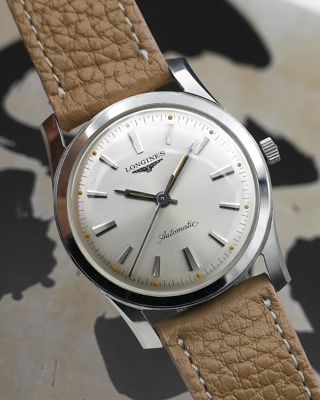

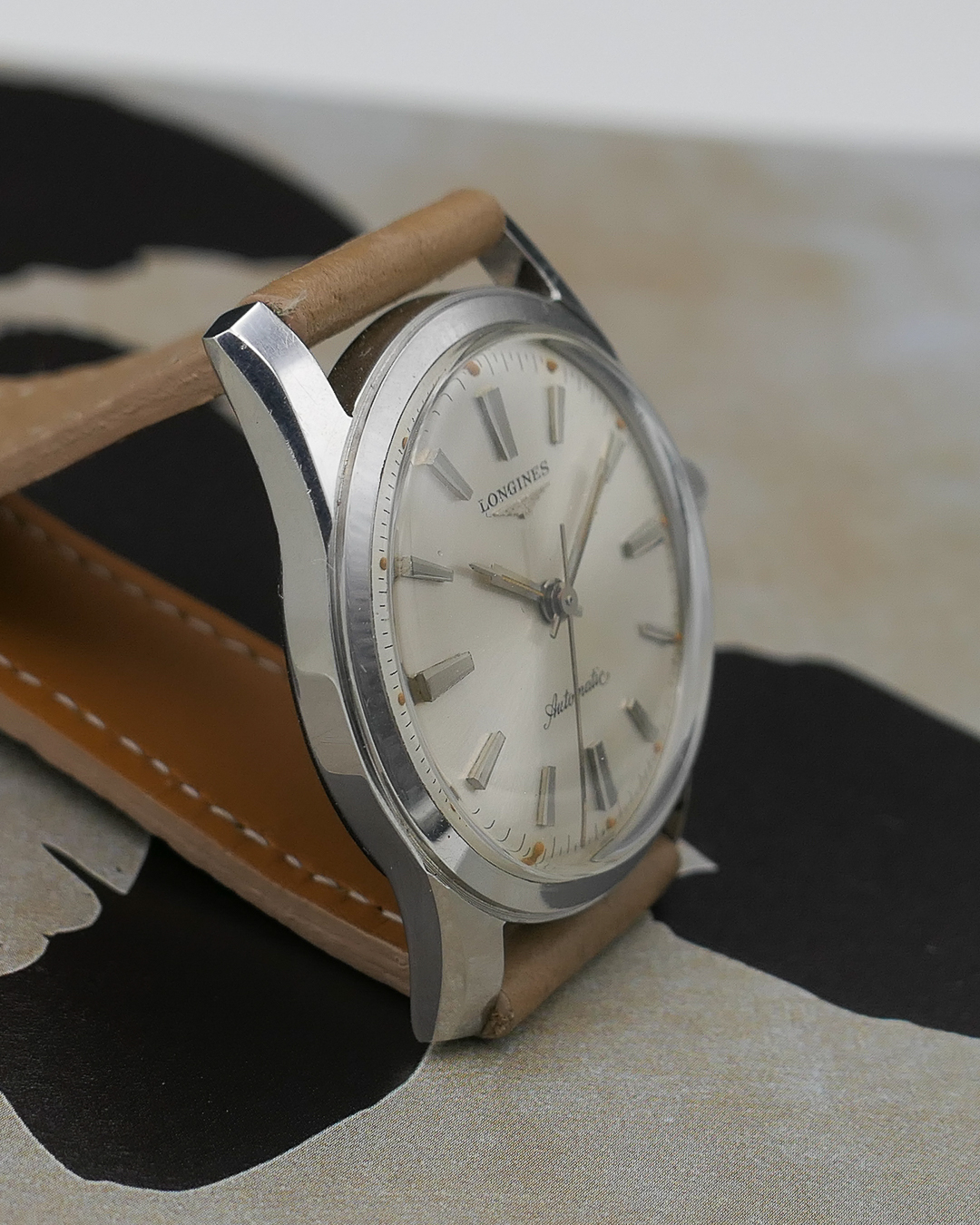

What would you experts out there make of this Longines?
23
15
Advertised as a 34mm, made for the American market in conjunction with the Star Watch Case Company, and from the 60s. I think it a sweet looking Longines. Yet, unlike any I've seen before. The dial is… how shall I put it? Full.. not cluttered, but filled. Rather than with the amount of room, or "white space" I'm used to seeing in Longines references.
But I'm new to Longines. Any help would be appreciated. (I do see that some polishing has been done to the back.)

Looks great from the front.

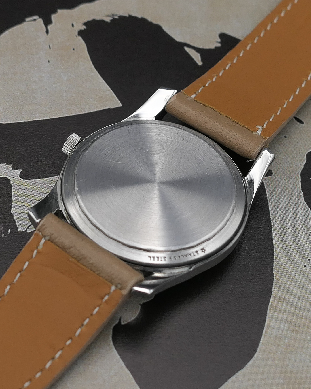

My concern is with the caseback. It looks like a screwdown type that the gripping lugs have been almost totally rounded off.
Comment based on appearance, not knowledge of the model.

Dial looks fine, there were a variety of styles offered.
However I share the concern about the case back noted above. I believe this watch has been discussed before and the conclusion was that the back has been ground on a lathe, probably to remove marks from a clumsy opening attempt.

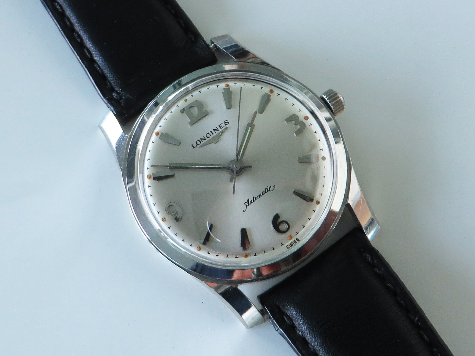

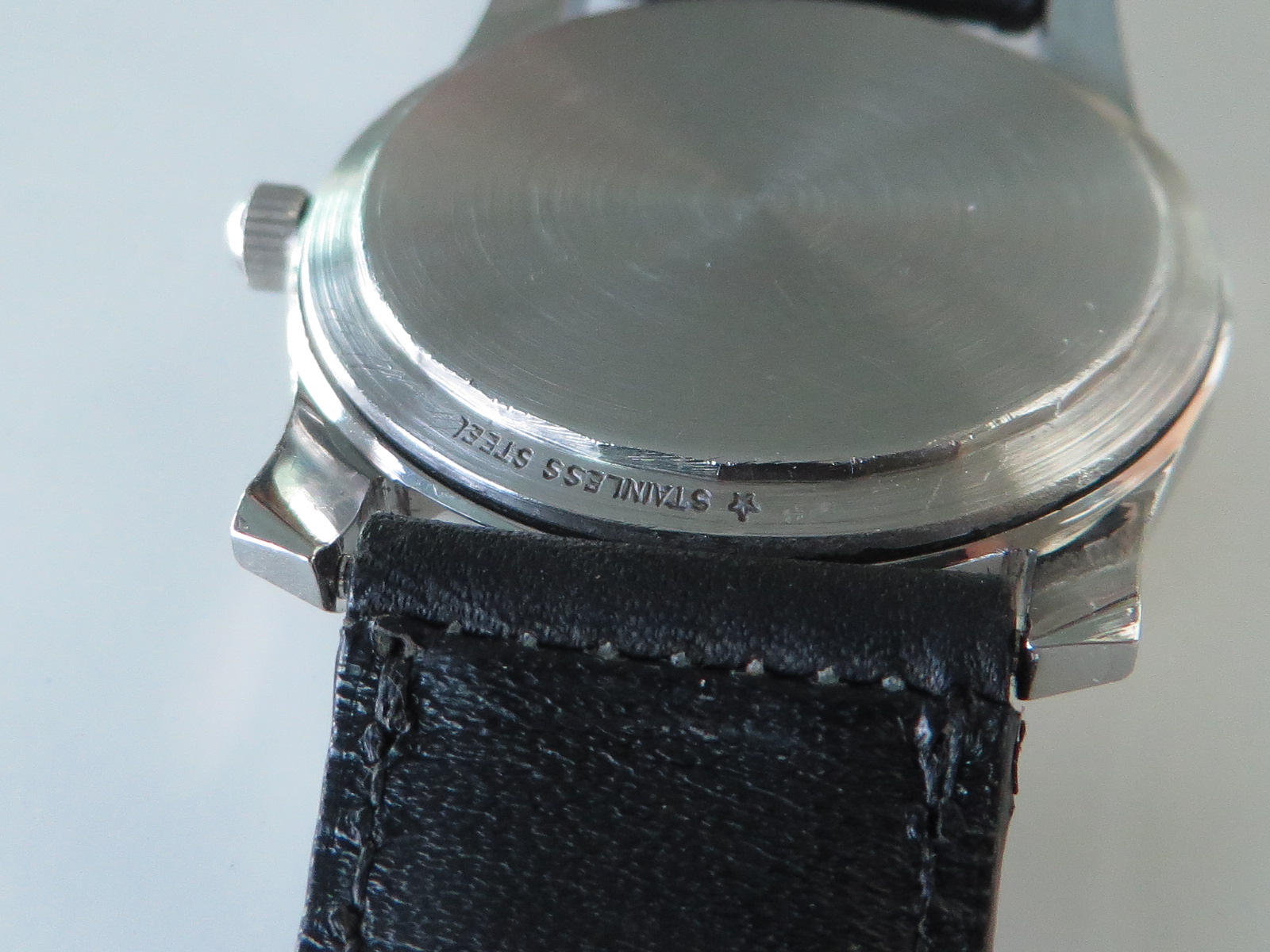

Here is mine for comparison.

It won't be easy to open that watch. That case-back has virtually nothing to grip.

This looks correct to me. There may be a very small chance that the dial and hands are original but are replacements. However, the condition of the case would suggest that that is not the case.
I expect that it is a calibre 350 (the crown looks similar to some grand prize watches).
The superglue-a-bolt-to-the-caseback method is not one I'd be eager to try

Extremely interesting and (perhaps unfortunately) telling. Alas… one simply cannot be too careful. Yours is a honey—those applied numerals quite bold and, really, outstanding. Hmmmm. I'll see what the seller has to say when back at work. I do really like the dial, but I'm looking for the "whole truth and nothing but the truth," you know? Trying to build a collection of "real deals" that suit my aesthetic taste. Not as easy as one might imagine! Thanks so much for your opinion. FH
You would be surprised at how noninvasive it is and a common procedure in the deep tropics. Well not exactly a bolt but usually some sort of flat round tool bit that can be affixed with "mightybond". My wife's Godfather was taught that trick at the Rolex service center in Makati many decades ago as a way to gently persuade a seriously stubborn solid gold oyster case back to unscrew without the Rolex tool "skipping" on the case back teeth. After removal simply soak the case back in lacquer thinner to remove the tool bit and that's that. It's still a common procedure on seriously stubborn stainless case backs as well. I have seen our watch tech in Cebu City even remove the bezel and acrylic on old oysters and similar swiss watches to allow heat to escape without damage to the dial and apply very careful amounts of heat to case backs to soften up stuck O-rings so the back will loosen. Not for the faint of heart but the tropics can cause these old watches to be very difficult to open when they have never been serviced in decades.
However I can see now that this longines has had it's case back wrench flats machined down and that is a shame.
