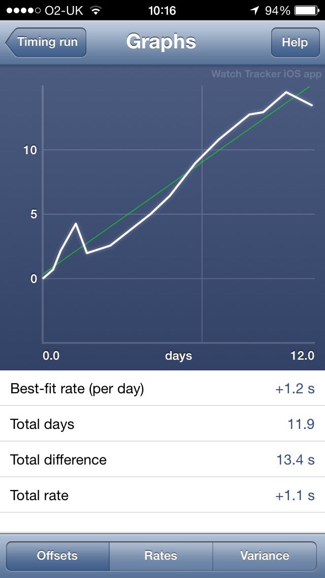

So, I've been back in the UK for a couple of weeks now. Using the watch every day, doing all the same stuff. Here's the result of nearly 12 days...
An average rate of 1.2spd!! A little blip early on, and again at the end mess the graph up slightly. With my job, my shifts times and actual work is anything but routine, so it's rested, worn and wound at slightly different times every day.
I'm amazed at the difference, considering it was at a constant +4.5spd just a couple of weeks ago over the other side of the Atlantic. I'm going back there for a week or so in a few weeks so a further definitive test will come!
