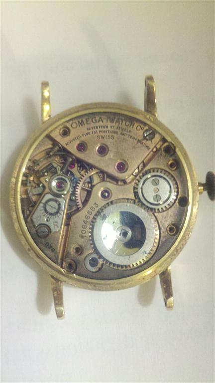

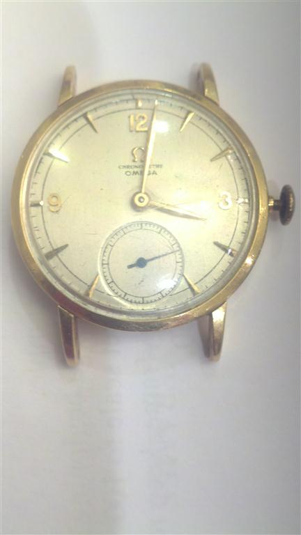

    Good Afternoon. I received a watch from my uncle's estate. The watch is not working properly and a local watch repair shop told me it is a lost cause and would need an complete movement. From my research the movement seems to be an 30TRG. Can anyone provide advice on what other steps I can/should take? I would like to see the watch functional again as I am a watch fan, but I'm not sure it makes sense to proceed with repairs. Any advice would be appreciated. Best Regards, Bill Dial.jpg Movment.jpg [​IMG][/IMG]

    Well one of the reasons why it isn't working is because I can see there are screws lodged into the mainspring, which seem to correspond to the empty holes throughout the movement. I would get it repaired, it's a valuable watch and a desirable one as well with the 30T2RG movement.

    Get a second opinion. Don't swap the movement.
    It doesn't look too bad imo, most likely the watchmaker can't be bothered.

    Thanks for the responses. I was very surprised to see the screws in the mainspring like that.

    That's a nice watch and as Kyle said very sought after by collectors of that era.
    Bill, you should contact Jesse - member omega564. He's done fantastic work on my watches.
