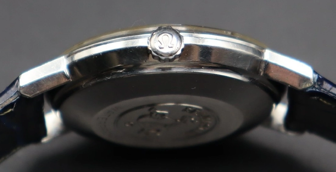

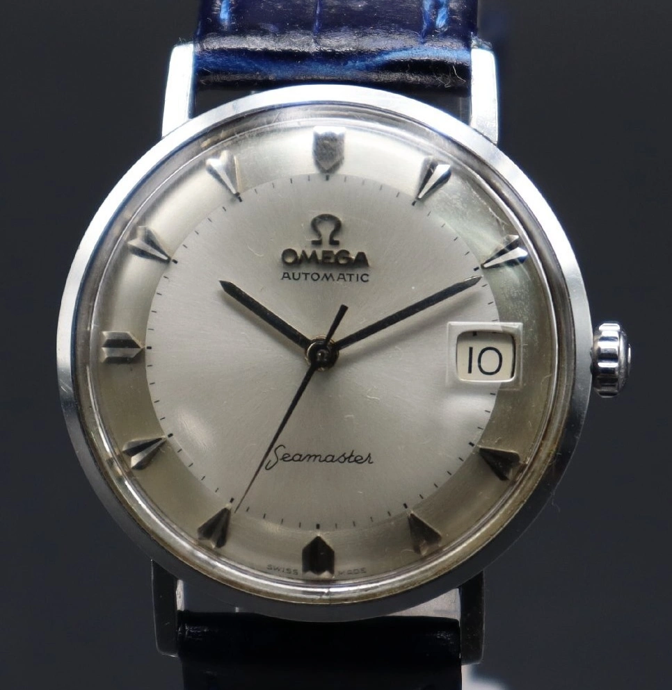

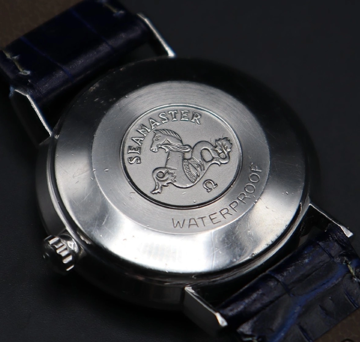

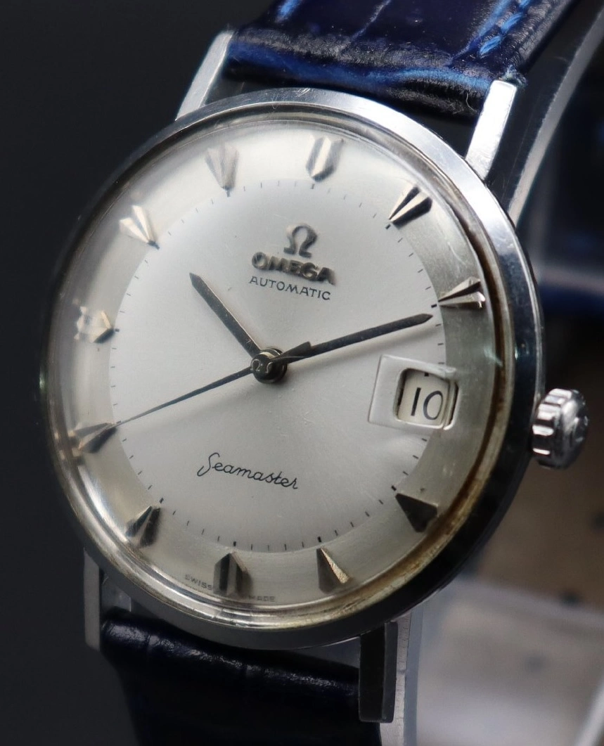

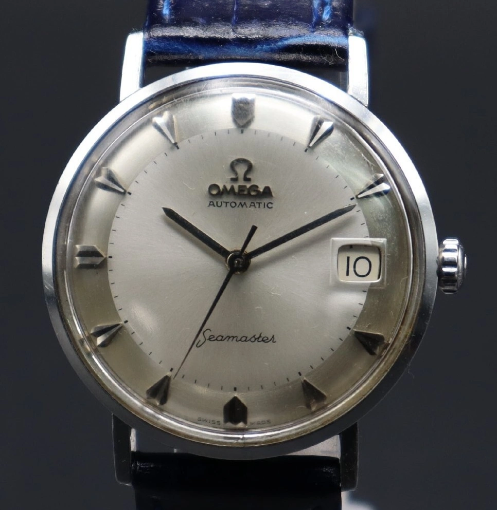

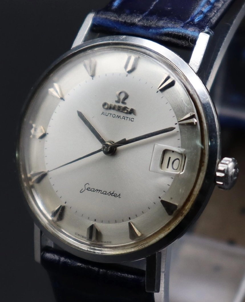

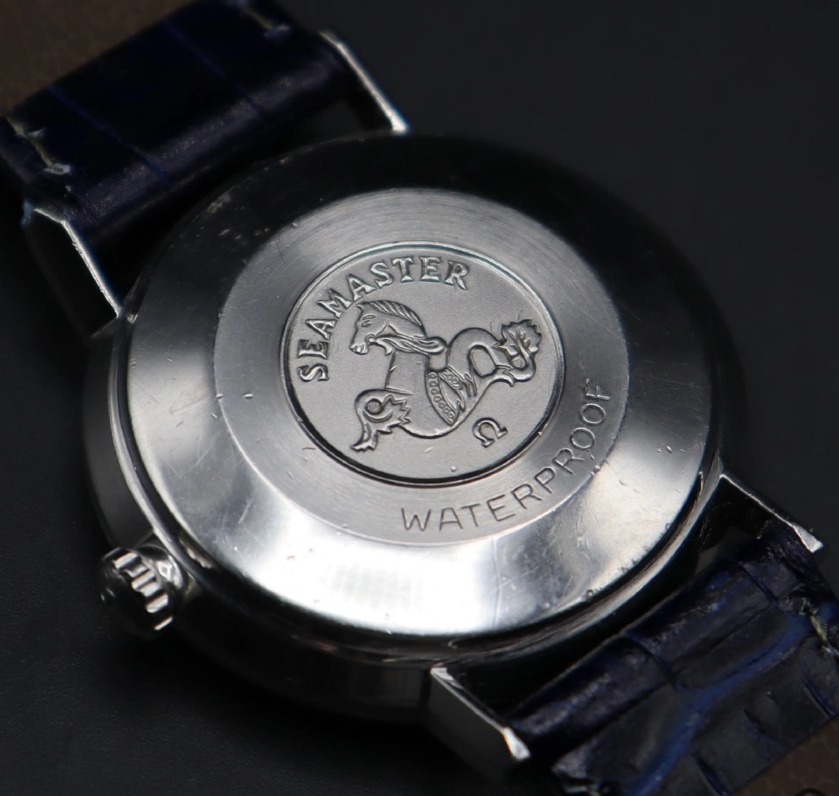

This was an impulse buy in an auction without enough time to research. Kind of questionable as a whole, but some interesting parts. These are the seller's photos, I will try to get photos of the inside when it arrives.
Any guesses?
16,305
45,025
Well, ‘61-62 had the hanger S in the front loader as a pre-Deville- Deville. I had one with a different dial but original “peanut” bracelet (also only made for one year). Never seen those markers or the two-tone in that case though- very interesting.
The lack of bezel around the date window I find out of keeping with this era but I don’t see any evidence that one was ever there- even more interesting.

909
3,818
Looks like a 14770 but not sure what’s going on with the date window.
13,489
31,804
Looks like the date surround is missing.
24,804
55,119
Yeah, I'm thinking that's true.
13,489
31,804
I will add that I have seen this dial before, the short no lume hands are totally in keeping with the dial. I need to dig through my files to see if I have photos.
1,535
1,726
it's a 14770 arrowhead markers with missing date window. A nice uncommon Seamaster indeed. Congratz!

As always, very impressed about the depth of knowledge on the forum ... and the generous spirit of sharing.
TBH, I'm pleasantly surprised about the hands being correct. I will keep my eyes open for a spare SMDV dial to scavenge a white date window surround.
