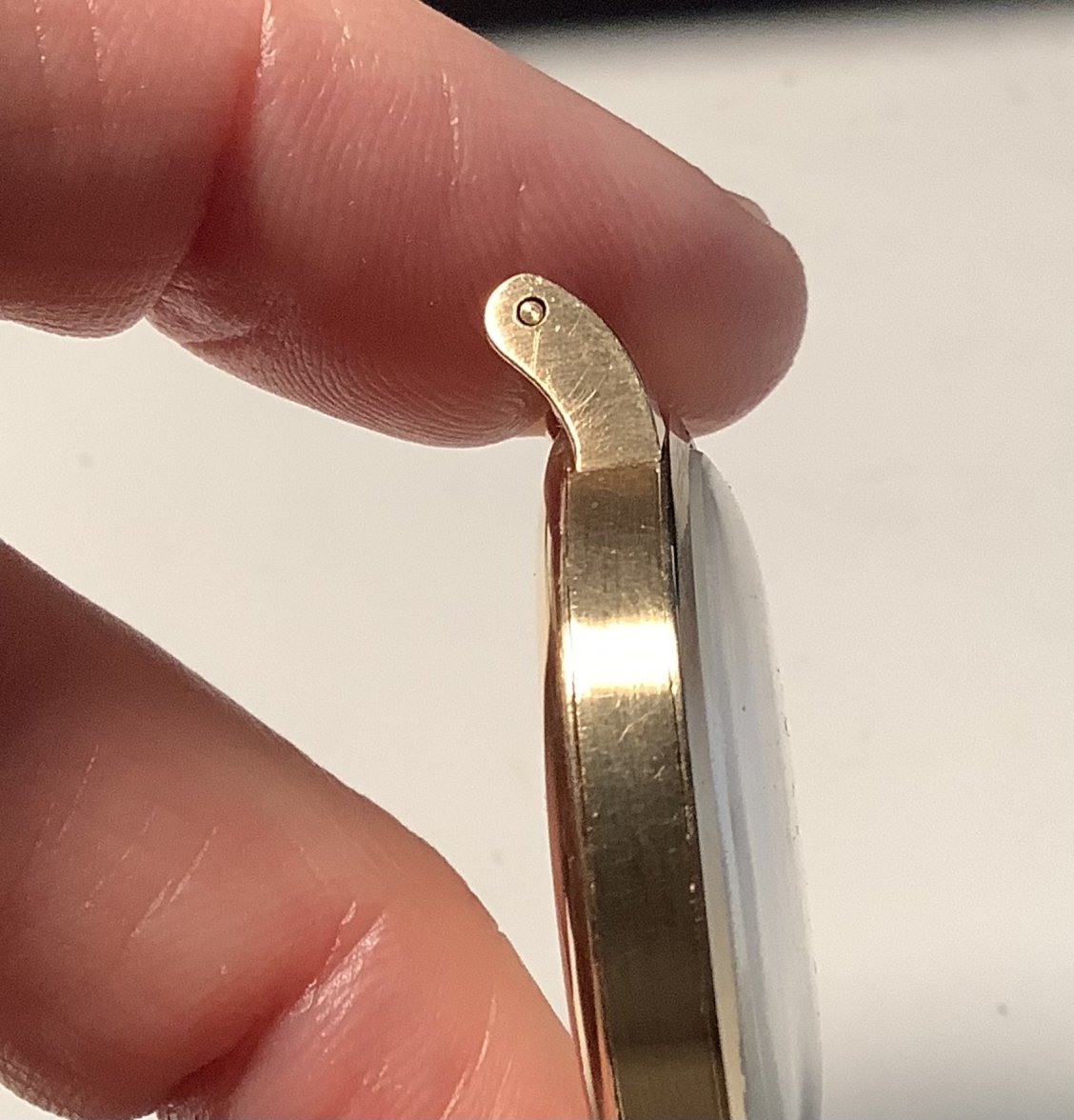

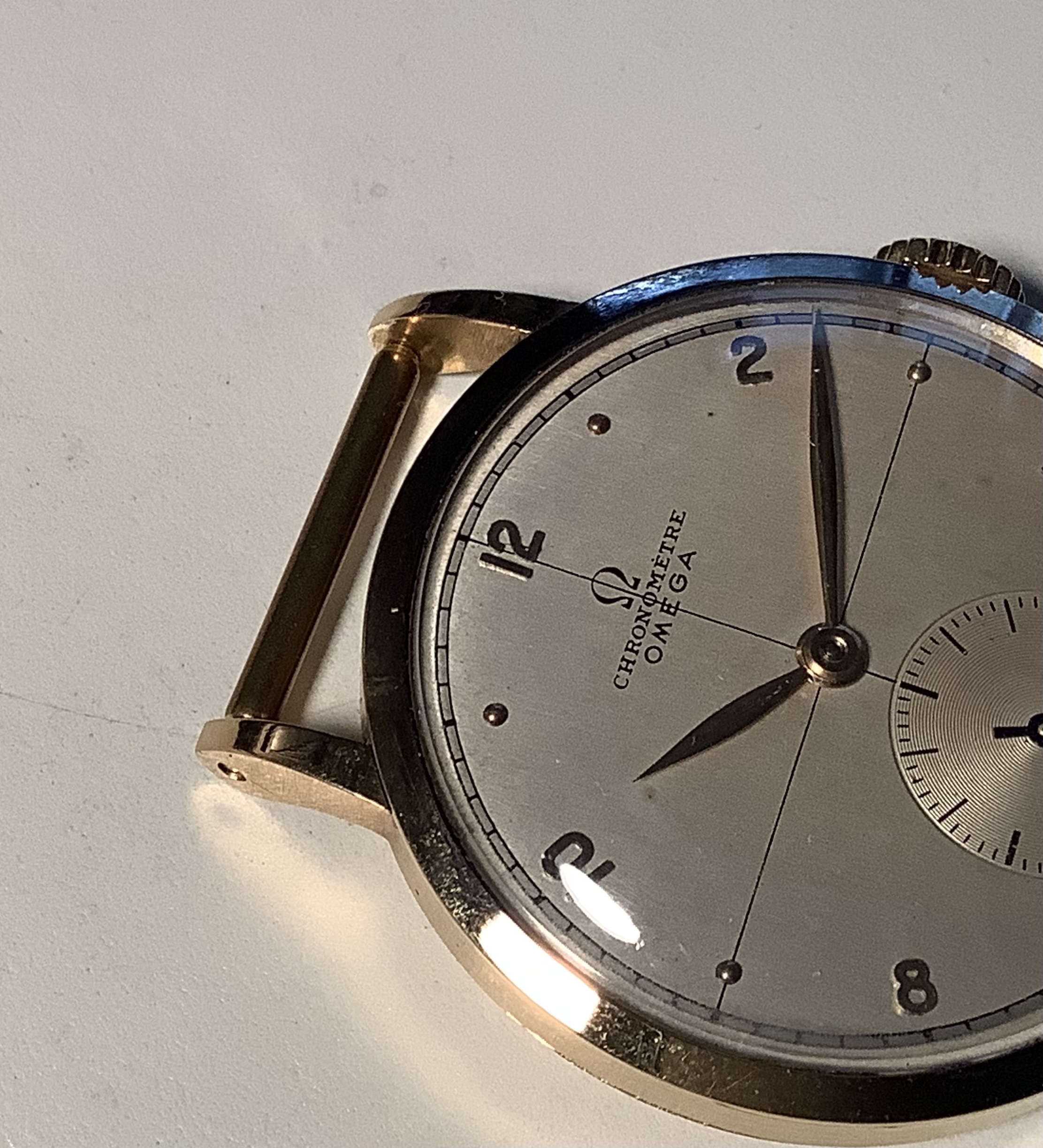

Thanks, Jim. When you say plated, I’m assuming with something like nickel, or some other white-colored metal? Over the years, on watches with less-beefy lugs, I’ve seen the brass/gold bars go to where the tips are visible at the edge. I guess for aesthetics, they used a similar-colored metal. Have you seen this? For example:
