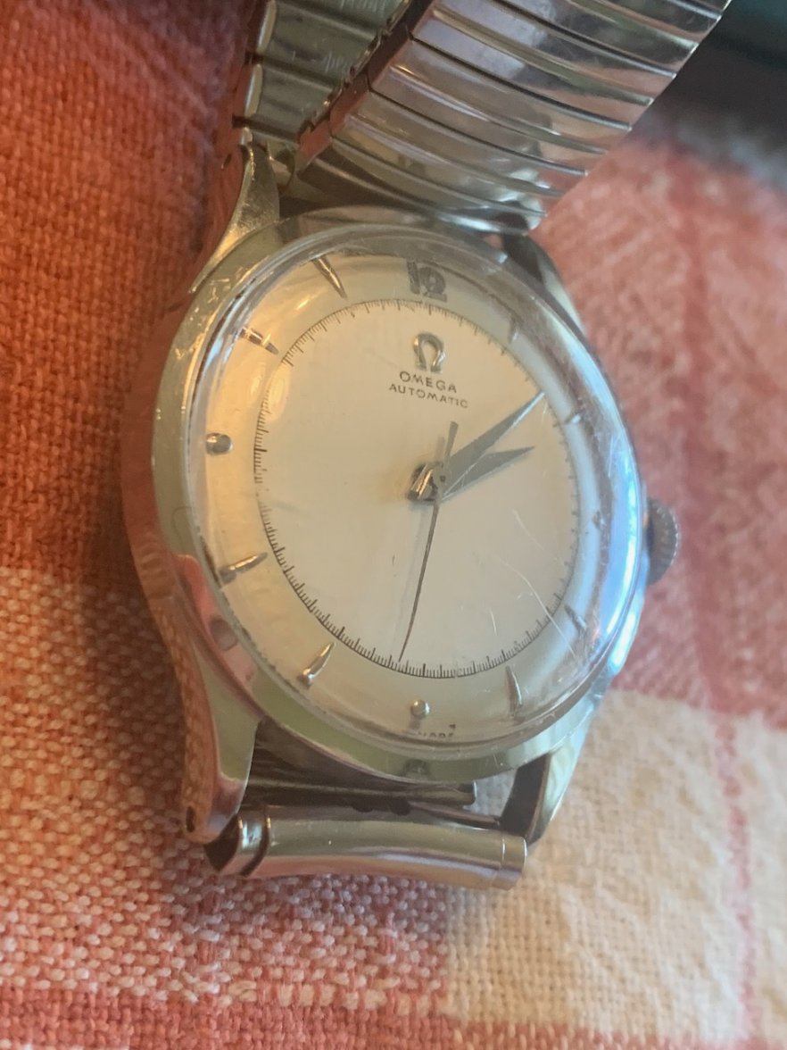

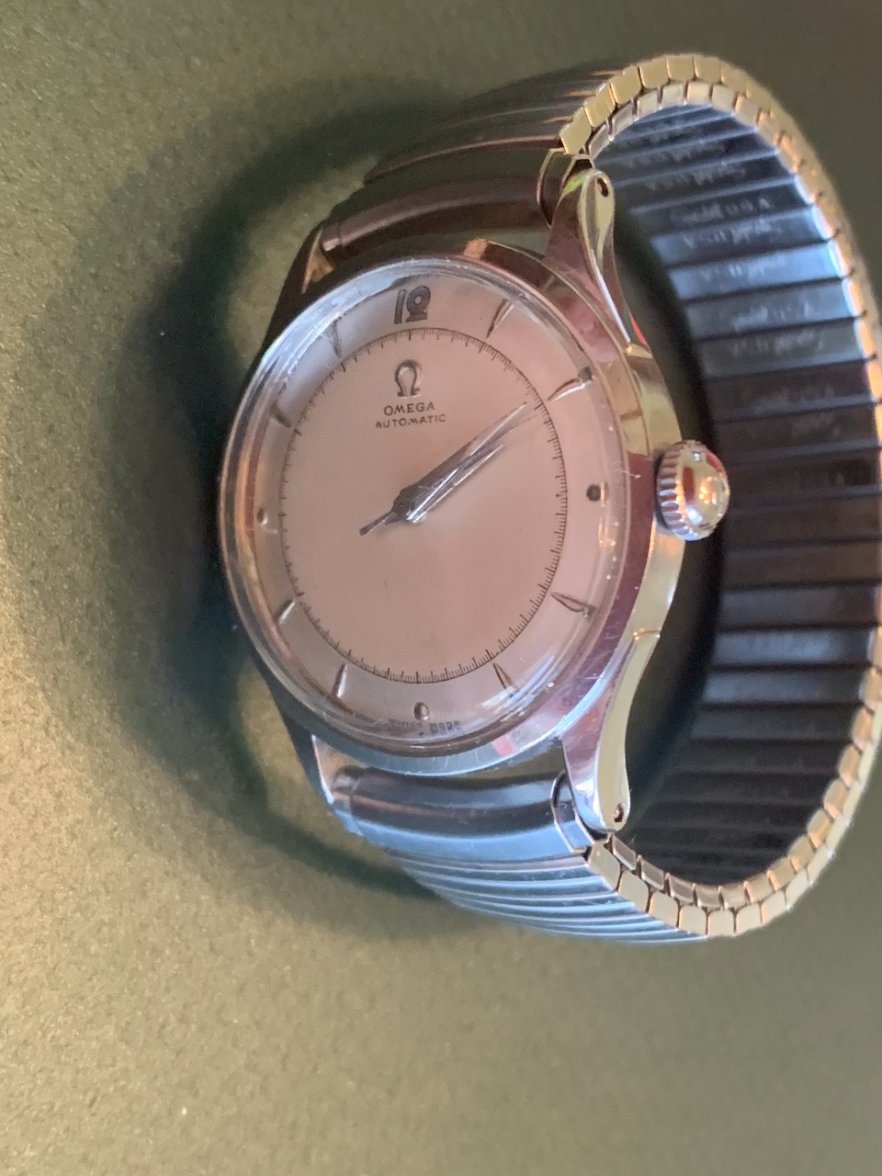

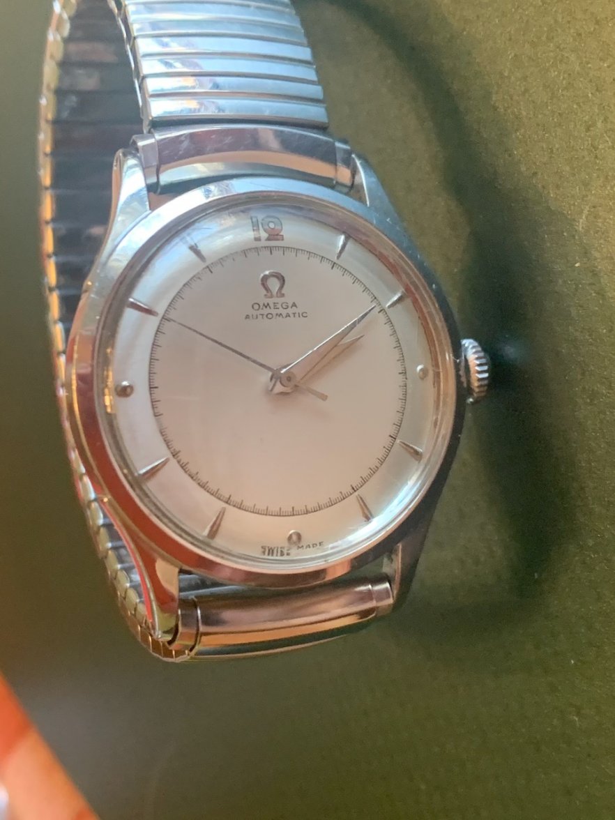

What Omega is it? 40's or 50's? Model? Minneapolis Repair Shop?
3
5
I inherited this watch from my father who passed away many years ago. I recently came across it, and NO, I have no desire to sell it. No matter what the resale value might be, the family value is too great. The automatic feature currently works. The watch is silver in color. I plan to bring to to a Minneapolis watch shop once the "shelter in place" is lifted. If it is feasible, I would like to have it put in good running order. In the meantime, I would like to identify it and find out a little bit about it. Will you please help me out with your knowledge about Omega? I recently took the included photos. Also, I'd appreciate suggestions about a Minneapolis/St. Paul watch repair shop. Thank you!
2,086
2,899
The watch looks like a ref. 2584 / 2480 from the late 1940s and appears to be in very good shape.
24,836
55,255

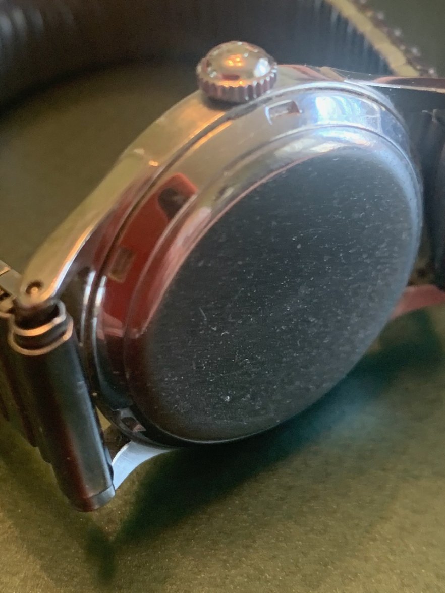

Wonderful inheritance. The definitive information needed to identify the reference and manufacturing date are inside the watch, so if you're comfortable removing the back and posting photos, we can give you more information. As you probably know, your watch has a "bumper" automatic movement, and you can probably feel the oscillating weight moving when you wear the watch. Unless you are very attached to that particular bracelet, you might consider replacing it, since the spring-loaded end-links can damage the lugs over time.
