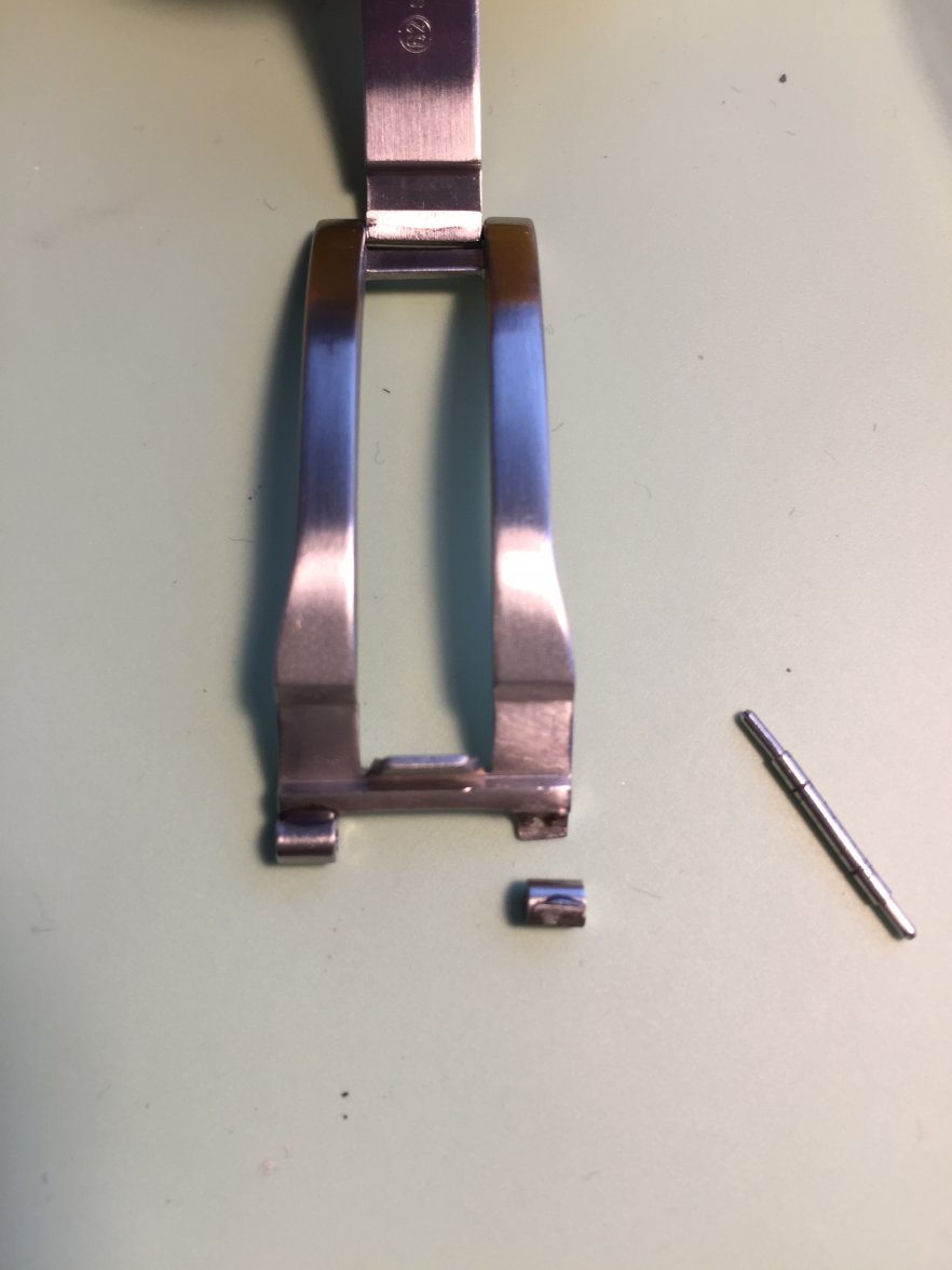

    Gi guys
    had a mishap and this little sleeve at the end of the clasp came flying off my 1499/842 bracelet. Clumsy, right? Luckily I rescued it! Anyway does it have a name, I don't want to look a complete dill when I take it to the watchmaker to see if he can put it together again...
    I would have thought it was all one part, but I can see how that would be difficult to manufacture.
    Cheers.
    J

    I call that the "springbar holder nubby thing at the end of the clasp".

    Ok. I think I'll go with the "springbar holder nubby thing at the end of the clasp". unless someone else comes up with a better name....anyone????

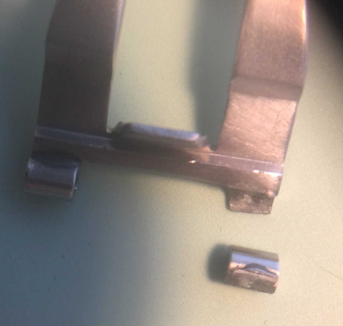

    Looks like it might need a new catch. Ok then. Probably Offrei? Not sure but might be called a clasp slider.

    I call it the "broken springbar holder nubby thing at the end of the clasp"...and yes you will need a new clasp as those parts are not sold separately.

    Cheers. Is brazing it back on an option?
  7. Archer Omega Qualified Watchmaker Sep 10, 2015
    26,464
    65,607
    Not a repair I would make personally - too much risk involved. If you could get someone to laser weld it that would be better, but they may still say it's at your risk...

    Thanks, Al. Pretty much what I thought, though never crossed my mind about a laser weld. But to be honest, it's not that big of a cost relative to the watch and also for what you get, including some peace of mind.
