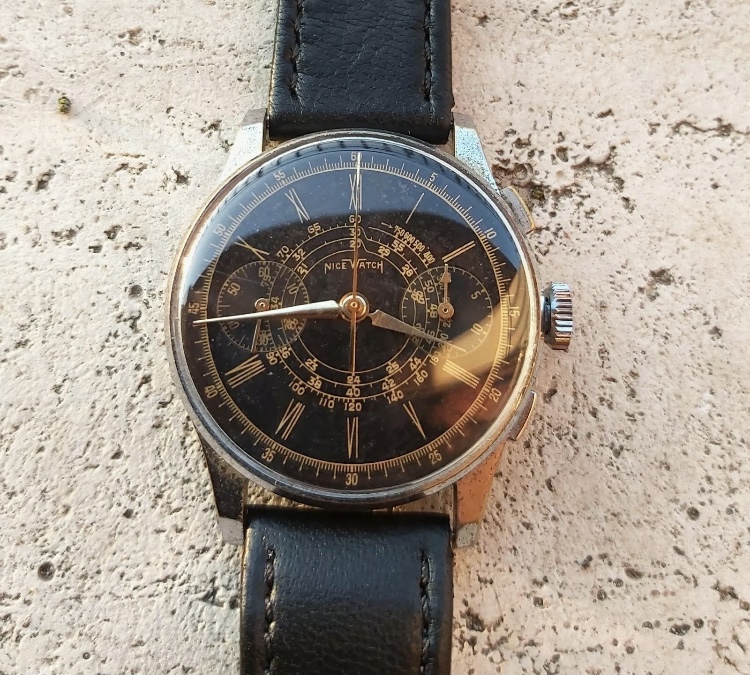

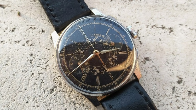

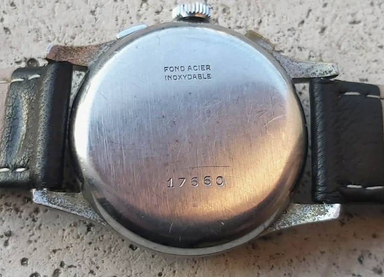

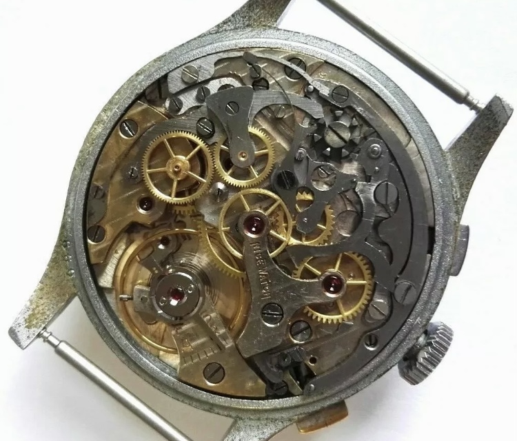

I found a couple of watches on eBay from this brand NiceWatch. I have never heard of it before and a quick search on Google didn't have too many informative links.
Please tell me about this brand 馃榾

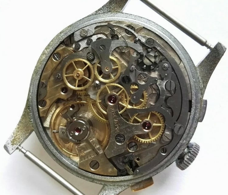

There was a lot of small brands that only put their name on watches produced by others ("Chronographe suisse" is maybe the most known provider). A lot did not survived and it is very difficult to find information about them...
When I say "produced by others", "others" usually produced the case, hands and dial, then put in it a movement supplied by other big names of the industry such as Landeron or Venus. It was a very common practice for watch manufacturer to not build the movement, and even high-end brands worked a lot like this: Breitling/Venus, Heuer/Landeron then Valjoux, Rolex/Valjoux, Omega/Lemania...

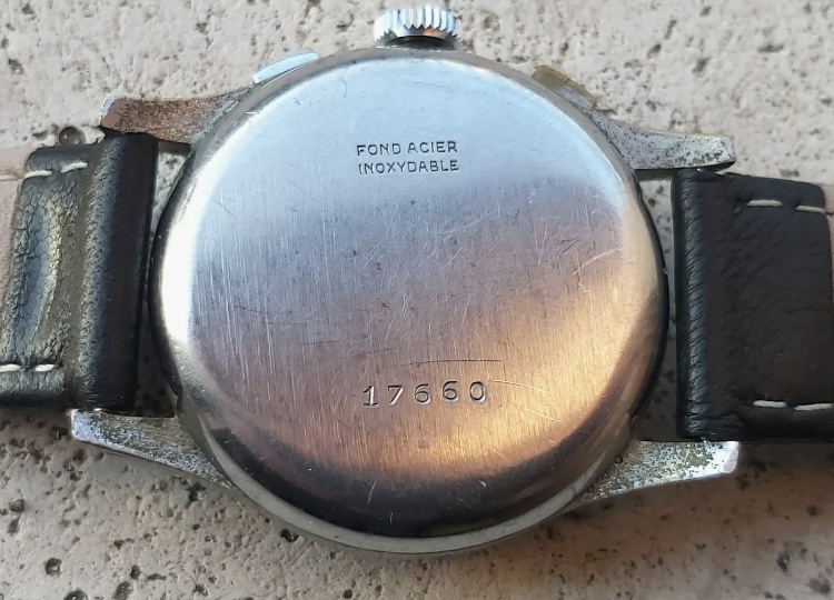

Yours hosts a Landeron 39 if I am not mistaken. The case looks like nickel-plated brass. Very common back in the days (because it was cheap, while steel was very expensive because of the war and post-war reconstruction) but as it is a softer material, the case usually end in a very bad shape... Yours lost a bit of plating but it looks in good condition overall. And I like the lugs 馃憤

Lovely dial!! What is the size?
I think it was 36mm excluding the crown. Wsnt to point out that I'm not the owner of this watch 馃榾

Thank you so much for sharing this information!
I agree this is a pretty nice looking piece and the condition is also quite okay. Only hoped that the hands were silver colored, then this would have been an instant buy 馃槈
