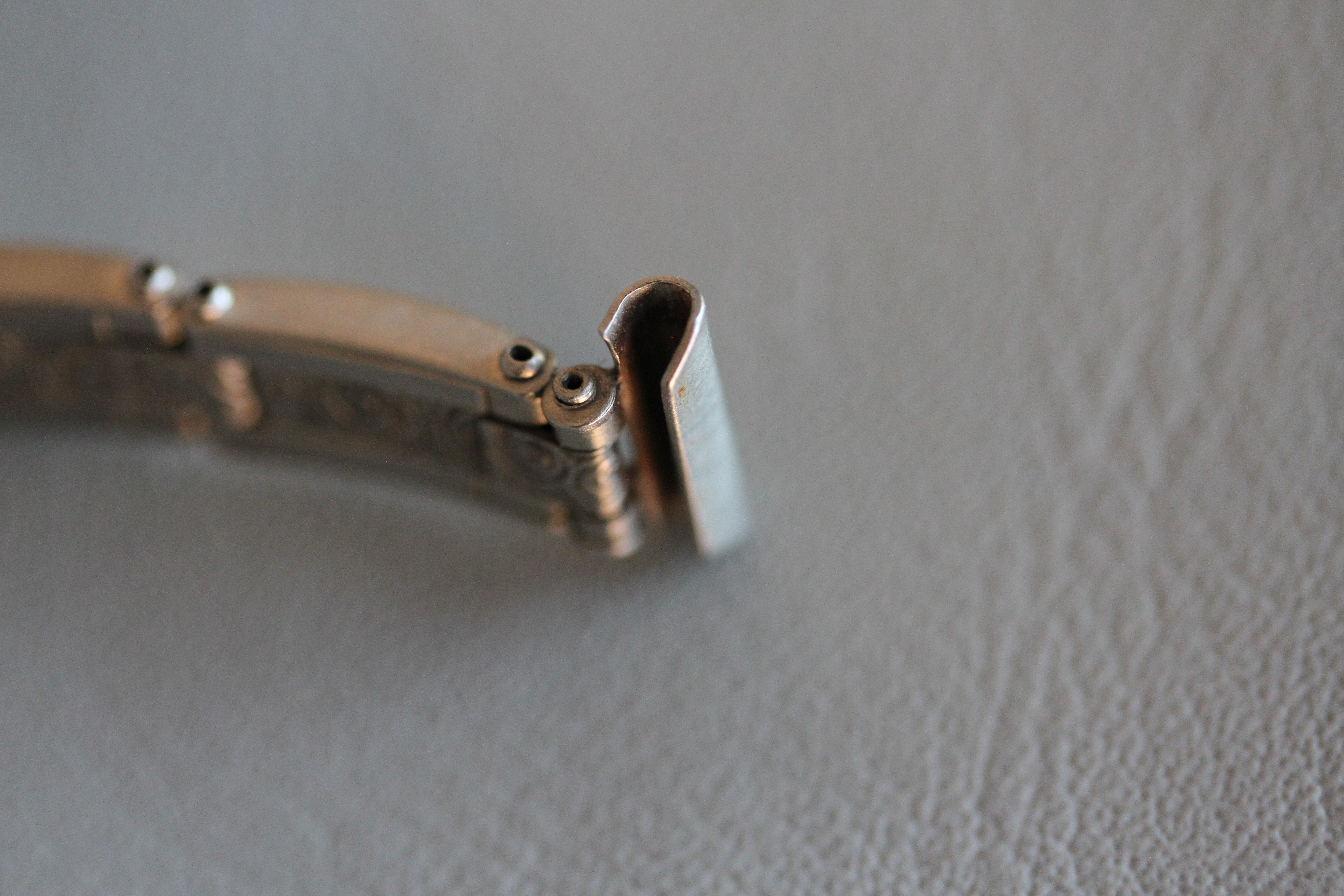

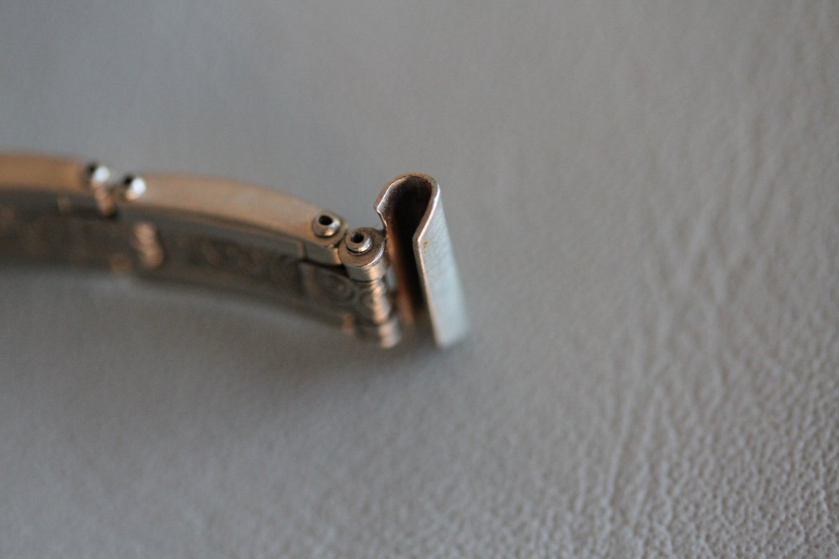

I recently bought a bracelet for my silver Omega, but I'm cautious about crimping it around the delicate silver fixed bars. It's not something I have experience with.
I also don't like the idea of shipping this off to my watchmaker just to close the loop.
Would a small rubber mallet work well enough?

How about a sort of needle nose pliers?

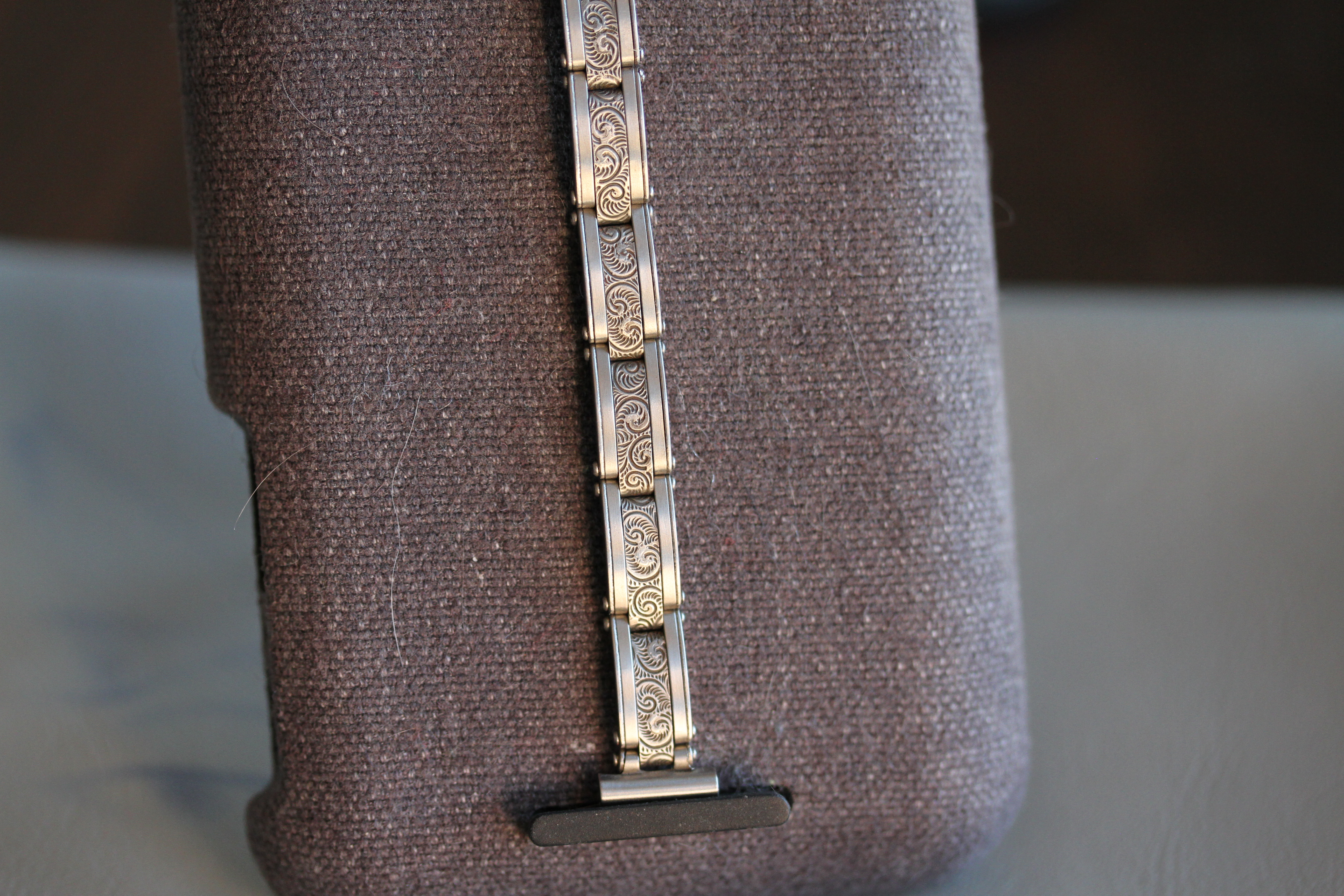

What a lovely old bracelet!

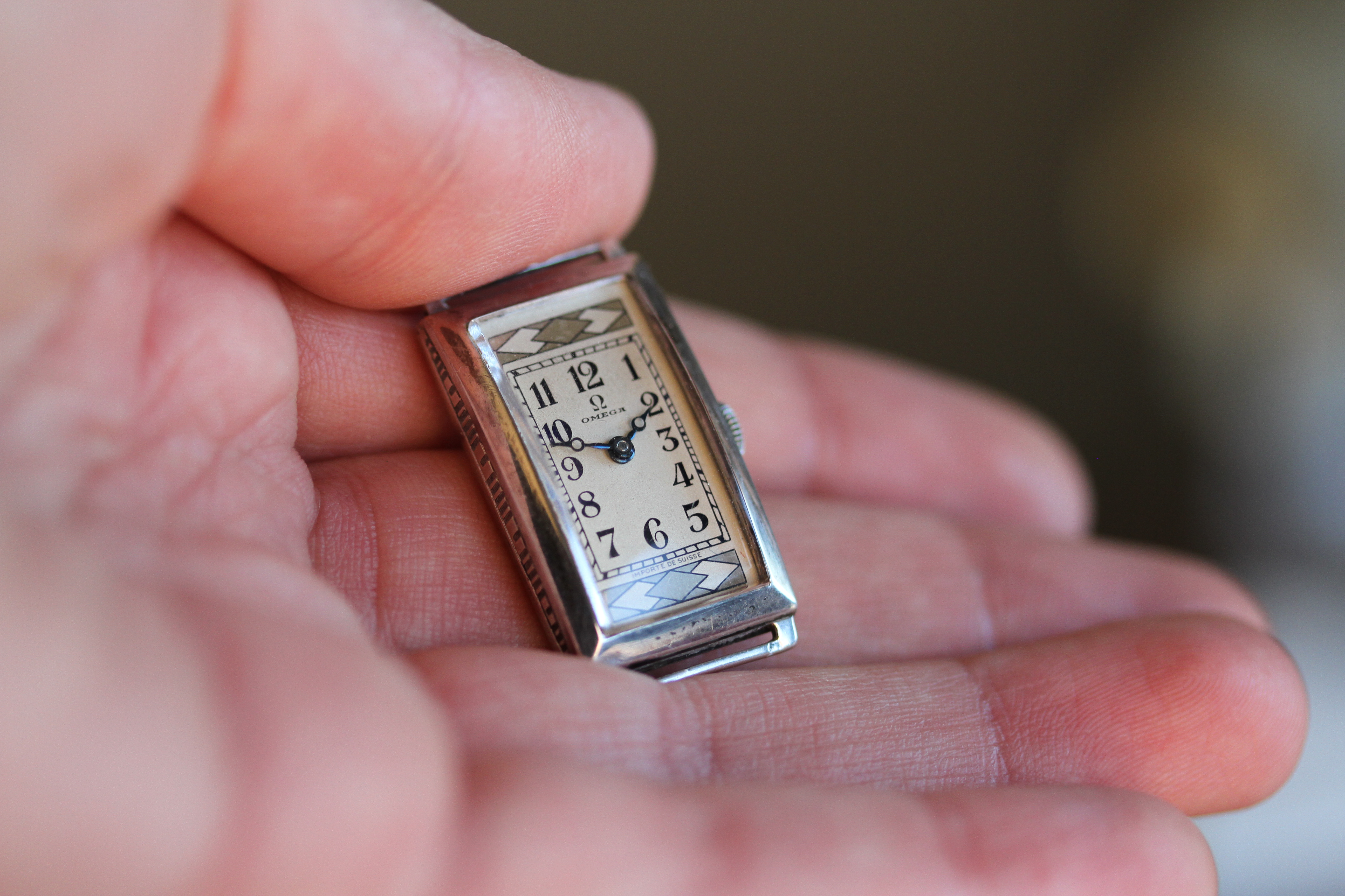

That’s a gorgeous combo D,
I reckon any competent jeweler could do it on the cheap, but I’ve done a similar move with adjustable vice grips and a piece of leather to protect against scratches

I figure that would scar the metal.
Use a chamois or one of those rubber squares for gripping jar lids,

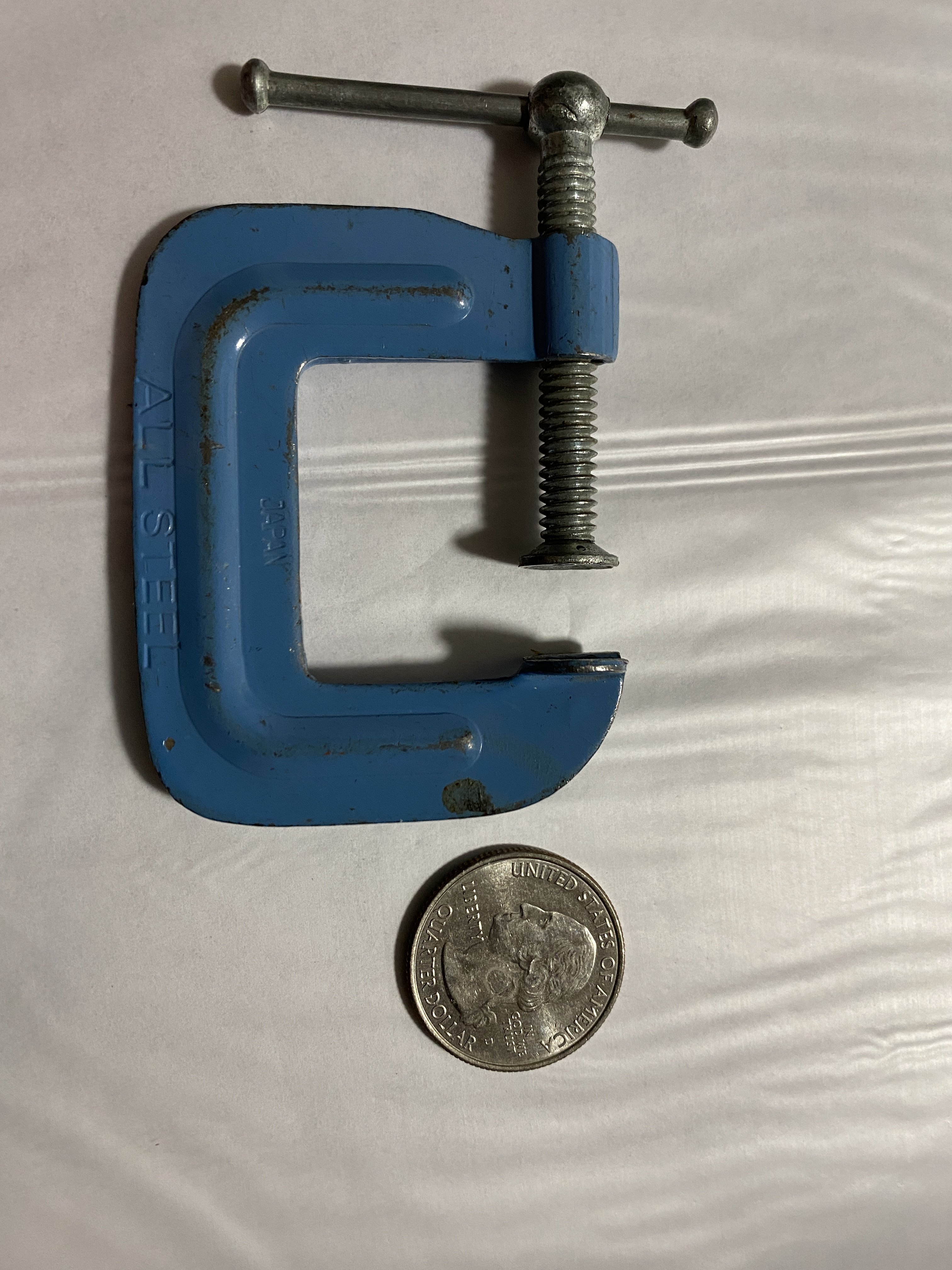

A small vise if you have one, protecting the ends with strips of leather. Pliers would also work (soft jaws, or protect jaws with leather), just a bit less controlled. I could also imagine using a crystal press with a plastic die. Just depends on what you have handy.

This will give you control, just add leather as mentioned above, or some tiny stick-on door bumper dots for cabinets.

I have no useful advice but must say that your Omega is gorgeous! Neat bracelet too.

a padded vice would help in steadying the watch. that is a super gorg omega tank. the case and dial detailing, love it!

Smooth jawed pliers, or add some padding to prevent marking.
This. Have used this method for Bonklip bracelets. I wrap a few layers of painter’s tape on the jaws, or similar, to provide extra protection,
