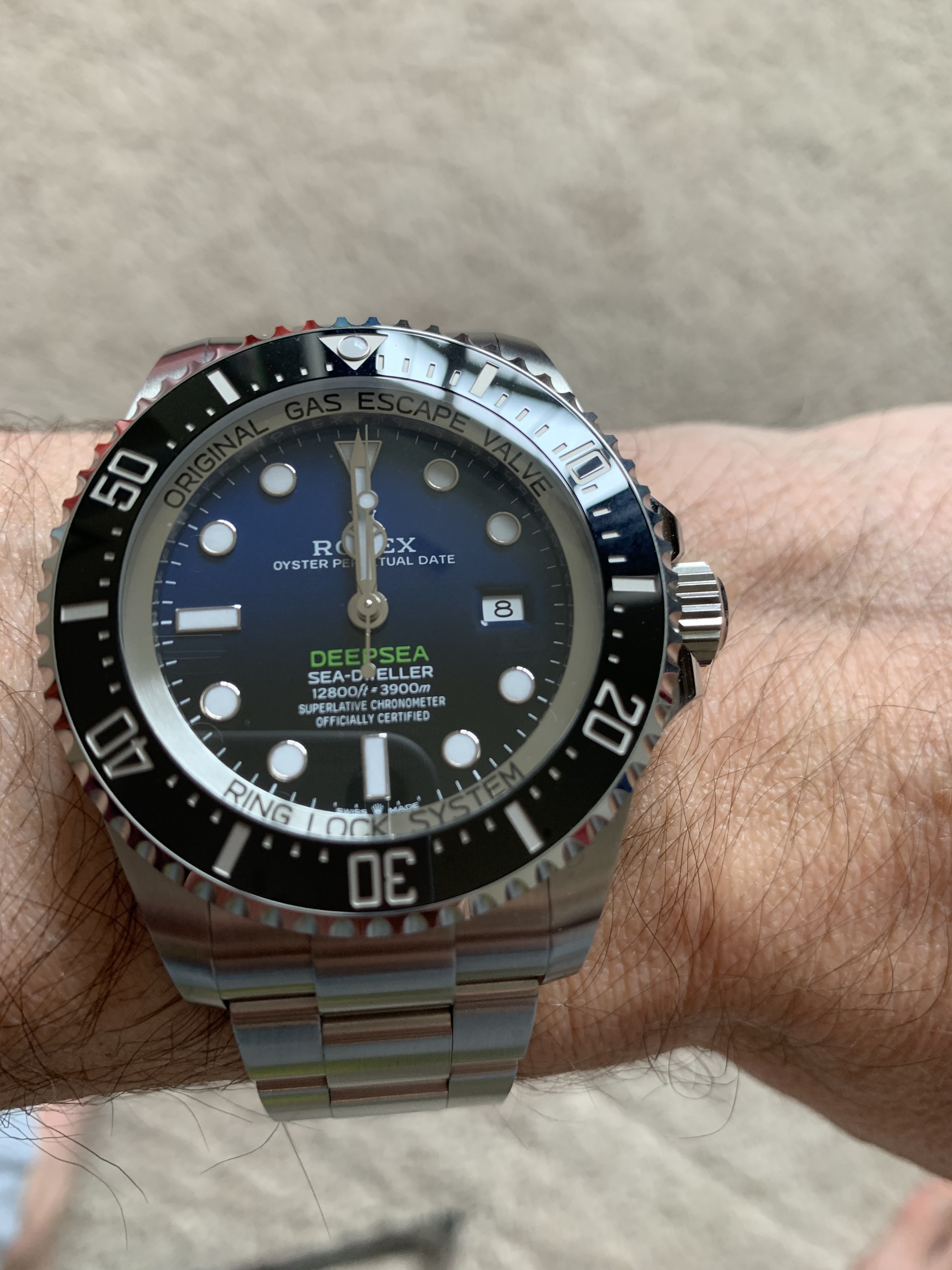

I have a old Rolex Submariner and a colleague from the office recently bought a Sea-Dweller Deep-Sea
I was chatting to him about it and asked why he'd gone for this particular reference over the Submariner and his response was, 'becasue it is better'; naturally he doesn't dive other than into swimming pools on holiday...

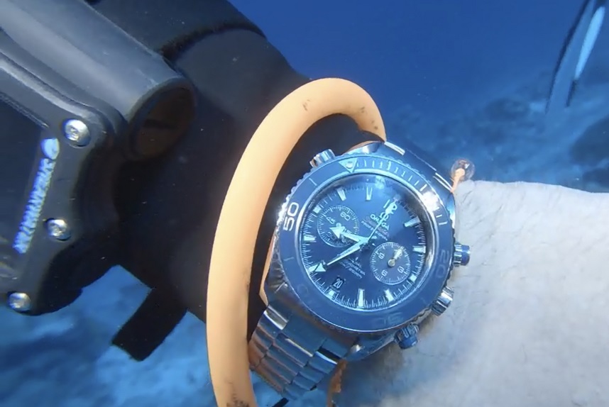

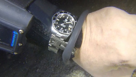

This works:
But so does this:
As for backup, both my wife and I carry an Oceanic BUD computer in our pockets. We also have full consoles but wouldn't use them unless a Shearwater (wireless integrated air pressure) had a problem, which they never have. The watch is just for show; I never set the bezel.
We also carry two lights, two PSDs (one on a reel). Oh, and a Spare Air each (3 cu.ft.). So we're pretty well backed up.

This works:
But so does this:
You run wireless with a hose mounted console with air pressure?
man your more paranoid then me. I just run a wireless console on a retractor mounted to my chest.
792
919
The wireless is a transmitter mounted on the reg (Oceanic, or so I'm told; it came with the Shearwater). The receiver is in the Shearwater. Yes, the console is hose mounted and hangs on a retractor at the bottom left side of the BC.
We once had a need for the console when I left the Shearwaters on the nightstand in the hotel a half hour away. It was either make the other divers wait an hour or improvise. We pulled our BUDs out of the pockets and used them and the consoles for the two tank morning. Doing so makes you realize how spoiled you are with a wireless transmitter.
We did take the slight risk that the Shearwaters wouldn't know of the day's nitrogen loading, but they were shallow dives on Nitrox and the following day was similar. Good times.
