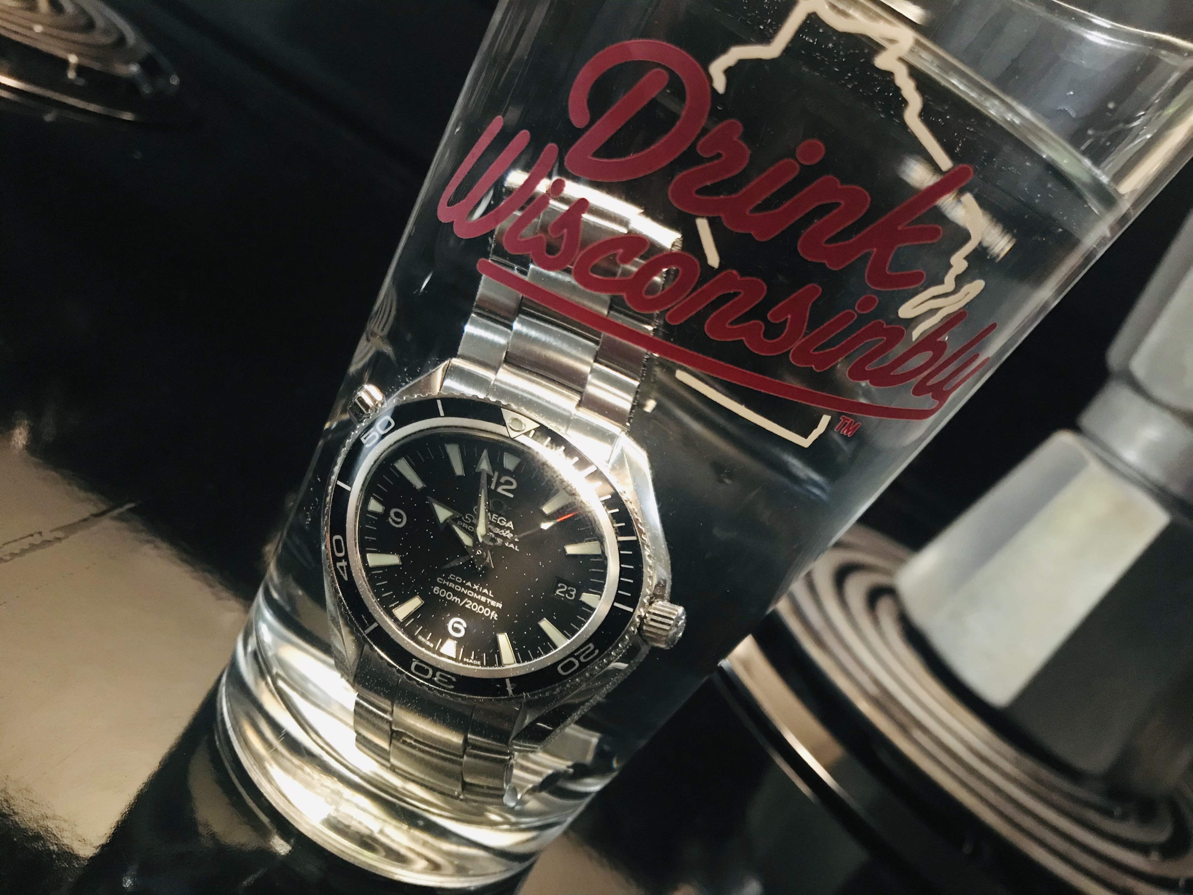

I think people are under the impression that a larger depth rating means that a watch is even more water resistant at lesser depths and for longer periods of time than a watch with a lesser depth rating. Like, "wow, if my Planet Ocean can go down 600m, no matter what I expose it to up here on land, it will always be waterproof. No need to ever have the seals checked. And why bother to avoid detergents or other things that can put extra stress on the gaskets?" That's my impression at least––and to some extent I can't disagree. I'm also open water certified and never go below 40 meters, but I still wouldn't wear a watch rated only to 50m.
It's so waterproof, guys!

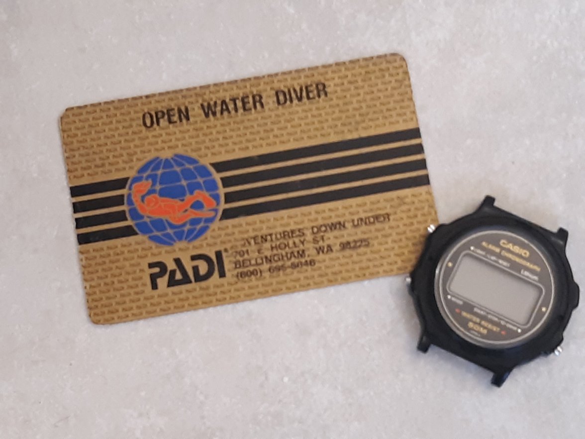

I posted this in another thread, but back when I dove I used analog gauges and this cheap Casio I found on the sea floor during a training dive. I got 25 dives on it with no issues. None were deeper than 30m. It is rated to 50m.
