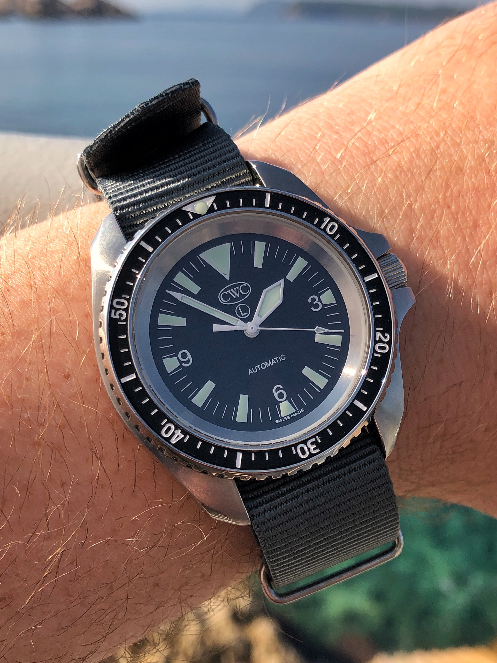

When I decided to get PADI qualified last year, I decided that I wanted to have a watch that was my "Dive Watch". That I could use for every dive I did from the point I started, until the point someday in the future when I can't dive any more.
My criteria were:
1 - Something I liked and would want to look after, that at the same time I could afford, and wouldn't be too upset about if it ended up at the bottom of the ocean and couldn't be retrieved.
2 - Easy to use underwater and on dry land.
3 - Would sustain 30+ years of Scuba diving. Whether I can do the same is a different matter.
I absolutely could have dived with a 50m water resistant casio digital, and there would have been nothing wrong with that.
But I am also a watch nerd. So wanted something cool and interesting (to me), that fulfilled the three desires above.
I picked the CWC Royal Navy Auto MK2 - reasonably affordable, 300m water resistance, and if the armed forces have been using them since 1981, I thought they could probably cope with anything I could throw at them.
These were built to 300m WR, because that's what the MOD specified.
As to why the watch industry makes watches with crazy depths - I guess technological bragging rights.
As to why people buy them, I'd agree with what others have said - personal bragging rights.
Rest assured, that 300m WR sure came in handy, 18m under the surface of the Adriatic. 😁

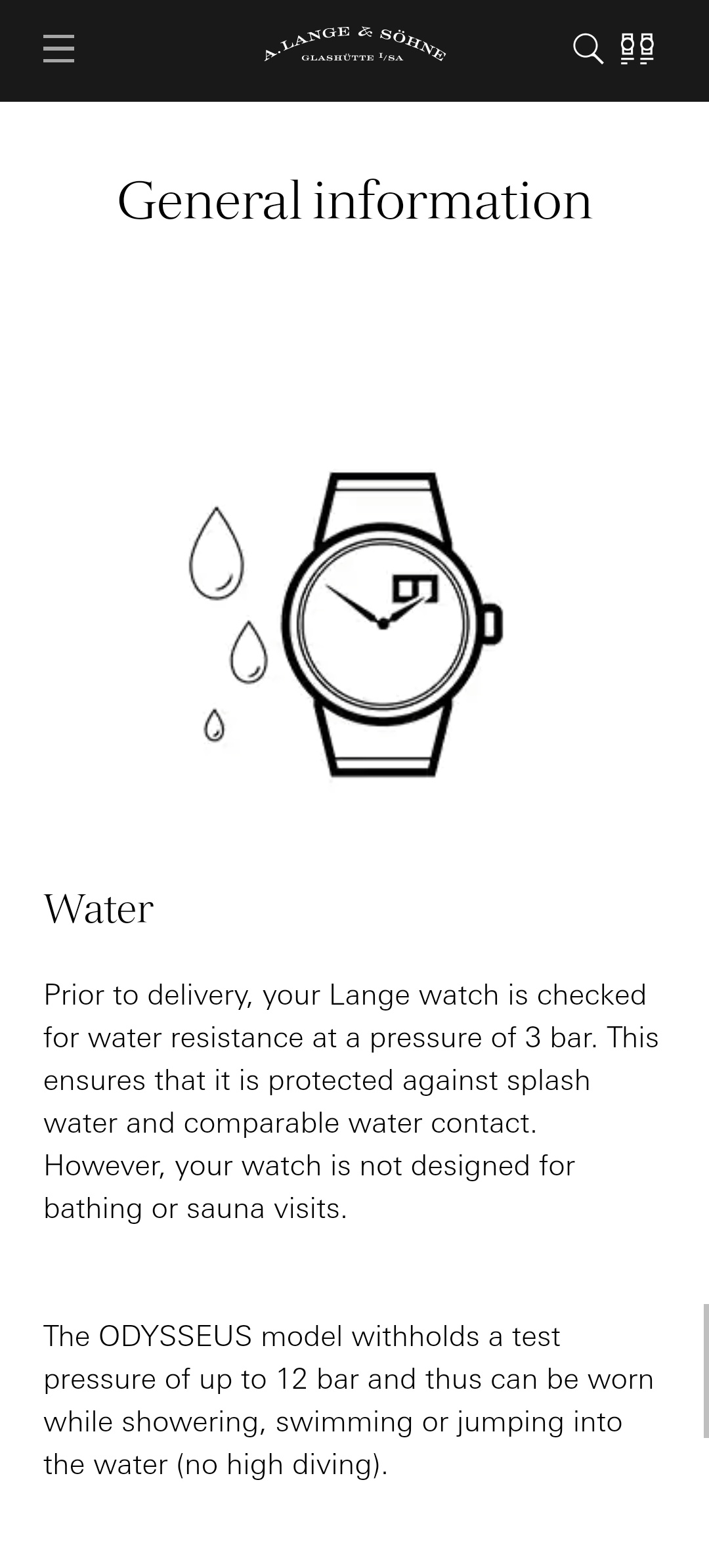

Any reputable company will not make you Google some third party chart made up by a watch blog, a watch seller's site, or some other entity to "decode" their depth ratings. In the case of Omega, they explicitly state that the rating on the watch is what the watch can go to in terms of depth:...
Thank you very much. I learned things today. As per your example I googled A Lange Soehnes guide to water resistance:
Clearly the best option is to look at the manufacturers guide or the watches manual.
P.s. Is there some "dynamic pressure" thingy alluded to in the last paragraph ("No high diving").
No idea why this is there. What does "high diving" really mean? What height is considered "high" enough to be "high diving"?
Far too many questions about this sort of statement to tell you why it might be there. As this is the first "sport" watch ever made by ALS, maybe they are nervous about dynamic pressure and their designers and engineers have never actually done the math? Maybe they are not concerned with water resistance at all, but movement shocks? Who knows...you would have to ask them. I can't say they inspire much confidence in the water resistance of their watches though, but then again they are a company that has up until recently, made dress watches that I doubt anyone takes in the water anyway. Very different situation from a company like Omega...

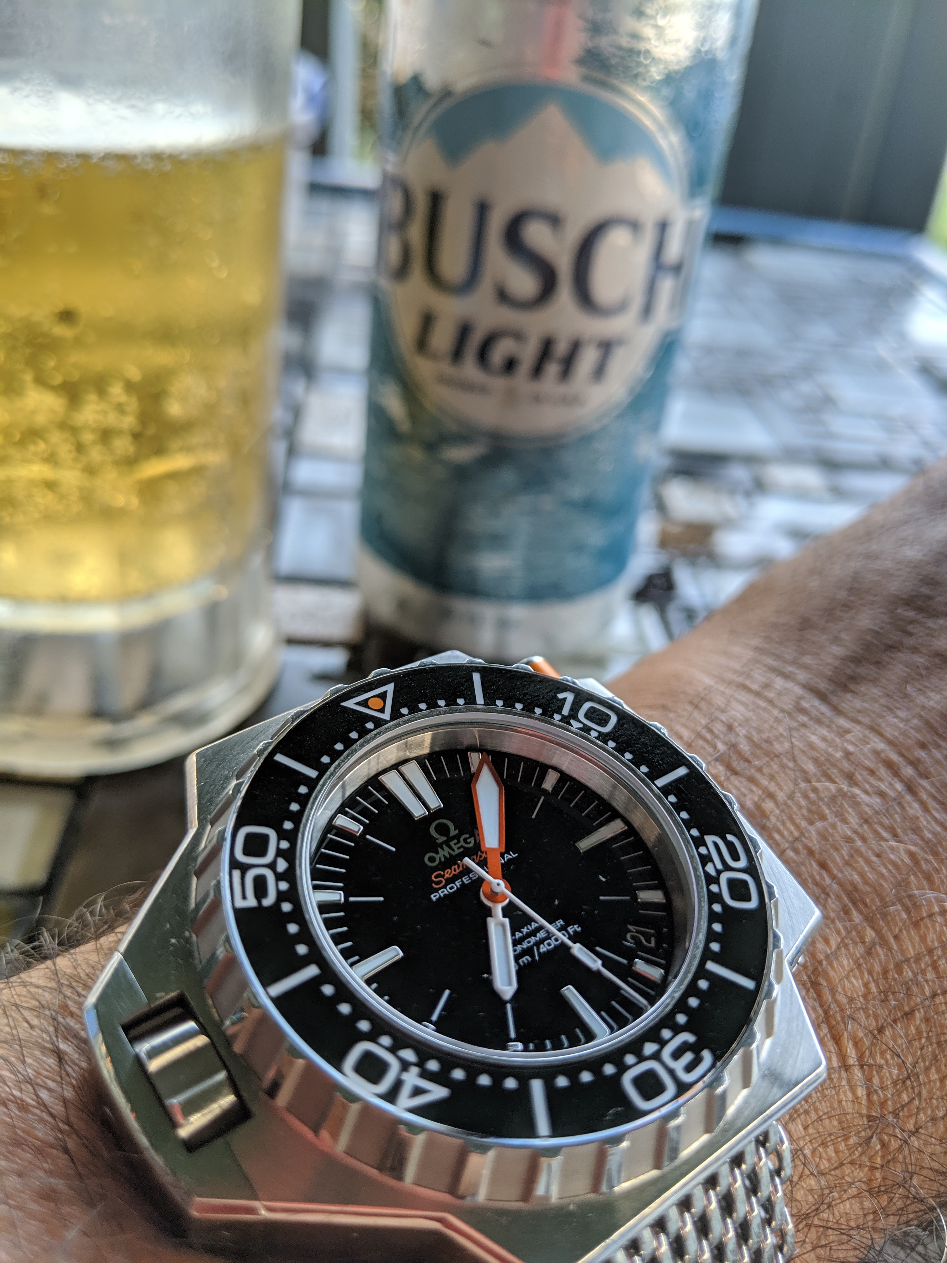

Anyone else go 4000 feet? Don't hate on me for my beer choice, it was two for one pricing.
5,530
9,452
Oh dear Dog. I don't hate you, but I definitely feel really, really bad for you! 😁
