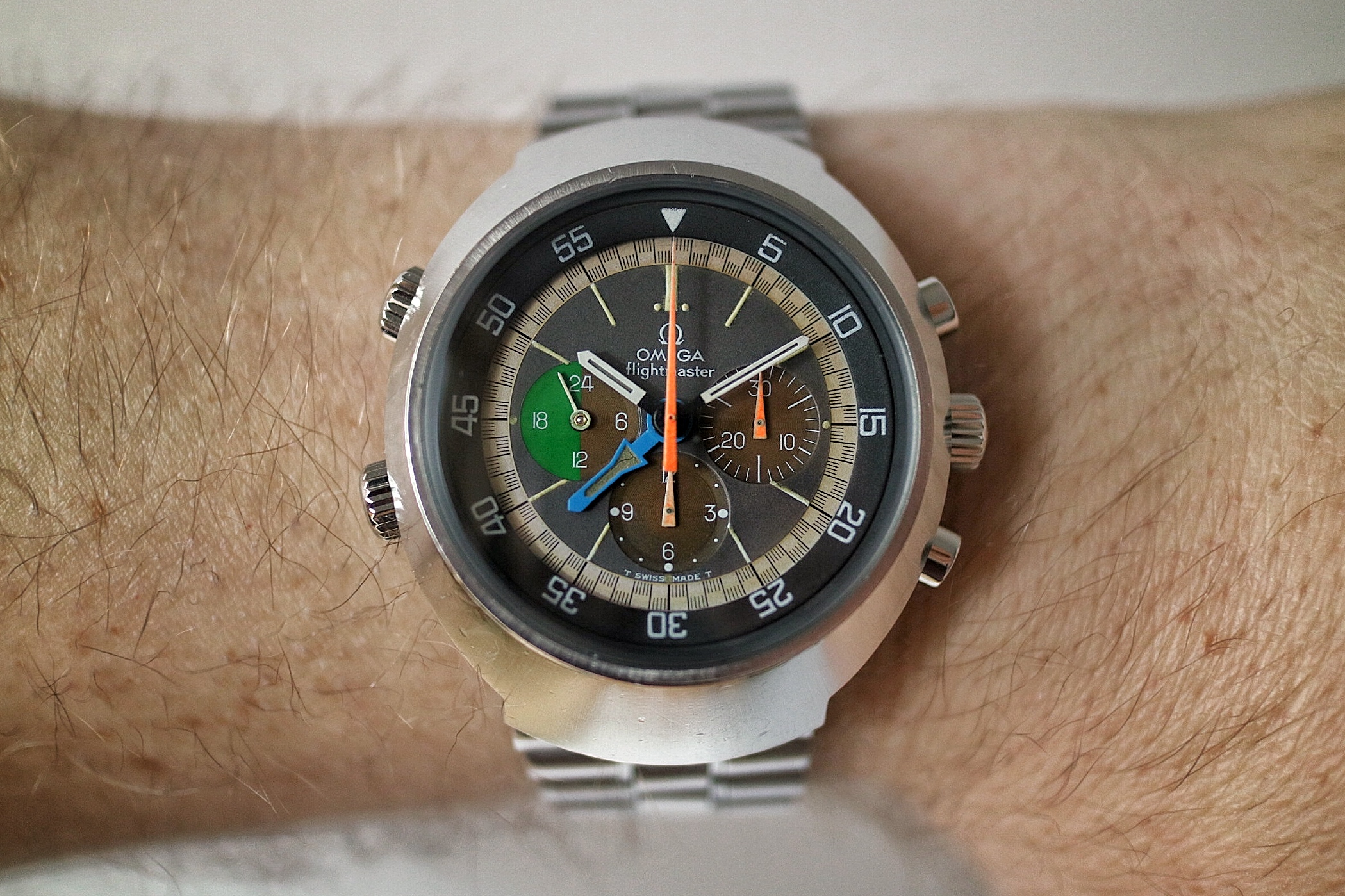

Potentially a dumb question, partly because I'm not so familiar with flightmasters: How do you distinguish a watch that sat in a box for decades, unused, with its original case, from a similar watch with a case that underwent a good refinishing to factory finish (or was replaced with a new but correct case)?
Are there telltale signs you look for, or is it just noticing the perfect quality of the case but comparing it against other things that have marks (scratched up bezel, etc.)? (But in that case, how do you know they didn't just swap the original bezel from an unused but correct watch that wasn't recut with a crappy one so they could use the clean bezel somewhere else)?
Not trying to challenge the description of the watch in question, I am just curious.
8,890
28,370
Not a dumb question at all.
Mostly from years and years of looking at, and handling watches - you just get to learn what鈥檚 genuinely not messed with vs. given a full rework.
To me, the watch for sale looks like it鈥檚 lost some metal vs. the 146.013 that I鈥檓 lucky enough to own, and is original (excluding the pushers).
My one was worn daily for daily for 30 years by one guy. It wasn鈥檛 treated badly, but the graining (which wasn鈥檛 cut deep on the 145.013) has worn, so that in bright light it looks polished.
Anything popping up now with very crisp graining and an immaculate case back, but then a dial and hands, and bezel that show exposure to use/life, to me is suspect. Not bad suspect, just not 100% as it left the factory. Probably. 馃槈
