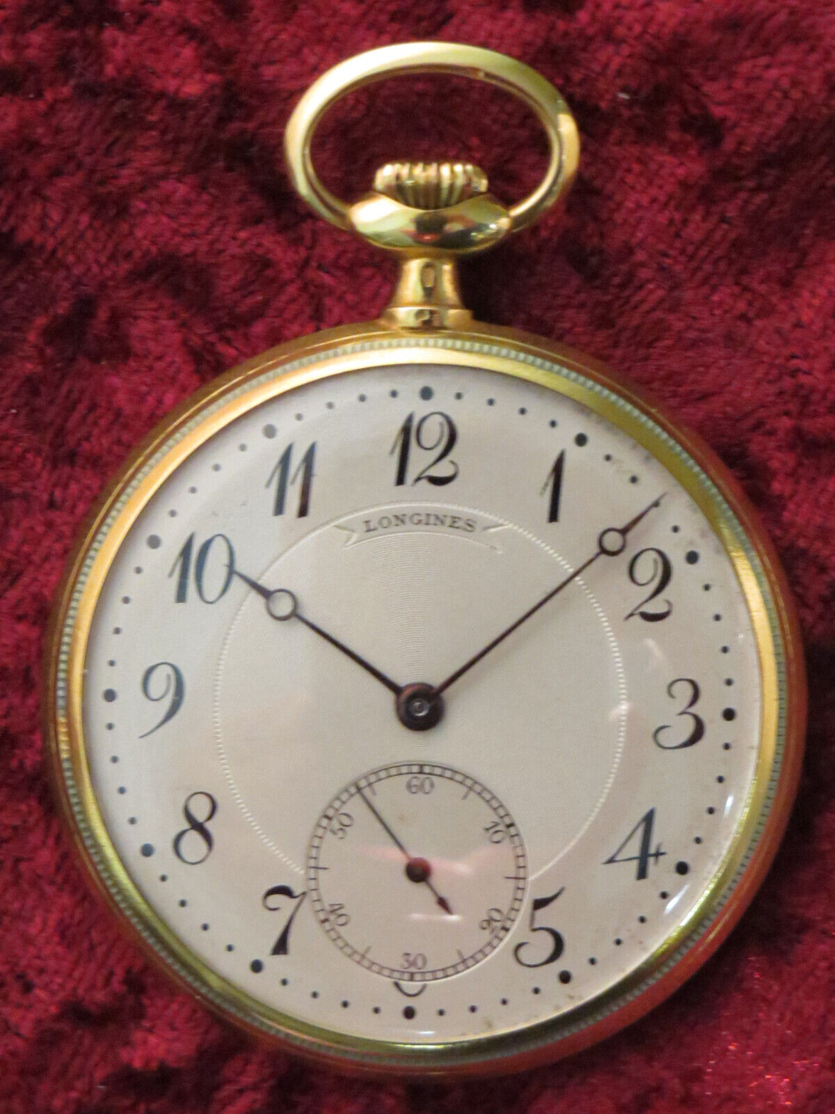

A German told me that a watch I'm looking at was serviced and that the dial was cleaned. I asked in what way it was cleaned and he told me "...just dipped in a silver bath - no other treatment!".
Perhaps it is a strange translational issue. Does somebody understand what he's talking about?

It's a lovely dial. I would like to see some more pictures of that watch.
2,971
6,347
I appreciate your responses. Should I receive it, I will gladly take more photos of the watch.
