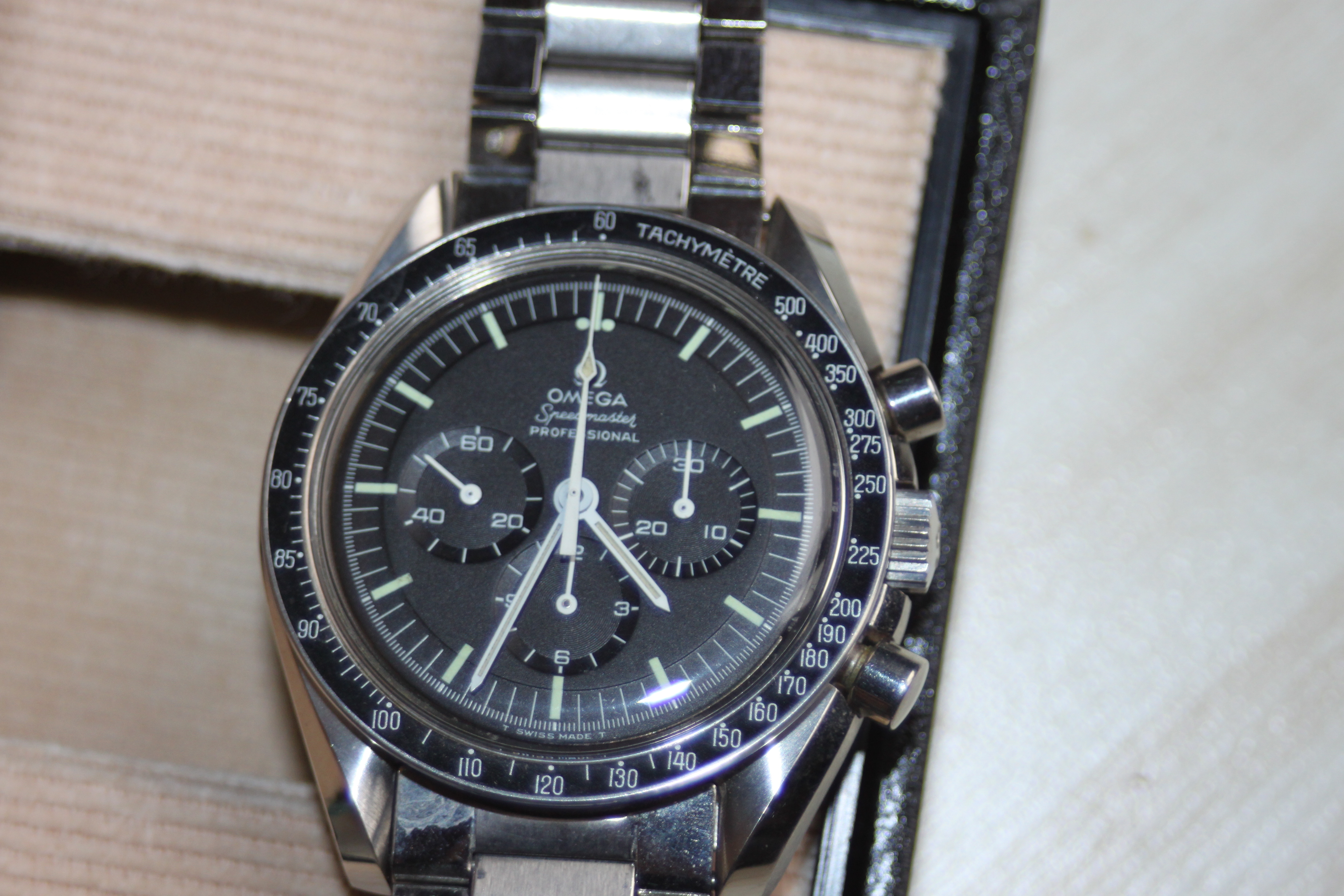

What do you think of this speedy. 1969?

It looks green because... it’s most certainly green 😁
Speedmasters from this era can give yellow or green patina... Although from my understanding, green lume is more common on -71 reference.

Absolutely this. Green, minty lume is commonly seen on -69’s in good condition so from an originality perspective this does not set alarm bells ringing at all.

Okey, just a theory 😀 I´ve seen this with other watches.

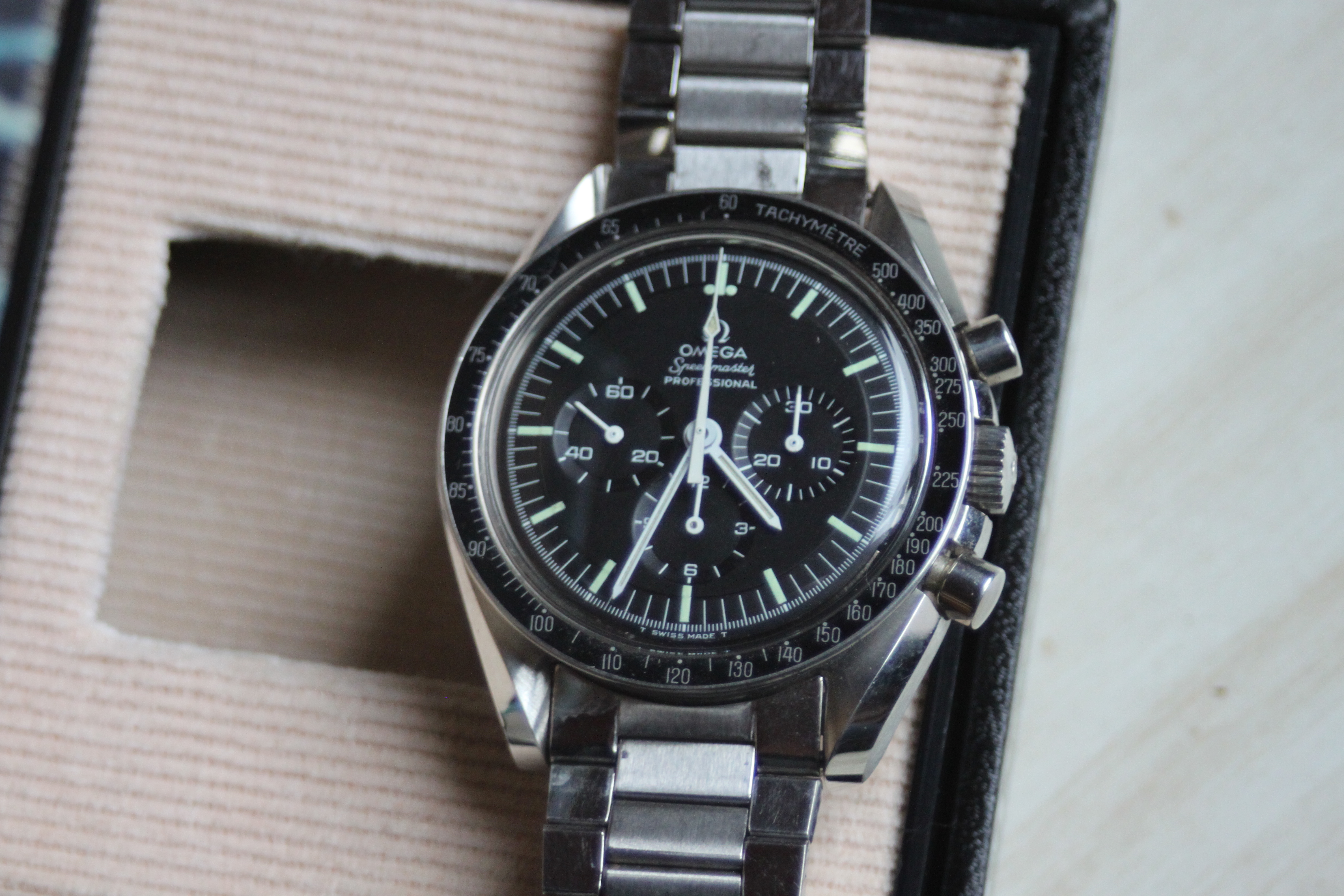

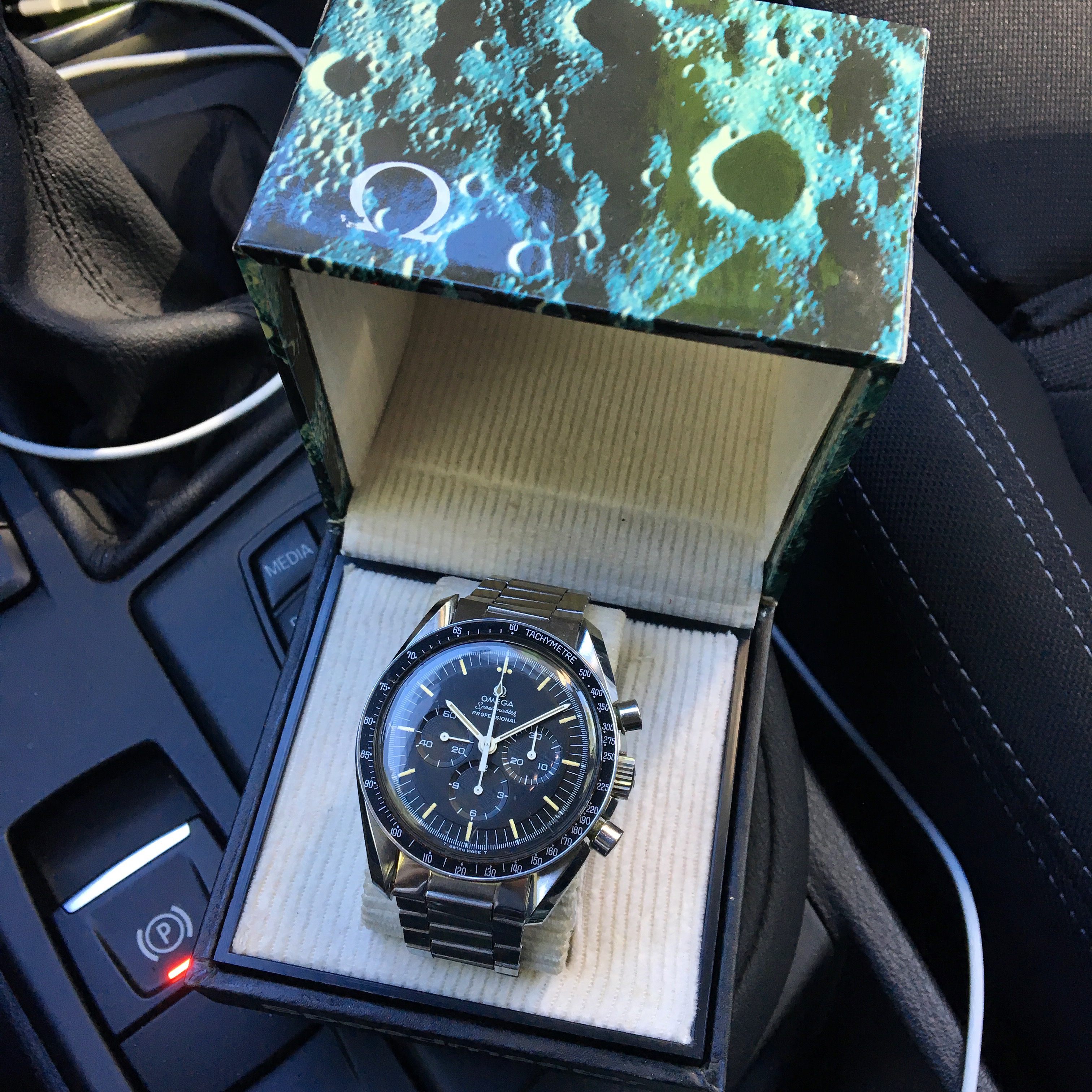

I'll make a few assumptions.... the condition of the box is excellent and although the photos are not ideal, generally, an individual who keeps a watch in a pristine box, in my opinion, isn't wearing the watch often. I would not be surprised if the watch and bracelet are in very good condition, maybe even better, considering the DON bezel insert looks flawless. The head alone could be close to 10K, maybe more-maybe less, and if you add the bracelet and the box, looking near 13k.
I really don't know what I'd do if the watch is as good as I think it might be. The seller is not doing his due diligence and maybe has no clue of the value of the watch. He may be happy to get back what he paid for it in 1969, and would be thrilled to get 7k. And, if he were to put up for sale in an auction, he'd lose 10-20% to sellers' fees.
If it is as pristine as it might be then 7k is a steal... literally.
Obviously need better pictures of the entire watch and the movement and caseback too.

Look, unless the seller is asking around half-market price those photos are just not gonna cut it. No further comments at this time.

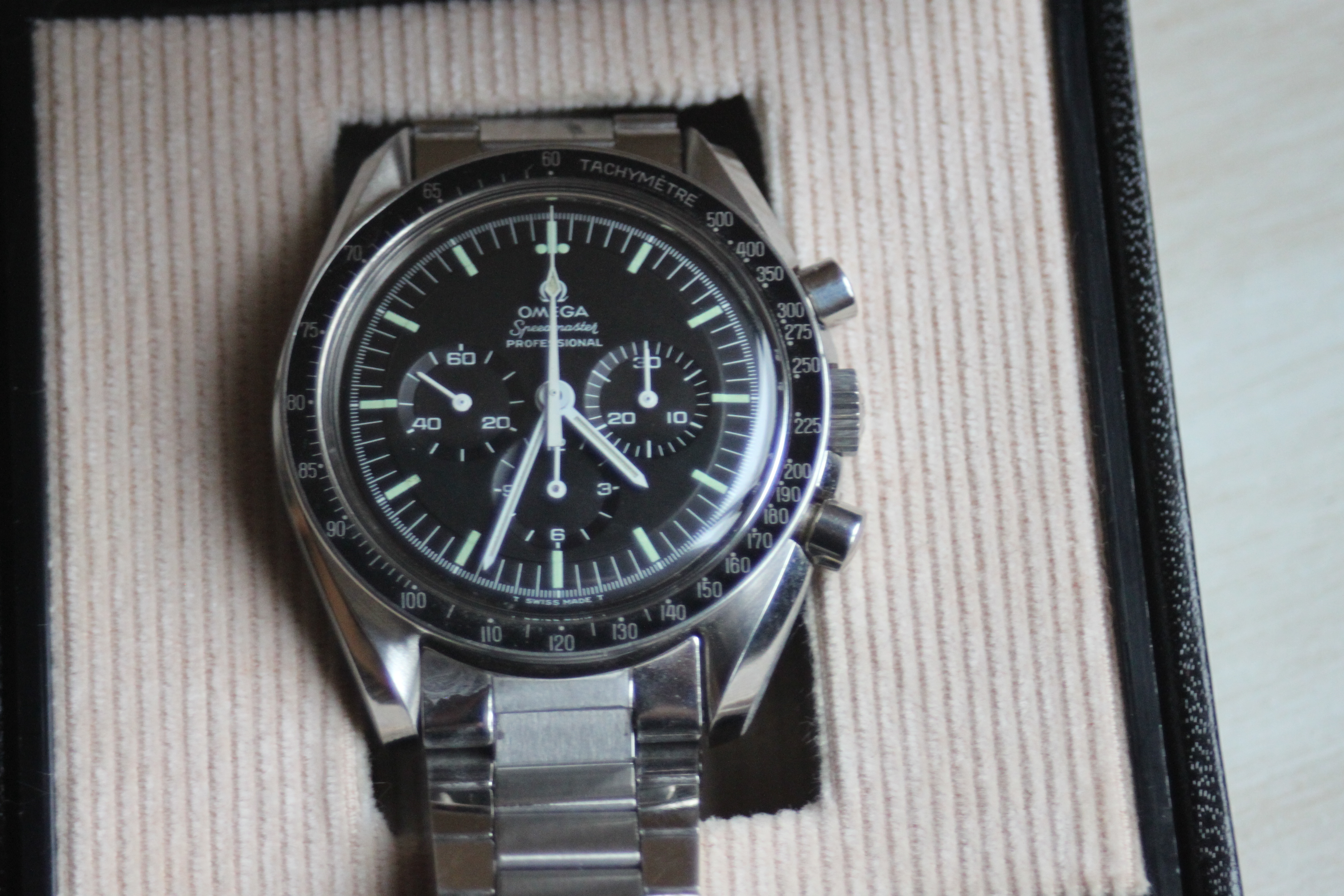

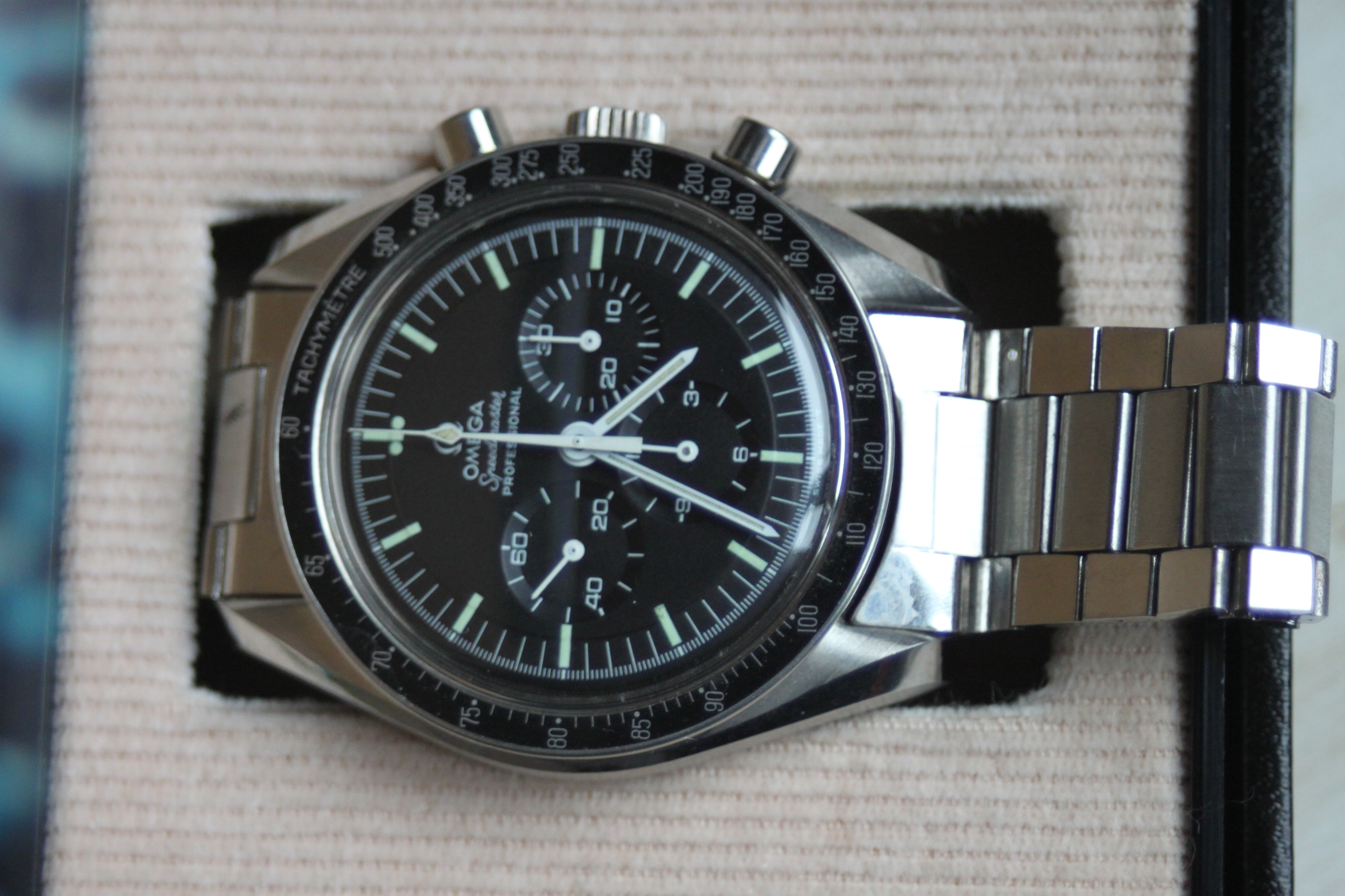

I would guess not--again, the picture's not great, but the hands look tritium. Also: you can see Speedmaster Professional on the dial; that's all correct. The missing thing's whether the Omega symbol's a -69/paint or -68/applied.
the newly posted pictures cleared this question up, but even from the previous pics, one could see the lume plots did not reach the out rim... hence painted logo. (ignoring the rare 321 replacement dials with short markers/applied logo)

looks very clean.
there's a late 69-early '71 batch that have the "well-chewed spearmint gum green" looking lume. not as popular with everyone, but nothing incorrect about.
the hands look very clean, which could set off alarms as replacement, but given the condition of the rest of the watch i think it has been mostly been safeguarded in a "clean, dry place" and all original.
$7k would be a good deal for you, and not outright unfair to a private seller that did no due diligence.
