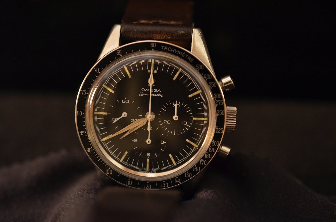

    I'm new to vintage Speedmasters, but I'm already in love with many of the Pre Moon watches.
    Currently I'm on the look out for a 105.002 in good condition and during my search I found this 105.002 watch: http://steinerveiling.nl/en/shop/products/omegaspeedmaster-pre-moon (attached a photo)
    A few of the parts however seems odd and I can't match them with the original ref according to my knowledge.
    1. The bezel has long 2/3 width markings and not 1/2 as I would think.
    2. The seconds dial has a spear tip, but the other end is not drop-shaped.
    3. The minutes and the hour dials should be indicated by straight, white, luminous hands. They are not.
    I hope you can enlighten me. I've probably missed something, but I would love to know what to look for when determining the authenticity of a 105.002.
    Thanks in advance.
    Kind regards,
    Mikkel

    Many things incorrect on this example; bezel and second hand are wrong, hour and minute hands look like modern replacement, lume on the dial has been cleaned, and maybe more...
    Take a look here: http://www.speedmaster101.com/105-002/
    tigerdyr likes this.

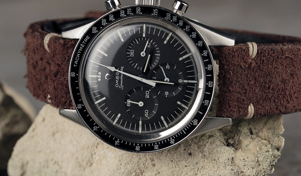

    Here is one that is correct. Welcome.

    how the fuck can such an official watch shop // jewelry store sell incorrect watches...

    This use to be a 105.012 (or so it is advertised as such). So what is it worth now?

    Stay away.
    You are now enlightened.

    Well, it does have a nice case and the correct movement for that model.
