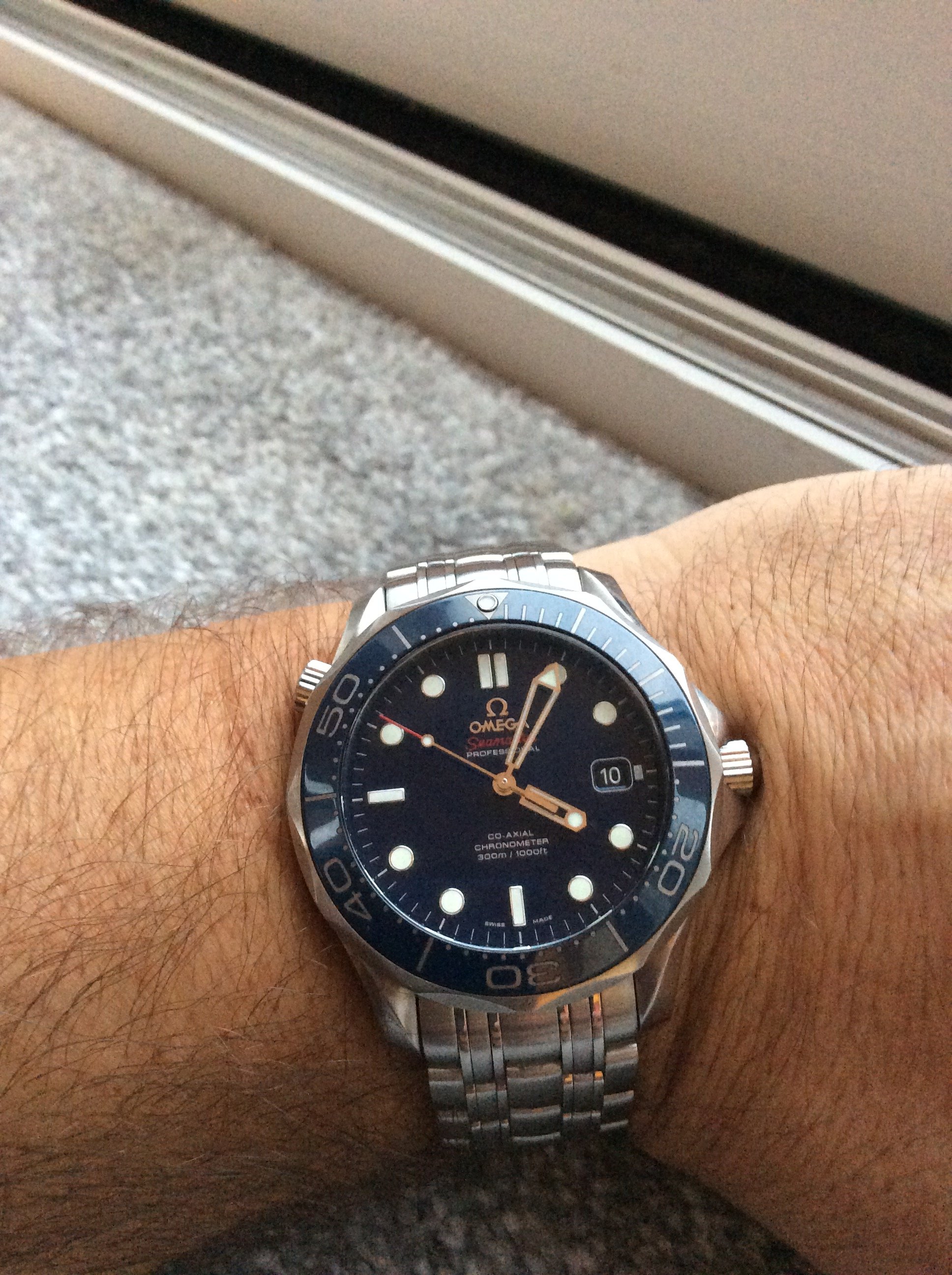

What do you think. Does it look fake

lots of grey market dealers don’t fill out the serial number and date areas, so that isn’t an obvious sign of anything. Post a picture of the card, and we can help identify if it is real or not.
I’ll post pics of the card when I get home

Let me rephrase that the serial number is not on the card anywhere. There’s no place for a serial number. There’s a reference number and then it just says Sterling jewelers
The watch so far looks legit. The warranty card came from Jared Jewelers (Sterling Jewelers) and they are notorious for not filing out warranty cards completely. I had a warranty issue on a Seamaster Pro ceramic chronograph I bought at Jared in May 2015, and the Omega Boutique made Jared send them a copy of the receipt because they didn't trust the warranty card that I had to finish filling out myself after I bought it (I still have that watch). The model number should at least match the watch model - share pics if you can.
I would NOT want to open it and ruin the water resistance unless the jeweler can do a pressure test afterwards, but you may void any remaining warranty if you open it up. And, a bad jeweler could mess something up inside when he opens it. I only trust my watches to a trained watchmaker.
If we had well lit multiple pictures of the contours of the case back and of the back of all the lugs including the serial number and all engravings on the case back, we could see some of the tells on the hippocampus logo and serial number, if it's fake. Also, a well lit closeup of the dial would help, as well as a straight on photo of the watch from the front.
Also, test the lume by swing a flashlight on the dial for 20-30 seconds - It should glow brightly at first, like it was electrified, and then fade slowly but still be readable in the middle of the night when your eyes are adjusted to the dark, all the way until sunrise. If the glow isn't super bright and fades after 1-2 minutes and then is hard to read in the middle of the night, that's a bad sign. The fakes have the green and blue lume like the real thing, but the dot will look less vivid white (more grey) or the lume isn't very good - I have seen some where the lume never jumps out at you like the real deal after being hit with a bright light.
PS: If the serial number is full of 8's 9's 6's and 2's that's a bad sign.

What is the serial number on the watch...if you want you can send it via PM...

It’s on the back of the bottom left lug super tiny. Looks like it’s laser etched.

Serial number: 89045846
Article ref: 21230412003001
Version of movement: 2500D
Is this the reference on the card? I'm not seeing anything here that would indicate it's a fake...

The warranty card has the movement 2500D that same reference but the serial number is not on the card. Only the back of the watch.

Reference number...not serial number...

Then it says caliber 2500d on the card that says pictograms

It appears the stars aligned in your favor. I was feeling good about your watch from your description of the movement feel, but now you've got some confirmation that the SN exists and matches the watch.

Yea I feel a lot better.
My main issue is that I have been told that no one should ever open it unless they are certified by Omega, I don’t know why that is, My guess is it voids the warranty or something, and right now my problem is finding one open, who will do it. For instance I’ve been told not to bring it to a watch repair place or a jeweler unless they are certified by Omega.
But since the serial number matches I feel like I can wait until I can get an AD to open it
