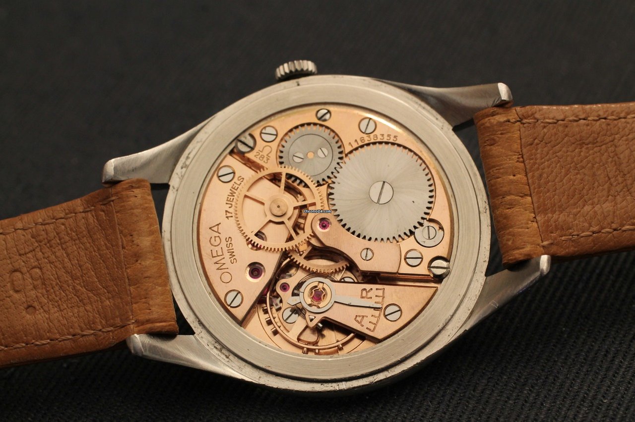

Yes, cal. 30 SC T2 and cal. 283 are different. According to AJTT, cal. 283 is 30 SC T3 PC AM 17 p and was created in 1949. OVD states that CK 2506 was introduced to the international collection in 1946 so watches prior to 1949 must have used a different caliber. I have a CK 2504 (35mm case) with cal. 280 (30 SC T2 PC AM 17 p created in 1941) and Extract confirming a 1949 production date. It seems reasonable that an early CK 2506 might have a cal. 30 SC T2 or cal. 280 even though that info is absent from OVD.

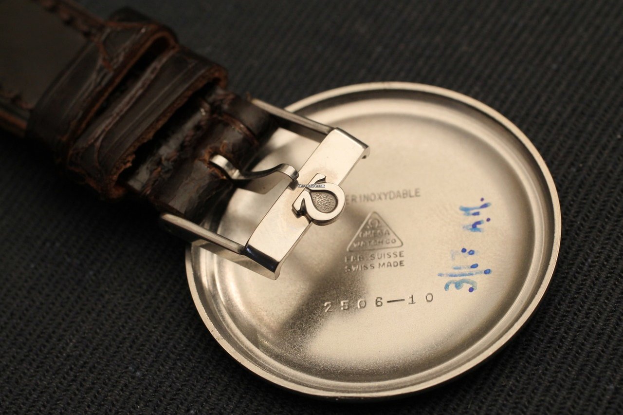

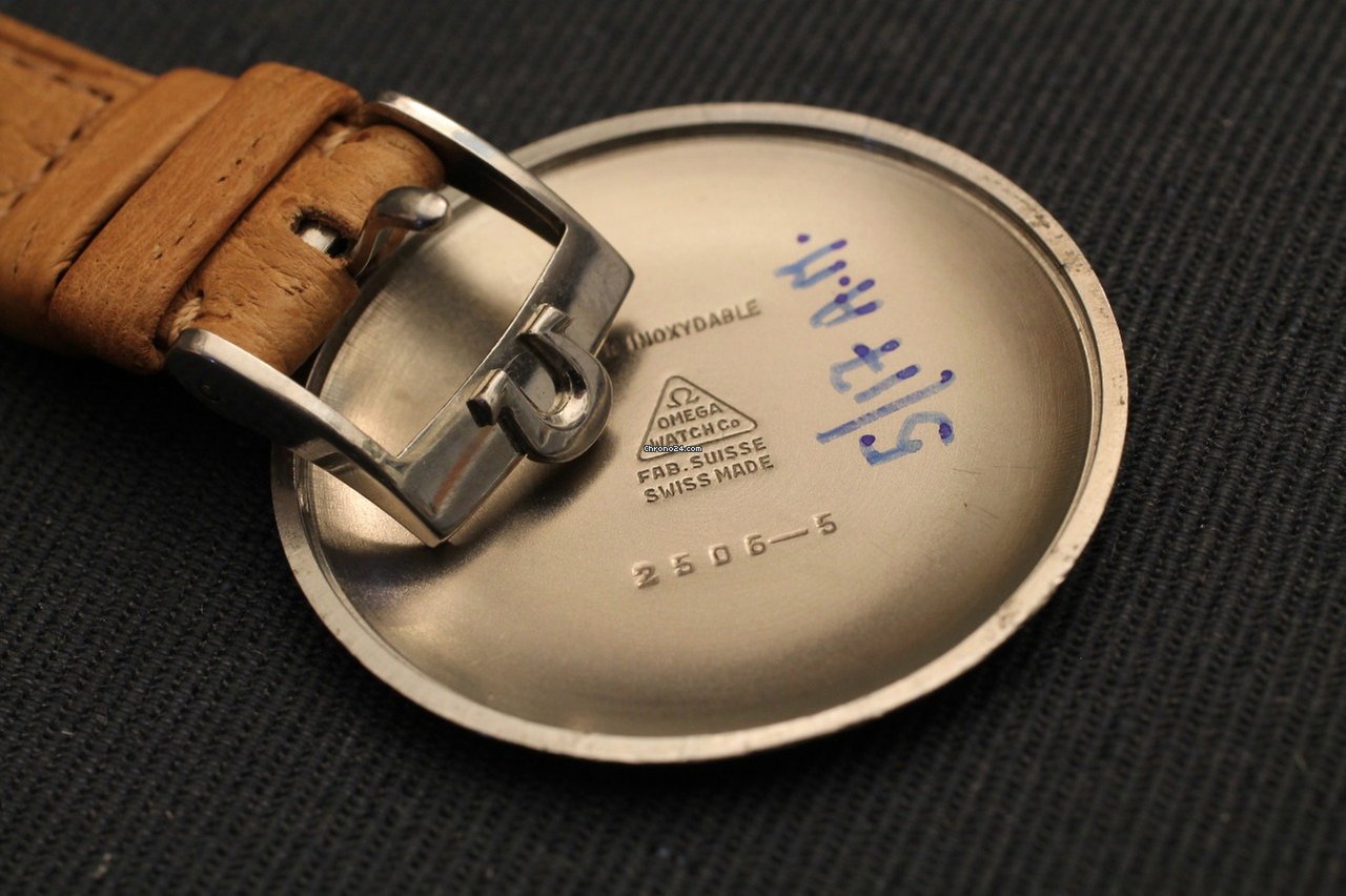

... I have a 2506 from 1943 with a 30T2 SC caliber and one from 1949 with a 283 caliber...
... according to the Omega museum the caliber 30T2 SC was once ticking in a 2292 and around 1951/1952 was recased in a 2506...

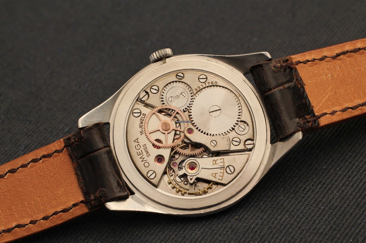

76,099
055CK2506 | STEEL CASE CAL.283
