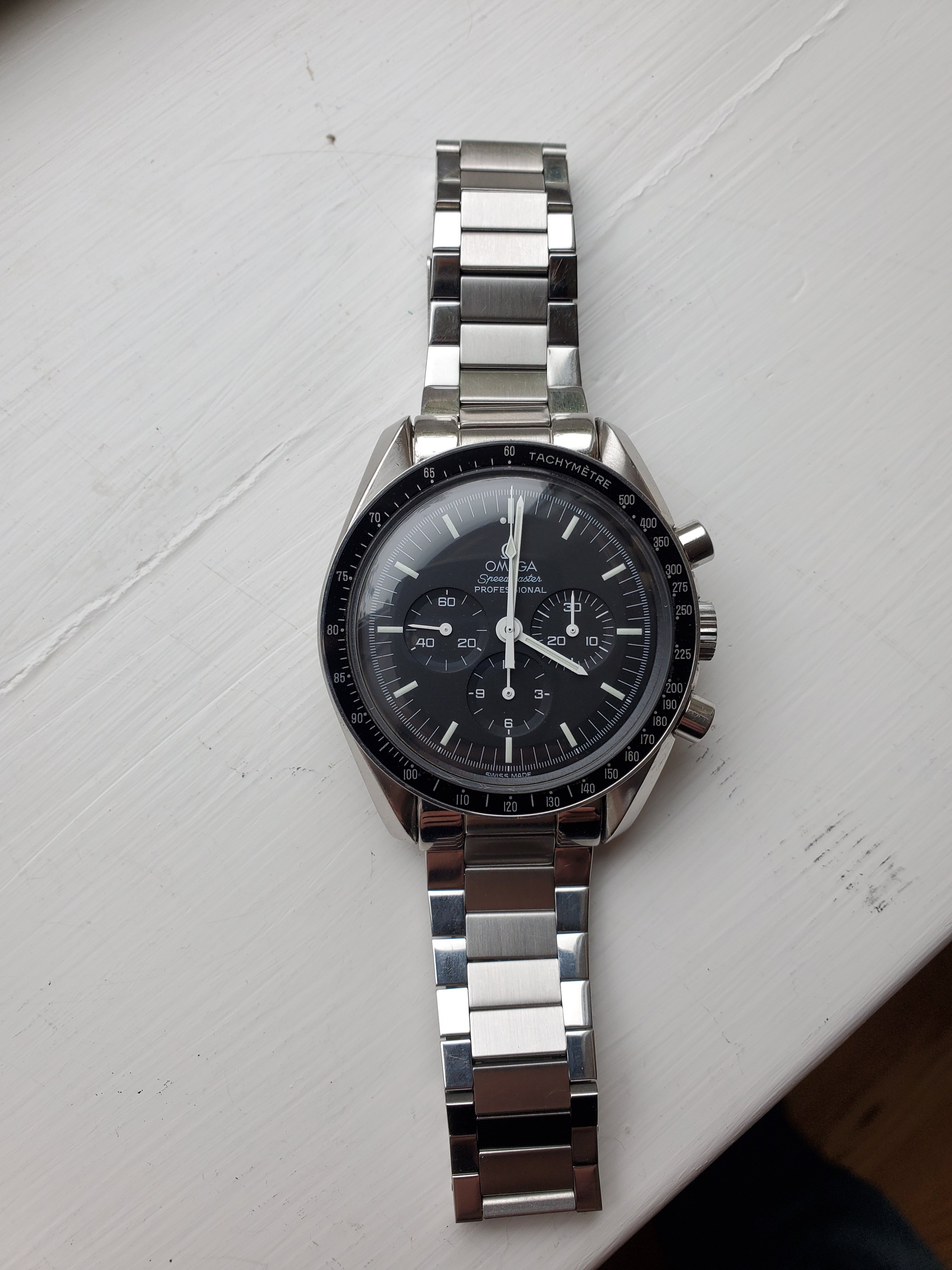

I have a 69 with 305968xx serial number and it has a DN90 bezel
Any chance it’s a 220 error bezel? Post a photo maybe

It is not the 220 error. I will post pics

My bezel is TACHYMETRE with the accent and DNN

Pics of the watch. The dial, hands and crown were replaced by Omega but I still have them (I will put the original dial back in)
