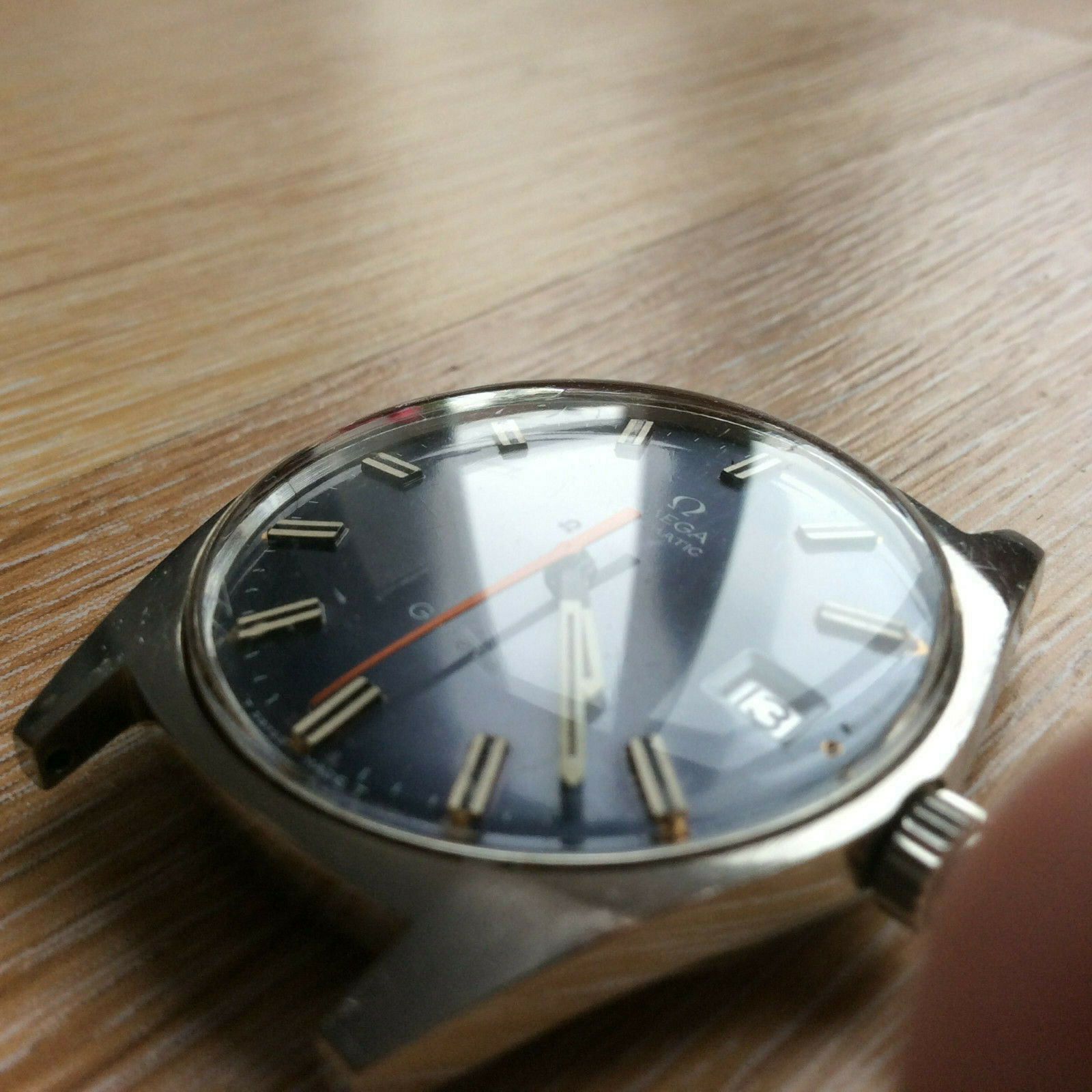

Hello there folks !
Was looking at this offer.

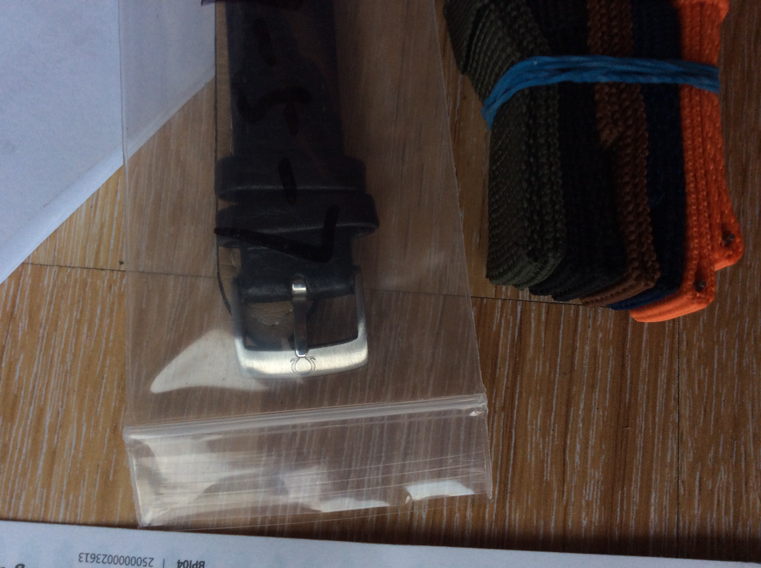

Does this watch looks genuine ? Seller said watch was serviced during August 2019 by COSYNS (Brussels) and he will join bill or "service certificate".
But for now there isn't any proof (opened case or paper) about authenticity.
Other strange thing, he offers straps with watch (to apologize about "delay")
Any ideas ?
Thank you 😉

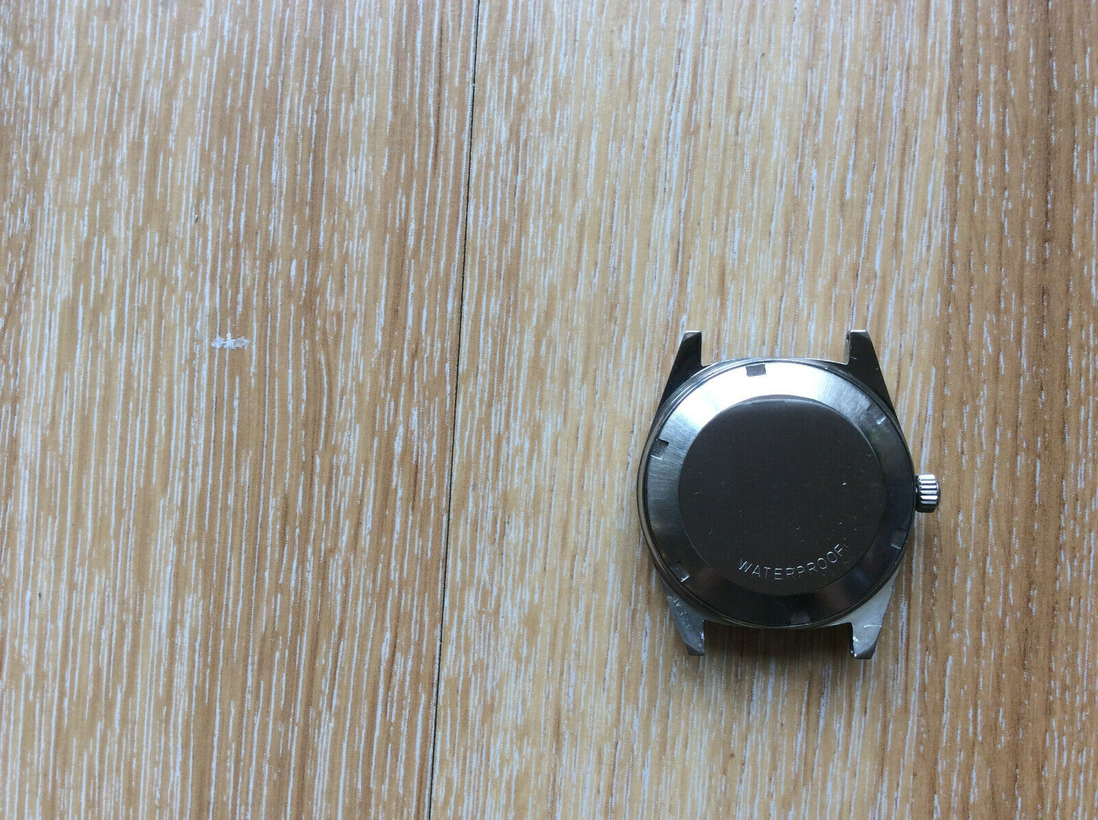

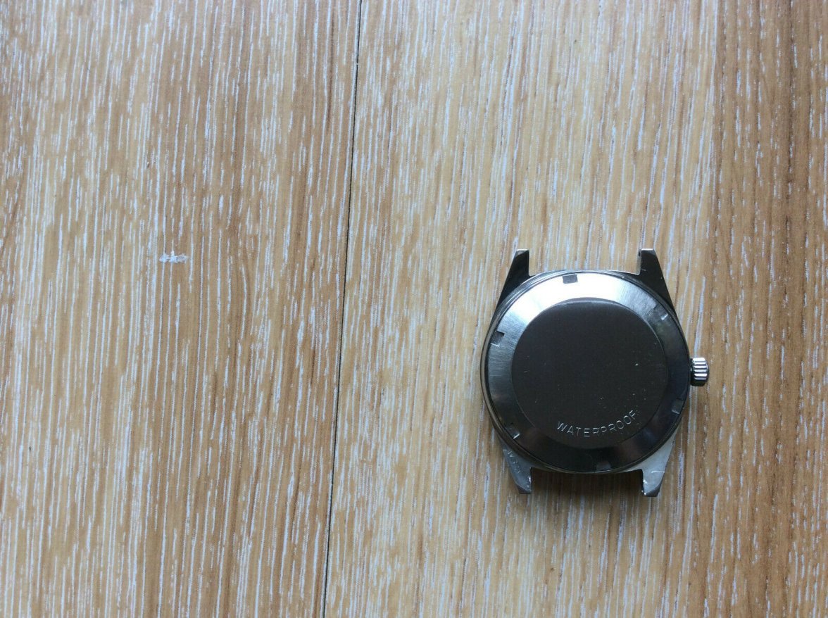

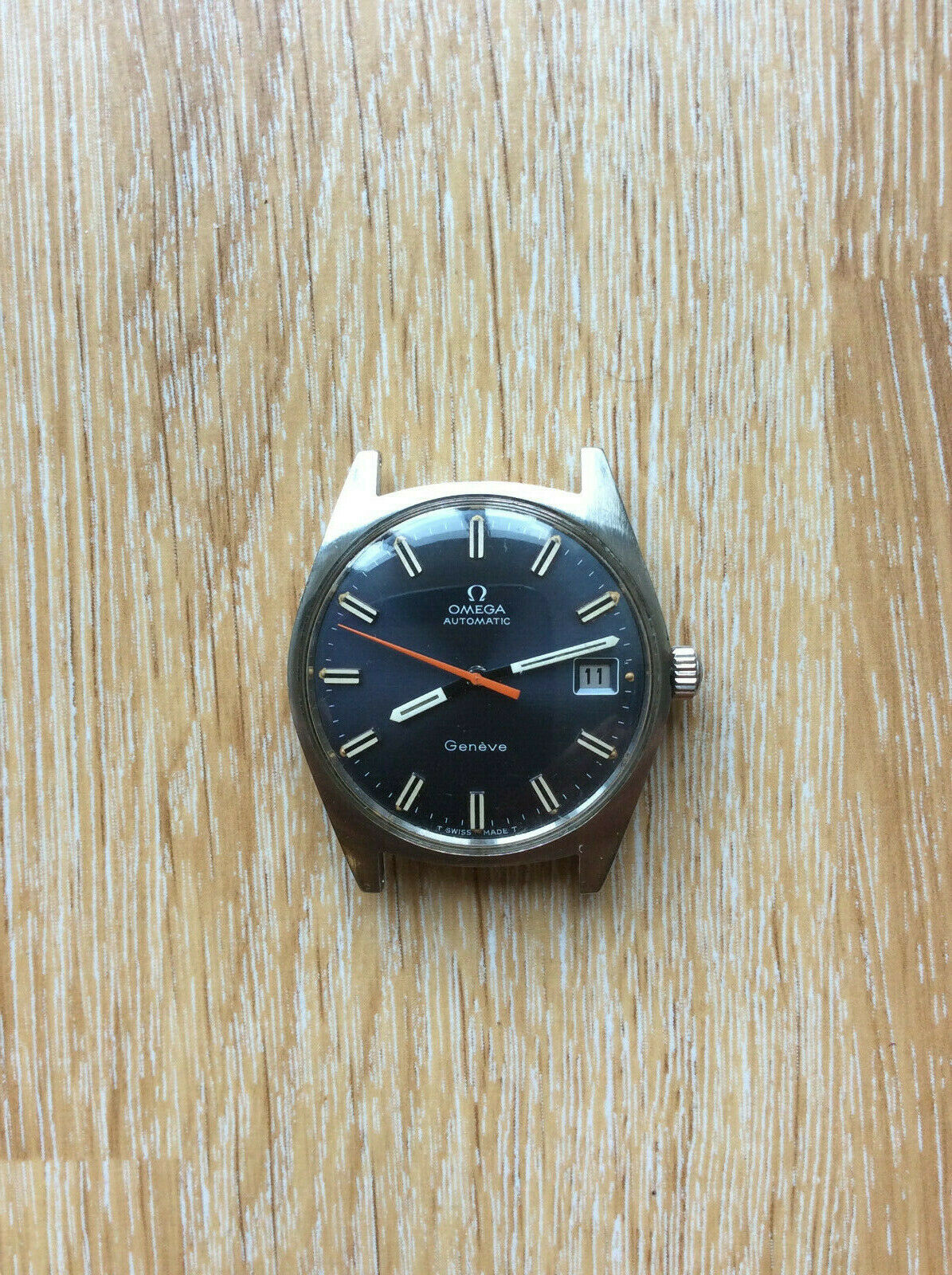

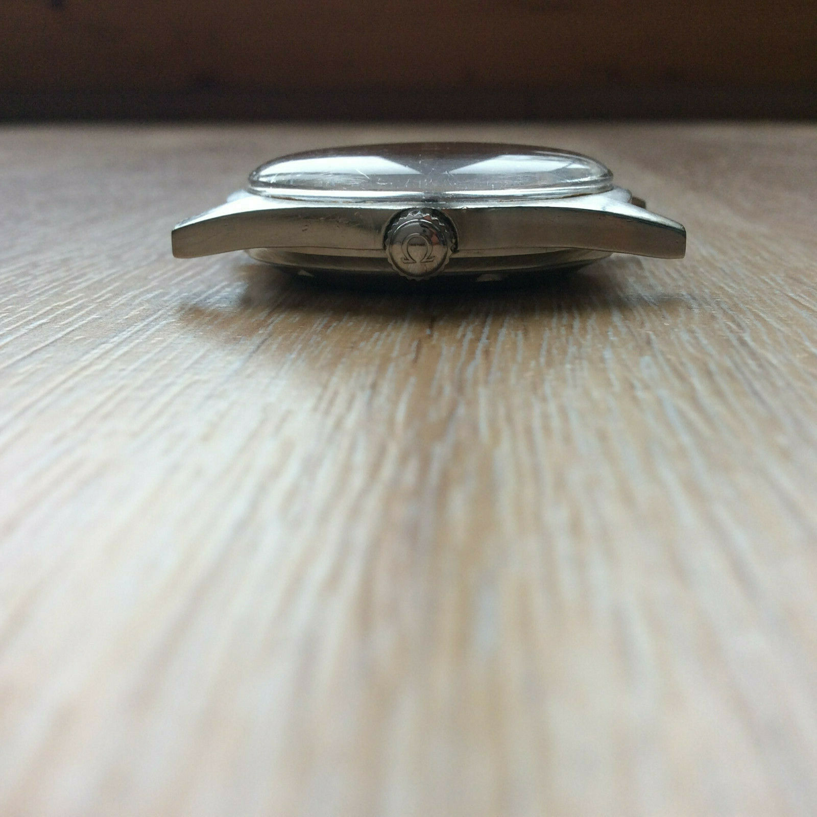

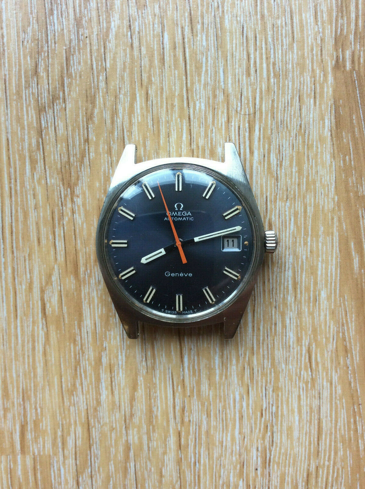

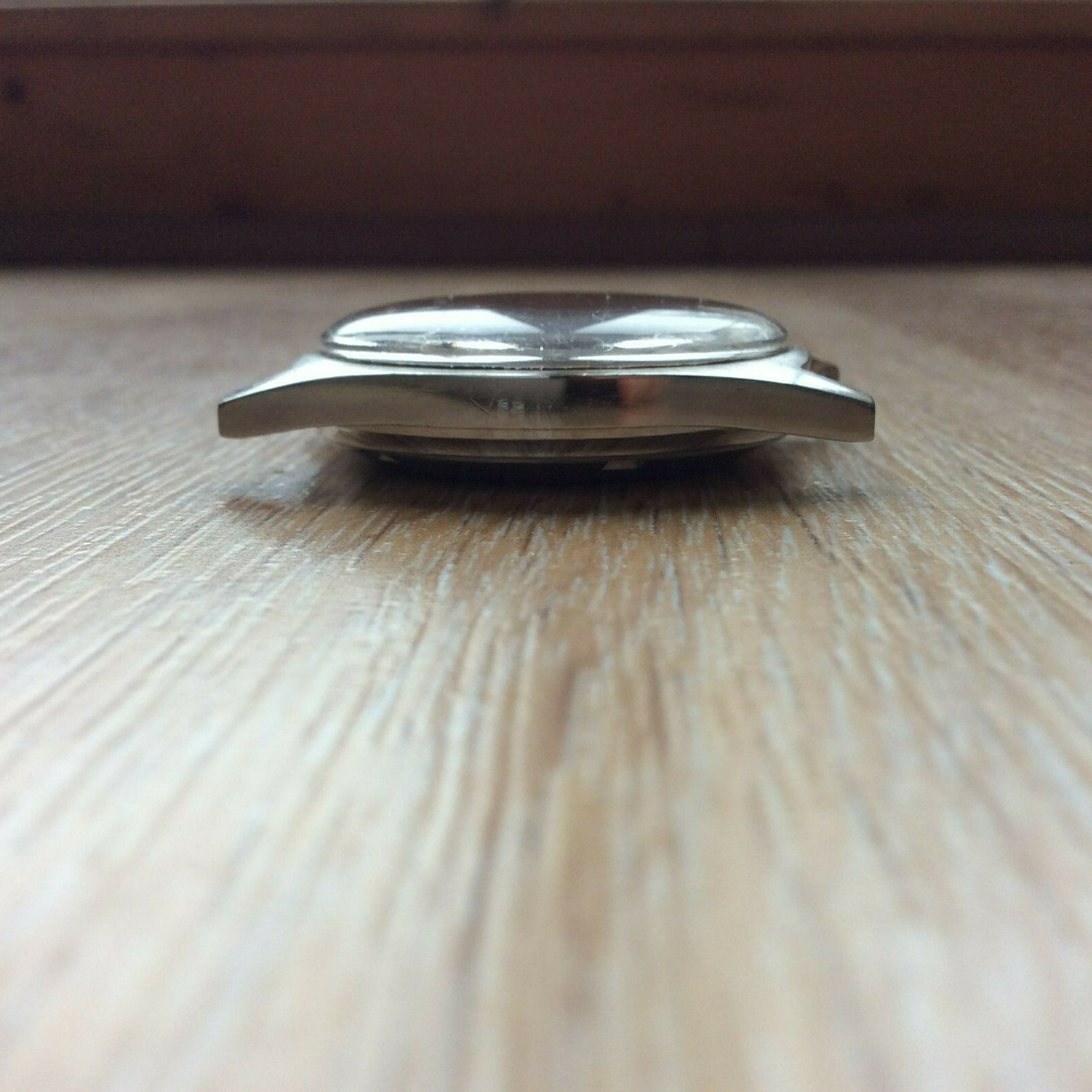

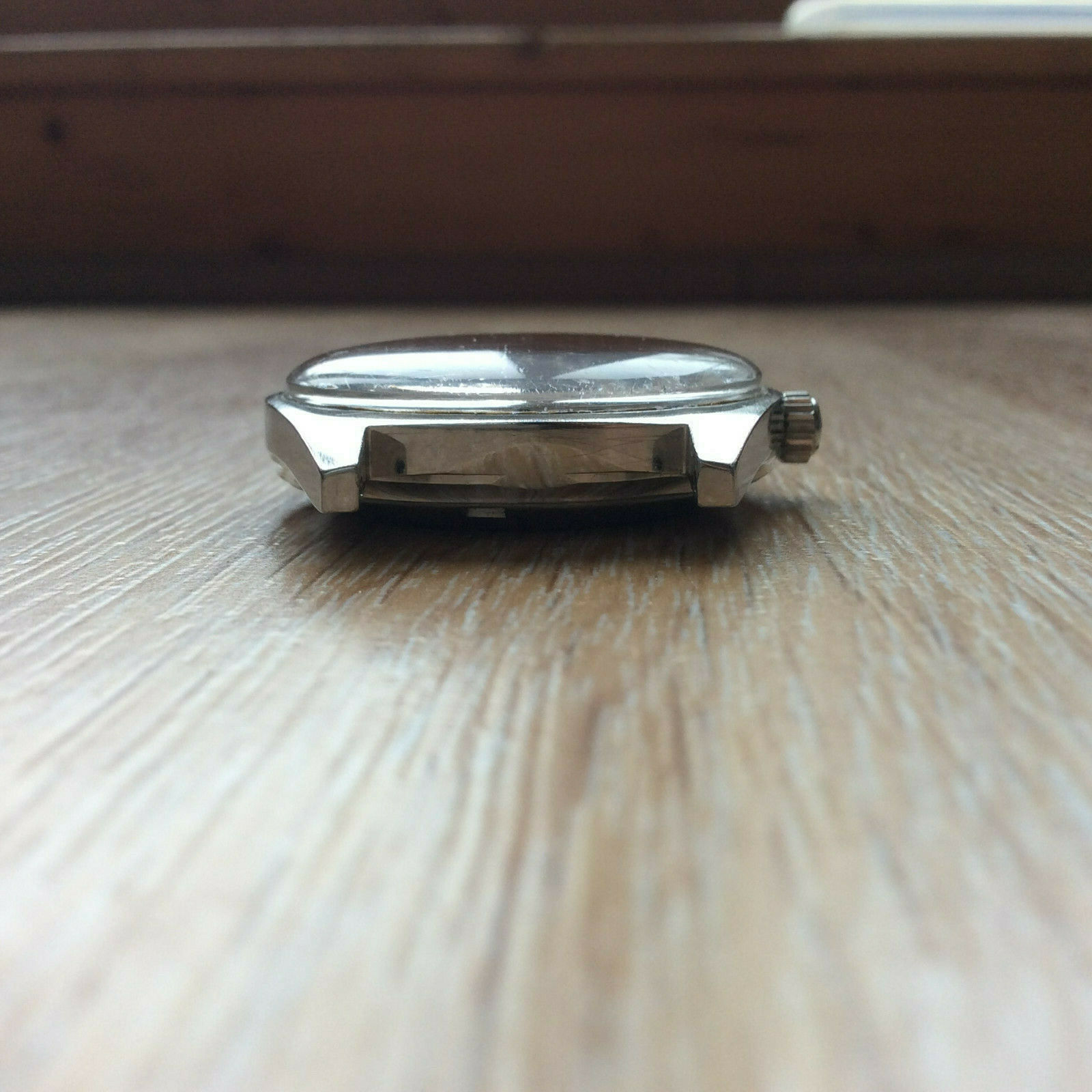

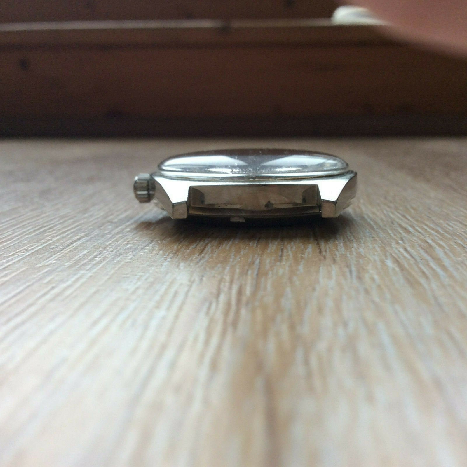

Thanks ! You're right !
I corrected post adding photos.

Others are better equipped than I am to give you expert input on this watch but my view is:
* that the hands are for a chronostop or a dynamic but incorrect for your 166.041,
* the lume has been horribly misapplied to the dial, which leads me to speculate
* that the dial is a redial.
* the case, watchback, crown and crystal look okay.
It would have been good to see the movement and serial number. Personally, I’m a fan of the 565 movement.
13,495
31,815
Hands are correct for this blue dial version of this reference, lume is fine, some discoloration around the lume on these blue dials is quite common.
Overall it appears to be in nice original condition.
