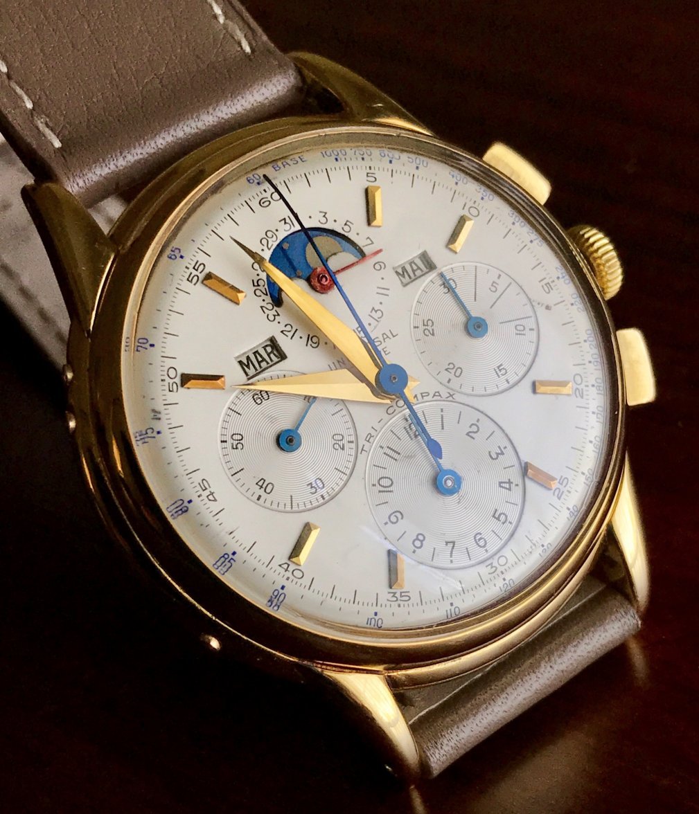

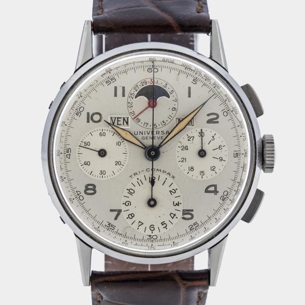

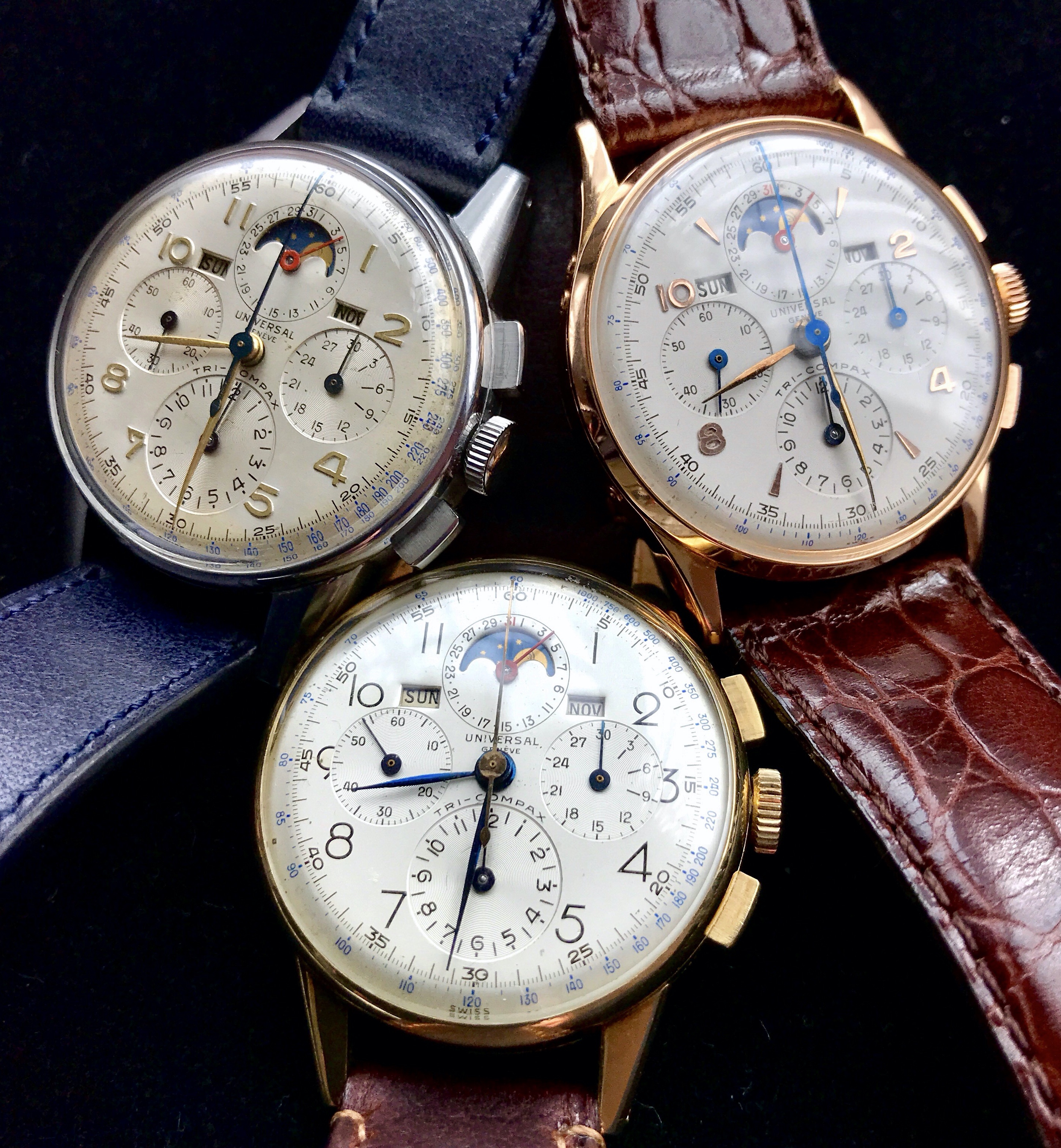

What are correct hands for a Tri-Compax Moonphase (cal 287) 1940's
344
435
I commonly see either the thin, sword style (usually gold) or the fat, plongeur style. Which would be correct?
Presumably, for the 1940s, these would be pre-tritium lume? Perhaps radium?

I imagine it depends on the dial, since some have lume and some don't. There might even be more styles.
1,668
8,397
We can wait on some of those more in the know, but I think that Dan is correct-dials with lume seemed to generally have hands with lume and a dial with no lume should generally have hands with no lume. Here are a couple examples of the latter.

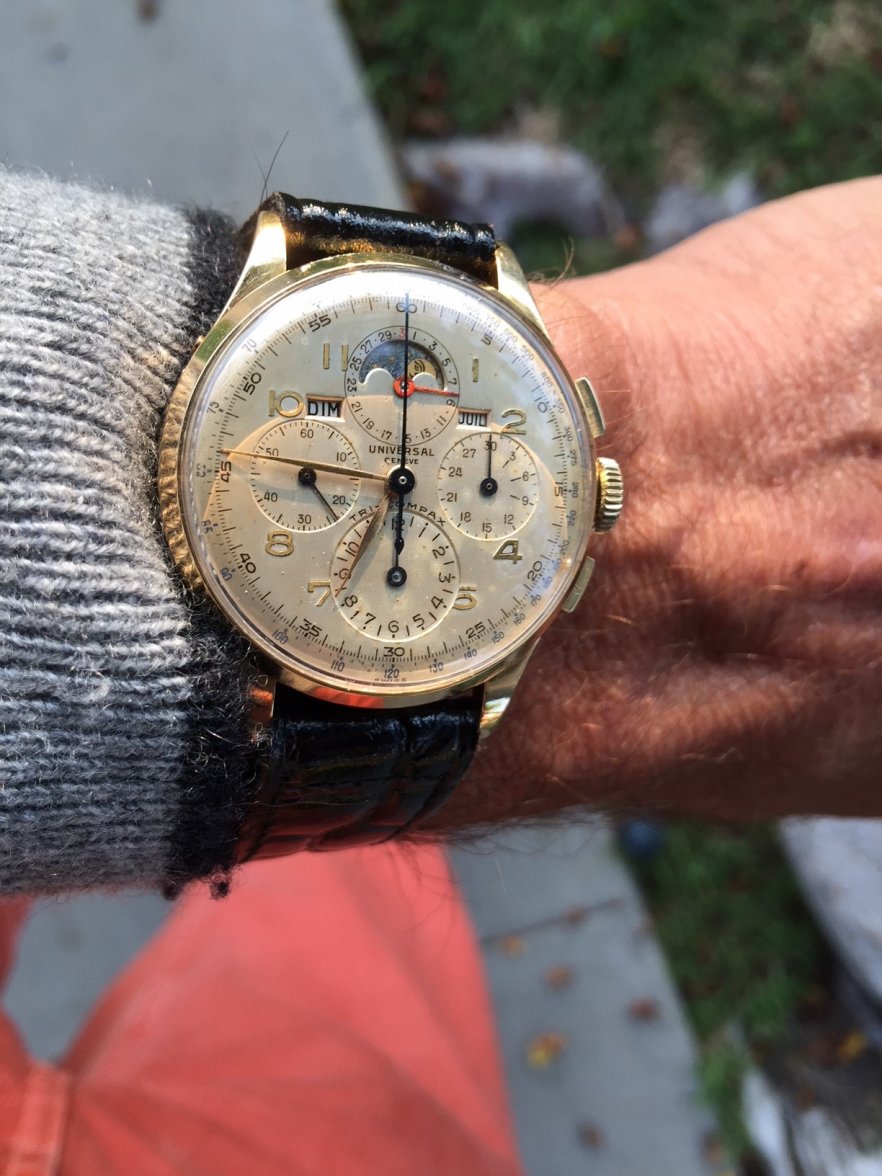

Curiously, I have not come across dials with lume pips. Perhaps I need to look longer, and perhaps they’ve just fallen off and been removed.
Also dials don’t seem to show radium burn, which makes me wonder what the lume material is on these plongeur hands.

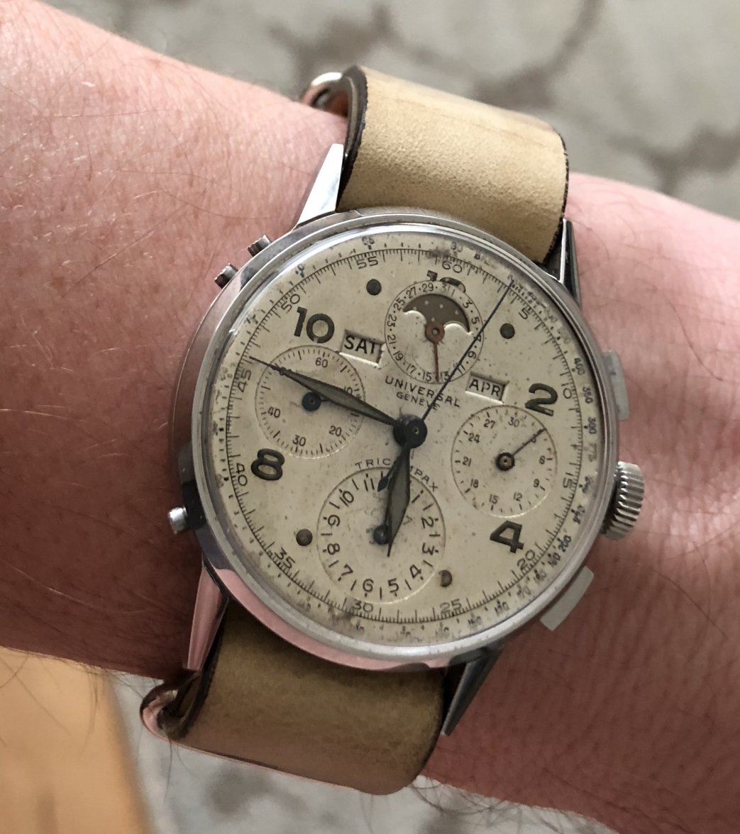

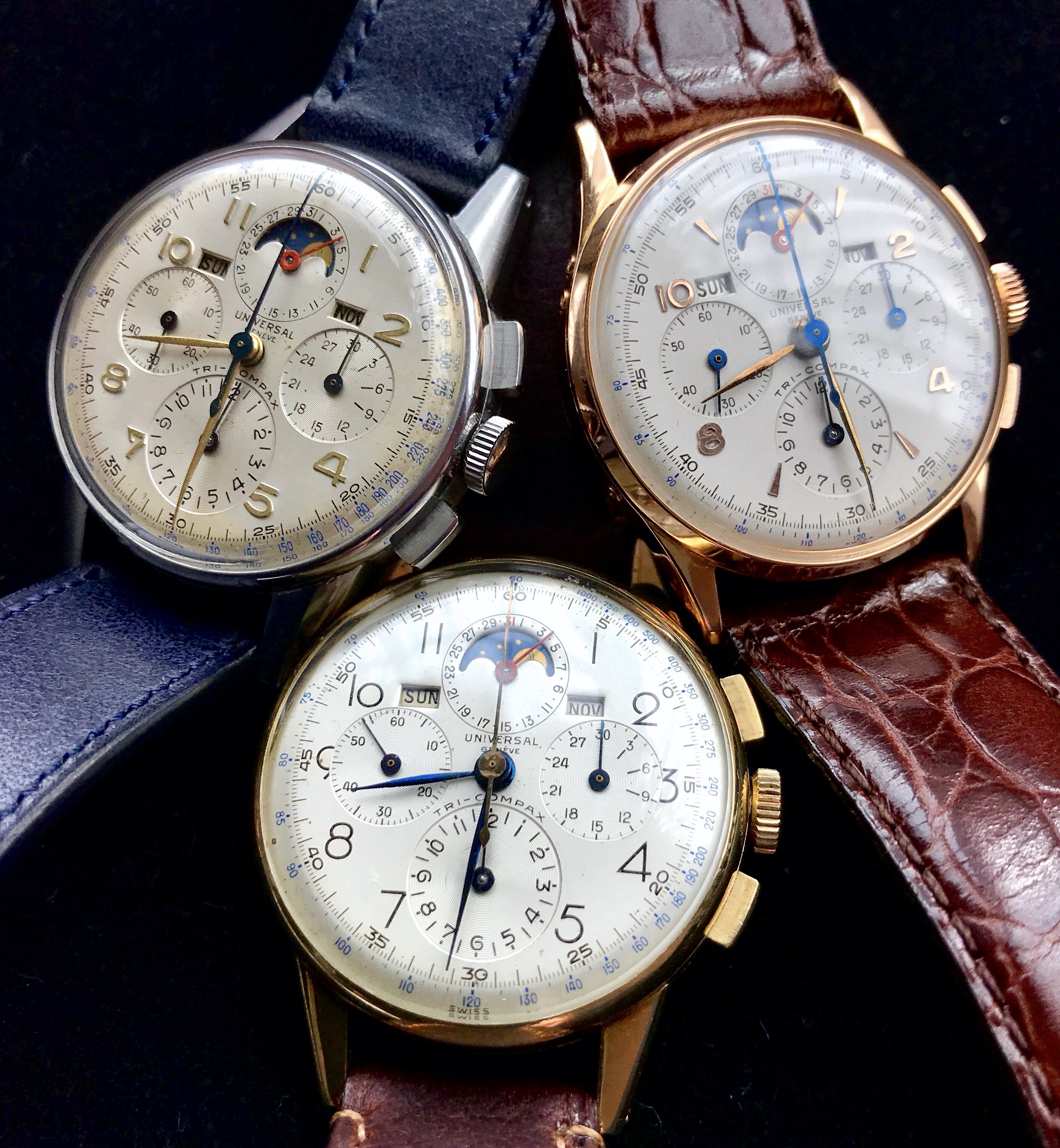

My ex watch with ex hands like OP pic one
Oh now this ones interesting. That green looks like radium. Did you ever take a giger counter to this? After ~80(?) years of radiation exposure, wouldn’t the dial be more toasty looking?

The dial lume is often on the numerals. Some numerals are lumed, some are painted. You need to look closely at good photos.

Ah, I’m seeing what you’re talking about now. I mistook many for paint, or even refinish. But you’re right - they have that green-black moldy hue.

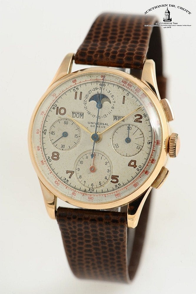

Lumed hands = Lumed dial indices... always. Sometimes the dial can be painted not lumed. Then non lumed hands are ok.
3,666
8,469
There are many possible types of dial and hand combinations, it's one of the cool things about UG ! Also makes it frustrating to try and catagorize definitively.
Better to look at individual examples, rather than generalizations.
The lume for the types of examples being shared in this thread so far is radium, and yes they def register on a meter.
One thing that I find interesting is the range of possible aging on the dial lume vs hand lume often seems quite varied, and more often than not, they don't match.
That very first pic in this thread is good example, offhand that looks to be original radium on the dial and hands.
I did - it was off the charts - I sold the watch!
