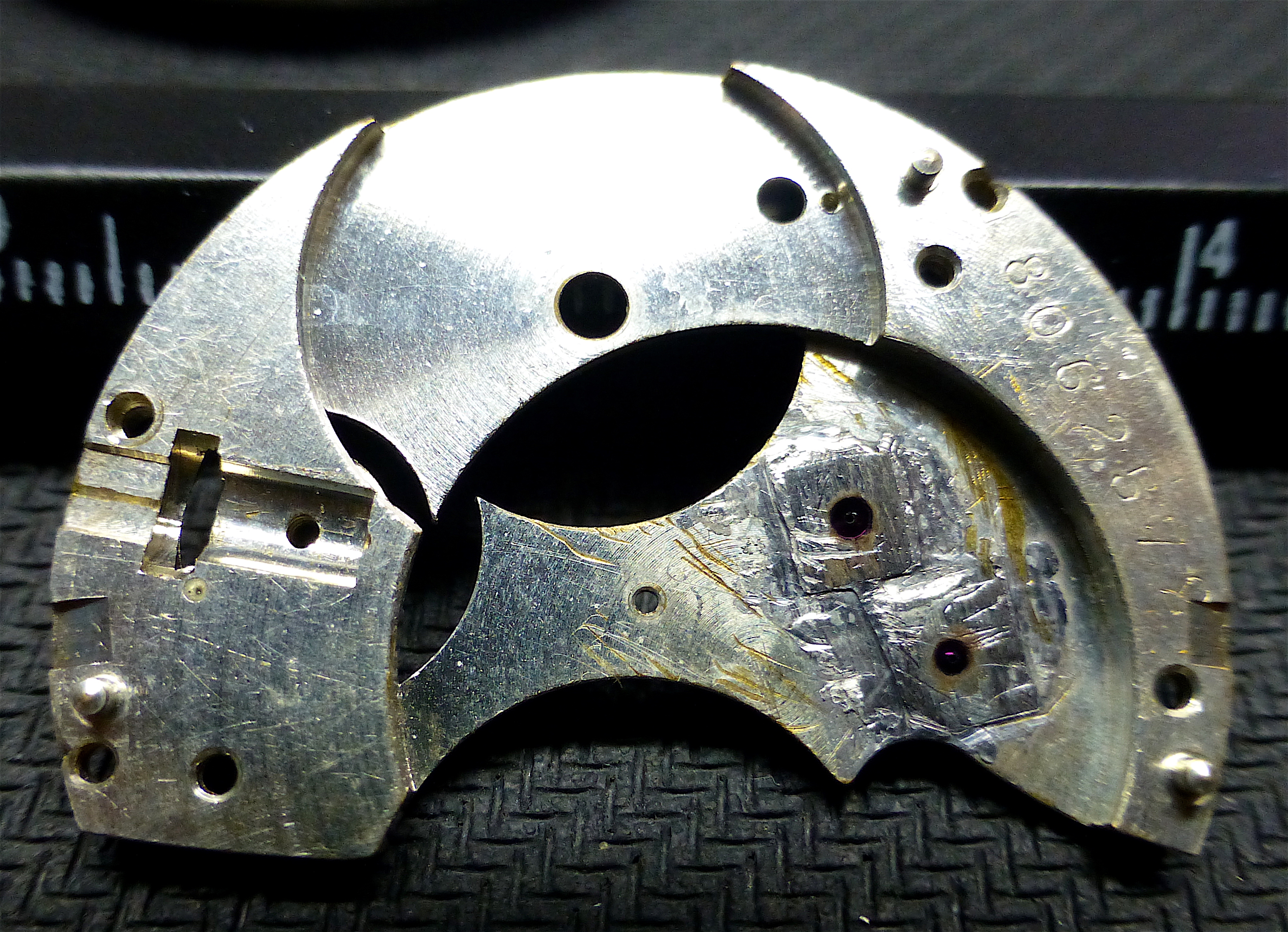

I'm sure @Archer and @Horlogerie would shudder if this ever came into their workshop.
"Sure, it needs two new jewels, let's see what I can do for you, pick it up next week."
2,203
2,057
It's that why they call them Mumbai special? I've seen flywheels with 300k miles on them in better shape...
