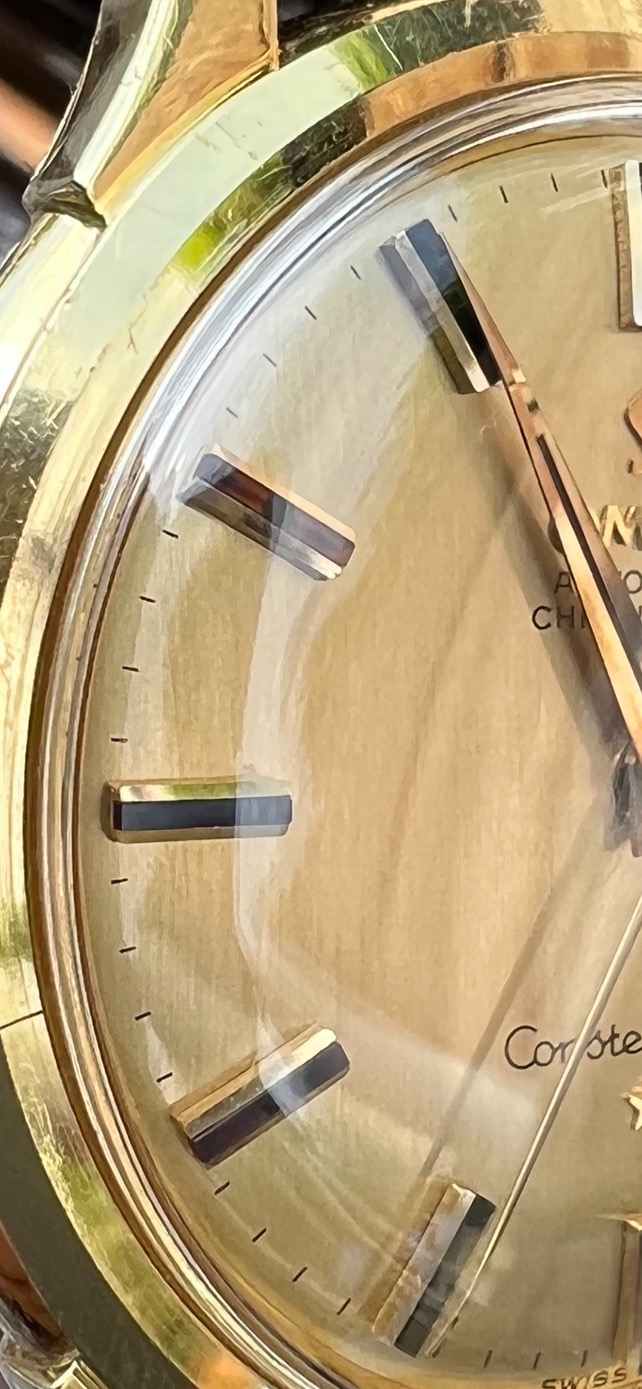

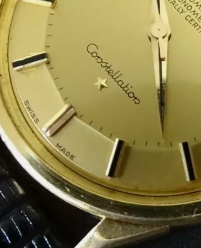

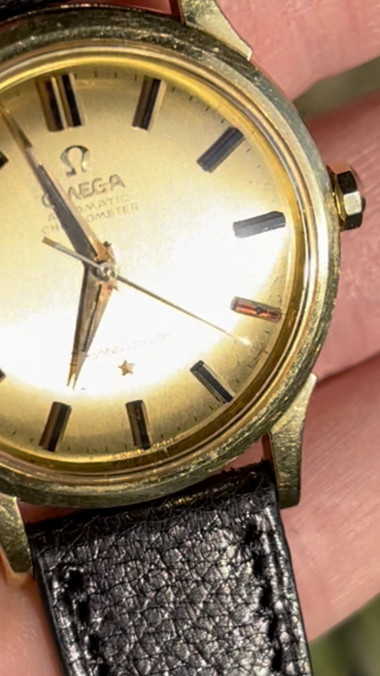

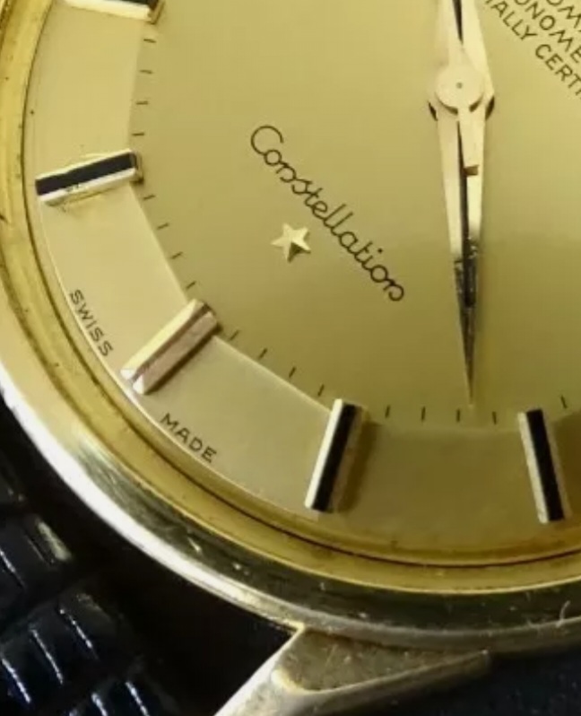

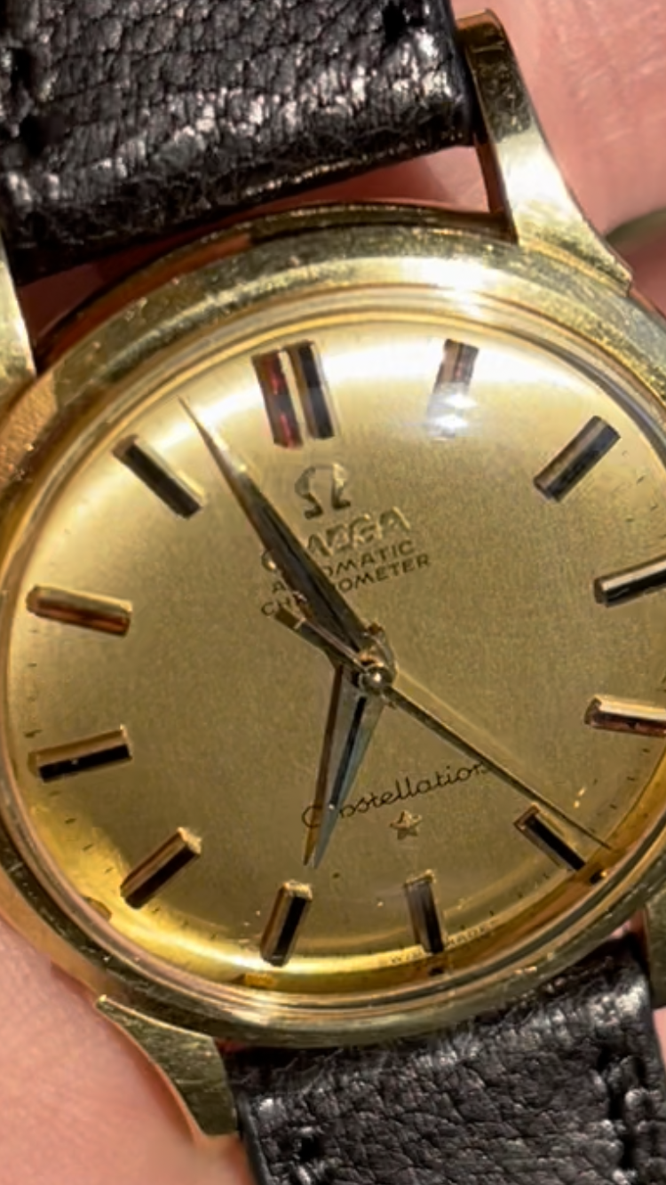

Hi all,
I’m about to pull the trigger on a nice Constellation Deluxe.
The only thing that make me wondering are the black Onyx index.

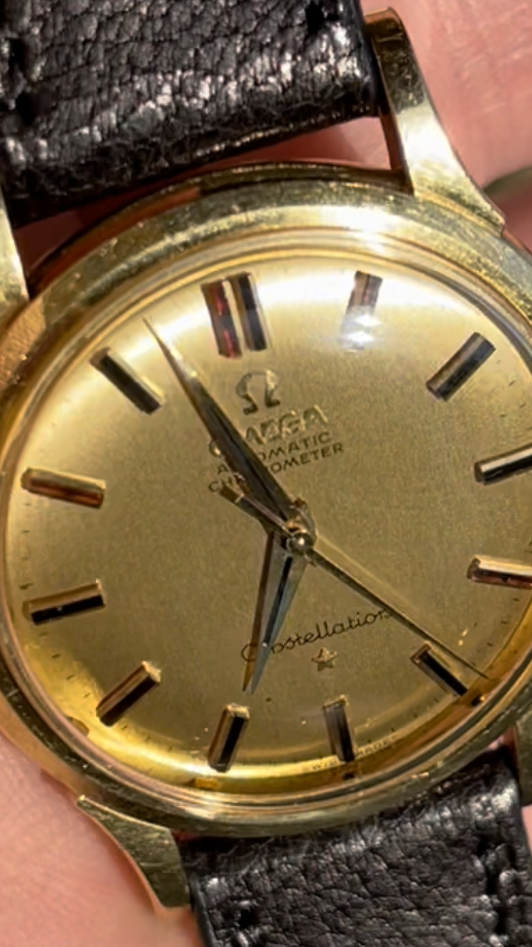

Indeed, even if hard to see on pics, the 10 hour index seems almost translucide and Orange when reflecting the sun.
I also have a video on which the left twelve hour marker has the same reflect.
I’ve read that Onyx natural may be translucide and even brownish / Orange, but have never seen this on a Constellation.
is there something wrong here, or maybe just a factory original issue in the process?
Thanks for your help

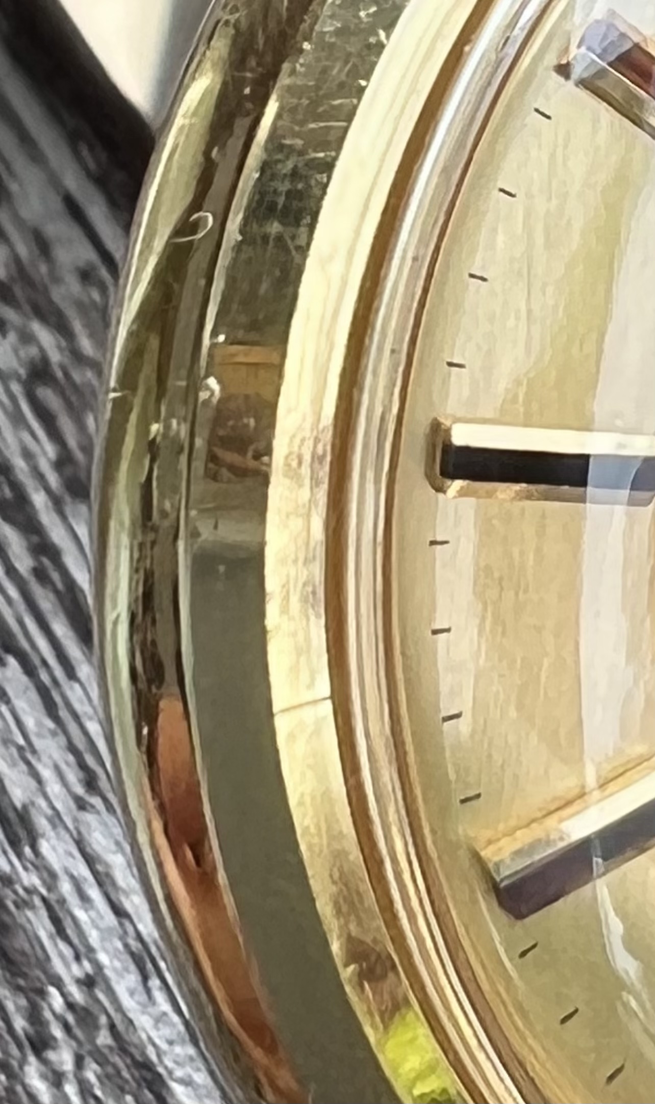

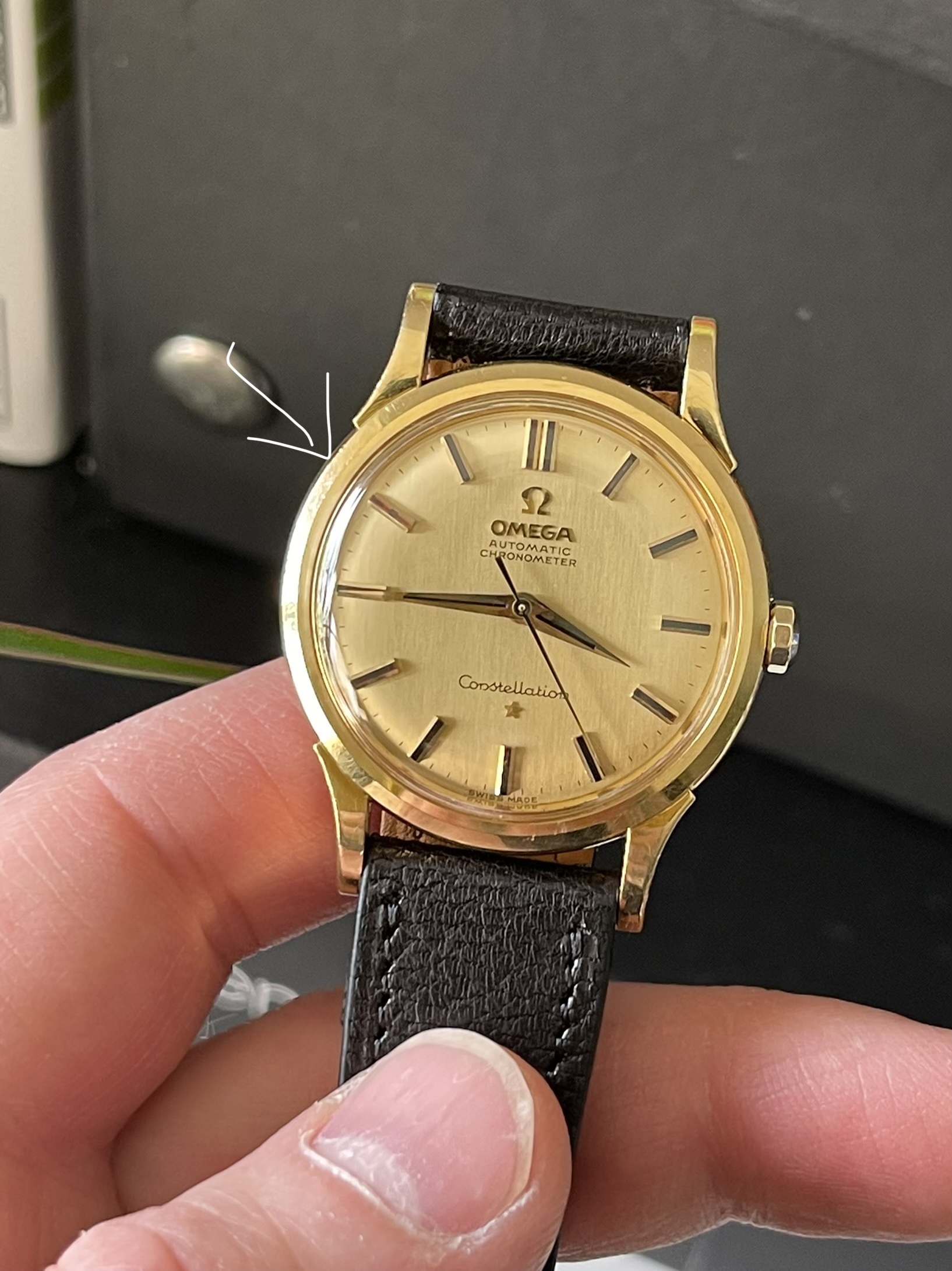

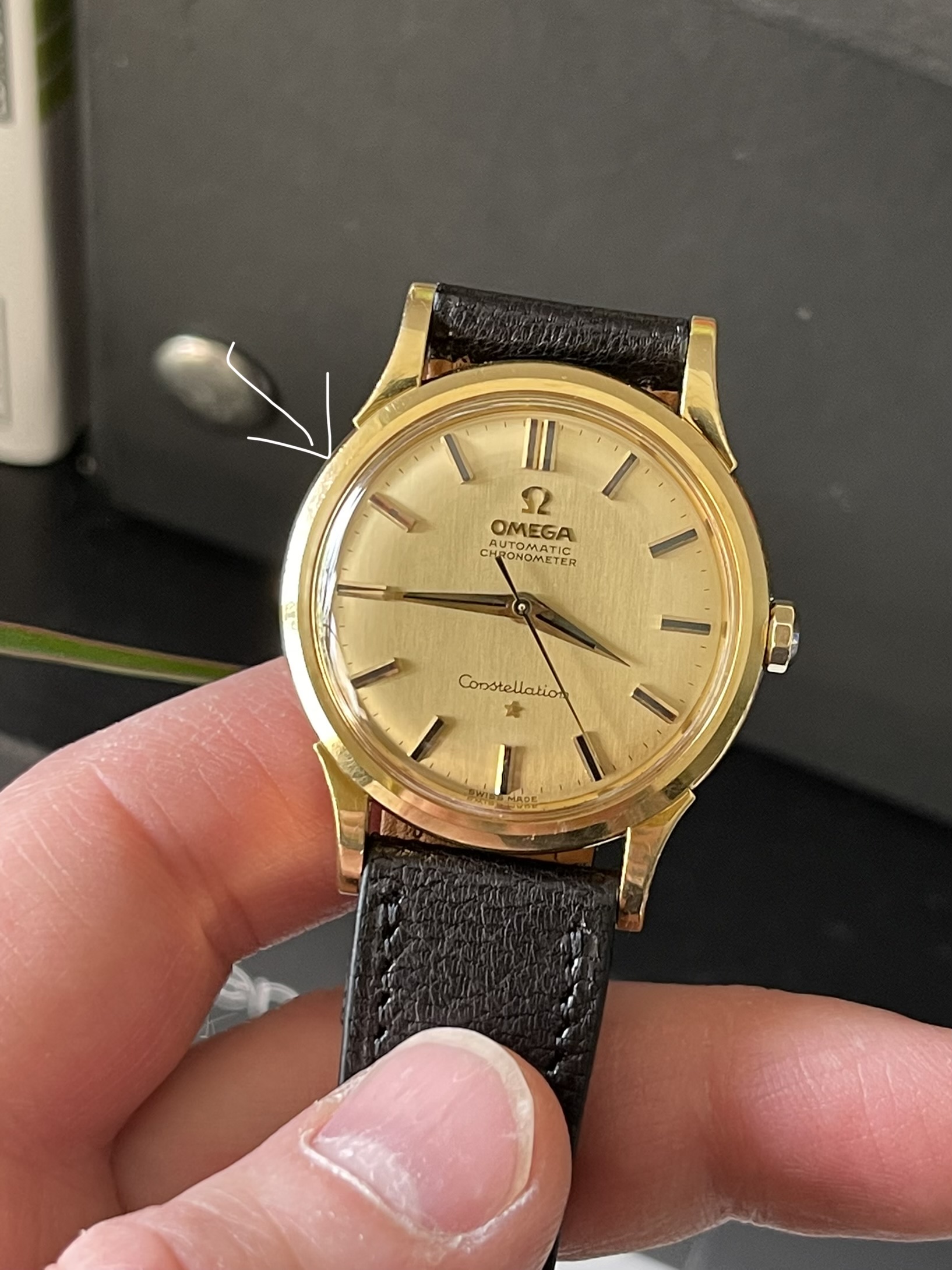

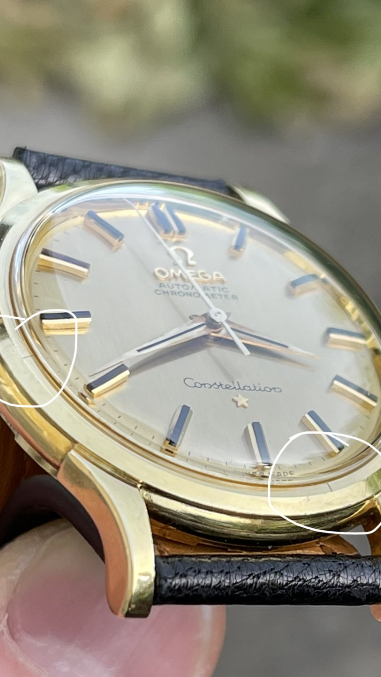

No idea but is the bezel cracked at 8:30?
Hi,
Thanks but not a crack, just a scratch.
here is a better pics of that

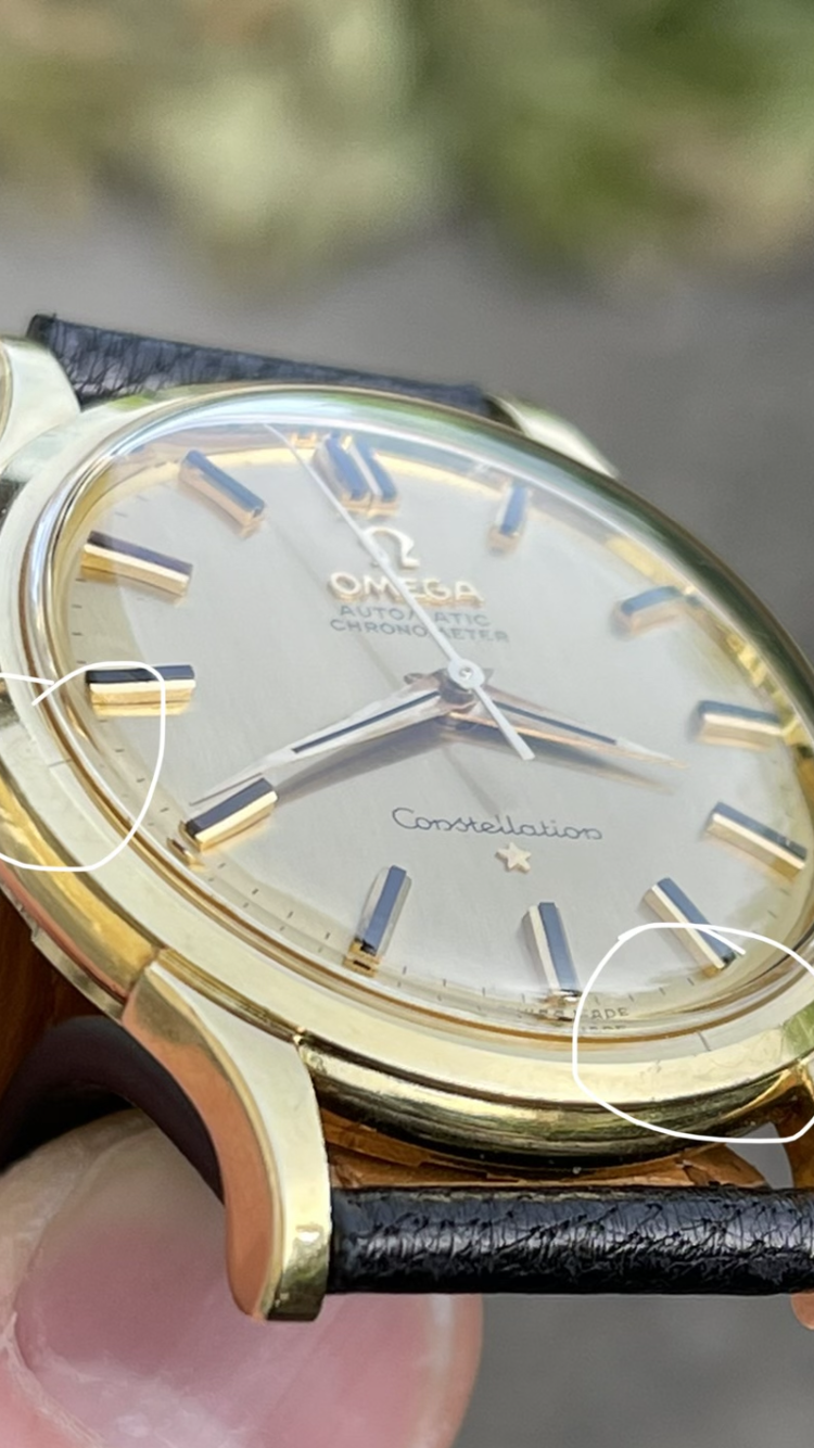

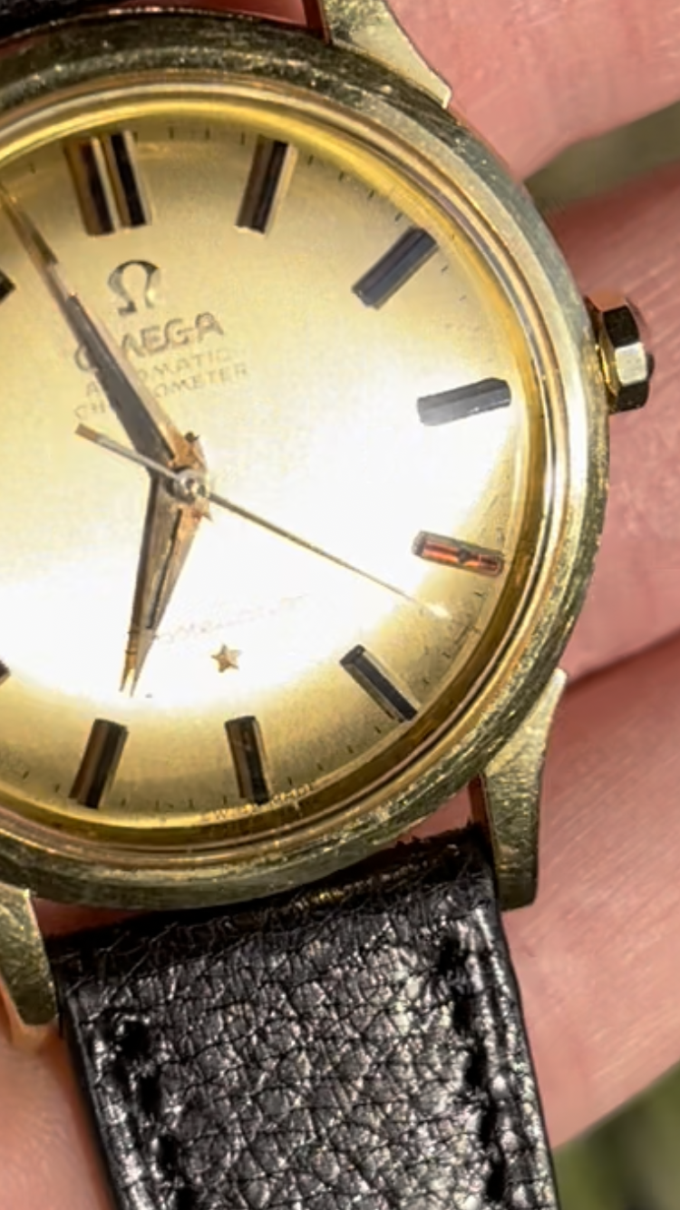

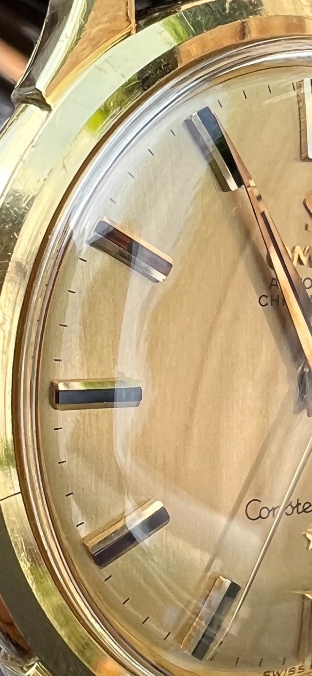

Actually it seems that all index have this translucide brownish variation according to the sun reflection.
Here is the one of 4.
No red flag here ?

Tropical onyx...shsshh, it's the next big thing 😉

I rarely comment when the pictures aren't clear enough for me to give an opinion and this is one of those cases. What I can say is that I've had numerous onyx Constellations but have never noticed any translucency, although I must add I've never specifically looked for it either.
13,556
23,504
Onyx is a translucent stone despite the fact most examples appear solid black, unless backlit.
It can also have hues of brown or red in it.
Its also relatively cheap, especially in the sizes used for hour indices.
I can’t see this being anything other than natural variation in the stone used at the factory during manufacture. The effort and cost involved in getting someone to cut glass or onyx to fit the hour markers would be prohibitive to the cost of restoring the dial.

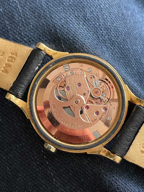

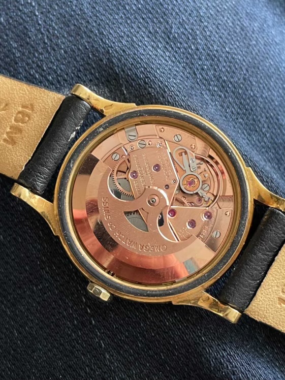

I saw that before . To me it was always a sign, that the natural material was original. Is there a chance, to take the movement out of the case?
505
738
To take the mouvement out of the case?
what do you mean?
here is a pics
5,729
9,514
Removing the back is step one. Now, remove the stem from the Mvmt., Remove both case clamps . Now lay the case back on the case only, not tightening. Turn over the watch and the movement incl. Dial rest on the back case now turn over again and have a close look at the dial/ onyx without distortion of the crystal. Take a better picture. And then reverse the procedure without ever touching the dial. Place the Case middle over the mvmt. Again, center the crown tube at 3 o'clock, turn over the case again, insert the stem and the loosely put back the clamps and their screws. The insert the at centered, press down the release button for the stem until it clicks in. Then tighten the case clamp screws and the back fitted right. Need one fitting screw driver for the case screws and a pin to press down the release pin for the stem. Viola! Then you know for certain. Good luck!
505
738

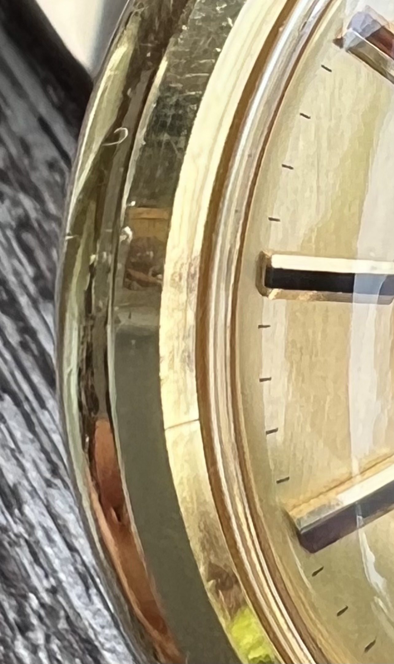

Here is one more pics I had when seller was showing scratch on bezel.
we can see what should be black onyx from side
3,790
6,452
Last week, there was a 168.006 sold on eBay. That one has a defect 6 o'clock hour marker and looks like it was missing the black stuff called onyx insert.
Maybe your watch had same problem and they tried to fill it with not-so- black stuff.

this .006 looks like it has had a ‘fat, flat ‘ deluxe onyx insert index replaced with a chamfered ‘full-fill’ lume insert index.
