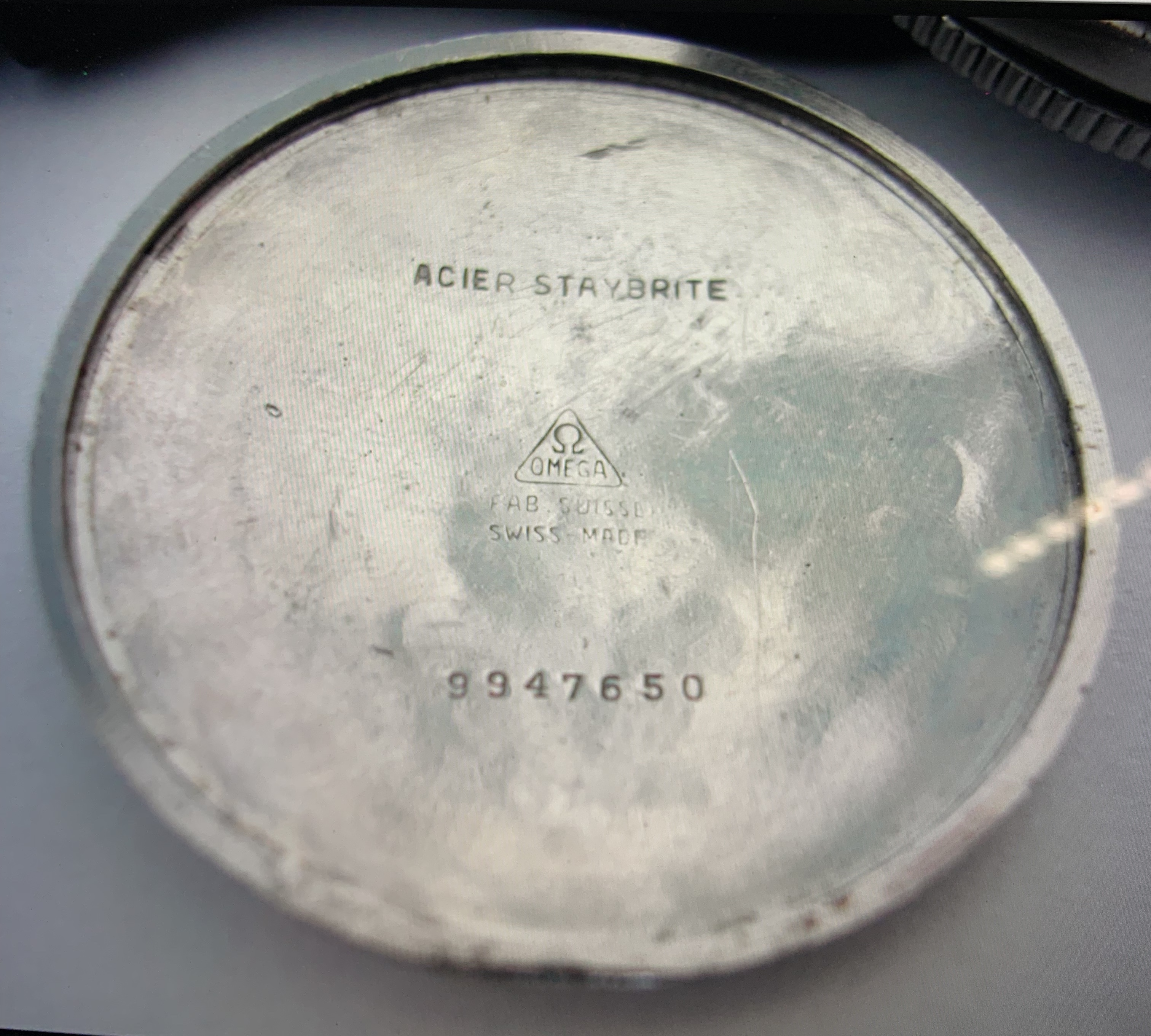

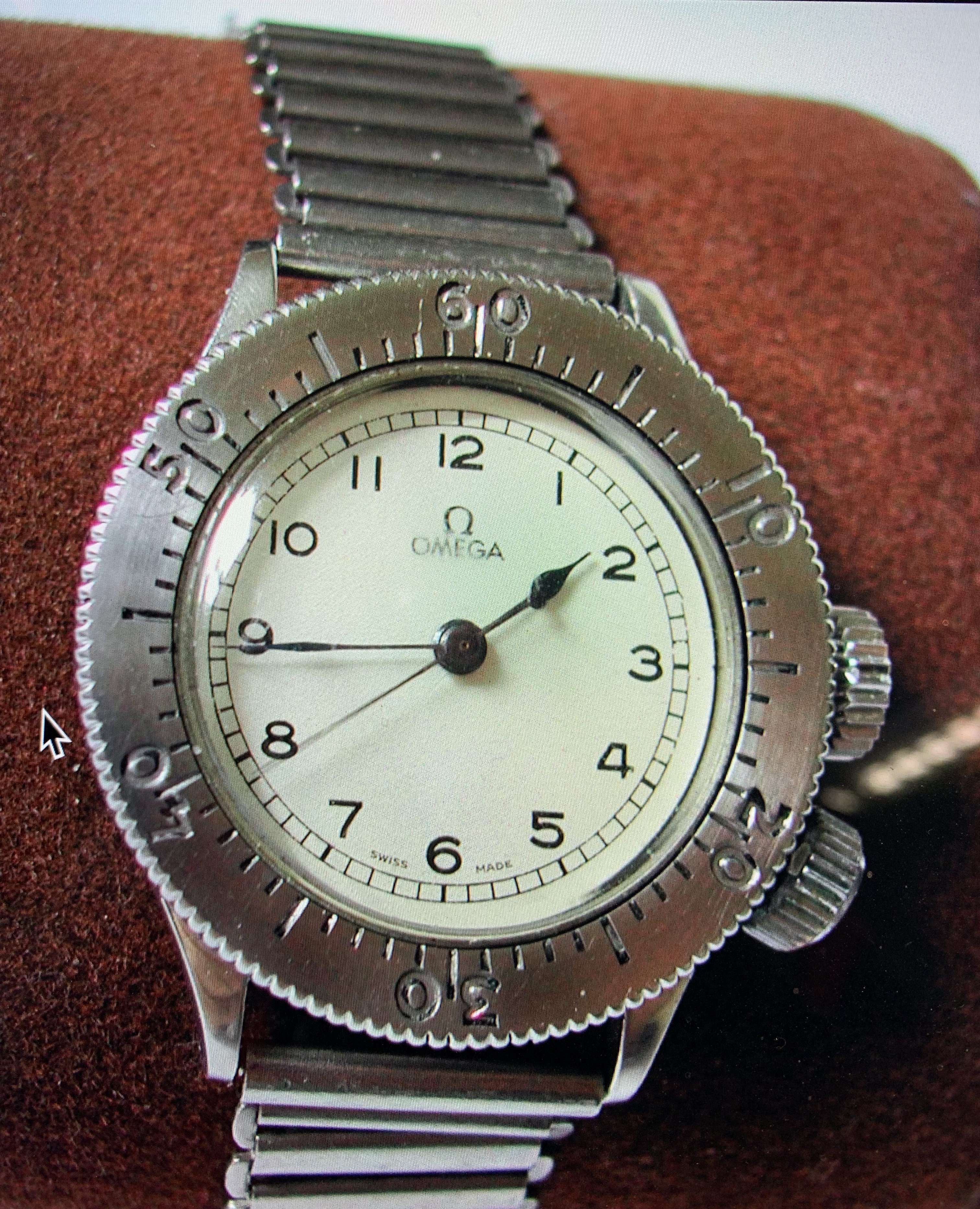

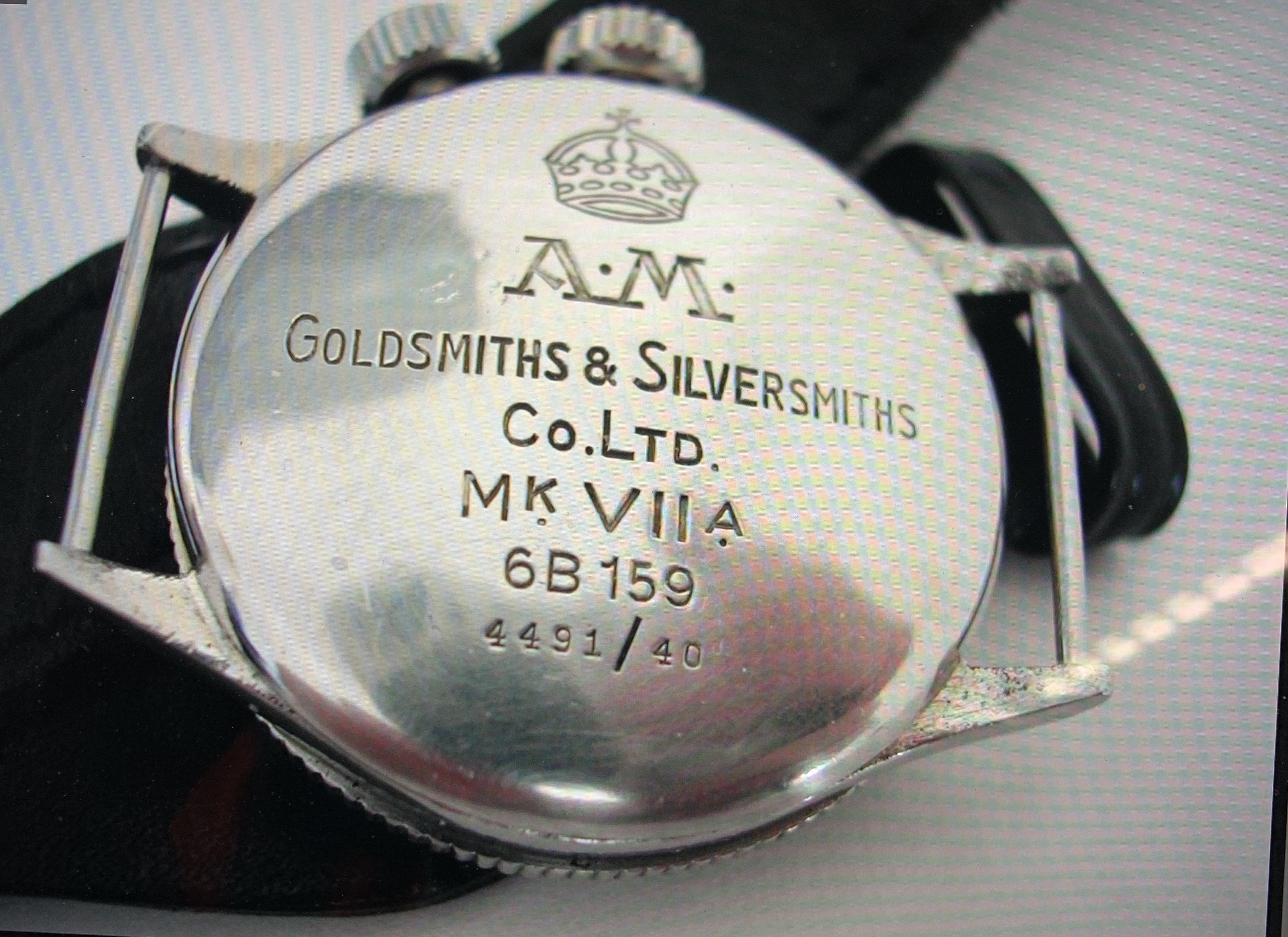

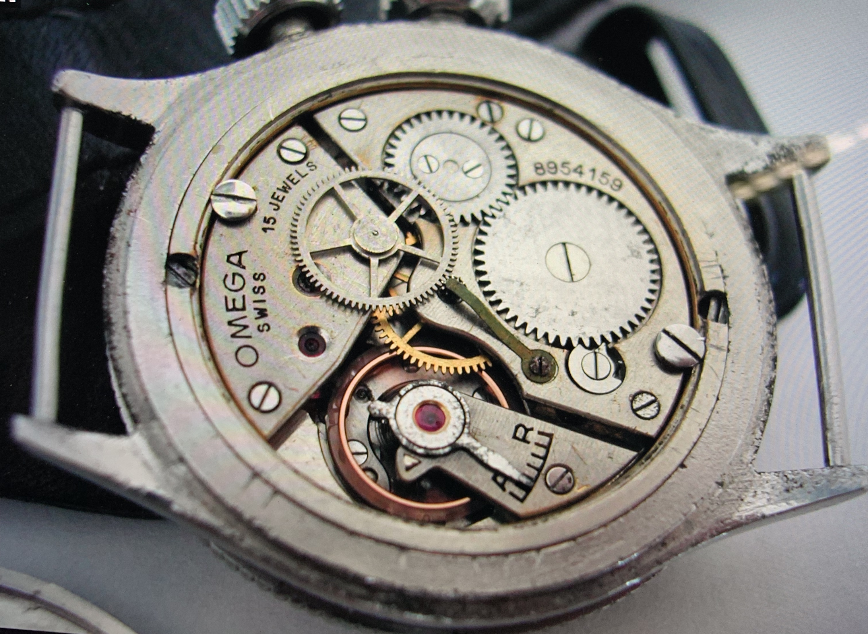

Please be kind as I am a new member,I have recently become the owner of Omega Weems 6B 159 4491/40 watch S/N 8954195 internal case number 9947650 see attached photos.I was hoping that all of the experts/specialist could point me in the right direction for research into the original order and maybe the original airman/navigator it was issued to

Wow cool, I had one too beginning of the year, but in general they are super rare! To find the name of the original pilot is impossible I think, but you can order an extract of the archive of Omegas heritage service. This will tell you when this watch was issued.
I just have some doubts about your hands and the dial. Your hands looks weired, but mabye its due to perspective.

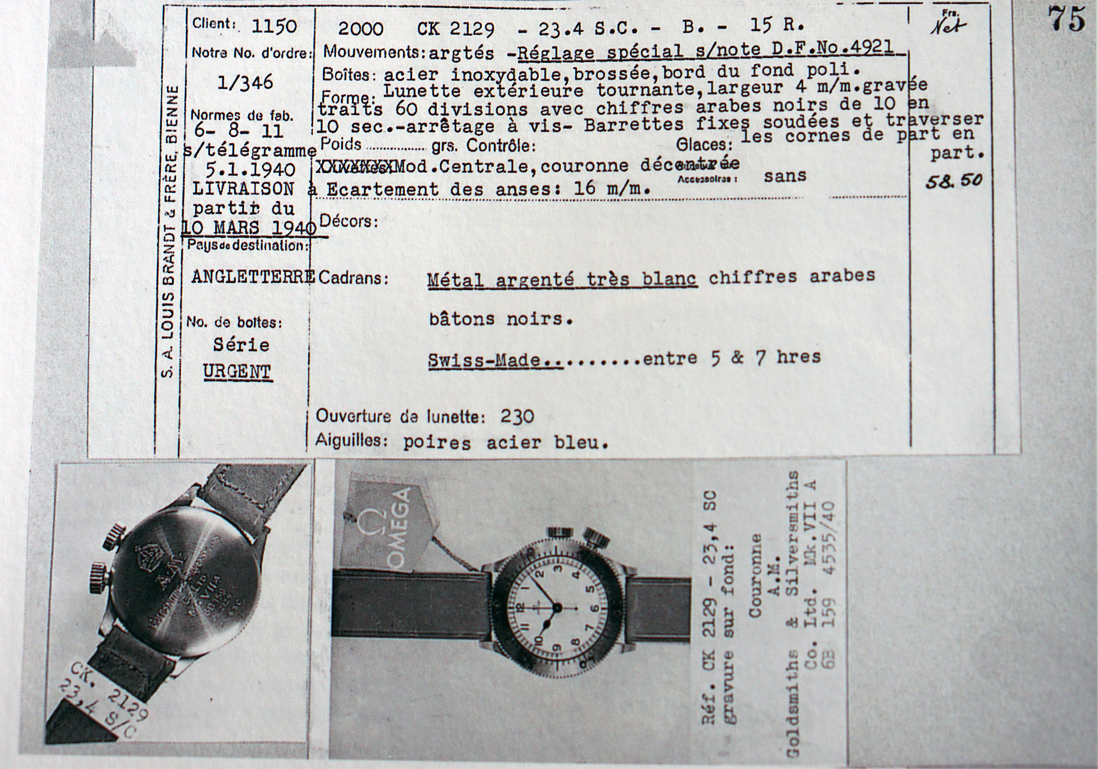

This was mine and a screen from the Omega Bible:

Really lovely and great to see it on a bonklip.
Hands appear correct, though dial does not.

Guys the watch recently had a renovation from a reputable restorer and the face was redone by professional people
I love this timepiece and so proud when I wear it from time to time

That's very unfortunate, as this destroys most of the value of the watch. But you love it, that's what matters.👍

@LarryG it seems to me like the minute hand looks like it comes from an "economy watch" - and the seconds hand seems like it's missing a counterpoise. No?

I think the second hand counterpoise is hiding over the hour hand.

@Syrte. I've seen a couple of slight variations, but what the 'ell do I know.
