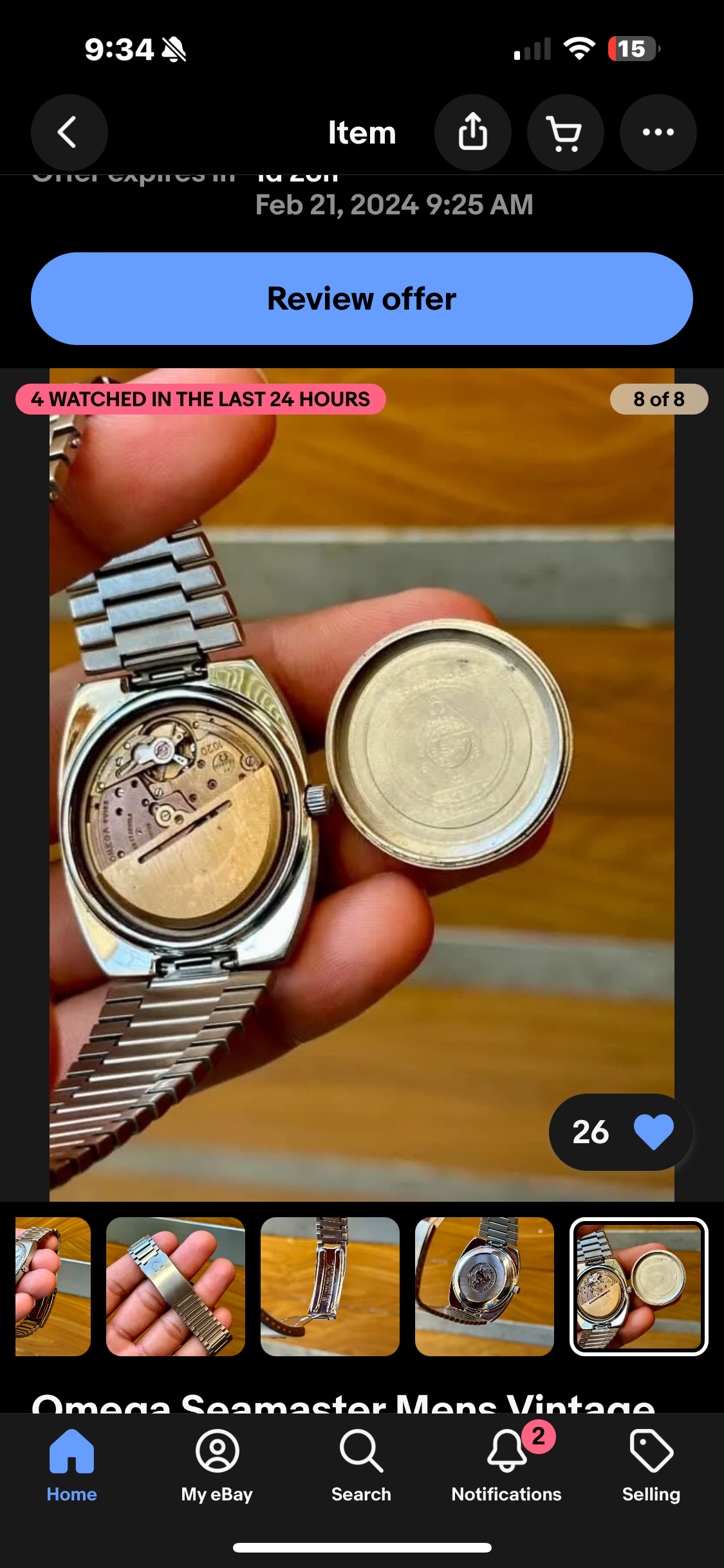

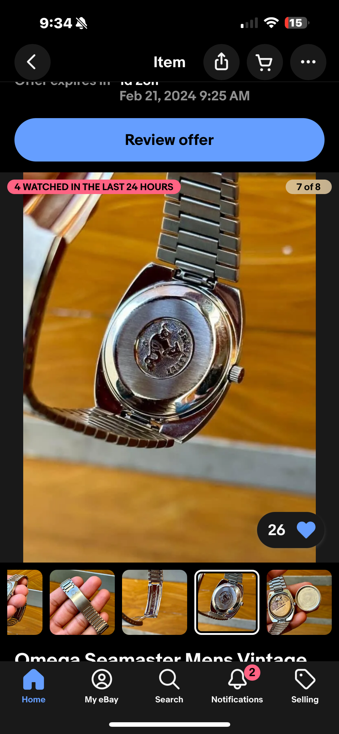

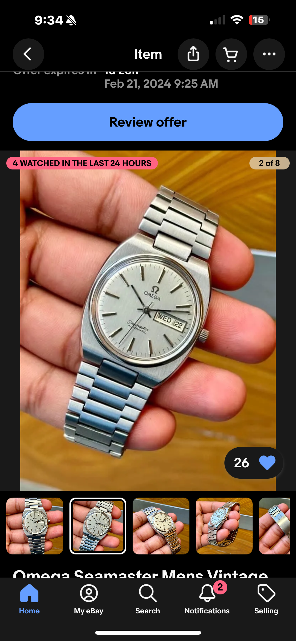

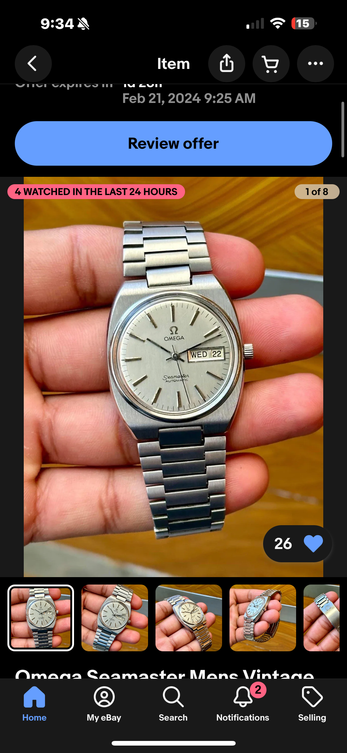

Hi,
I am looking to buy my first vintage omega ref# 166.0216 and see a listing on eBay. I have been weary about eBay as my method of purchasing but it seems to be a decent place to go if you know what you’re looking for. I gave added the photos of the watch to this thread. I contacted the buyer and they said that it was 100% authentic and no dial restoring has been done. Is there a way to know this 100% or is there anyone who could support with this?

People here can help you if you post lots of good photos. In general, the best way is to pick a small number of references that interest you and take a deep dive into studying them so you can identify issues. You can start with the "learn how to fish" thread for general principles.

People here are generally happy to help but you’ll need better pictures

The dial as it appears redone to me but the pictures are too poor to confirm

Yup. The applied minute markers at 11, 12, 1 and 6 look misaligned with the corresponding painted markers.

This. They say the devil is in the details. Get great close-ups and study them. They often reveal the subtle imperfections that are a dead giveaway.

I see this now, thank you!

Everything, but especially the dial and movement.
I found the watch you're looking at on eBay. PUHLEASE stay away. Everything is terrible and it is VASTLY overpriced at $1150.
The dial is a redial and the case is overpolished. These are not particularly rare or desirable, so if you like this style you should be able to find a much better example for less.

On the watch below the printing doesn't look good at all. The minute hash is not aligned to the hour marker at 6, the minute hash at 8 is missing altogether.

Seamaster text is off. Watch is coming from area with lots of fakes.
