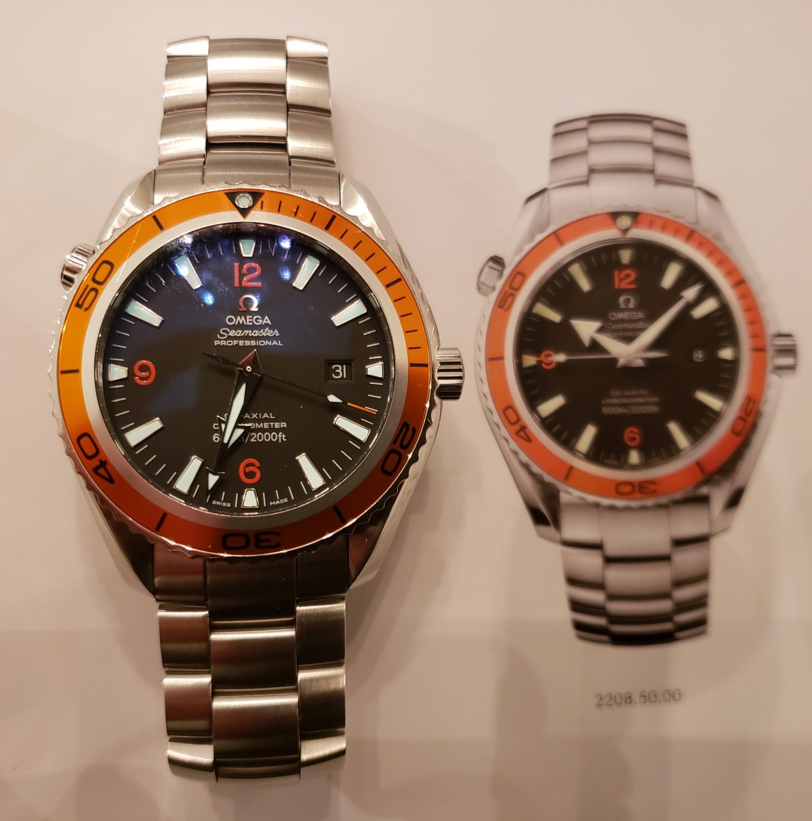

So I traded my speedy hesalite for a PO XL 2500. I've always wanted one and I just didnt "love" the speedy . Great watch but....I'm a seamaster kinda guy i guess. Well 1 day after the trade the watch stopped working and I got really annoyed. Contacted the guy I made the trade with and he was just as surprised seeing that the watch got an overhaul 3 months ago.
He was willing to take it back to his watchmaker and get this sorted out but given my busy lifestyle it was a hassle. So I removed the cover to see what's going on and noticed the balance wheel not moving and was stuck. Archer noticed a missing screw (messaged him about the issue) so I figured it wasnt screwed in properly and it fell off blocking the movement.
So....I brought it to my watchmaker and he took a few screws off to see if he can see what's going on and then put the screws back(not in the same place) but left the balance wheel unscrewed which got unwound and now needs a new one and a complete overhaul.
Silver lining is that I'm getting an overhaul and that the watch will come back to me good as new with a 2 year warranty. Sucks that I have to dish out money for a watch that just got a d overhaul but it is what it is. The previous watchmaker wasnt omega certified .
I brought it to an omega service center here in Montreal and the turnaround is approx 4 weeks.

So....I brought it to my watchmaker and he took a few screws off to see if he can see what's going on and then put the screws back(not in the same place) but left the balance wheel unscrewed which got unwound and now needs a new one and a complete overhaul...............

Well, a screw fell out in transit, which isn't great, but these things can happen. You really don't know that the original overhaul was flawed or that his watchmaker is incompetent. We just know he made a mistake. The seller offered to make it right, and you were the one who decided to take matters into your own hands by taking the watch to a watchmaker that you KNOW to be incompetent. I don't think the seller owes you anything more.
I hadn't seen him in a while and he was very good with everything I gave him so far.
His time has come I guess.
