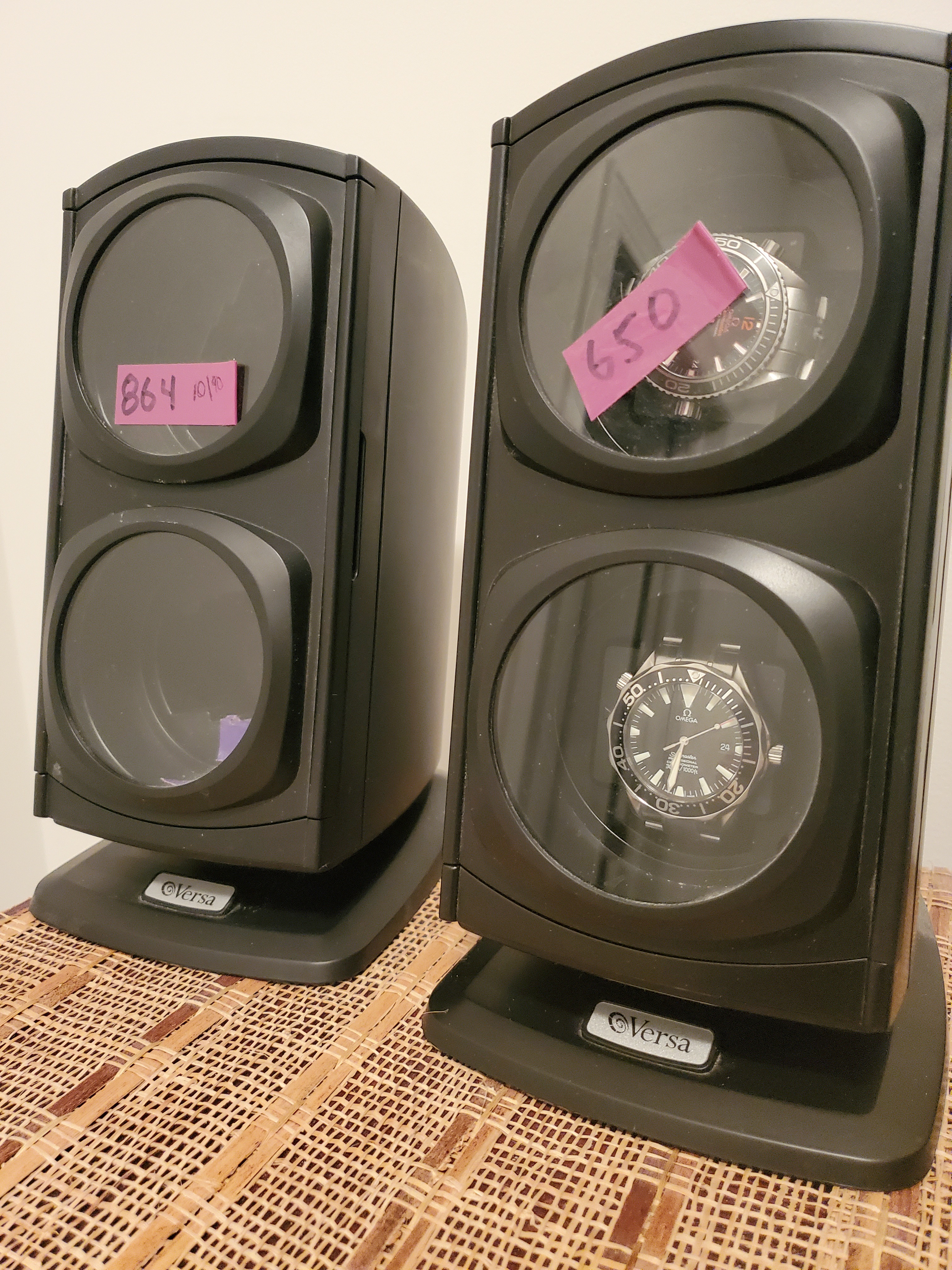

A cheap winder will keep your watches wound as well as an expensive one. No need to see such a simple device as an investment.
I have two, each taking two watches, which I bought a few years ago on Amazon for 40 €. They just do the job.
1,253
4,830
+1 to above. These have become a "bit" noisy in a very quiet room and I've changed out one of the pods. All in eight or ten years. Four tpd settings and clockwise, anti clockwise, bi directional.
