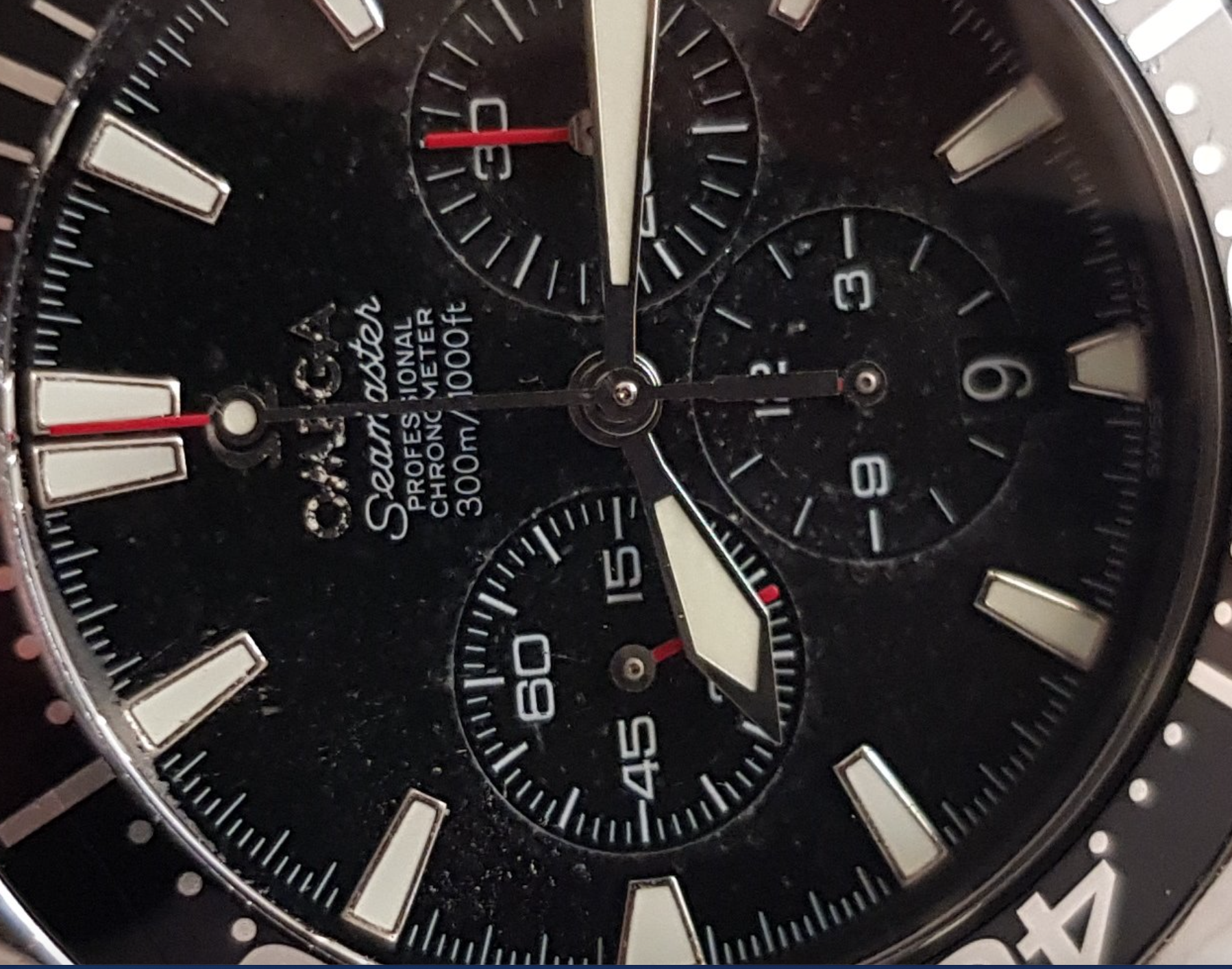

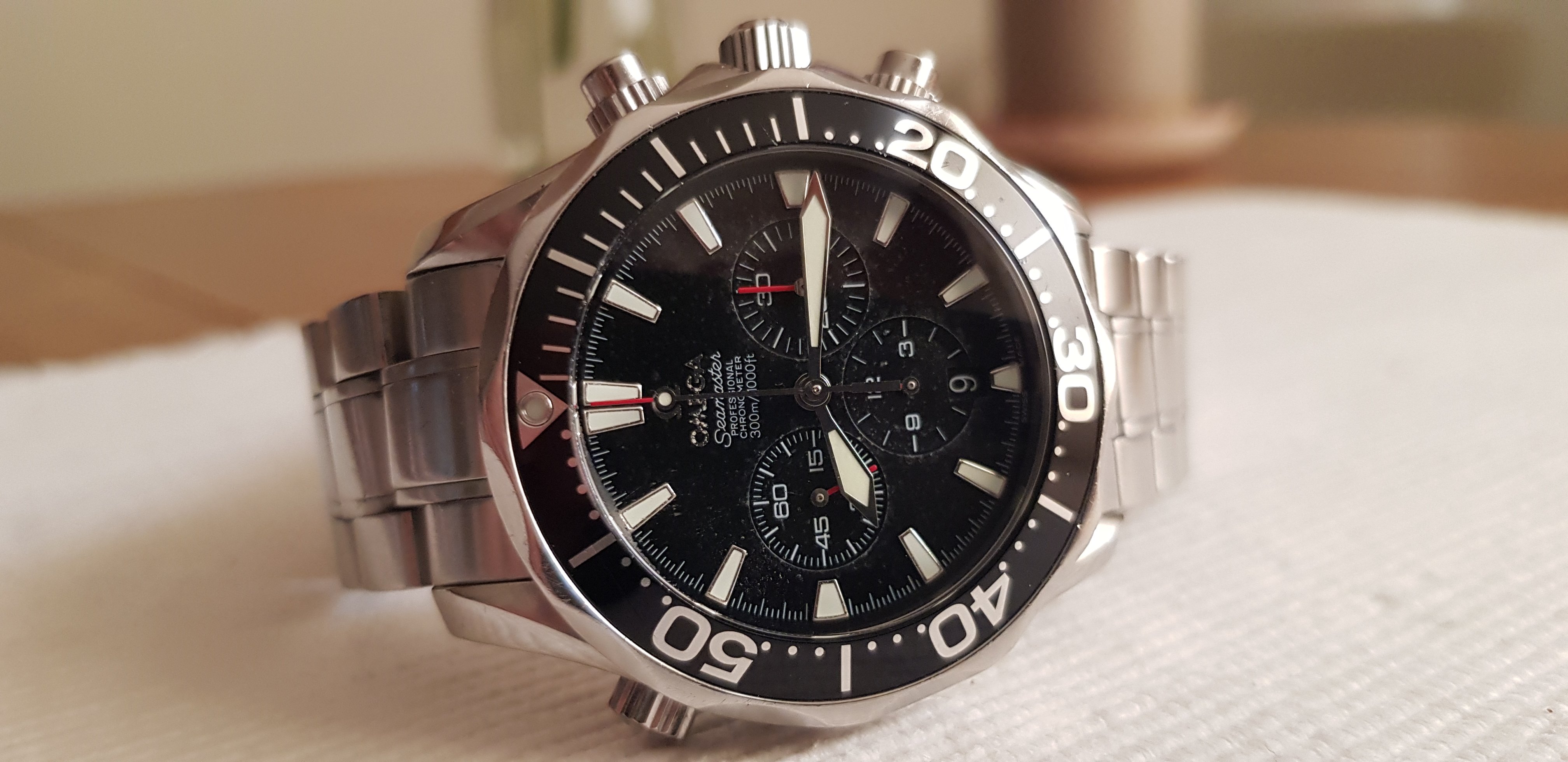

Every time I wear this sword-handed Seamaster Professional Chronometer I remind myself that when I bought it there was a comment in the listing that it might benefit from a future service and since then I've enjoyed wearing it on rotation and growing to like it more and more.
What does it need? Well it's out of COSC spec, currently showing about -15 s/d. The bezel has a bit of looseness and the bracelet could do with a strip & refurbish.
What does it not need? The crystal is scratch free, the lume on hands and dial is amazing.
What needs thinking about? The dial has a kind of surface spottiness and the silvering of the word OMEGA is starting to look less-than perfect which I regard as "early stage patination" and the case obviously shows some age-related battering but this isn't a new watch, right?
I can't decide: replace the dial or live with patina?:

15 seconds wouldn't concern me, but I'd have the watch serviced if it was mine.
The merest hints of patina wouldn't concern me either on an honest watch that sees regular use.
Any dial impairment is not very apparent in the photo you provided.

The dial is looking a bit tired. If you send it to Omega and they replace the dial included in the service cost I'd be happy with that solution. I'd live with it for now if I had to pay for the dial. I'm not sure if Omega replaces dials included in service but I'm sure someone here knows.

The dial is looking pretty bad for a modern watch, so I suspect you have some moisture ingress. Lacquer damage, corrosion, etc. I suspect that the dial would be replaced at an extra cost, but it would be worth it IMO.

Y'all have better reading glasses than I do.

Thanks Dan.
"Omega" is looking poorly.

IMHO, this is damage, not patina, maybe due to destroyed gaskets and water ingress. As Dan said, it's looking not great for a modern watch...
What does it need? Likely a complete service and some parts...

This was my thought as well. That dial should not look that beat up given how recent this watch is. I think it is possible that the Slowdown of the movement and the damage the dial are related, and if so... most likely an ingress issue somewhere.

All of that and someone to pay for it. Guts of £1000 or equivalent in your currency.

This looks definitely like water ingress and I think that you should take the watch to a competent watchmaker as soon as possible.
