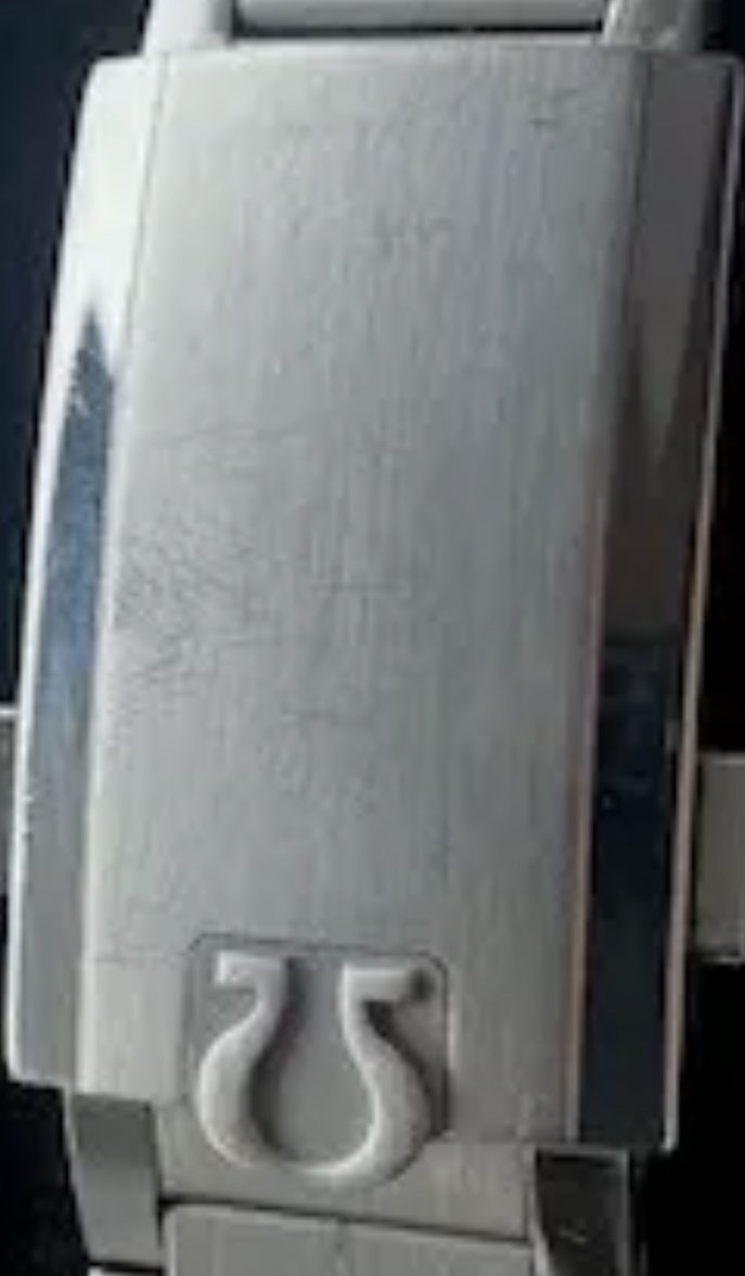

Hi guys. Looking at purchasing a used watch which has quite a few scratches on the clasp, these things do bother me, I know I’ll scratch it myself and that’s fine but when someone else has done it, it bothers me. May very well buy the unworn version but wanted to know if I could get these scratches out fully or if I will be left with marks if I get it done professionally? Help very much appreciated.

If you are just removing fairly light scratches as are shown in the first post, then using Scotchbrite is probably the least risky method.

Yes to Scotchbrite. I have used it to great effect. Take you time and don't use to much pressure to try for a quick result.
When I've done I cover the clasp with Sellotape to stop further marking [needs replacing now and then]. Take time to place the tape and you can stop any bubble effect so no-one will notice. J.
