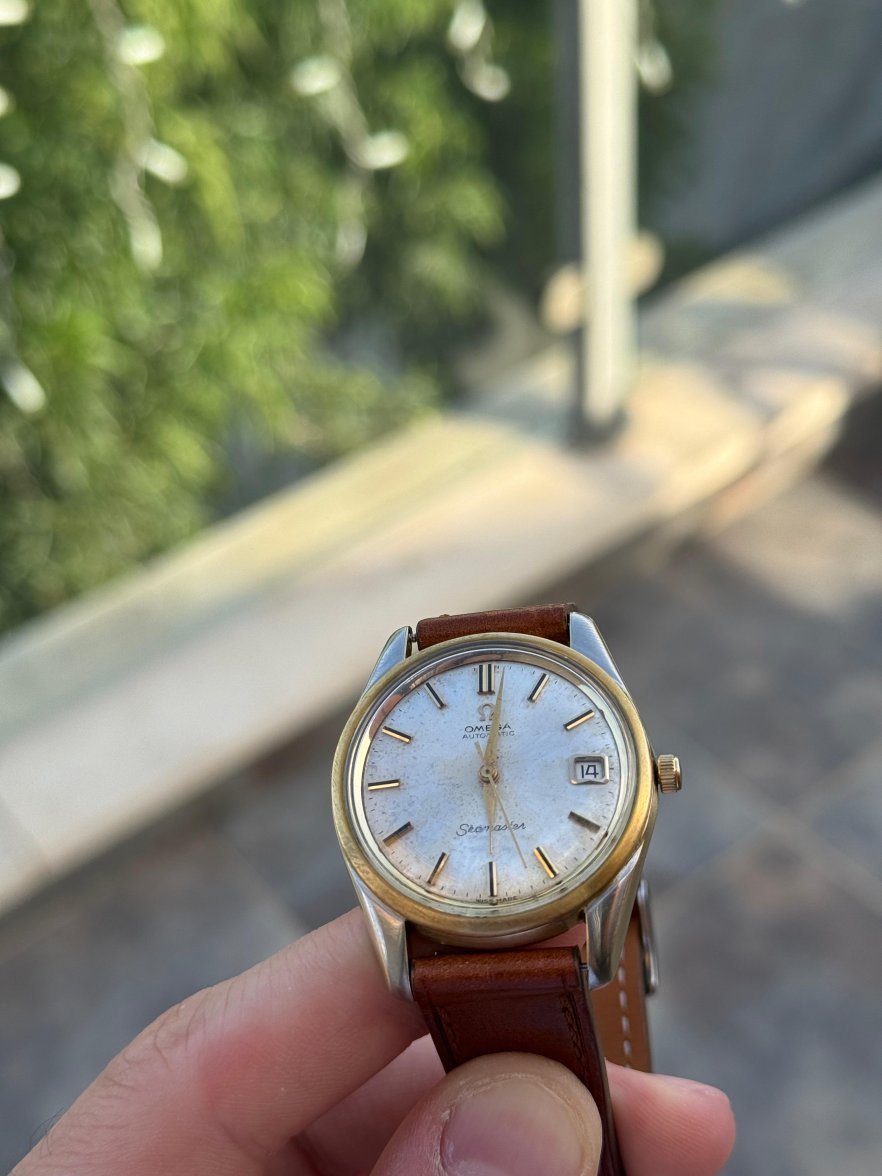

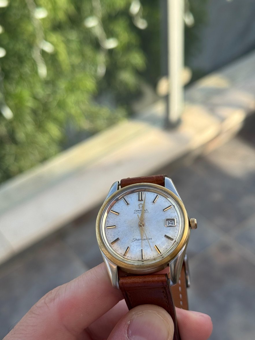

Hey all,
I'm new into watch collecting and was fascinated by vintages omegas. I managed to find one from Chrono24, for 125$(!!!) - It is a 166.010 562 Caliber, Gold & silver plated - assumed to be from 1970. The dial is a bit dirty, looks like some sort of liquid, but still looks good IMO. Generic crown.
Would appreciate your opinion on whether this looks like a redial or unauthentic case, etc. Strap is not authentic, bought from Etsy.

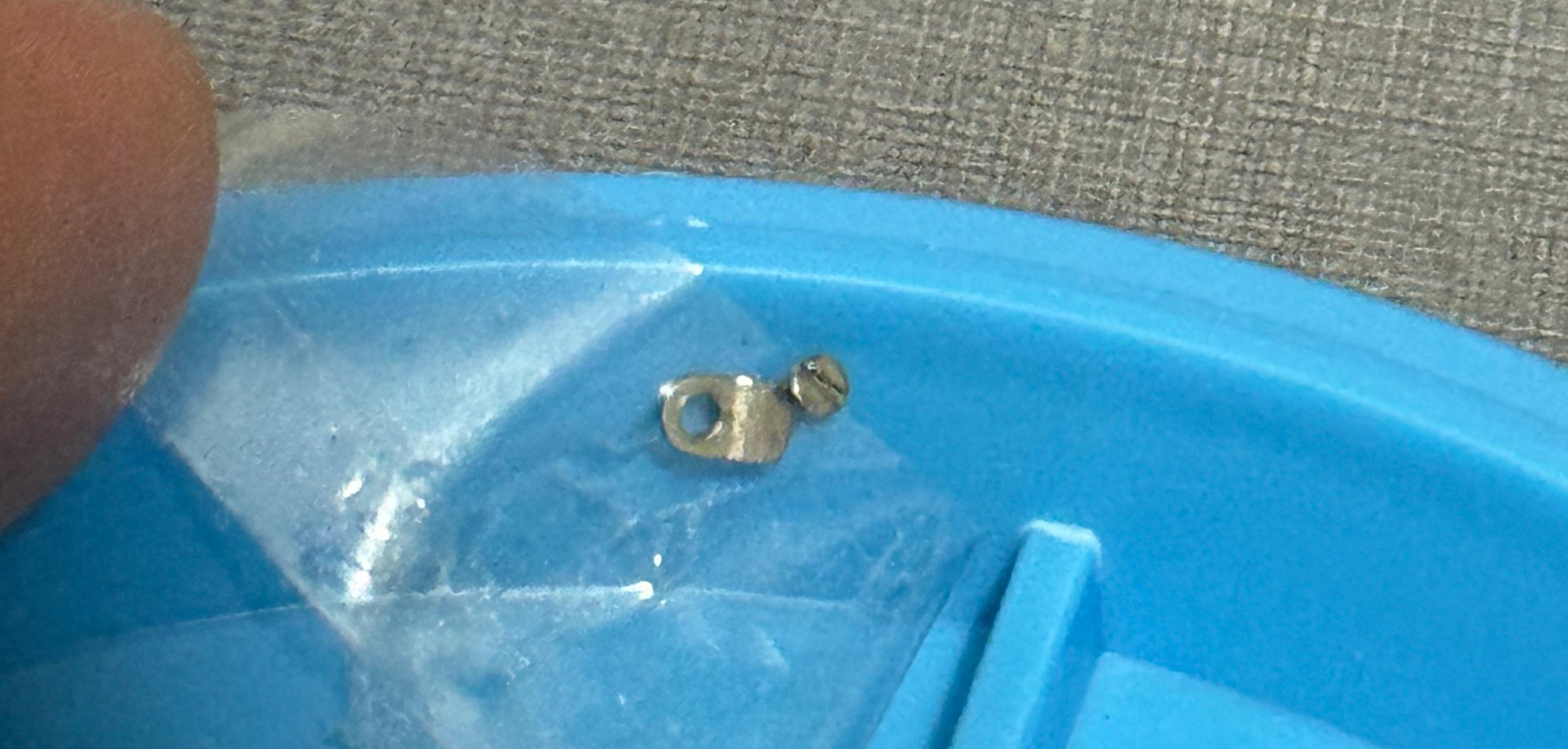

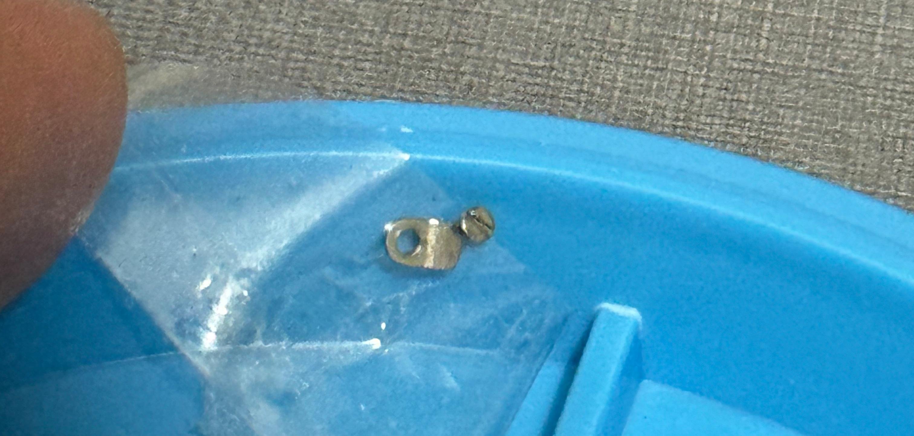

Also, one of the screws which hold the small metal in place which holds the dial inside the metal case doesn't screw in, and is loose, attaching picture of the screw & metal(not aware of the part names, numbers) - do you guys know where can I buy this part from?

Correct. At first, price was agreed to be 350, managed to reduce to this for unoriginal crown/crystal/...

That would be a hard pass for me. The dial is shot, these didn’t come in a two tone case so I’d be inclined to think that’s an aftermarket bezel someone has had made as the gap to the case edge is too large, the mid case is severely polished and the crown is wrong.

I don't see an upside with this one.
Incorrect bezel, damaged dial, damaged movement, nothing nice about the watch.
Save up for a nicer one.
This would suggest that the threads are stripped/damaged.

The part is called a case clamp. There are different part numbers depending on the case.
Stripped screws can be indicative of more damage/wear. These are fairly common movements. Most of the time it is easier to get a new plate, than to bush and re tap the hole.
I like to self service my watches, So this is the sort of thing I sometimes look for. Mostly this is a 'parts' watch. May be made from parts. Some call these franken watches. Others like myself call them rat watches, as it can be quite fun and entertaining to source the parts and restore something not normally worth restoring.
The price is fair for such a watch, It will, however, not considered collectable.

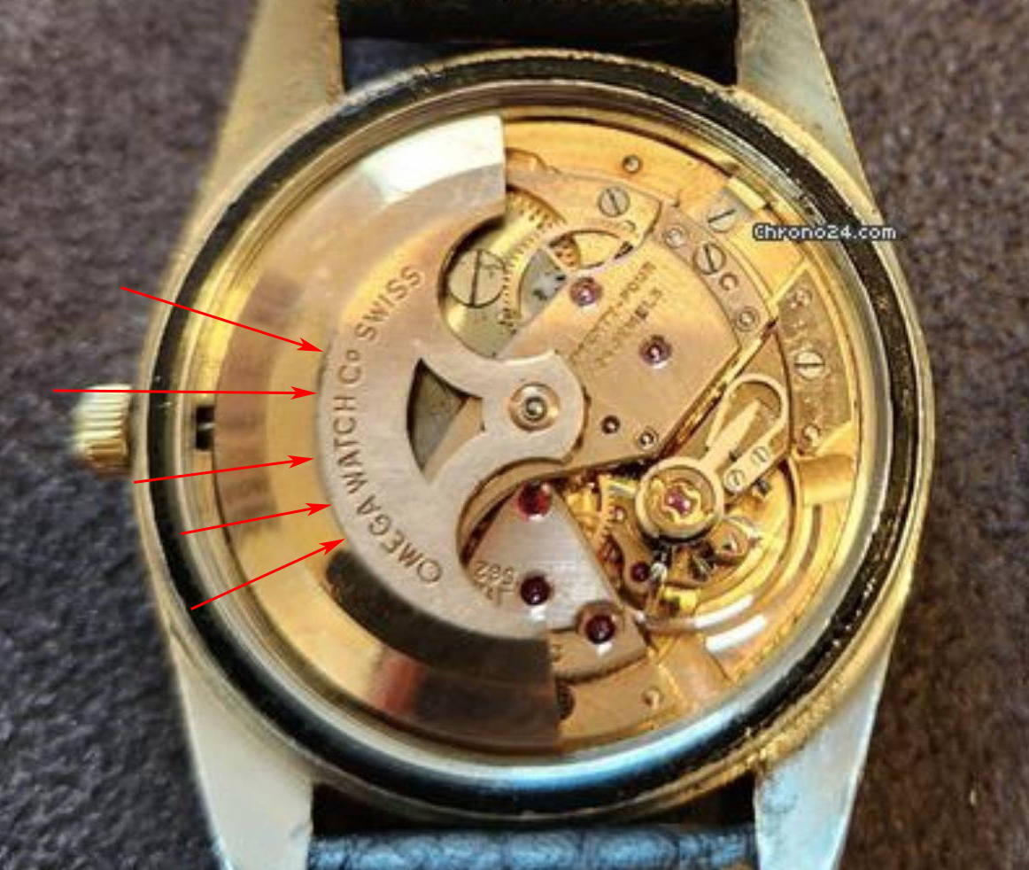

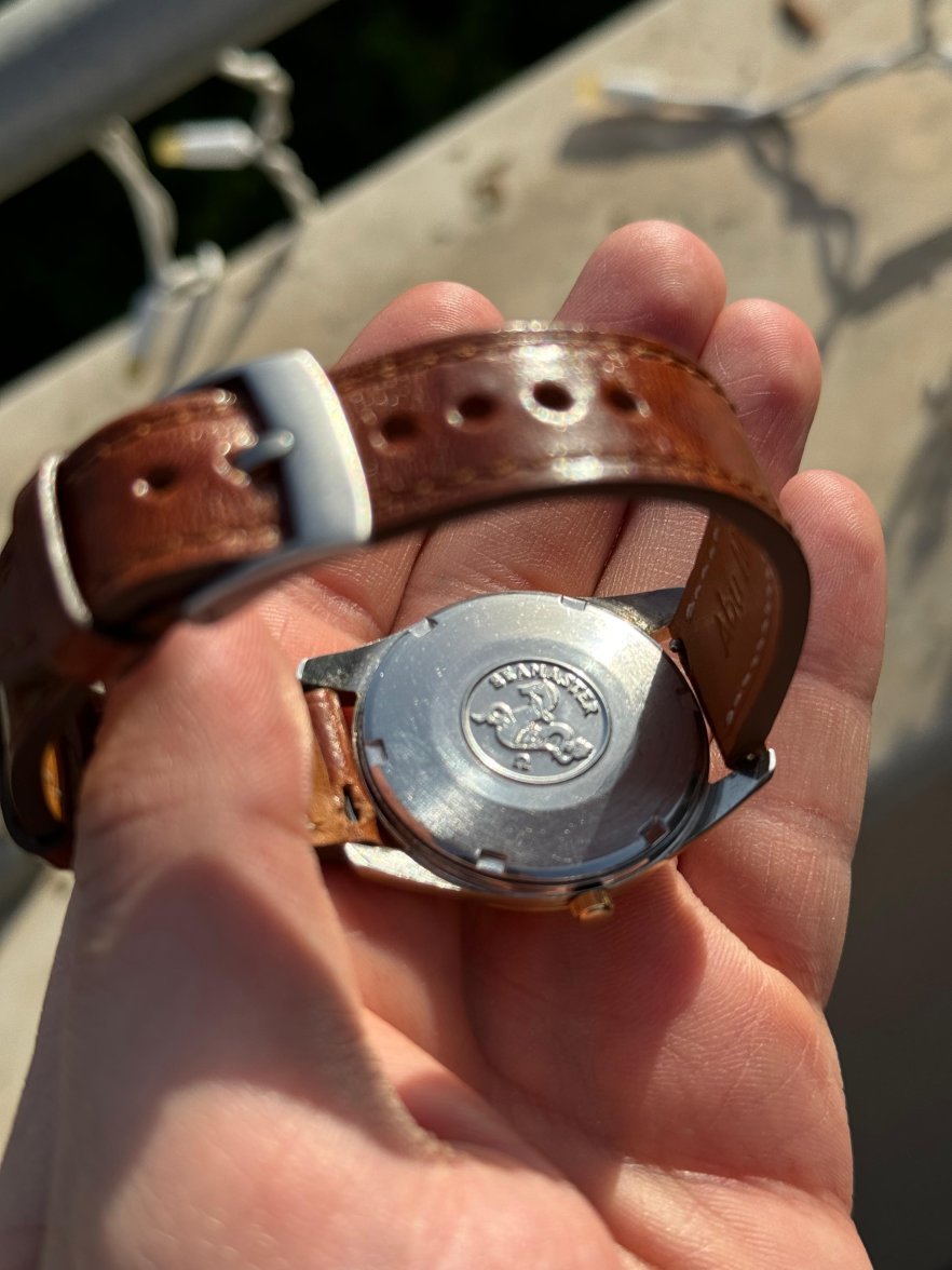

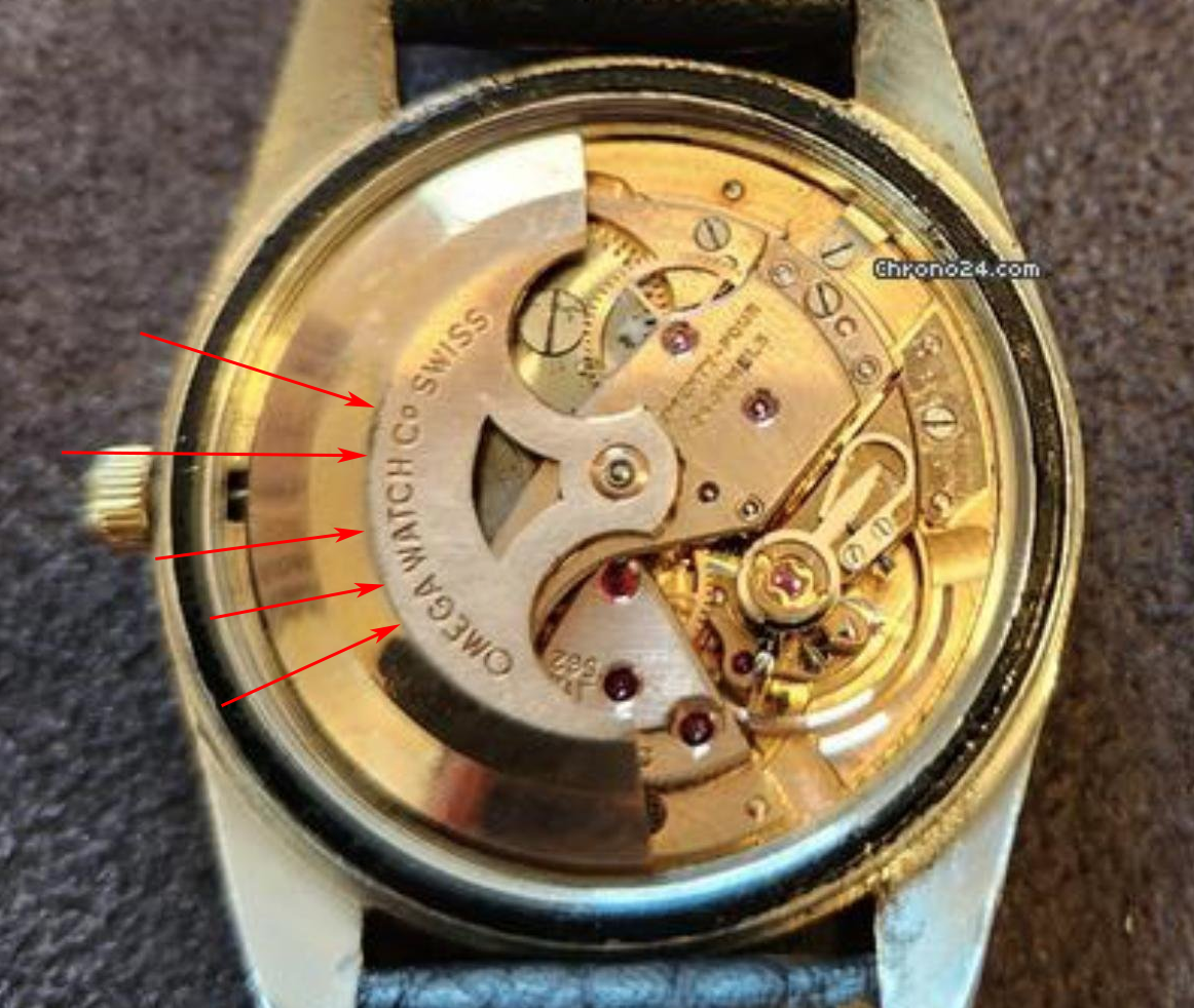

Damage, nasty wear to the rotor from contact with the case back caused either by a worn rotor bushing OR from the movement flopping around because of a loose/missing case clamp, maybe both.
Do you maybe know the part number of the screw/where can I get a new one/where can I get the part where the screw is screwed to 😀?
6
At the end of the day if it makes you happy, that is all that really maters.
That part is the main plate, the chassis of the movement where all of the other components attach to.

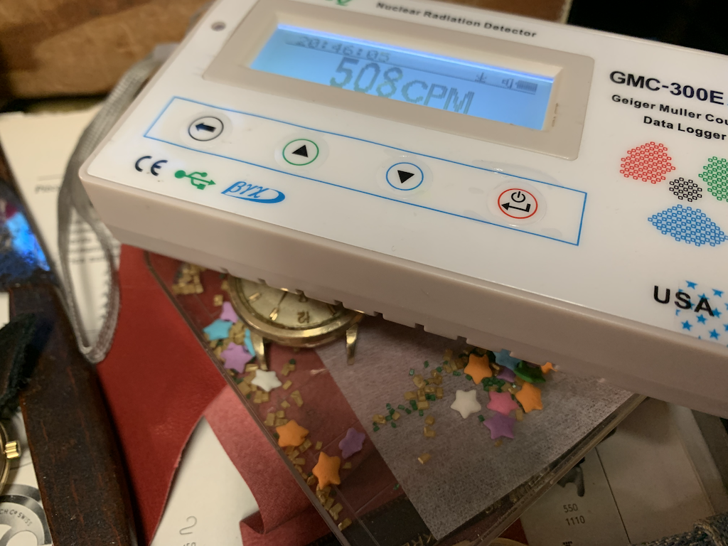

The real problem will be when Radium dials (dyles) can no longer be sold on eBay. I just checked the one I got this week. (sorry you get to see it again.)
I think this one is going to be a keeper.
