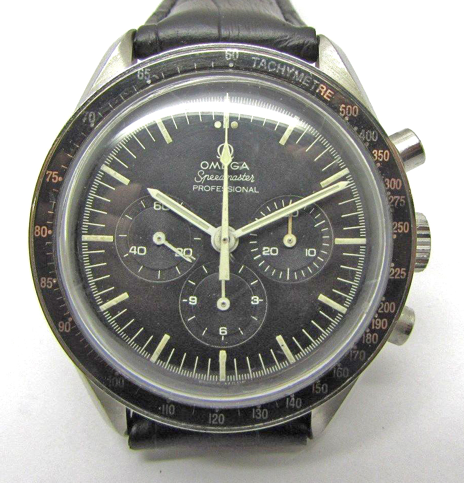

WARNING: Dodgy eBay Speedmaster 145.022 with "Original Dial" and DON Bezel Back Again

Franken movement with fake bezel and fake dial. Many of them around and have been talked about here before, all have the same exact fake bezel and fake dial, just different franken movements and different ebay seller IDs. Notice the fake dial: stepped, no T but long hour index with printed logo, and especially the wrong font types. The mid case appears off also, but not certain without side by side pictures.

Is this the same one that's been floating around for like six months? Sort of like that 2915 that hung around like a bad smell
2,876
1,962
Just the bezel and dial that look the same, but the movement is a different franken in each listing.

This one's back again but he's modified the movement further with some genuine Omega parts by the looks...
http://www.ebay.com/itm/VINTAGE-OME...109887?hash=item5b21717dff:g:JmsAAOSwxp9W4NH6
Already up to $2600 which is sad...

Have to admit I was looking at the bezel originally but more to try and figure out what the hell it was.
That was only after the head-scratcher of the painted logo with the long indices.
