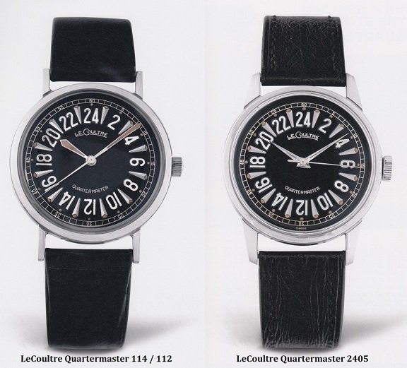

The 1959 LeCoultre 24 hours dial "astronaut watch" was based on the military-inspired Quartermaster 114 and 112 versions, aka "thin lugs" versions.
The LeCoultre Quatermaster came with a special hand-wound caliber K831/CW, 18 K VpHour, 40 hours power reserve, of course with a single full rotation per day, hence the 24 hours dial.
Quartermaster versions came in a 33,5 mm stainless steel waterproof case, with the 114 & 112 having a locking-ring caseback, while the angular profiled lugs 2405 version came with a screw-in caseback.
The bespoke version, ordered by NASA for the "Mercury 7" astronauts came with a totally different matt black dial with white painted hour and minute markers. No luminescent material was used as safety reasons prescribed any radiation was to be avoided.
(Photo: Jaeger-LeCoutre)

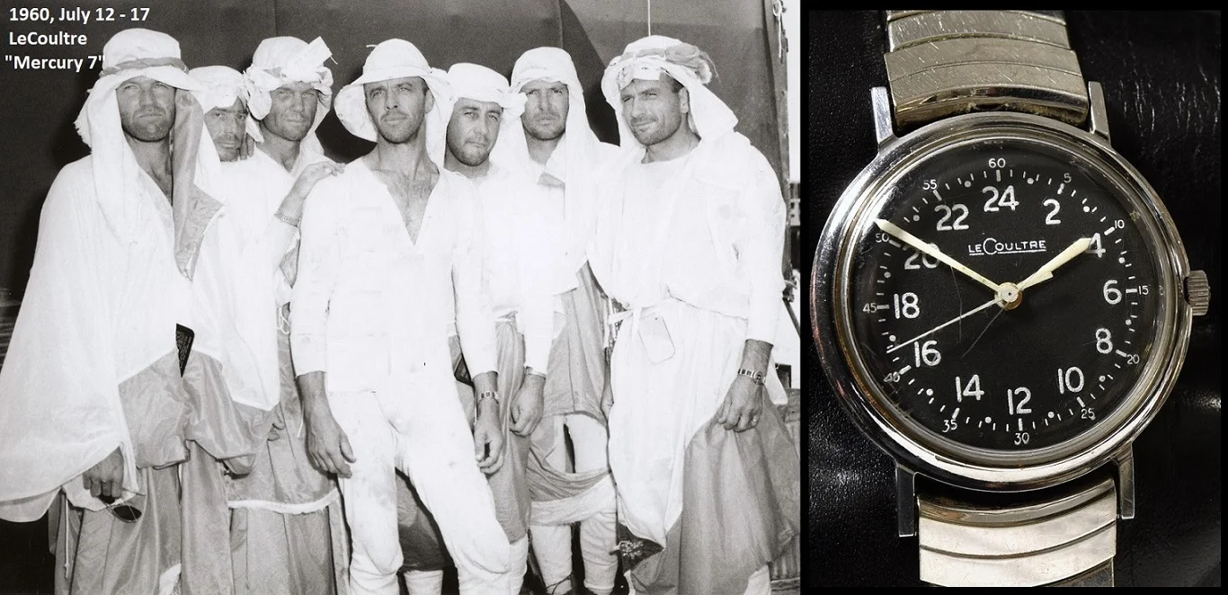

NASA astronaut Walter “Wally” Schirra’s 1988 book “Schirra’s Space” revealed that the 8th LeCoultre “Mercury 7″ wrist watch went to NASA STG engineer Harold I. Johnson, a member of Flight Control Branch Training Aids, who was responsible to get the wrist watches in the first place.
Although in sink with the Zulu time zone of the wordwide NASA tracking station network, the Mercury 7 astronauts only wore the LeCoultre 24 hours dial watches, nicknamed ” the Johnson watches “, during training and PR events between September 1959 and October 1963.
