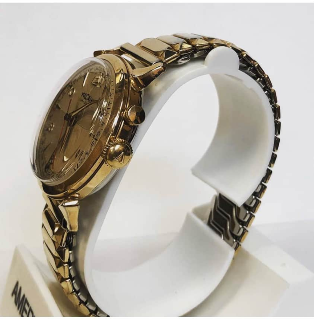

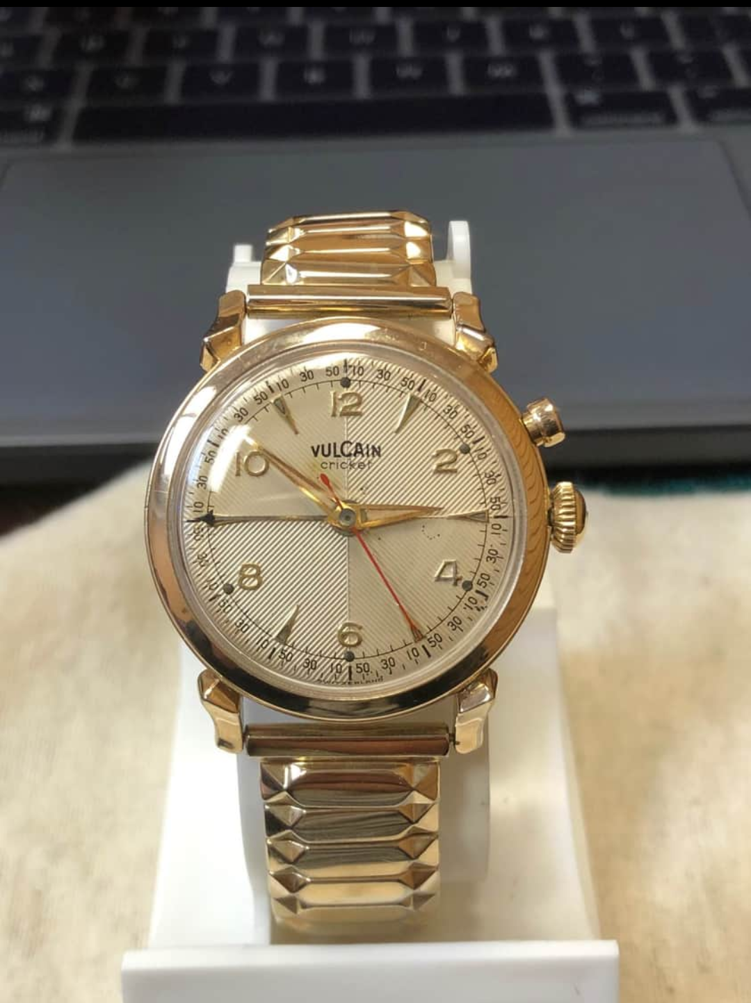

Once again I'm posting about something I need thoughts on. This time it's this Vulcain Cricket. Listing says it runs and I thought the dial was neat. Price is at $300 but no pictures of the movement. Slight discolouration on the dial and the case back looks polished but does anyone have any thoughts? Thanks!

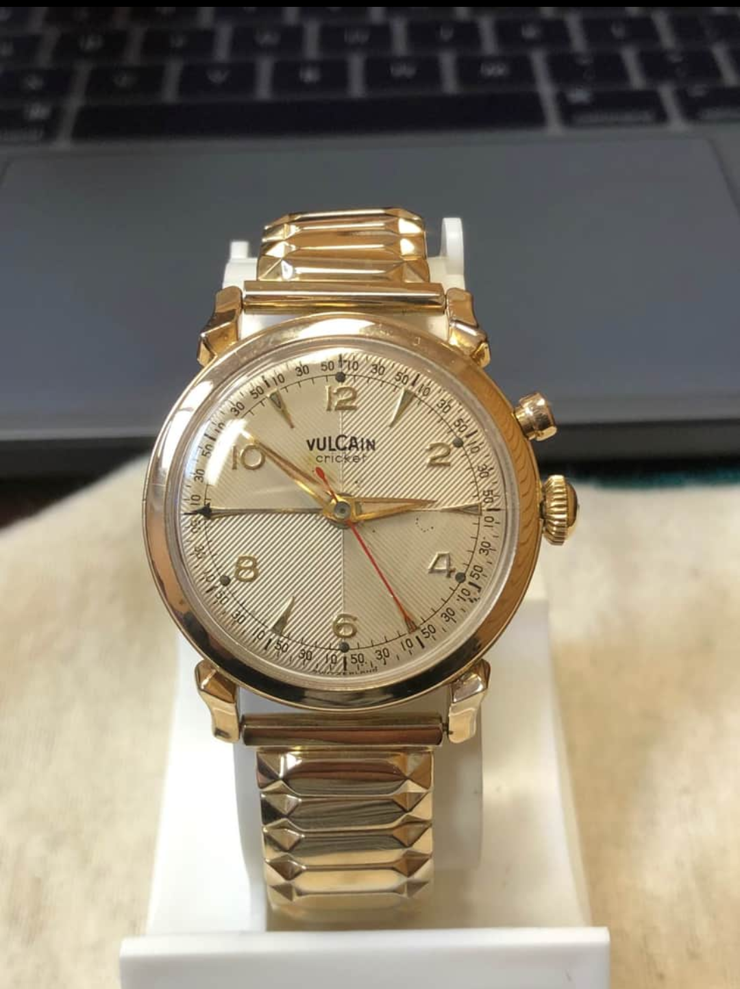

Would very much appreciate any comments on it!
The dial and hands look OK to me. The textured quadrant dial was a popular dial design on many watches in the 1950s, so your example probably dates to that era. The outer alarm scale is unusual. Your example should have the Vulcain in-house Caliber 120 alarm movement inside. Your case looks to be gold plated (these also came in steel) so check carefully for case wear before buying.

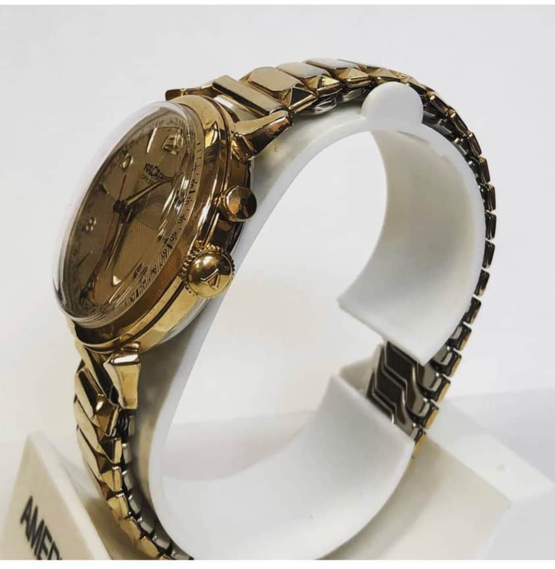

Are these lugs less common? I've looked around and only seen a handful of other examples with the same lugs.
I agree, the lugs are less common. Check for plate wear along the edges. If you buy it, consider replacing the metal band with a soft leather strap to avoid lug damage.

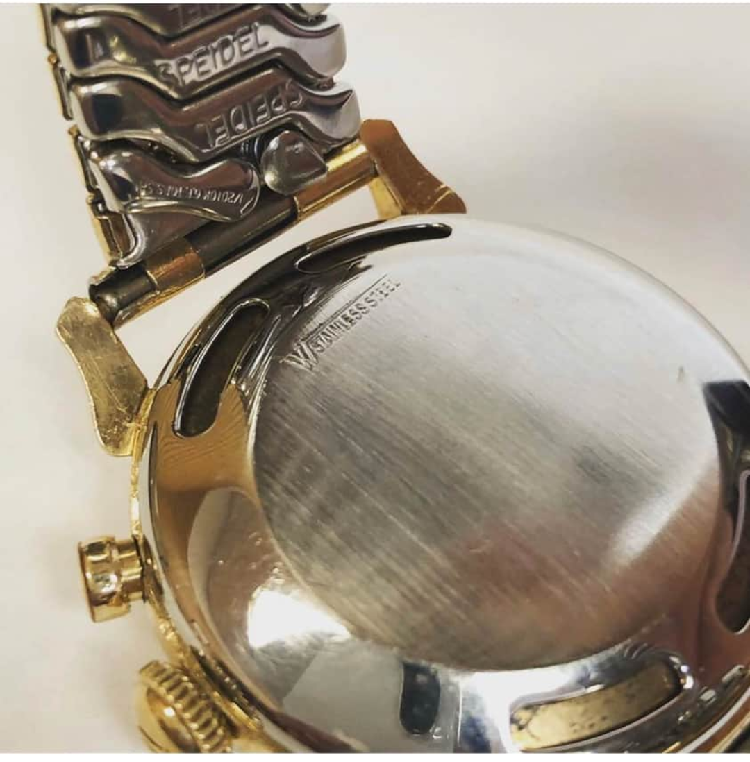

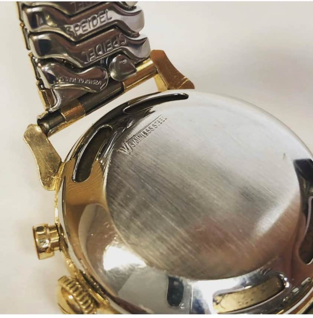

And I've seen other crickets with serial numbers on the case back
Based on the caseback markings in the photo above, I think your case was made by the Wadsworth Watch Case Company, a US case manufacturer. It was relatively common for Swiss manufacturers to ship bare movements and dials into the US and to have them cased locally. If your watch was sold into the US market, that would likely explain the uncommon lugs and a lack of a serial number as compared to the Swiss-cased watches more commonly seen.
