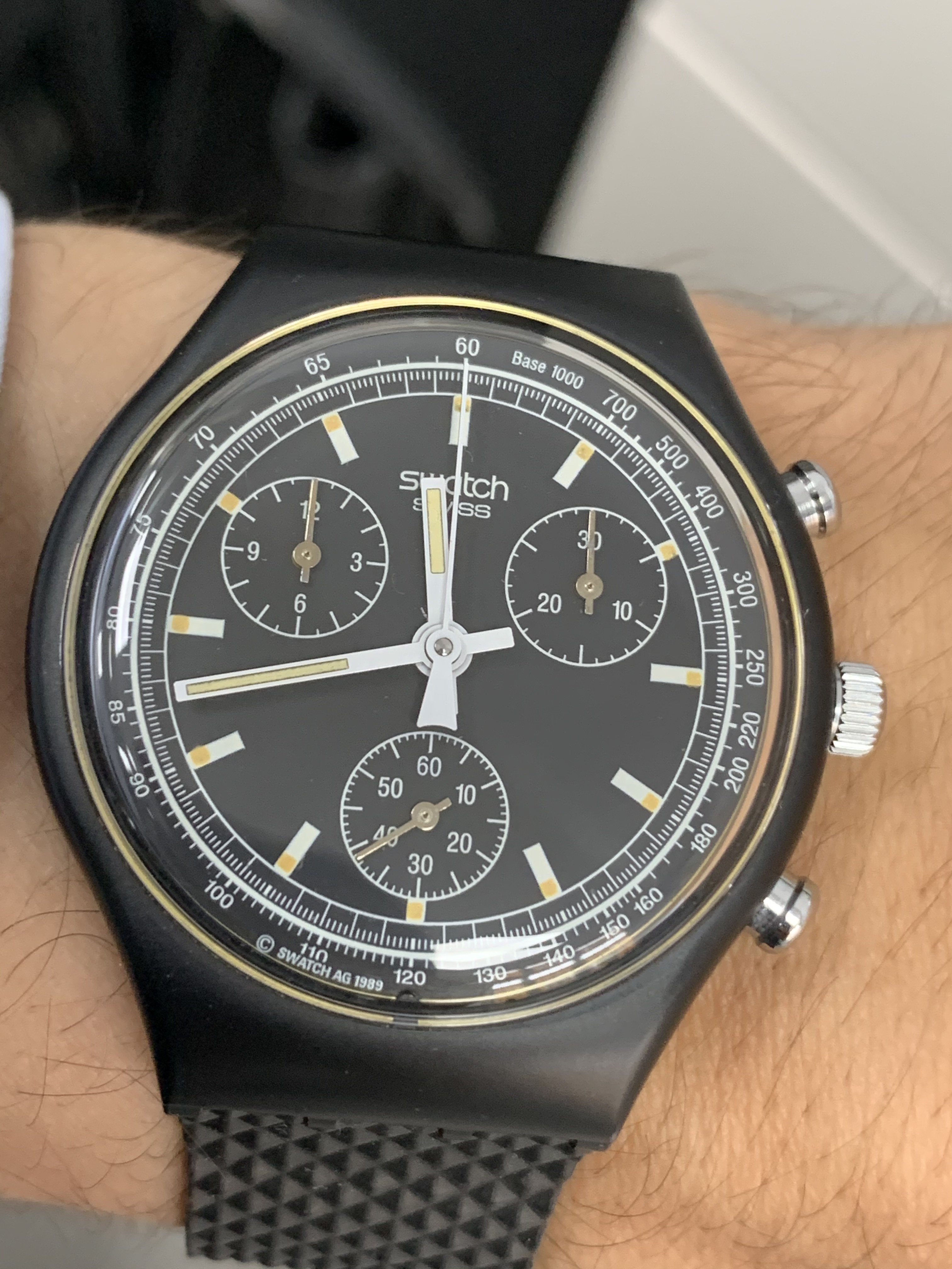

Just realised that I sold my most modern watch (<5 years old) in october and now I wear only vintage. I wear a couple vintage Omega watches on daily basis in office and weekends, but if active leisure is planned on weekend days I wear this - Swatch (!) Black Friday from my birth year and one of a few quartz watches which have charming lume patina.
