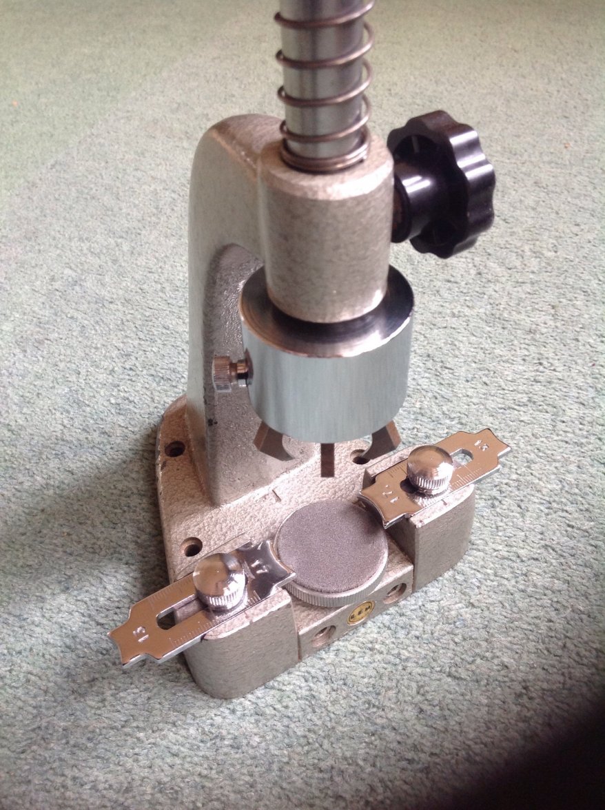

I don't have many, but recently scored a remarkably clean set of Mido case back openers, and given that I happen to really like the brand, I'm quite chuffed!

This is a great find. Congrats! I have a few watches that specifically need these openers. If you come across another lot, please do let me know.
-Khurram

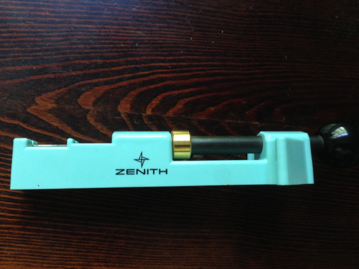

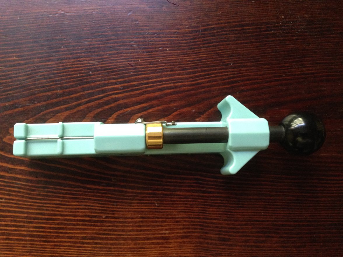

Here's one for a very specific job.
Now that is cool! Dedicated to one model, and color coordinated!

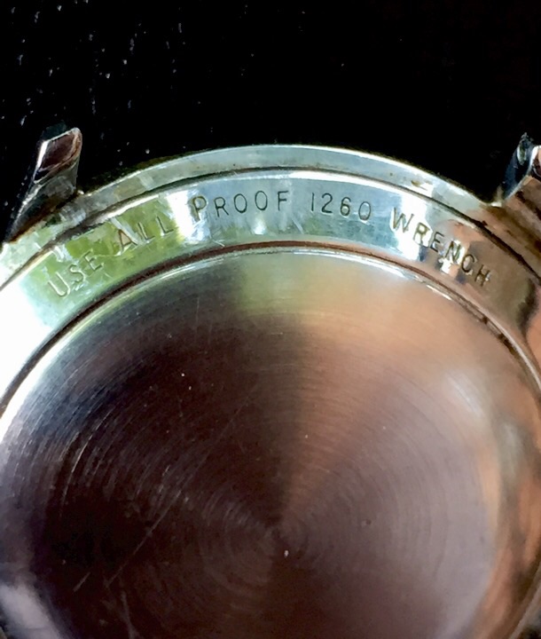

No vintage tools here. A deficit that is highly beneficial to my watches, by the way. 😵‍💫
But, I am curious....
Anyone have the proper wrench for this LeCoultre monocoque case, and if so, what does it look like?😕

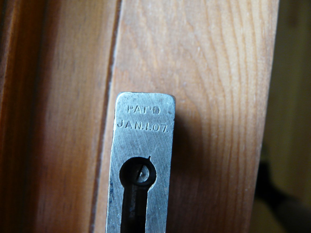

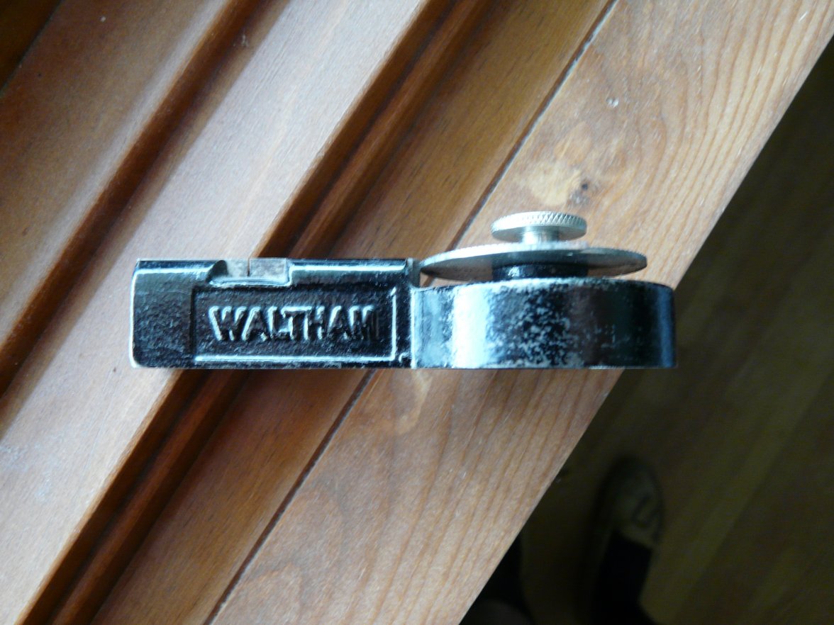

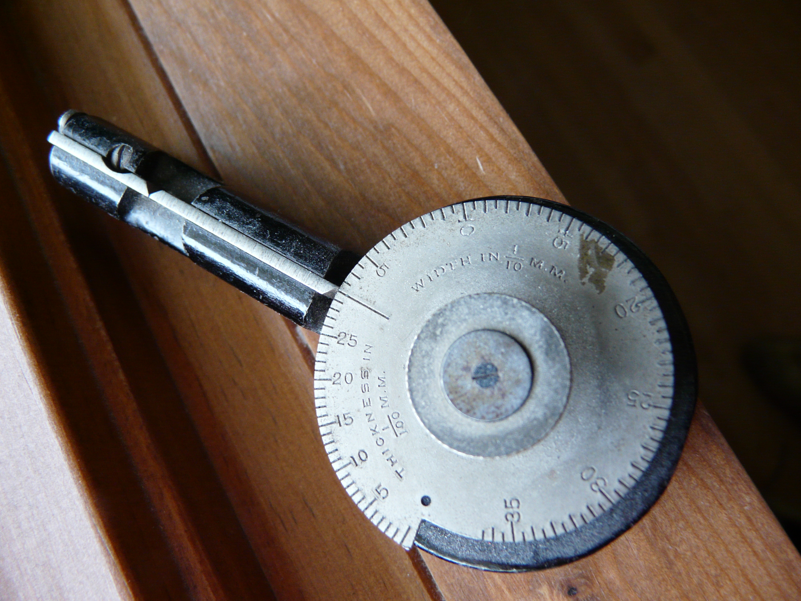

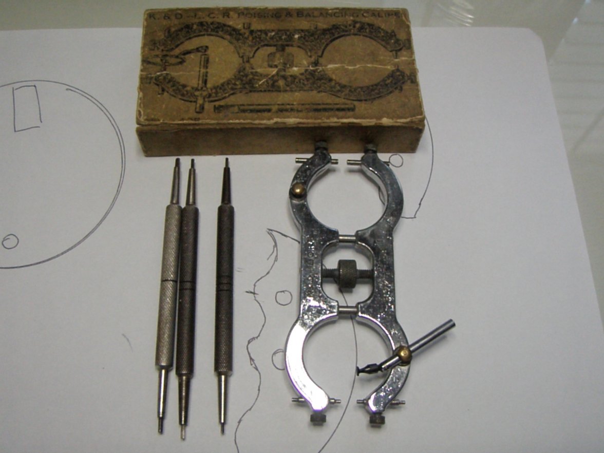

Waltham watch sping measuring tool..... I checked it in the lab at work, its still quite accurate.

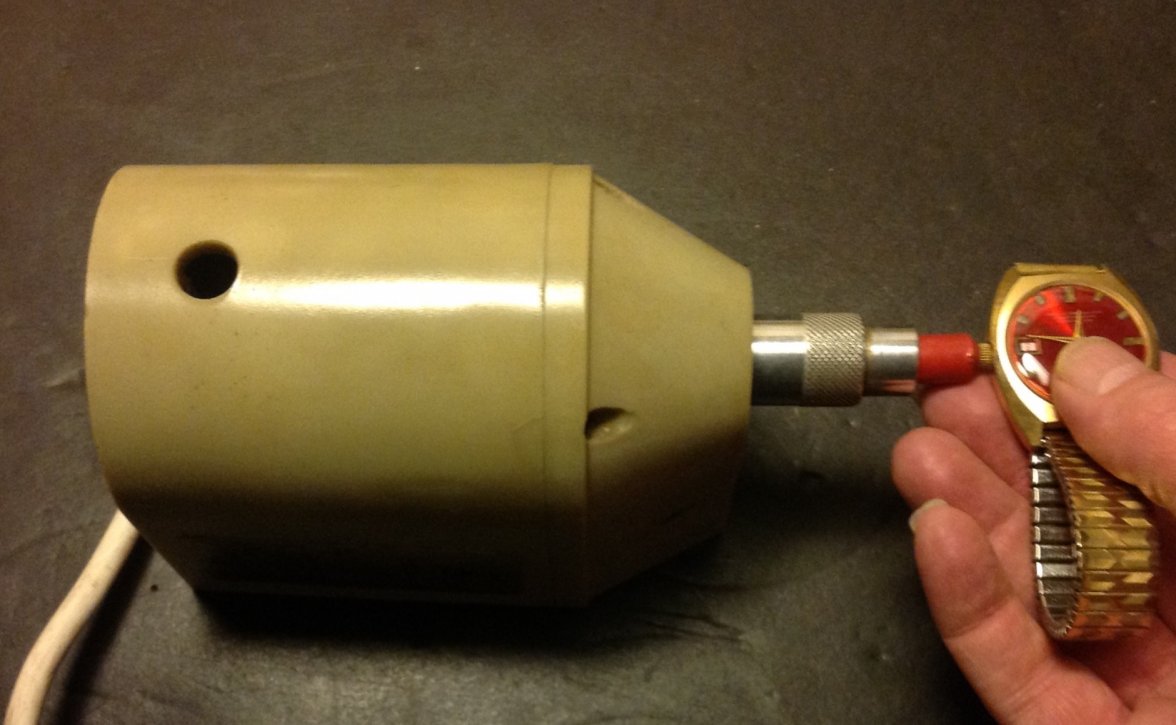

So! You have an antique pocket watch, and it needs a new crown. You have a crown with the right tap, and the colour and diameter are fine, but the I/d is too small to fit over the pendant of the case. What do you do? You use a reamer from an assortment of crown reamers like these.
You run a busy repair shop circa 1950. Many mechanical, manual wind watches on test that require winding every day. Necessary, but a nuisance. So, what do you do? You buy a Bergeon watch winder. Advance the crown to the rubber cup, press inward, the winder does the job for you, without damaging the watch!

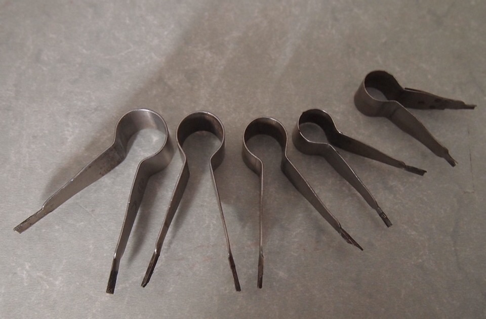

Vigor crystal lift - not expensive and does the job well. Cheaper and much better quality than the new Indian made versions are:
And when the small one just won't do...this large SUC model will:

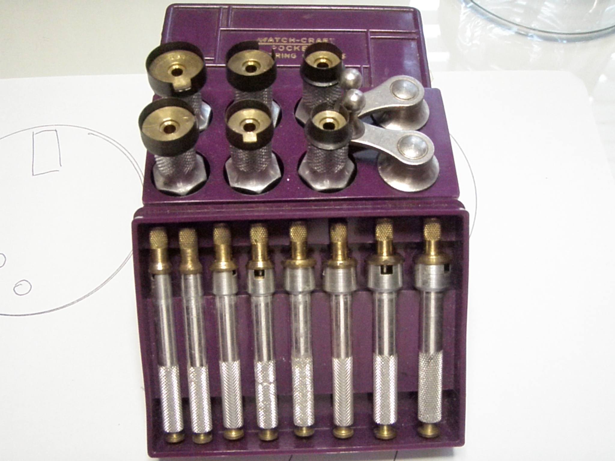

Winding mainsprings back in by hand is not good practice, so on those rare occasions when I might use a spring again (very rare), I use a proper set of mainspring winders. This Watch craft set can be had cheaply and is mainly for pocket watches:

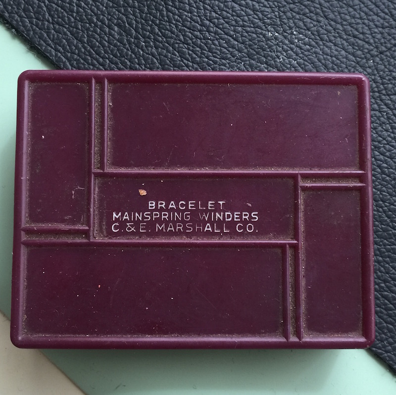

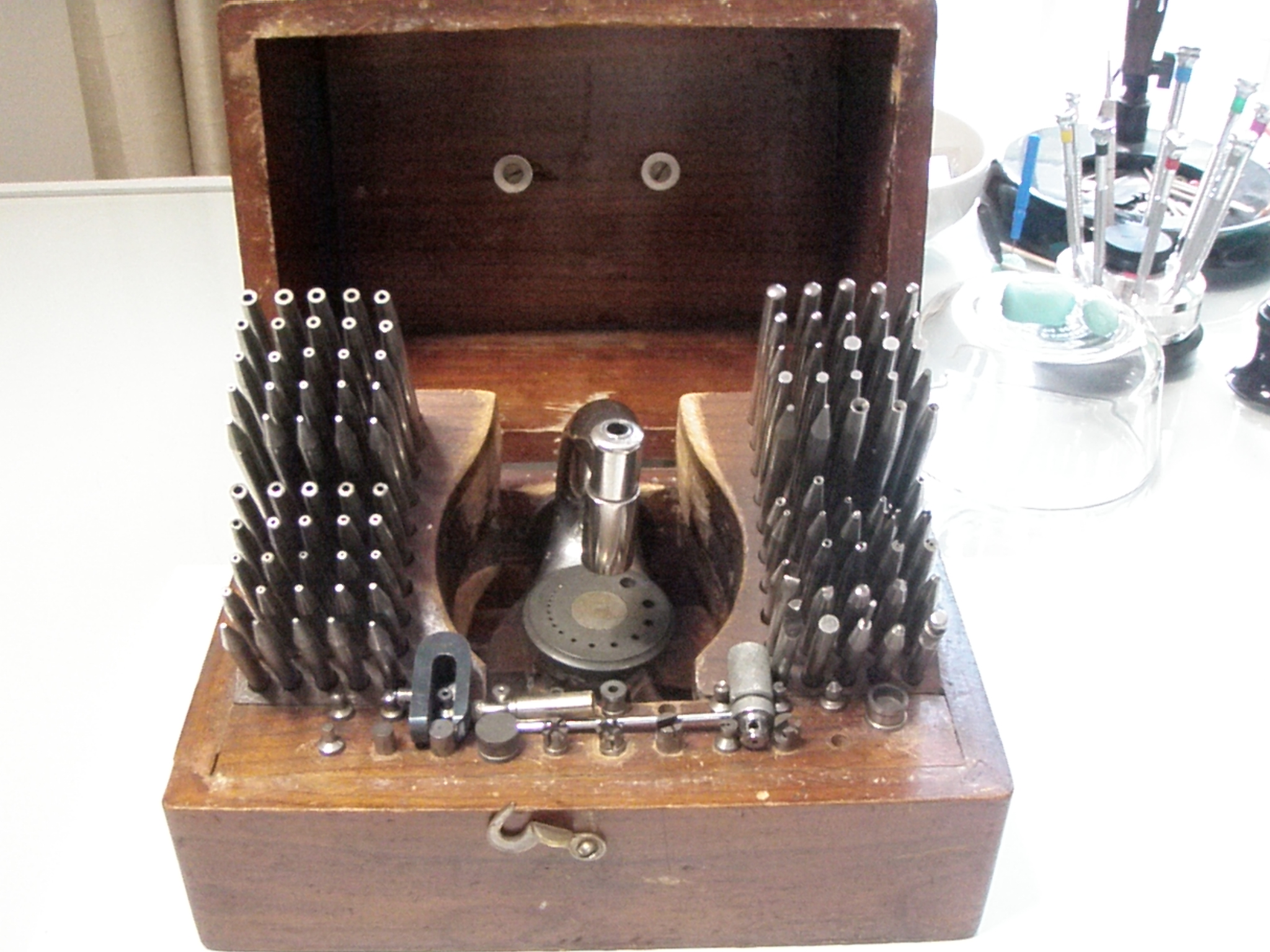

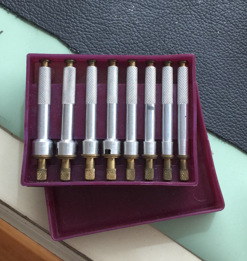

I can't afford the Bergeon winders Archer has so I have the other ones.
Winding keys and balance calipers.
And an old staking set which one day I hope to learn how to use.

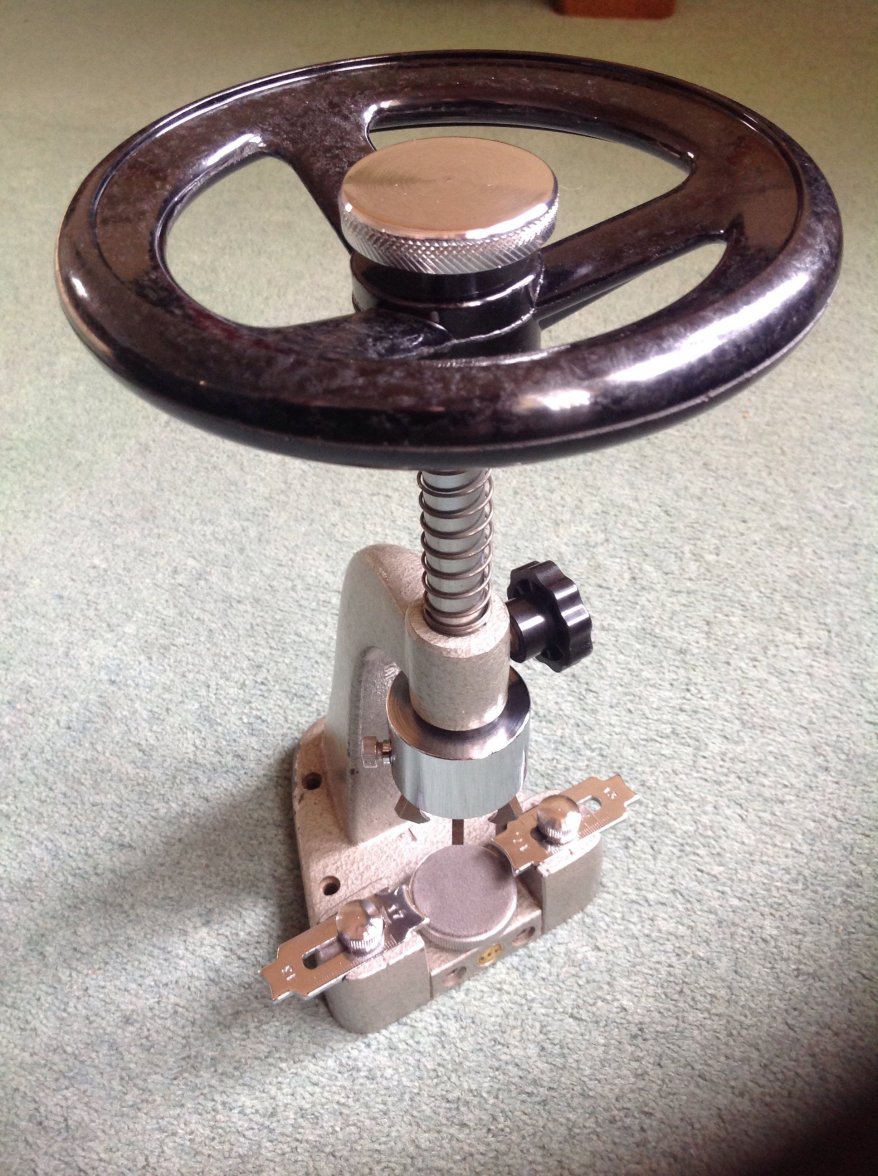

I inherited these recently. I just like having them around.
