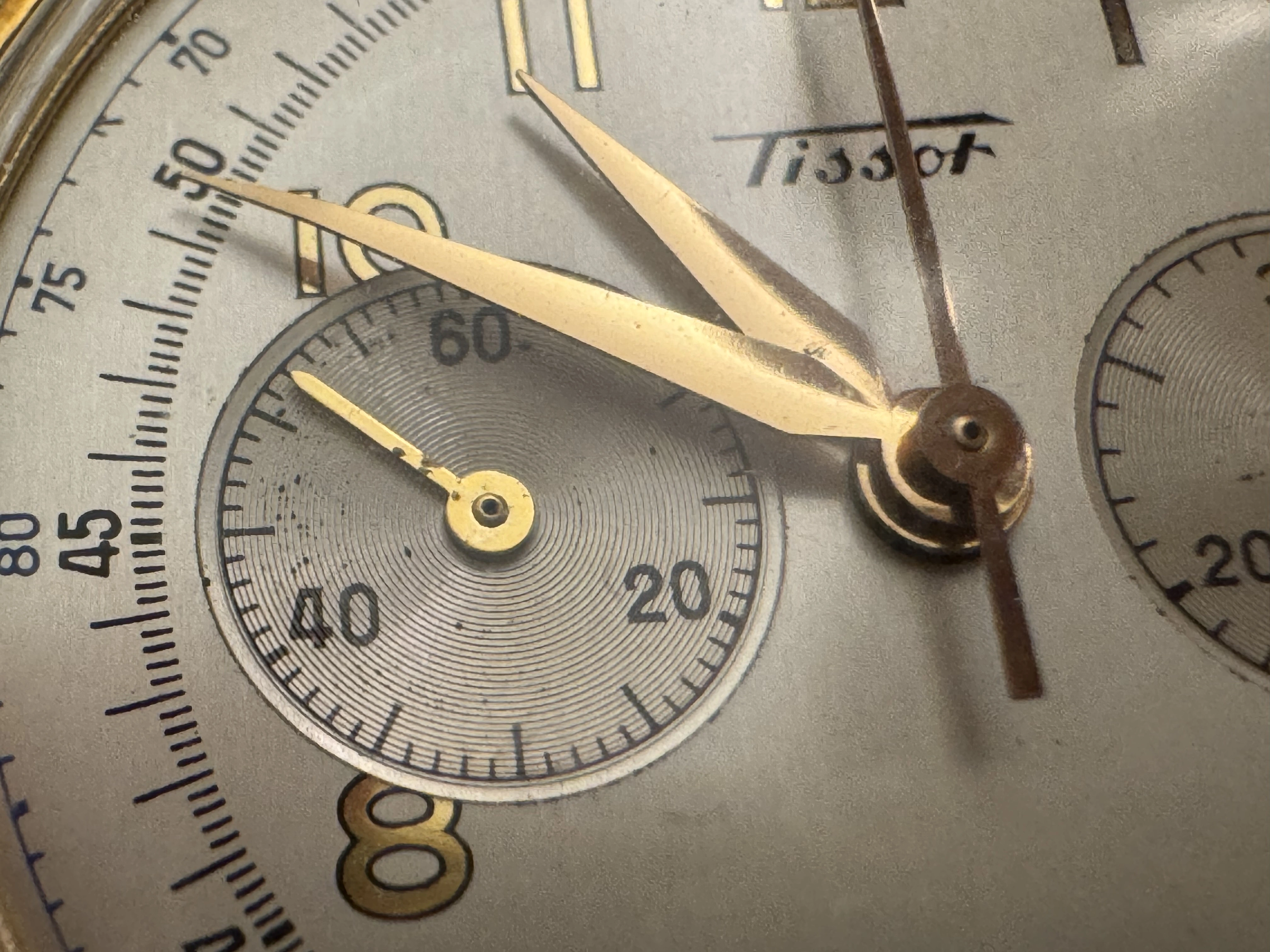

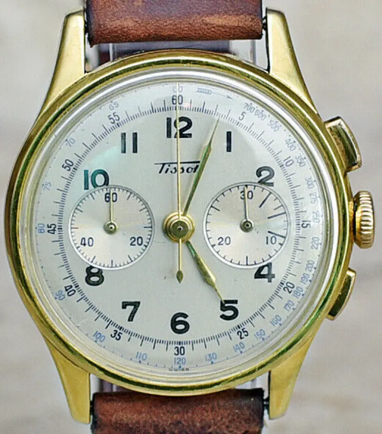

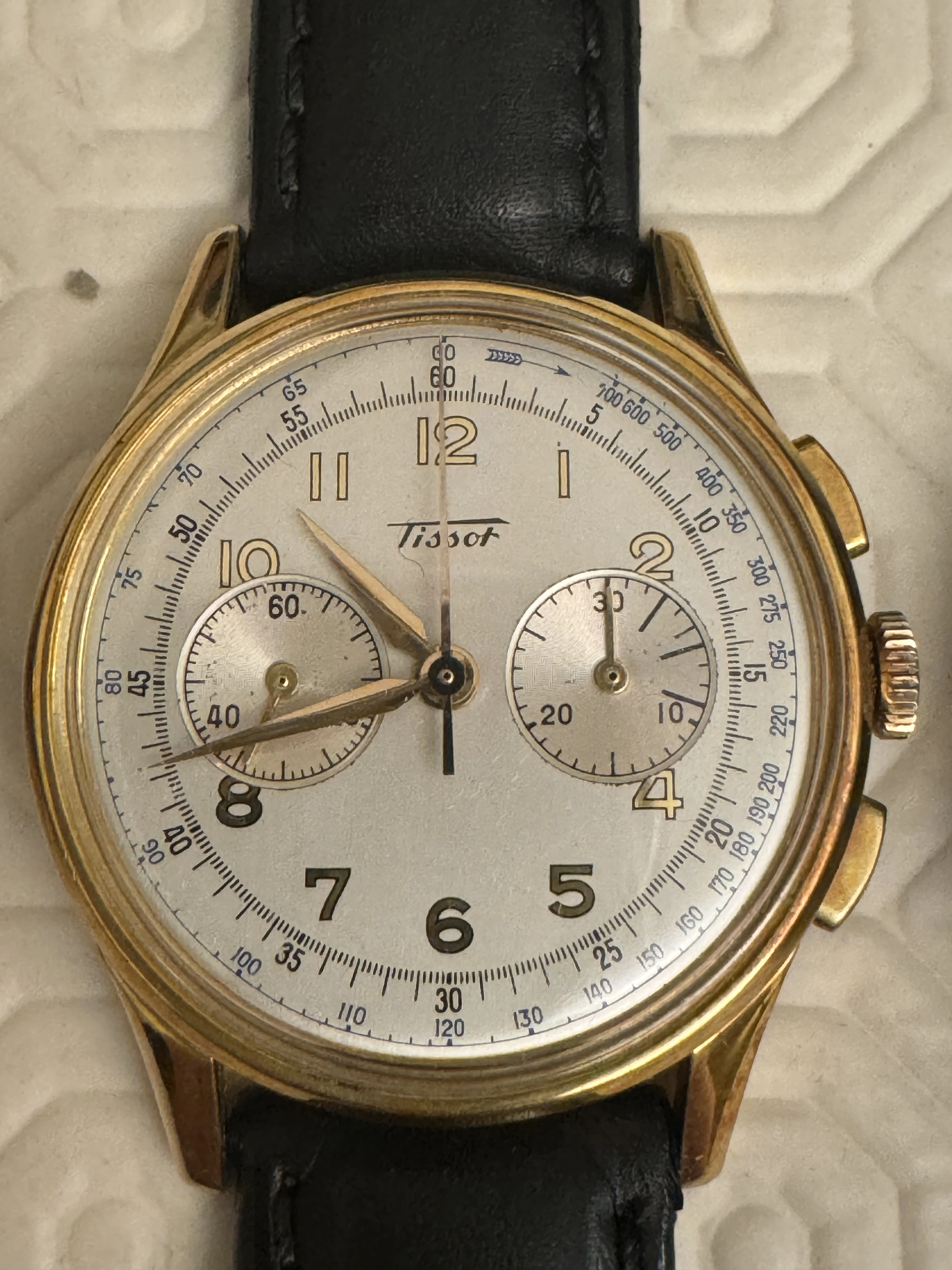

Hy guys,
I need your support trying to identify this gold case vintage Tissot chronograph.
It belongs to an uncle of mine who has been working as watchmaker for Demarchi here in Italy, when this Company was the distributor for Omega, Tissot and others here in my country.
I’m sure it’s original and “untouched” , but I would love to know something more as I asked my uncle to sell me.
I’d like to pay a right amount , fair for both me and him.
Thanks in advance
Antonio

Hello @Perry1980 and welcome to the forum! Just judging from the dial alone, it would appear you have a chronograph dating to the mid-to-late 1950s (no later than 1959).
To better give you the answers you are looking for, we would need to see pictures of the entire outside of the watch (top, bottom, both sides), the inside movement, and the information on the inside of the caseback. Your uncle may be able to remove the caseback for you. Please take some well-lit, sharply focused pictures and post them here.

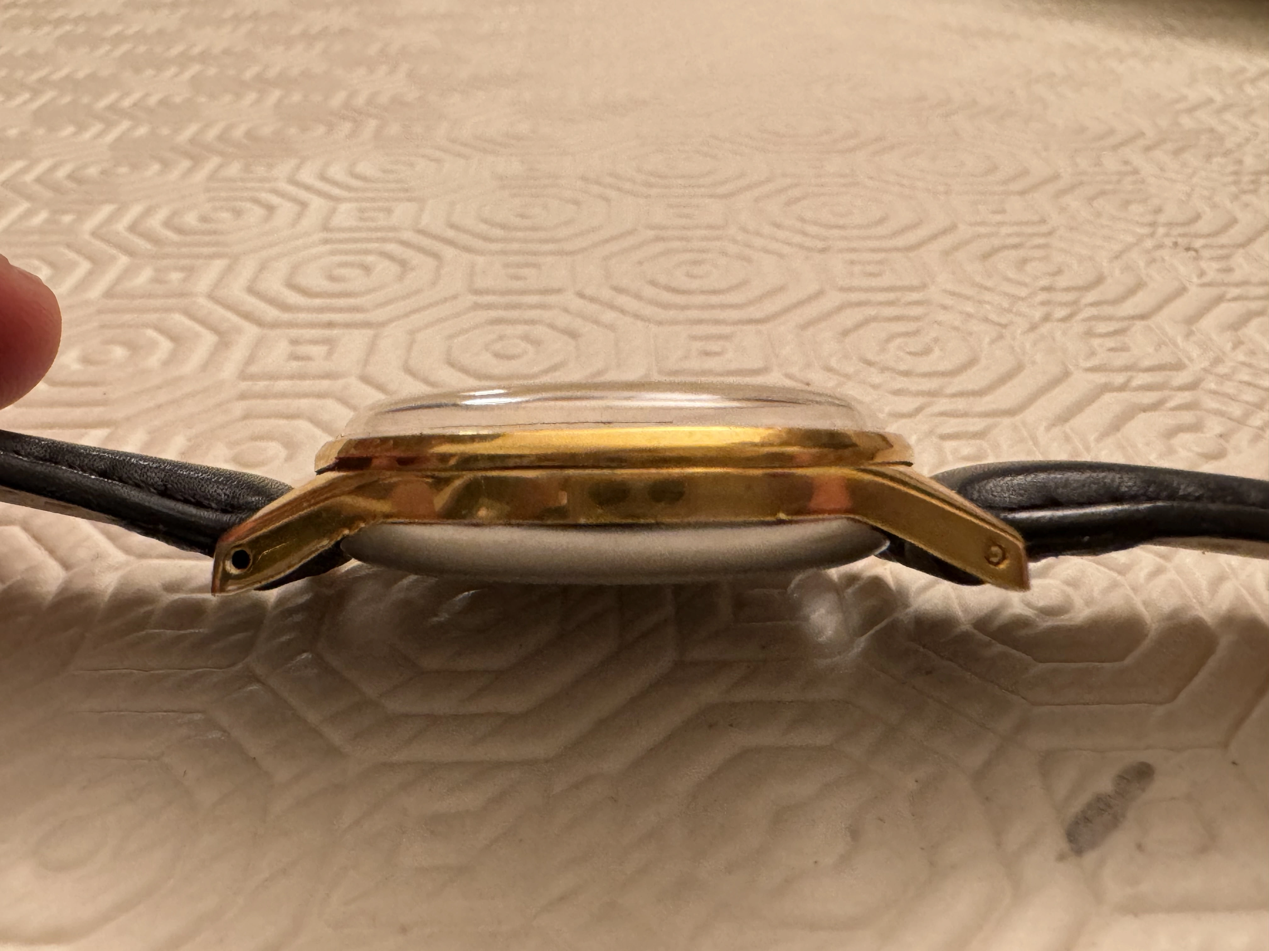

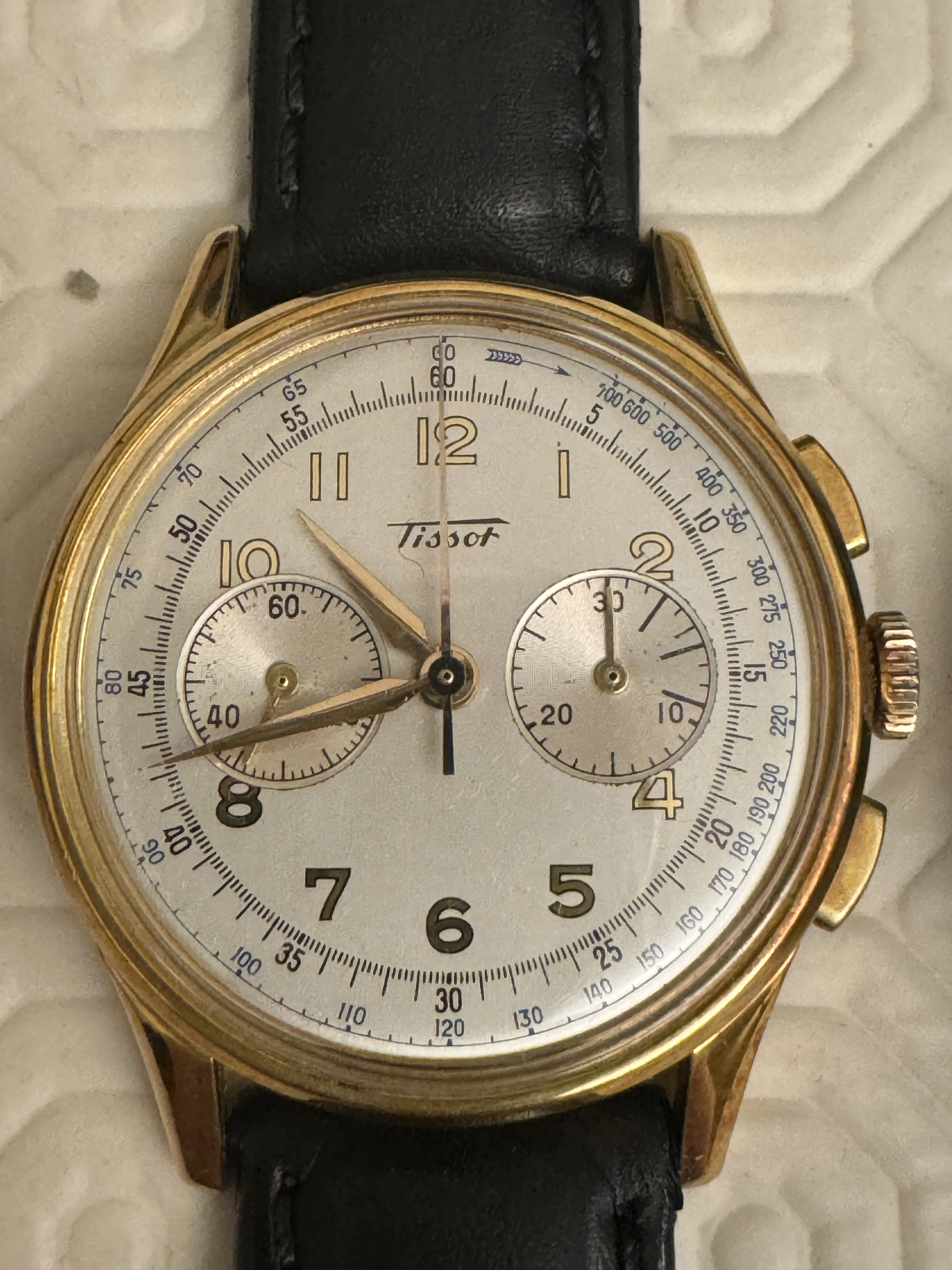

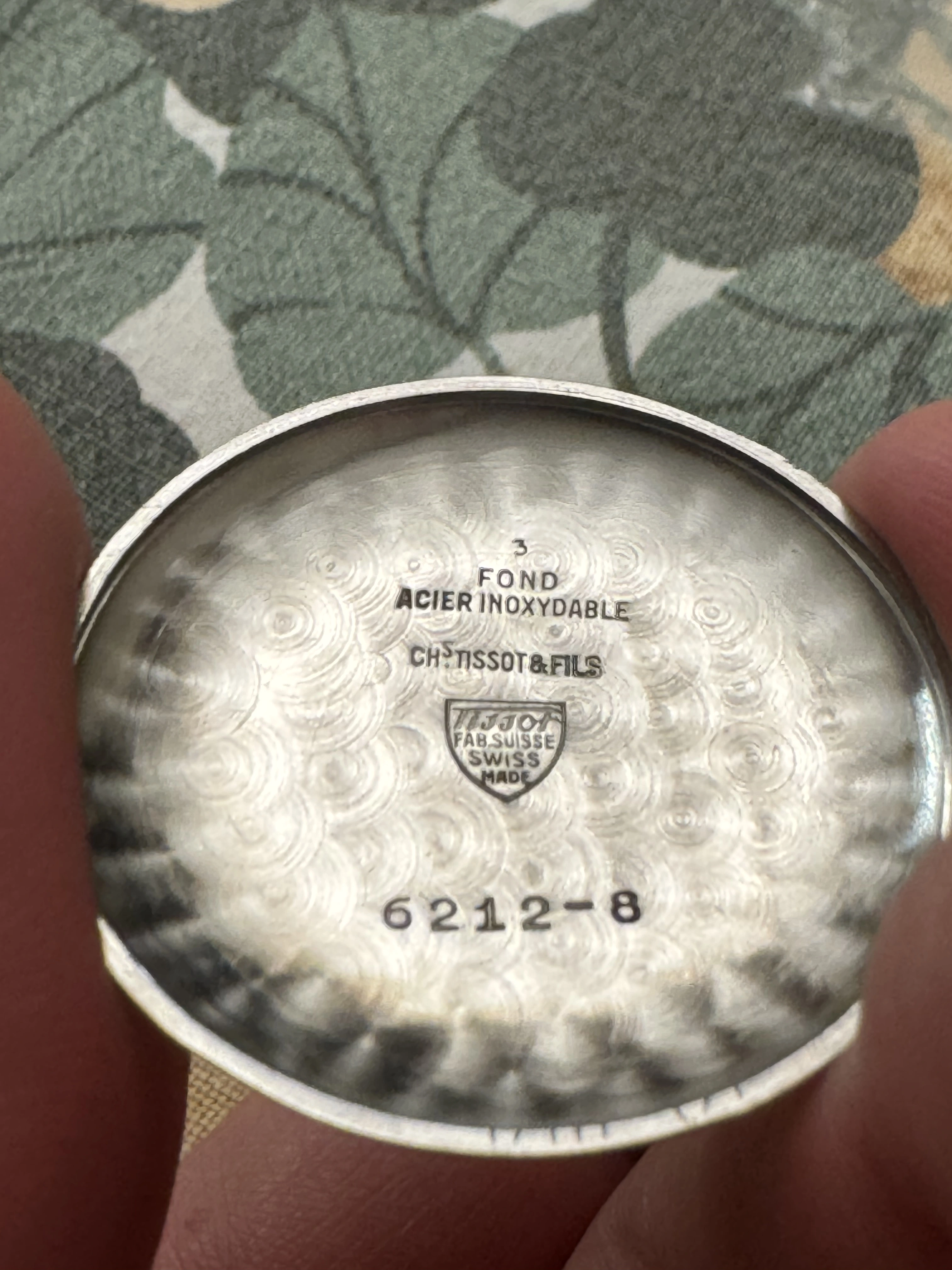

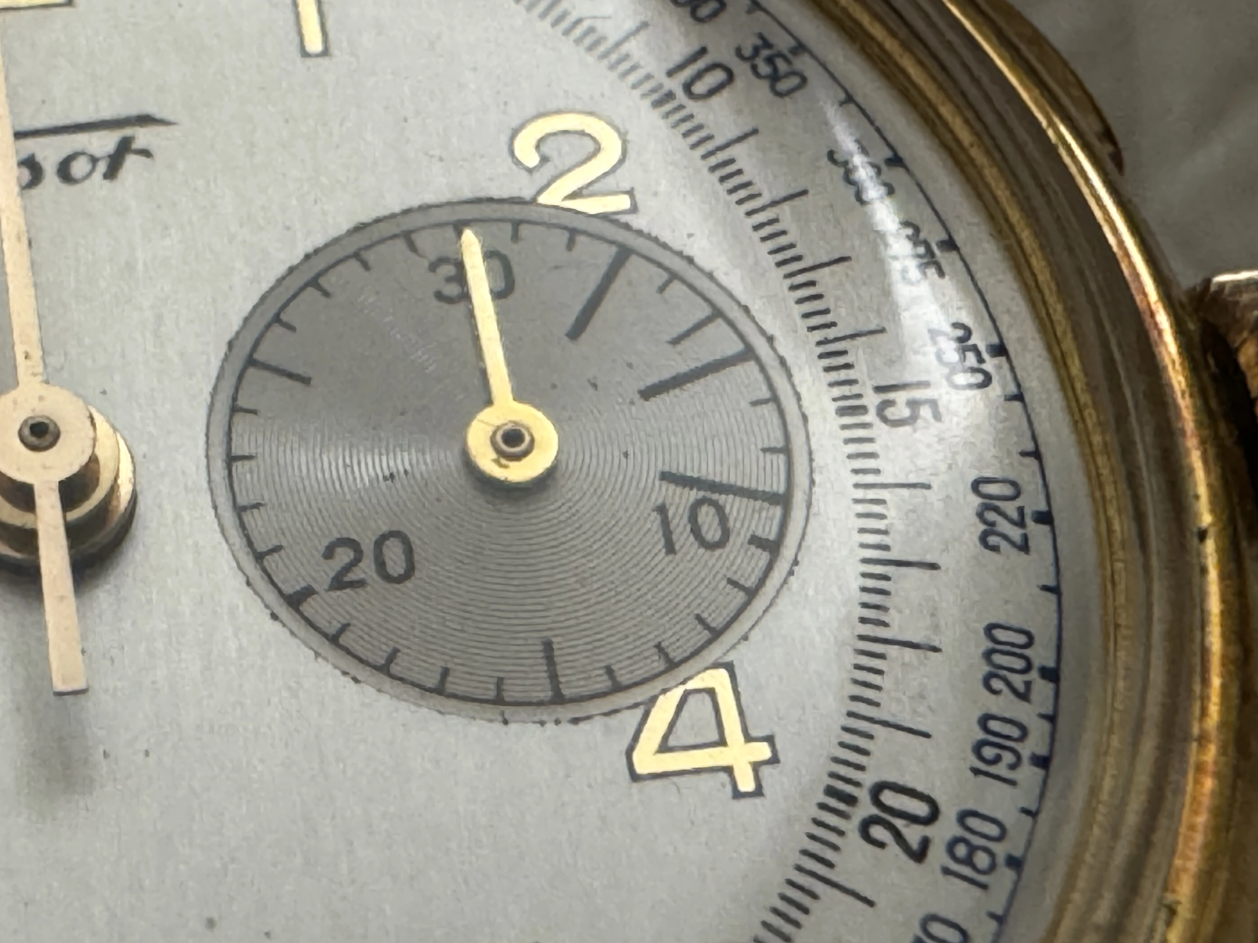

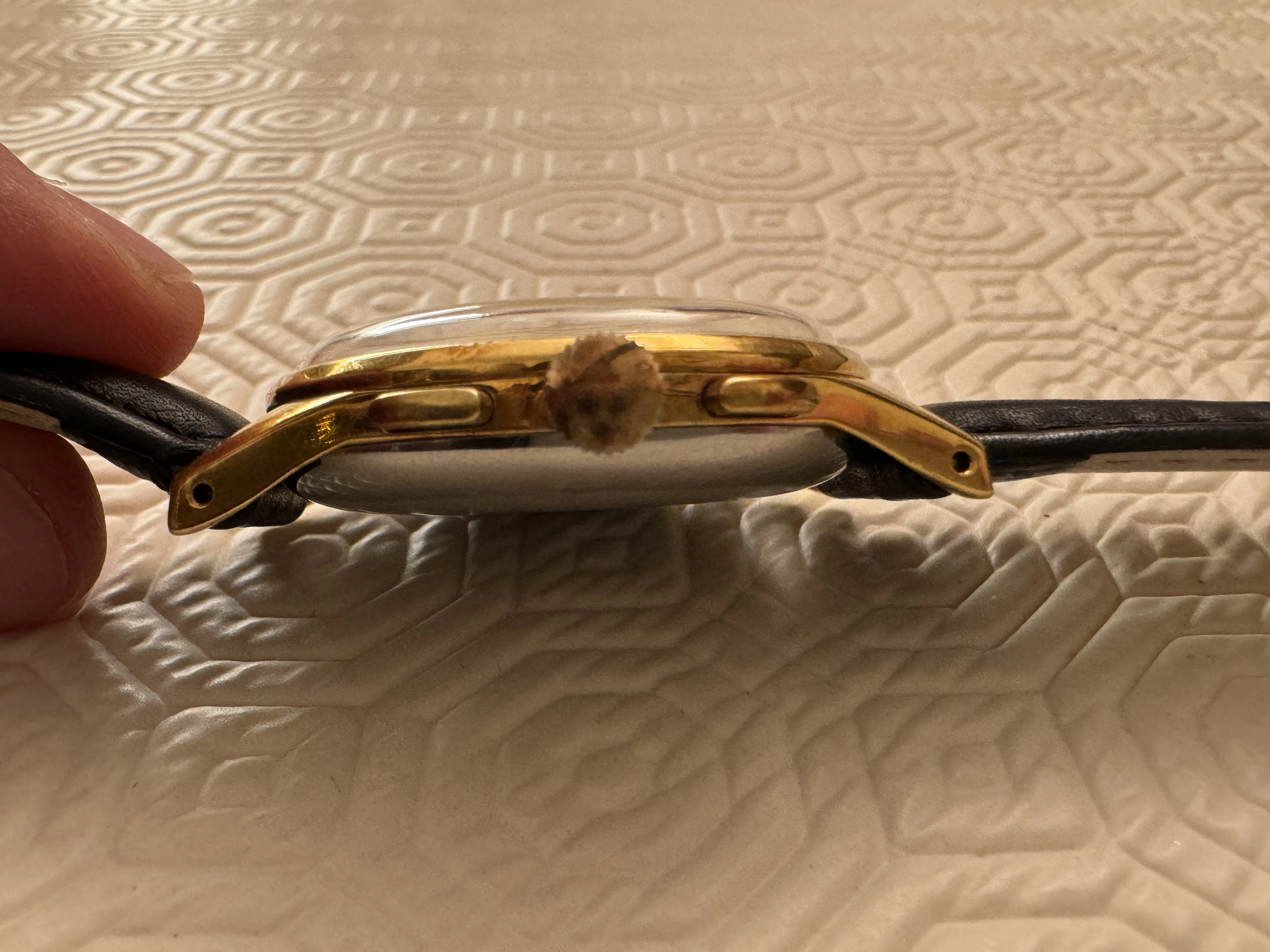

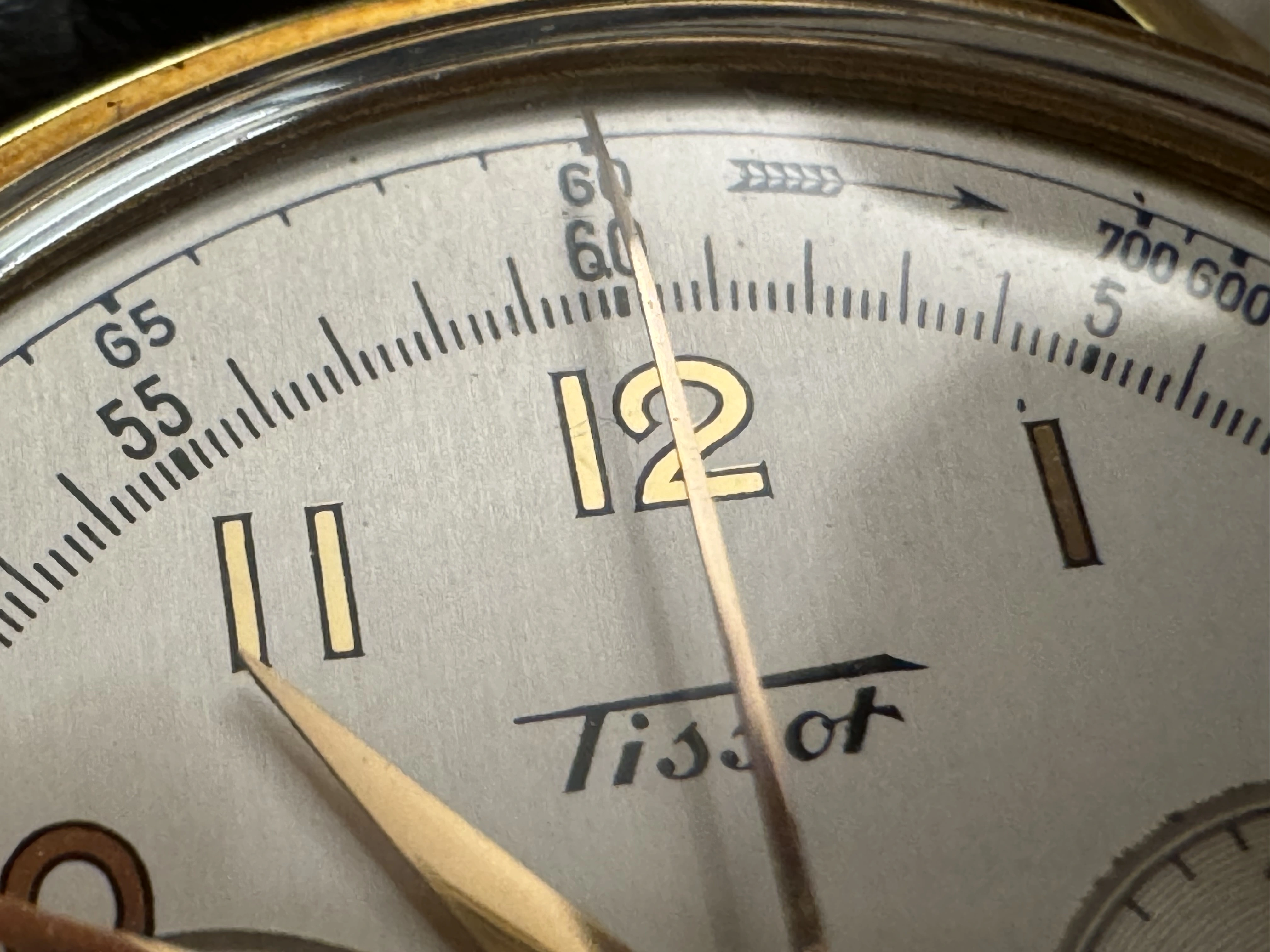

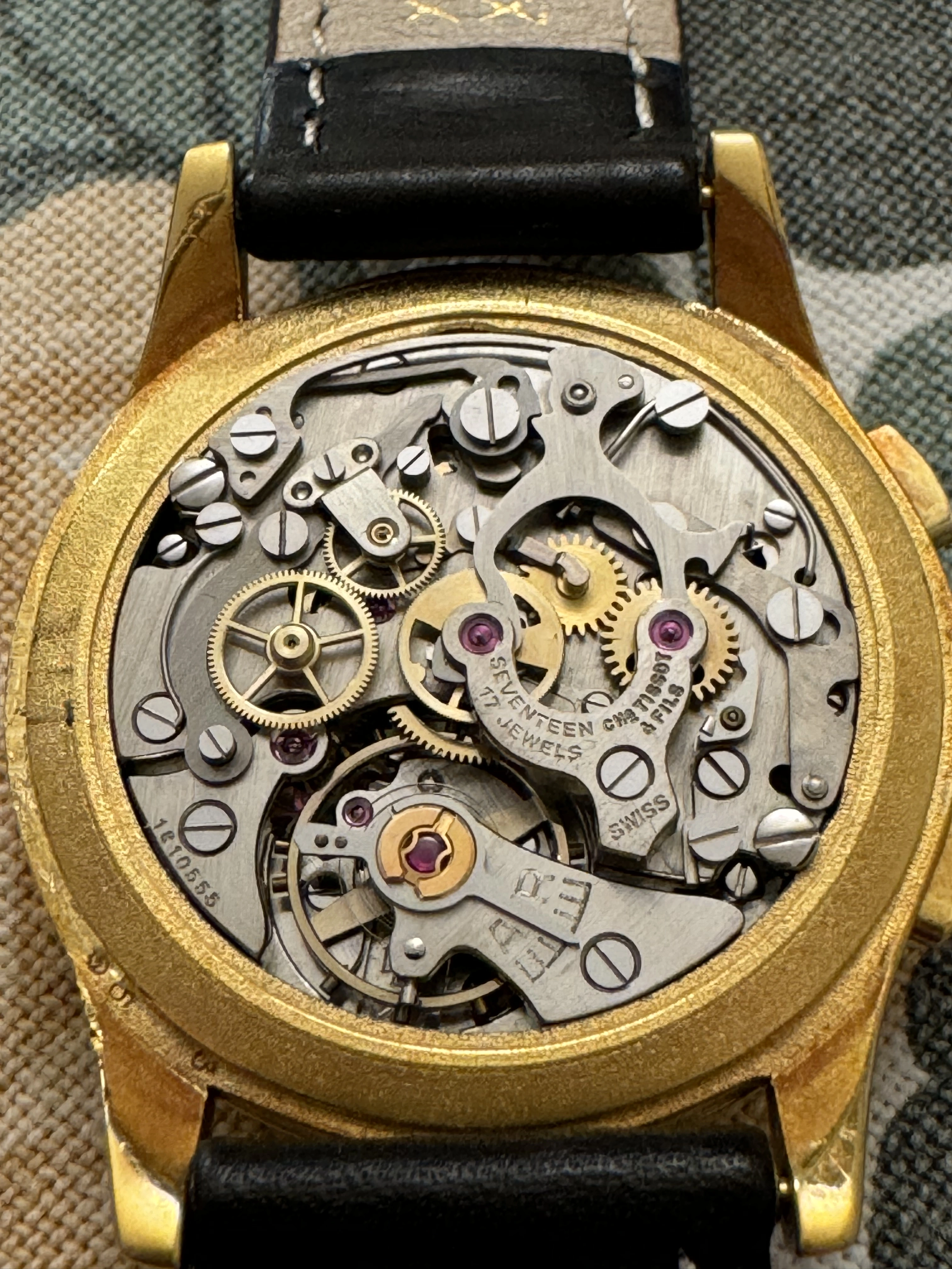

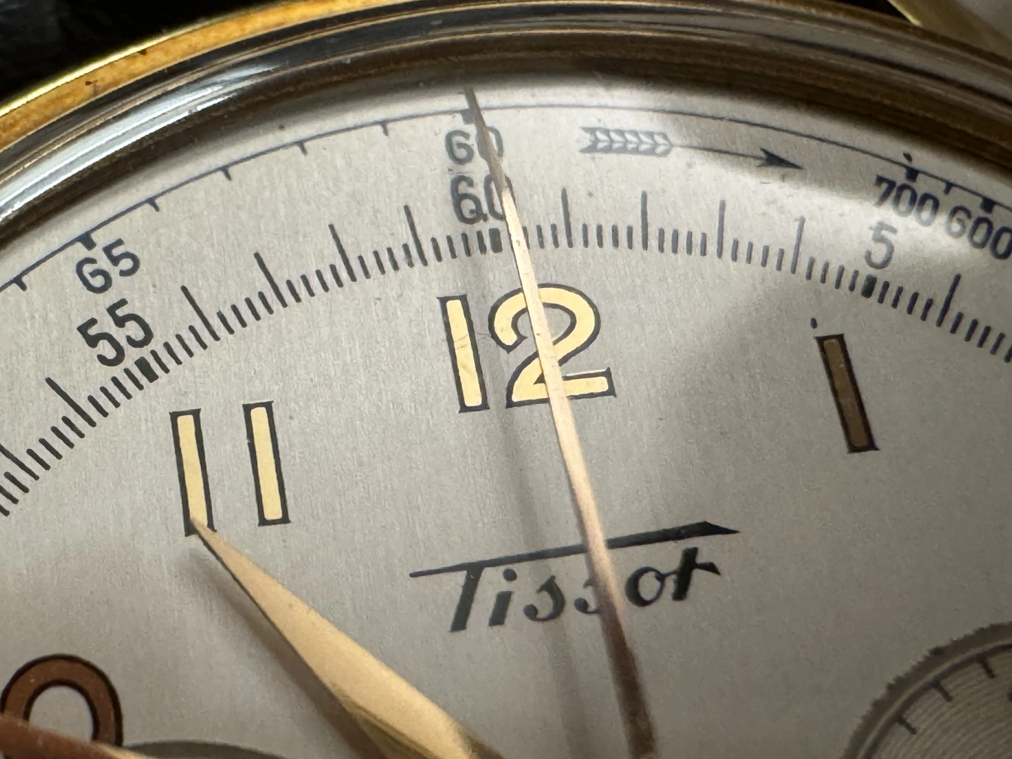

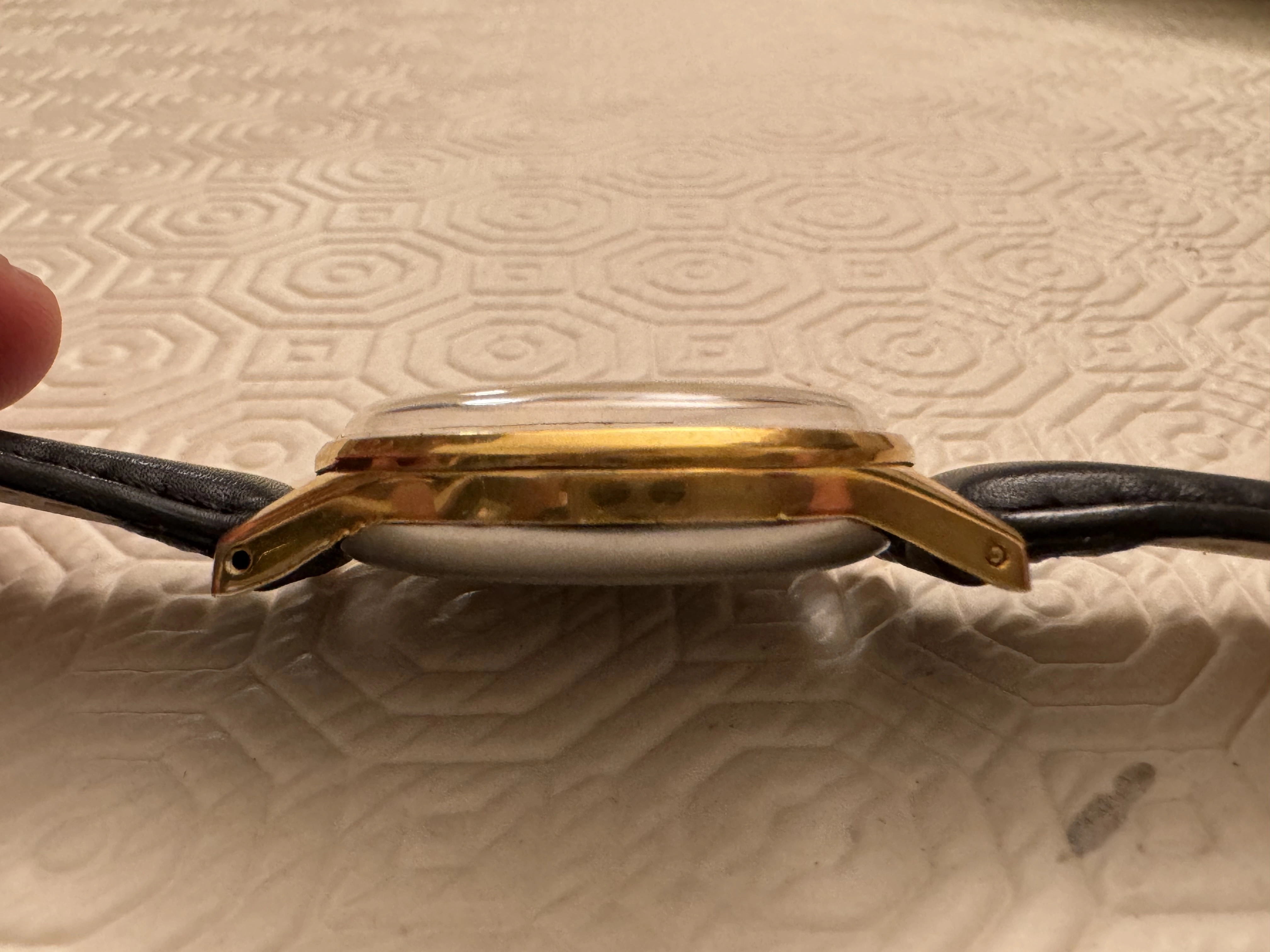

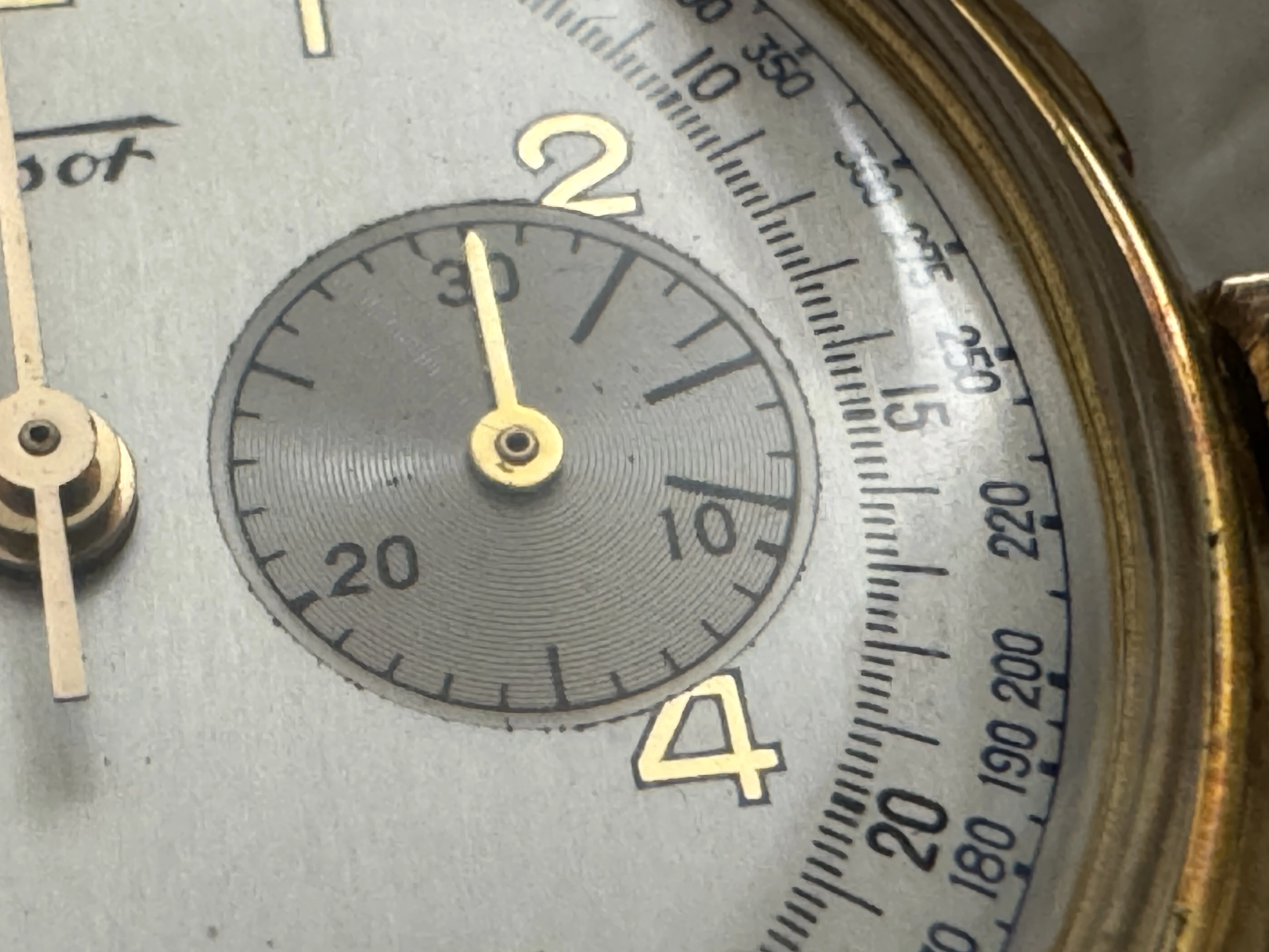

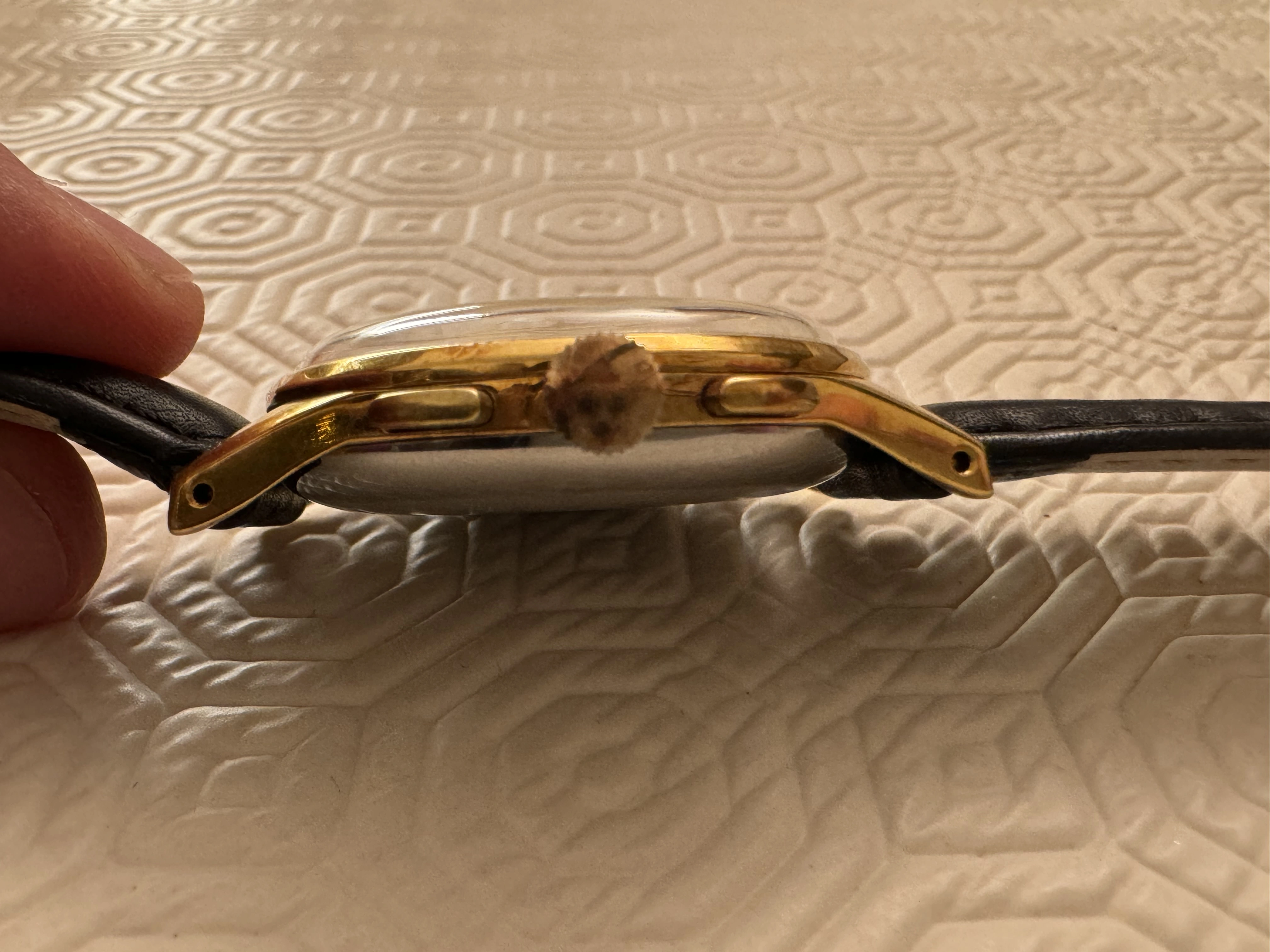

Sorry for the long delay of my response!
Here are some new pics of this Tissot.
Thank for your comments !
Antonio
3,278
14,261

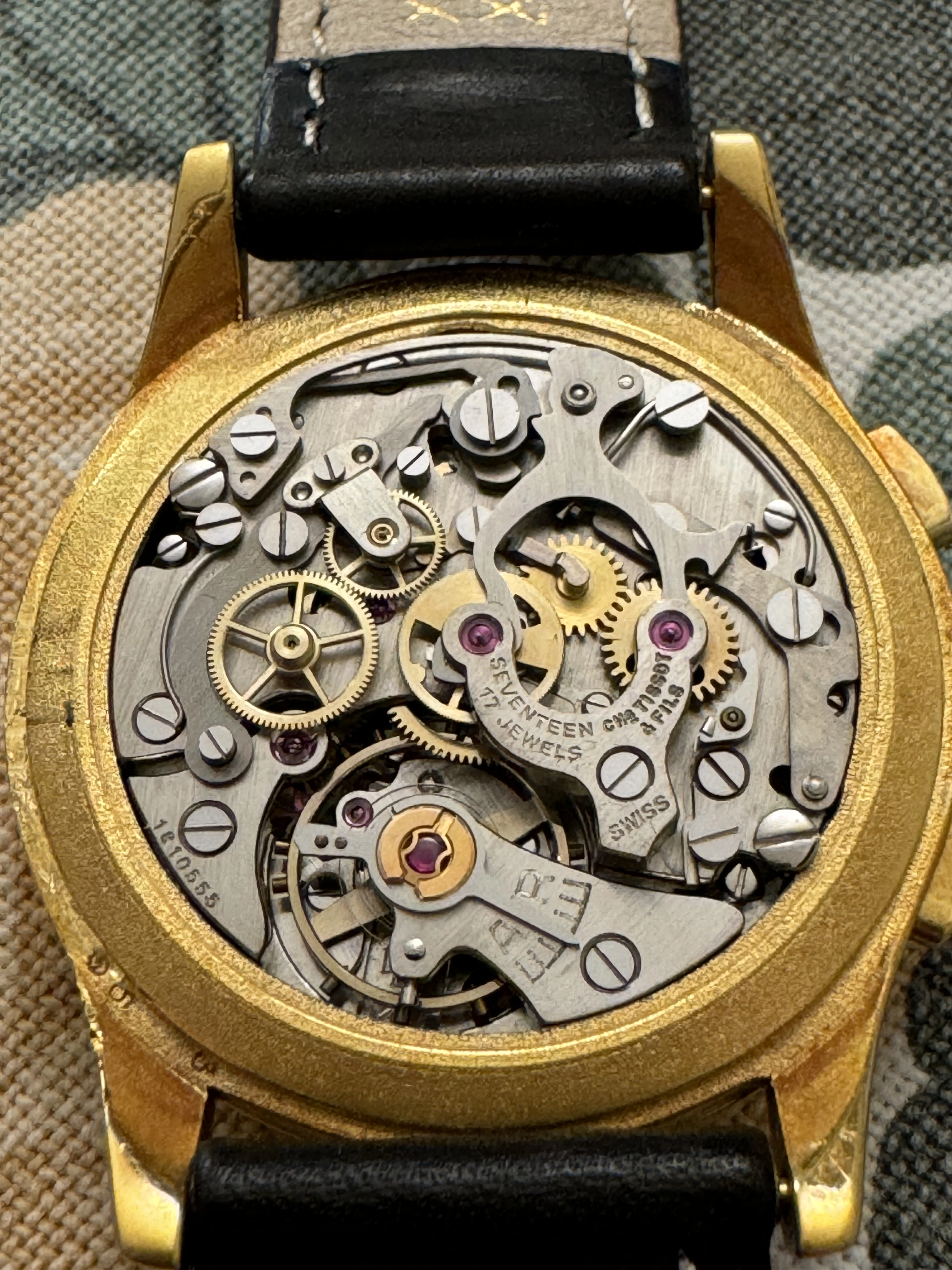

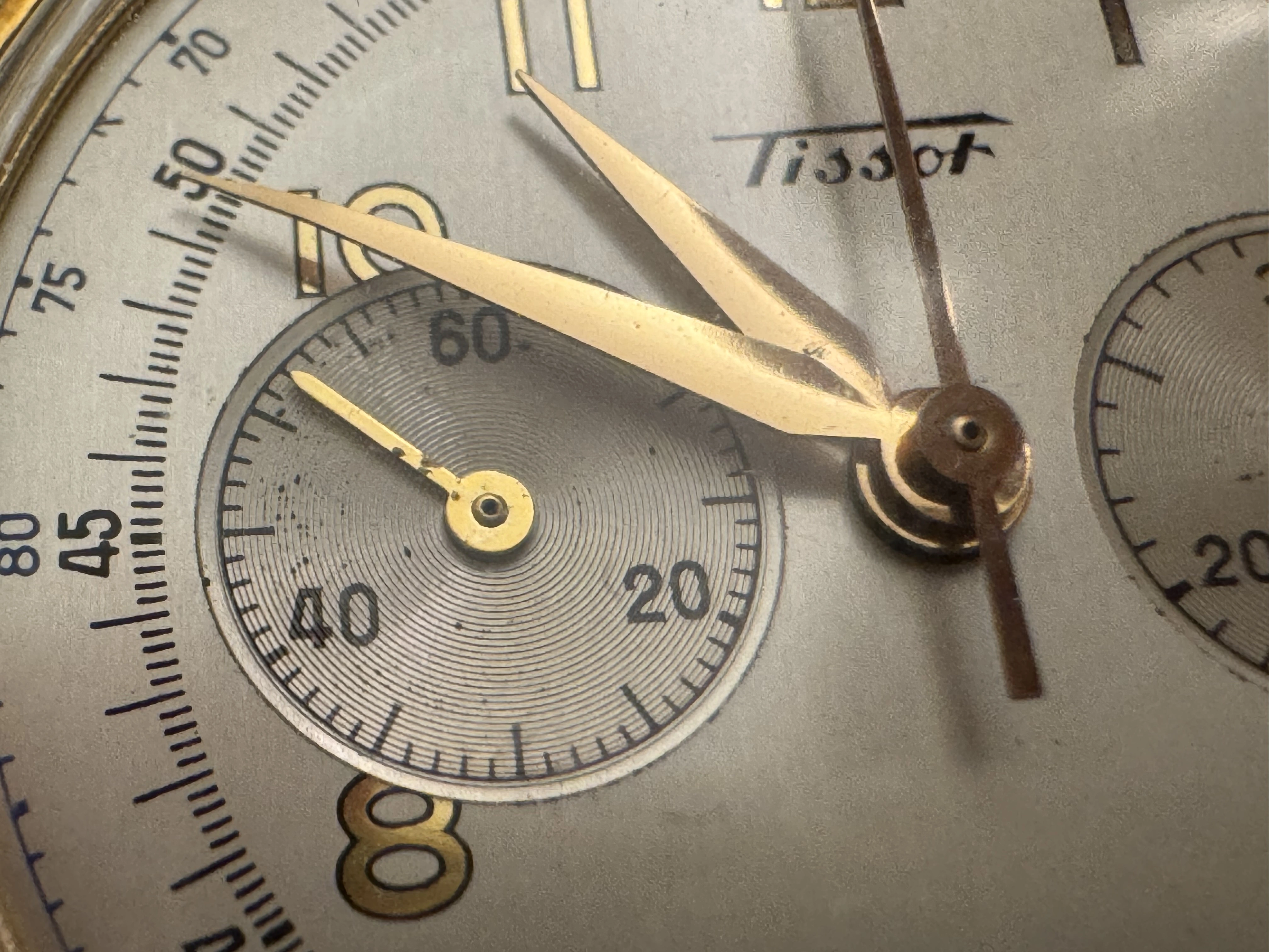

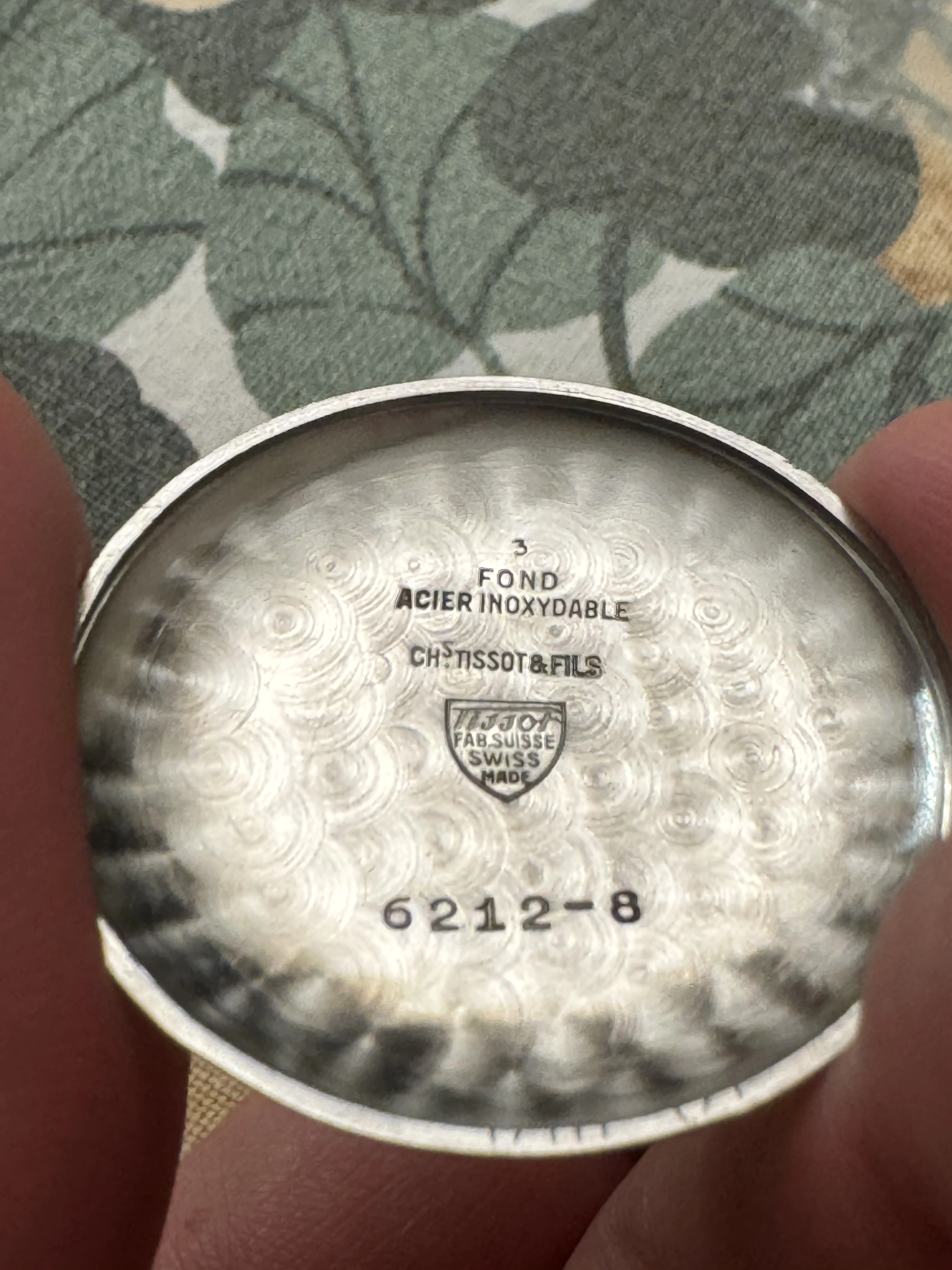

Based on the information from the inside of the caseback, your watch would have left the Tissot factory as a reference 6212-8. The 6212 was a family of two-register snapback chronographs produced between 1941 and 1948. The 6212-8 was manufactured near the end of that production run.
The 6212 chronographs were all based on the Lemania CH27 column-wheel movement. At some point in your watch's past life, the movement in your watch was replaced with a later movement, the cam-based Lemania 1277. The hands may have been changed at the same time, as Tissot preferred to use "plume" hands with that dial. Your watch would have left the factory looking more like this example:
As you may know vintage watch collectors like those on this forum prize originality above all else. Although the 1277 is functionally the same as the CH27, it was not original to that watch and that reduces its desirability to collectors.
As a family heirloom however, your watch has a value far beyond collectability. The modifications made to that watch by your family are part of its history now, to be best appreciated by you.

Why even ask questions if you only want answers that support your preconceptions? Clearly the "Tissot" engraving on the movement bridge is not original and I would certainly trust @Vitezi's judgement about the movement and hands. But go ahead and believe what you want to believe.
As for value, it's rather low due to the replacement parts and gold-plated case. Collectors take a clear-eyed view of these things when shelling out their money, old family stories carry no weight. But it's a pretty watch at first glance and I'm sure you will enjoy it.

I also noted that the Tissot engraving on the bridge is not original, which is plain to see. The Tissot engraving is crude and obviously added separately from the 17 JEWELS and SWISS engravings. I don't know who added that engraving and when, just noting an observation. Look for yourself and draw your own conclusions.
You don't have to be bothered by the fact that parts are not original, but threads like these are valuable for people who are learning and serve as archives for people doing research, so we generally try to be honest and we don't sugar-coat the facts.

1277 and 1281 are the same family of movements. 1281 is later version and three register so this is not a 1281 since two register.
That said I do think your reference was originally produced with the earlier column wheel Ch27.

I don’t know the other forum but advice is clearly wrong on movement. 1281 is three register and your watch is 2.
