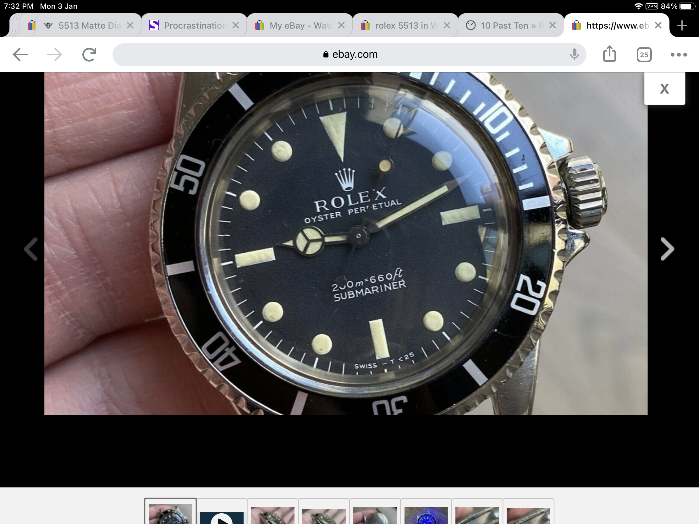

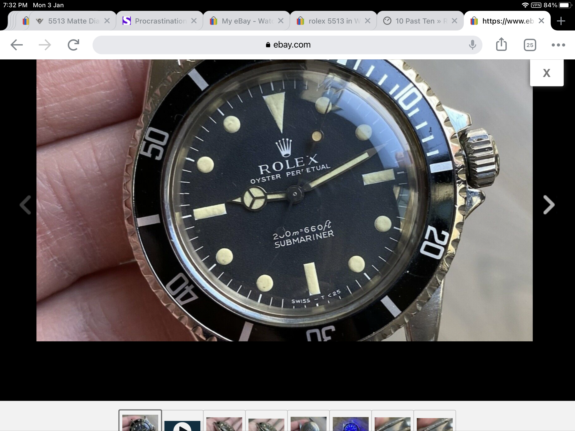

I feel like a bit of noob asking this but better to look silly than be silly!
Can it be assumed that if a dial glows like this it must be a re-lume? I would have assumed so, especially looking at the seconds hand but would appreciate comments from those who know for sure.
Thanks for your help

From the plain light shot, it looks like a relume for me. The lume is too uneven and indented for an original with that level of glow

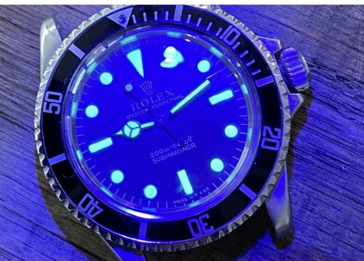

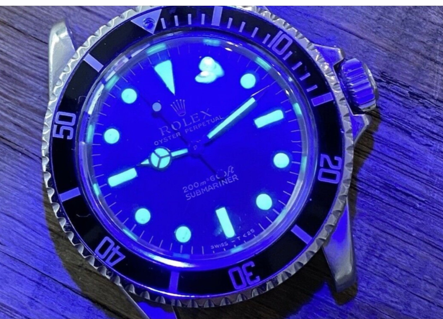

Google rolex zinc sulfide to find out how 5513 MF lume should respond during and after UV excitation. The insert is not correct as you probably know.

Thanks for your suggestion,
I have just found one of your previous posts where you mention uniformity among all hands, another cause for concern is the smudging around the 6 marker. Therefore I have come to the conclusion it is most likely a relume as the correct examples did not seem to show this. And I could have accepted the non period correct insert but the dial less so.

I agree that the sweep hand is re-lumed, but I'm not sure there's anything wrong with the dial based on those photos. If the lume dies off immediately when the UV source is turned off, it's about what I would expect. And the domed/puffy shape of the lume is also typical for MF dials. The missing insert definitely affects value if you decide to make an offer. A proper long-5 isn't easy to find and would cost more than $2k USD.

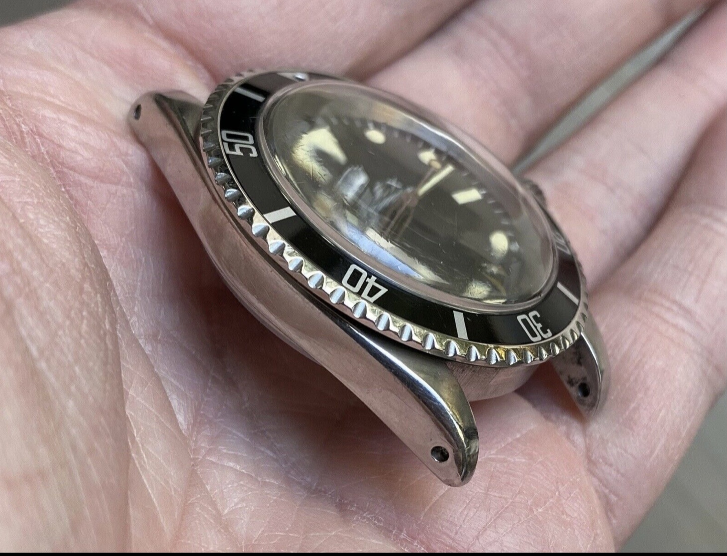

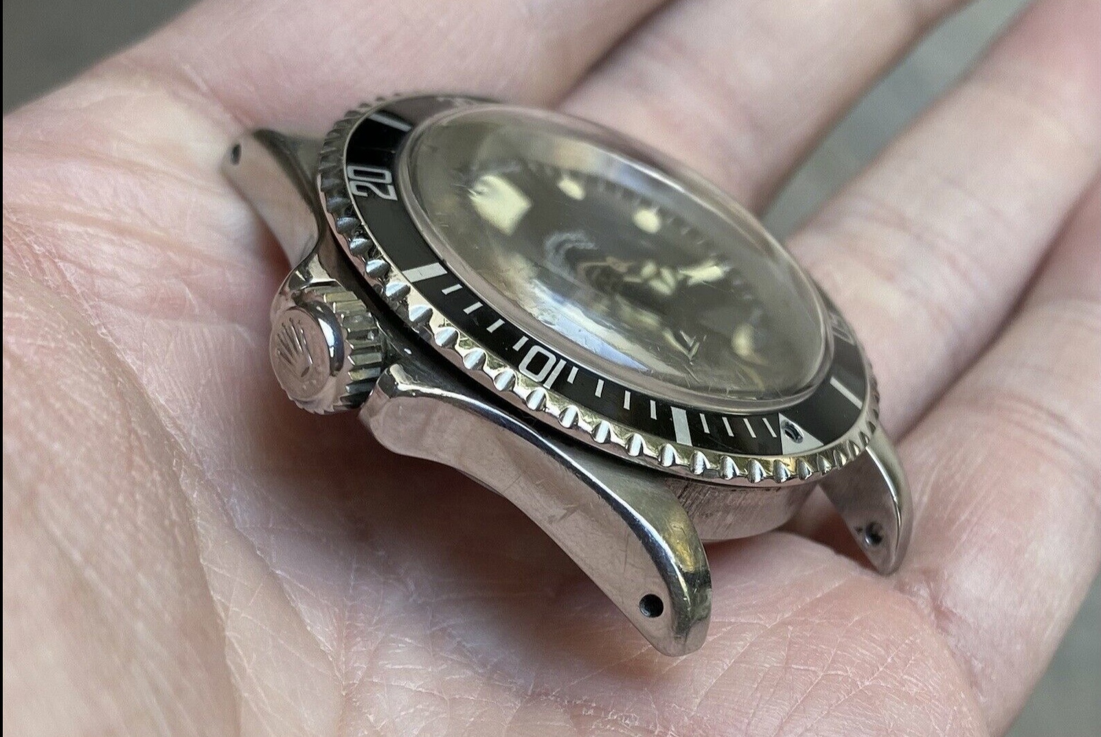

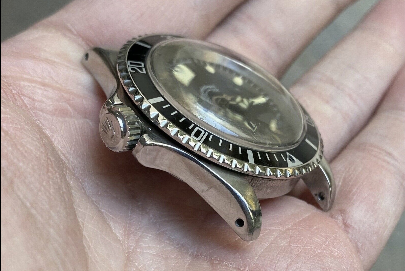

I agree. What about the case? It looks really polished
1,432
1,580
Case is not great, but you get what you pay for and I am looking more for wearable rather than a collector grade piece (which I would love but I am not prepared to spend $15k on). Probably not the smartest rationale and patience may be the better virtue here:

Thanks again for your insights, they are greatly appreciated, looks like I got it backwards with the lume !

The case has been polished, but it's not too bad IMO. The lugs and crown guards are still relatively thick and the lug-holes aren't cratered. I think it's a very wearable 5513 at the right price.
The dirt around the 6 marker looks to me like something in the reflection of the crystal.

Definitely relume. I would search for another.

1967 is an odd year and the lume still fully glows when lit up...but only for about 15 seconds

Point is- its not helpful when people post information thats not relevant or is misleading. Certain models of the 5513 and 1675 made around 1966-1967 still glow today and the uneven look of the lume is very similar to this time period as well.
I see nothing in these photos that would lead me to believe the watch is re-lumed. That being said, I would need more information to be certain. Like, what is the serial number?

Agreed, this is specialized info, so people shouldn't guess. In particular, a zinc sulfide dial should glow under UV excitation. Here is a photo of my 1966 and 1977 ref 5513 Subs side-by-side under UV excitation.

Serial number is 158xxxx so around the 1967 which fits with other examples - I have come to the conclusion that Dan S knows his stuff and it is original.
Thanks to all for chipping in with their comments it was a good discussion

not to mention the crystal is original, and its impossible to find the early domed crystals...even those this is an expendable part, it always excites me to see the original still intact.
The lugs on the other hand dont look so hot 😀
