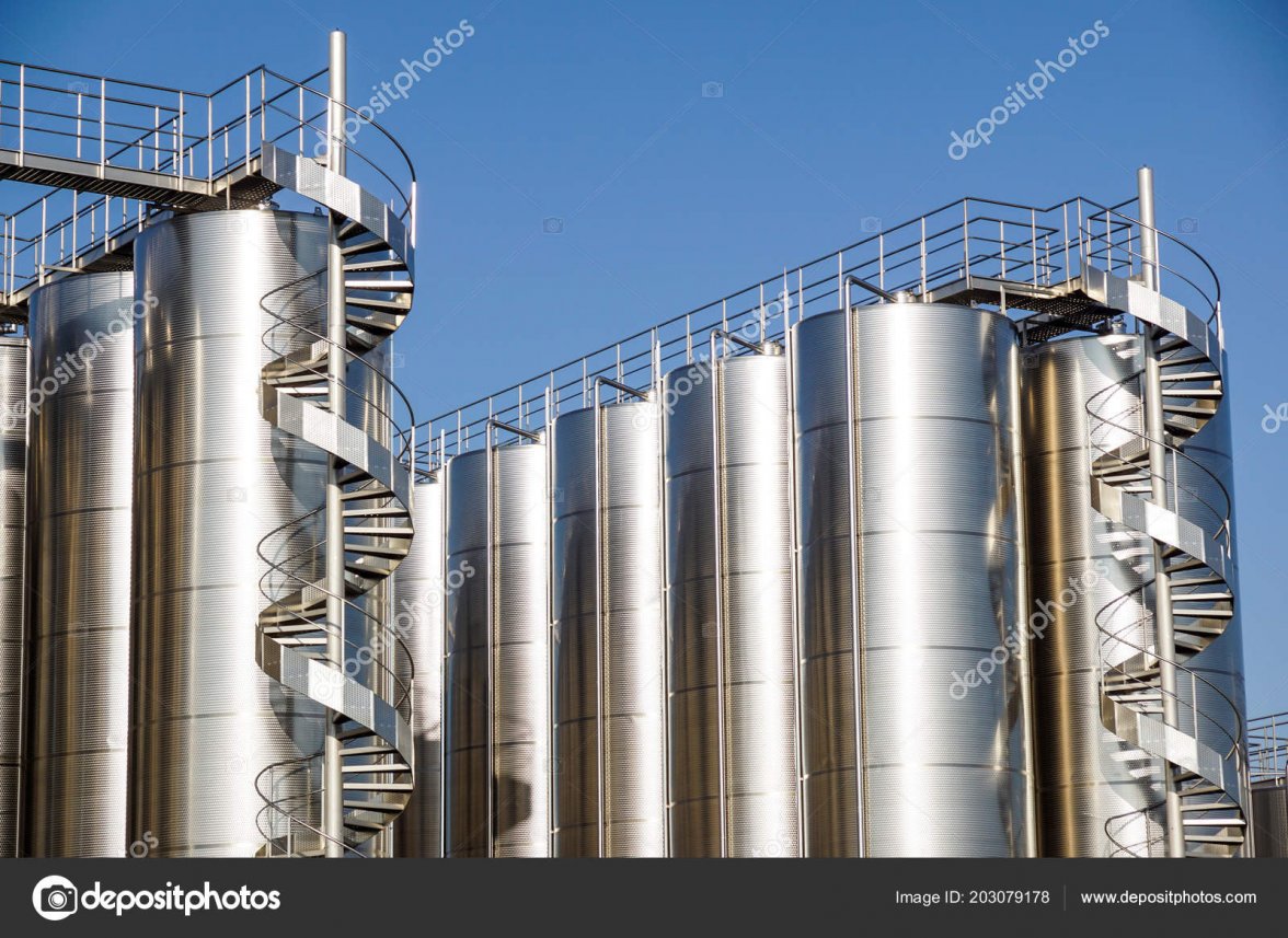

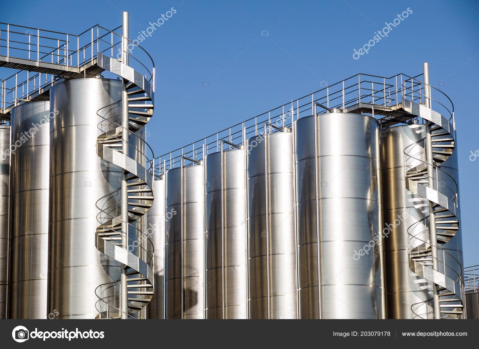

They are pretty much the same real benefit of 904L is it polishes a touch better.
Its as cheap as chips really like 316L it’s no super steel as the below is 904L
( commonly used in wine and chemical vats )
