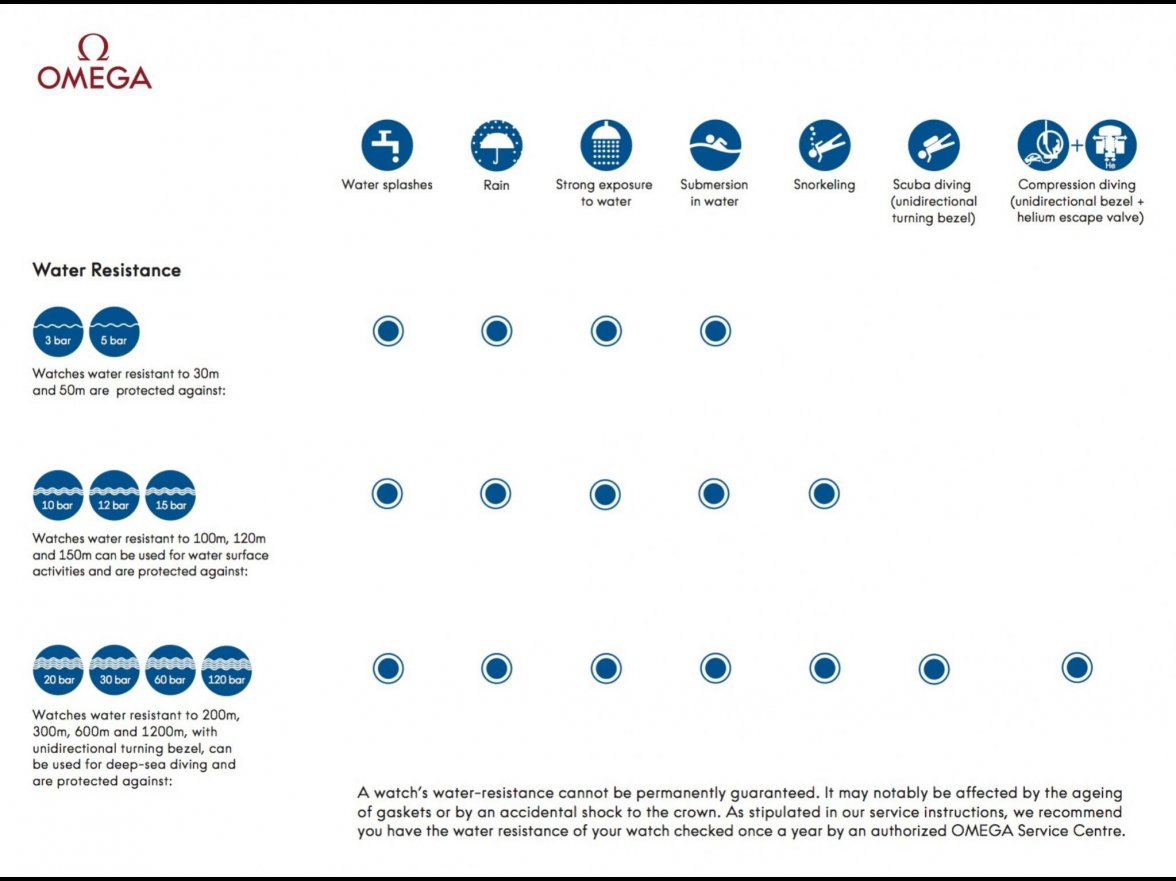

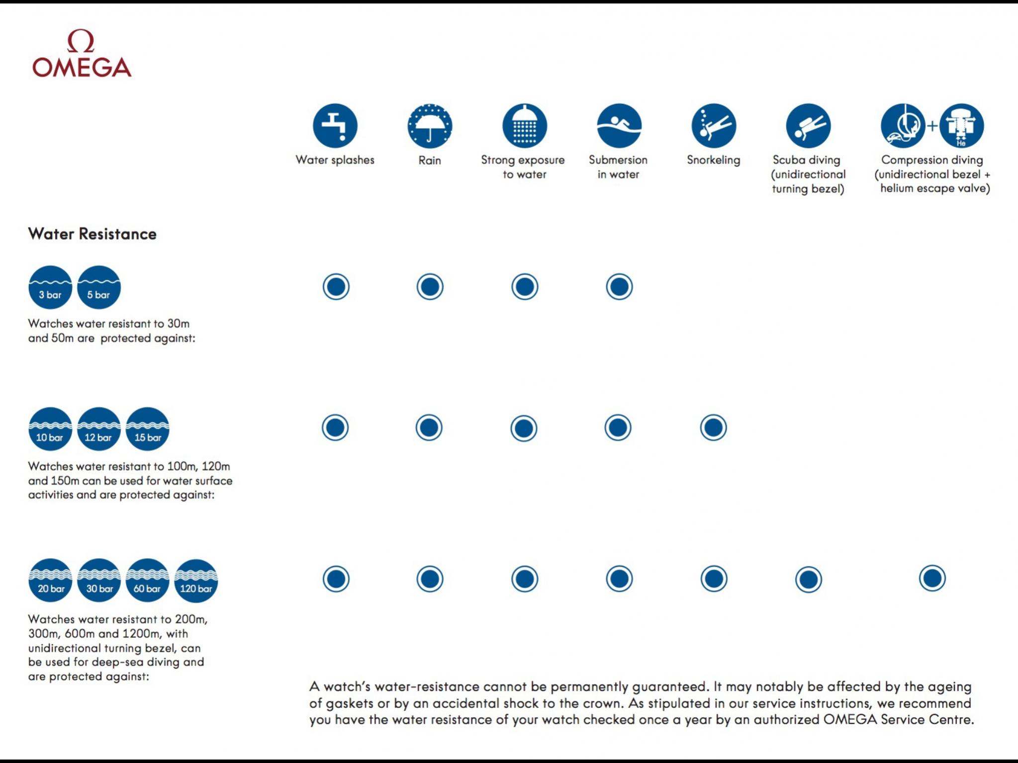

Here's Omega's guide on what's what, I'm interested to hear about how you square being ok to dive to 50m but not to snorkel.
1,530
3,595
50m means 50m...
Not fit for snorkelling means not fit for snorkelling, also on the chart I provided 50m does not mean 50M it clearly states that it has some water resistance but snorkelling a sport done not far from the surface is not recommended
