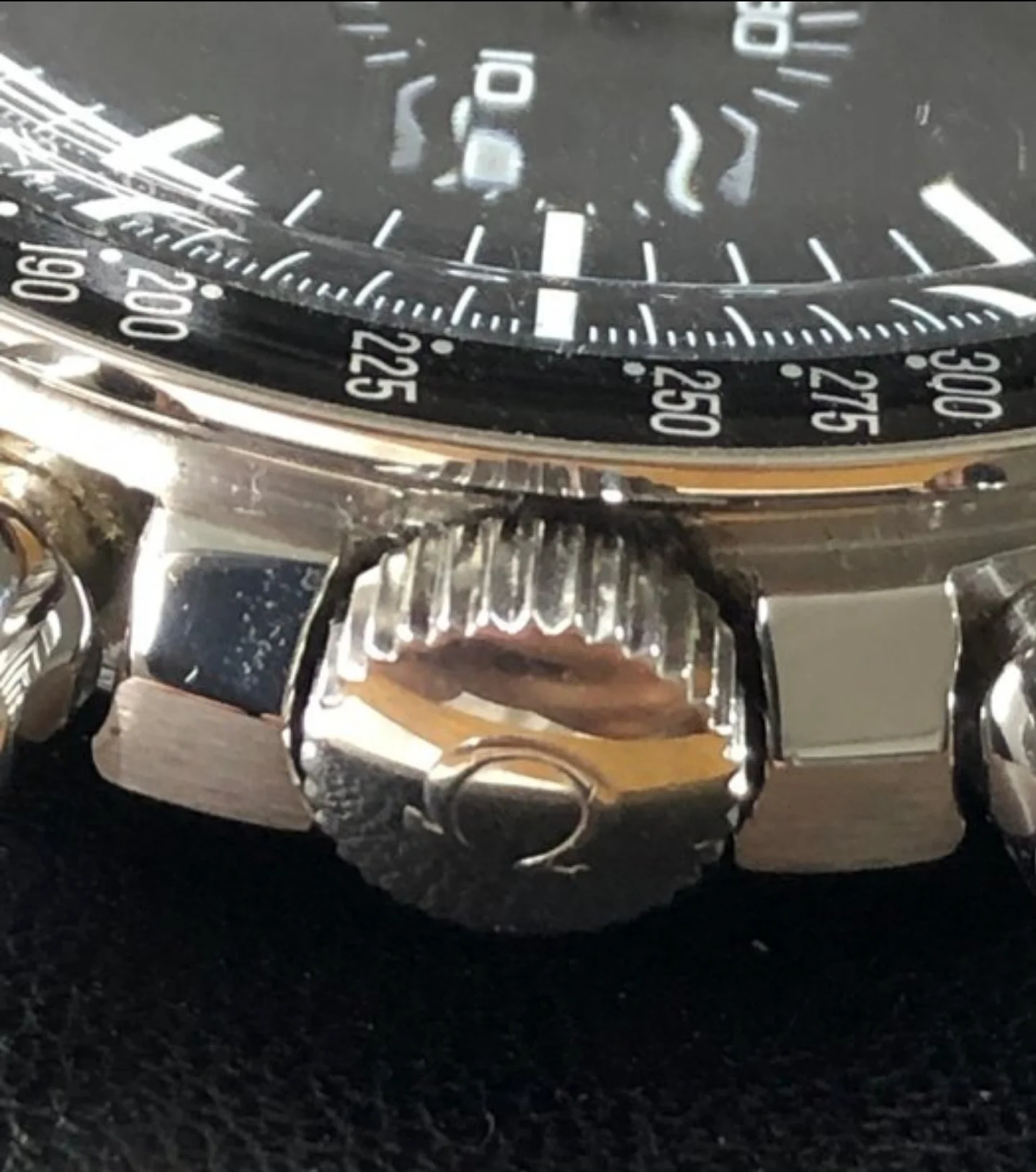

Unfortunately it has service dial, hands, bezel, caseback, crown and bracelet.
234
222

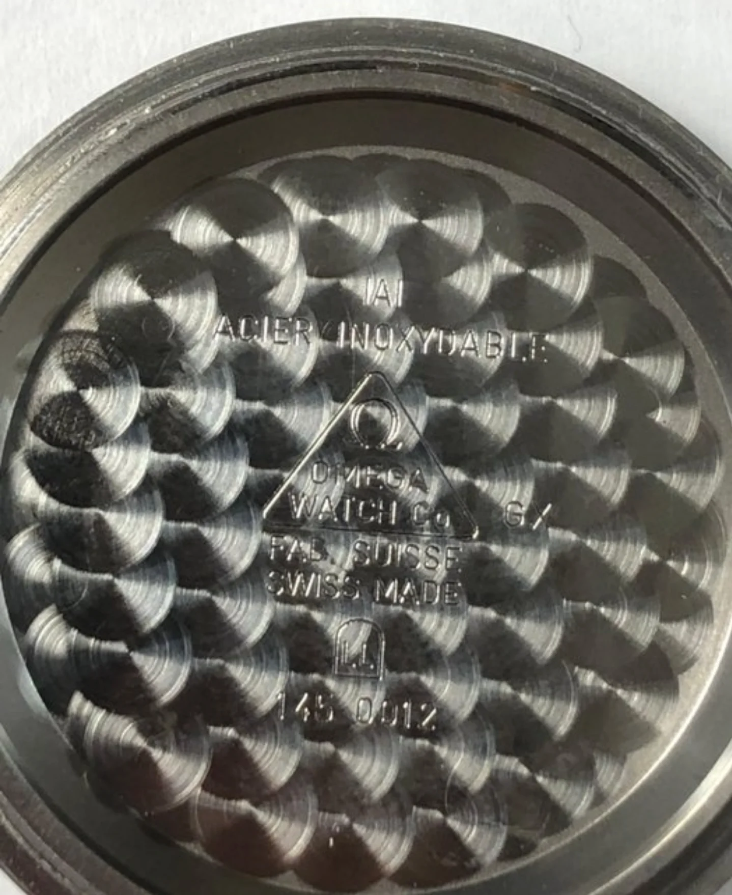

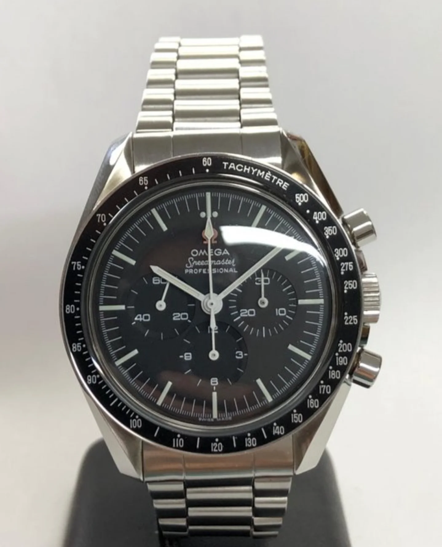

looks like a 145.012 that went in for a service and had everything replaced and polished.
Caseback is service, hence the 0012 vs 012.
Bezel is now DNN
Dial is a service dial with non tritium lume
Endlinks and bracelet are no longer 516/1039
and crown
it’s genuine, but not original to the watch.
75
29
Bezel is now DNN
and crown

The question is not are the parts genuine, rather…….are the parts original. Big difference. This looks like a factory service gone wild. Which is why it’s not generally recommended to use factory service for vintage. It can be an extremely expensive way to devalue a watch. Impossible to know if this was factory or independent service without documentation.
If this was sold to you as completely original, with commensurate price, that’s not cool. Not sure how long ago you bought it but I would start investigating your options asap.
If you got it cheap, there’s a price point at which it’s OK, if you want a new looking watch, but for most collectors, it will not appeal.
I hope you can work something out.

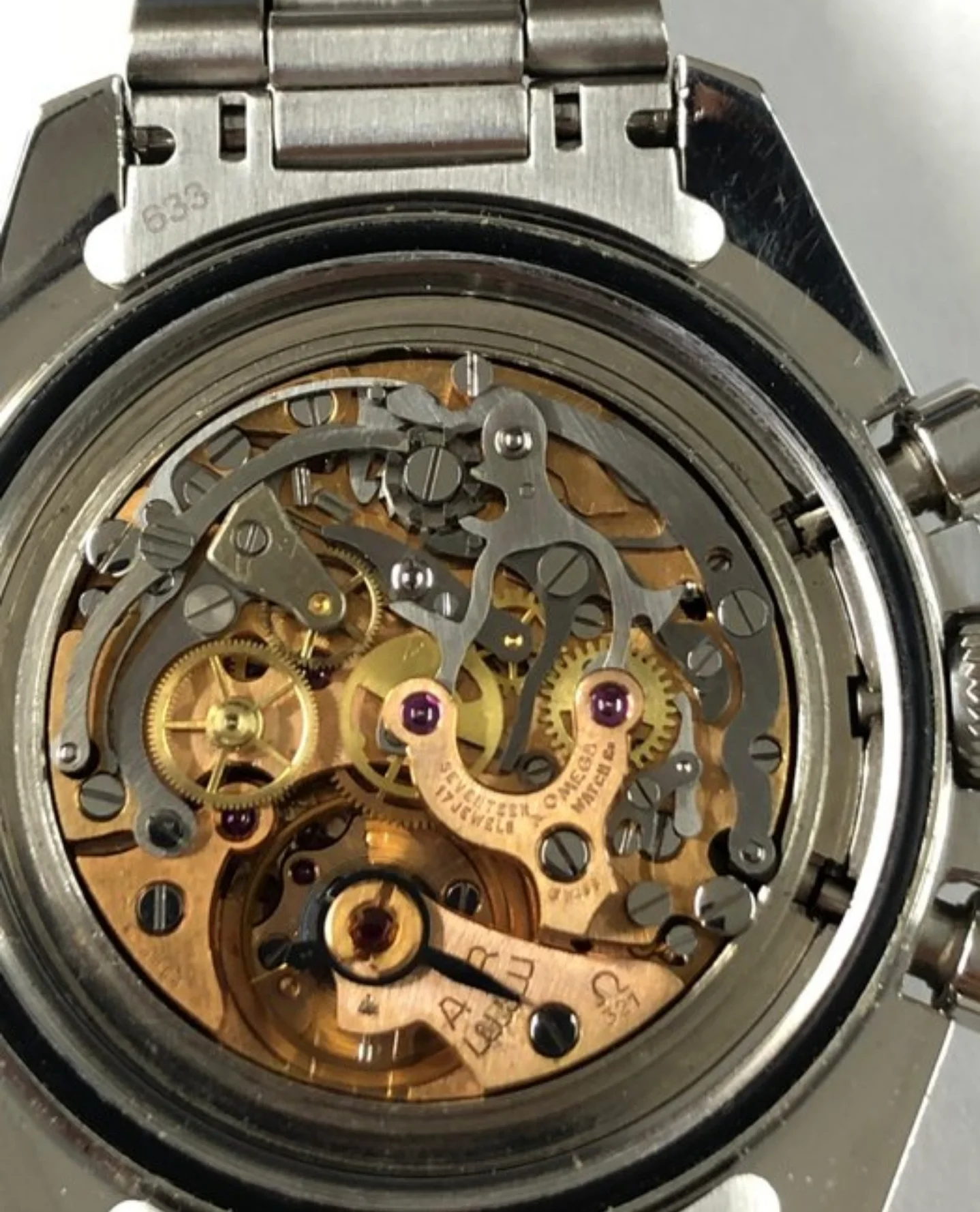

also the movement number has to be checked
was it ground off? Not sure it is even there to check.
353
1,083
i assumed, that it has been made unrecognizable by the TS (digital not analog 😃😁😁😄)
if not, ...

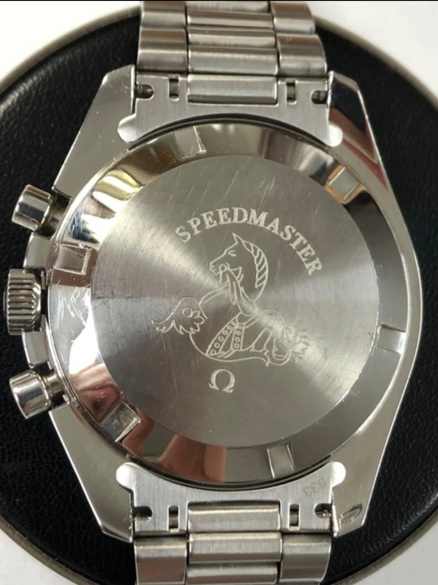

It is basically a WatchCo Speedmaster. It should be worn as such which means that this is a wearer. I just don't understand why the serial number was ground off, makes no sense. I bought a 145.022 69 thta went through a service at Omega and the dial, hands, bezel, pushers, crown were replaced (I bought the watch with all the original parts that came with it). I thought i would put the original components in it but I actually like wearing it like this since I am not afraid of damaging anything and I have other vintage Speedmasters to wear if I want to.
234
222
I do not think the serial number is ground off.. likely just blurred out the number for the photograph.
it is certainly a watch to be worn like one would have in 1968 😀
