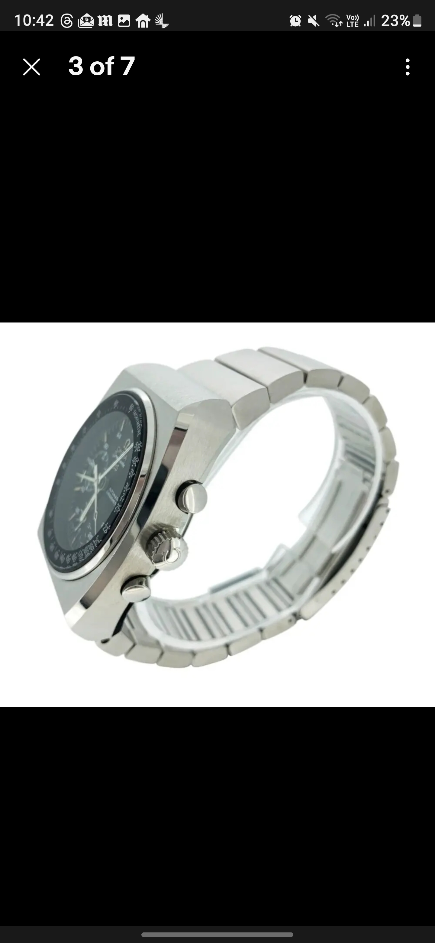

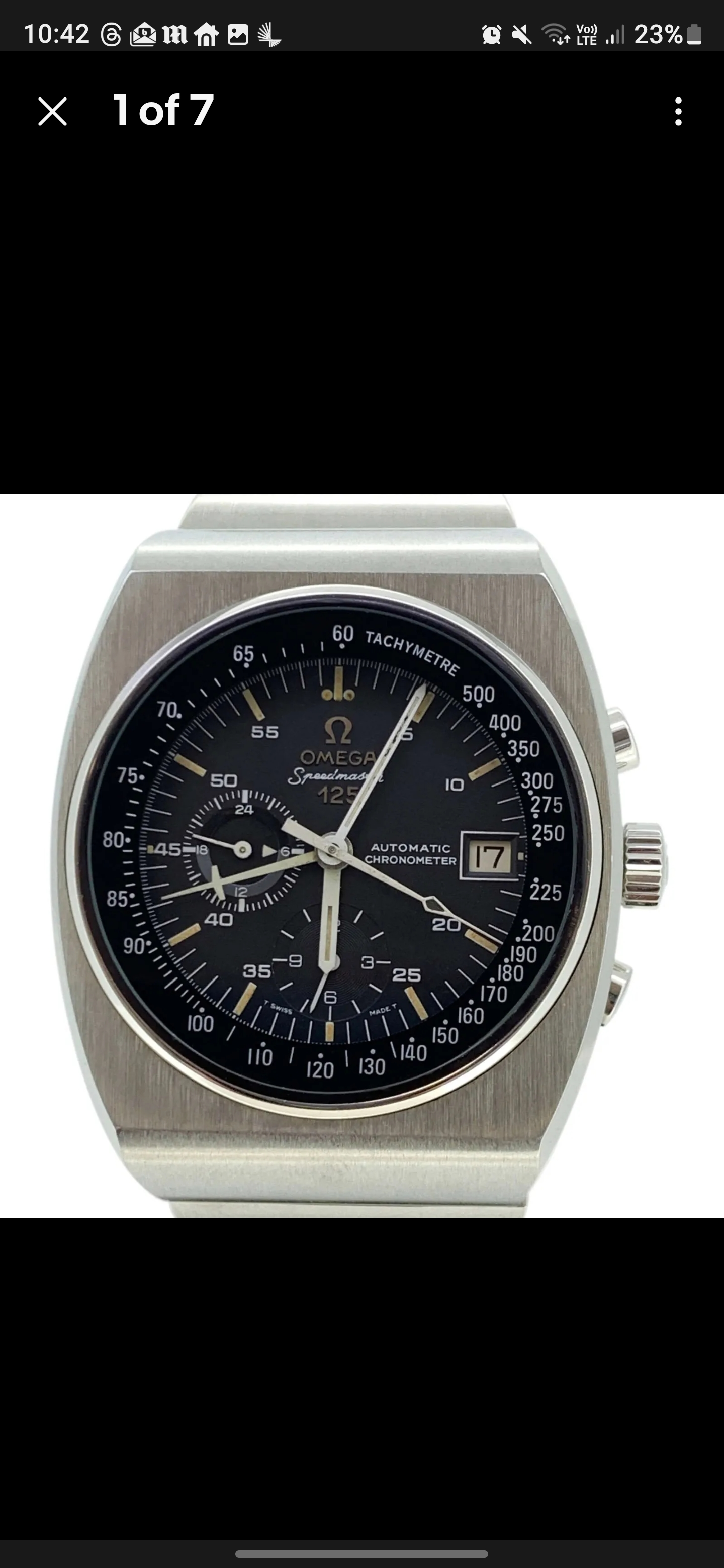

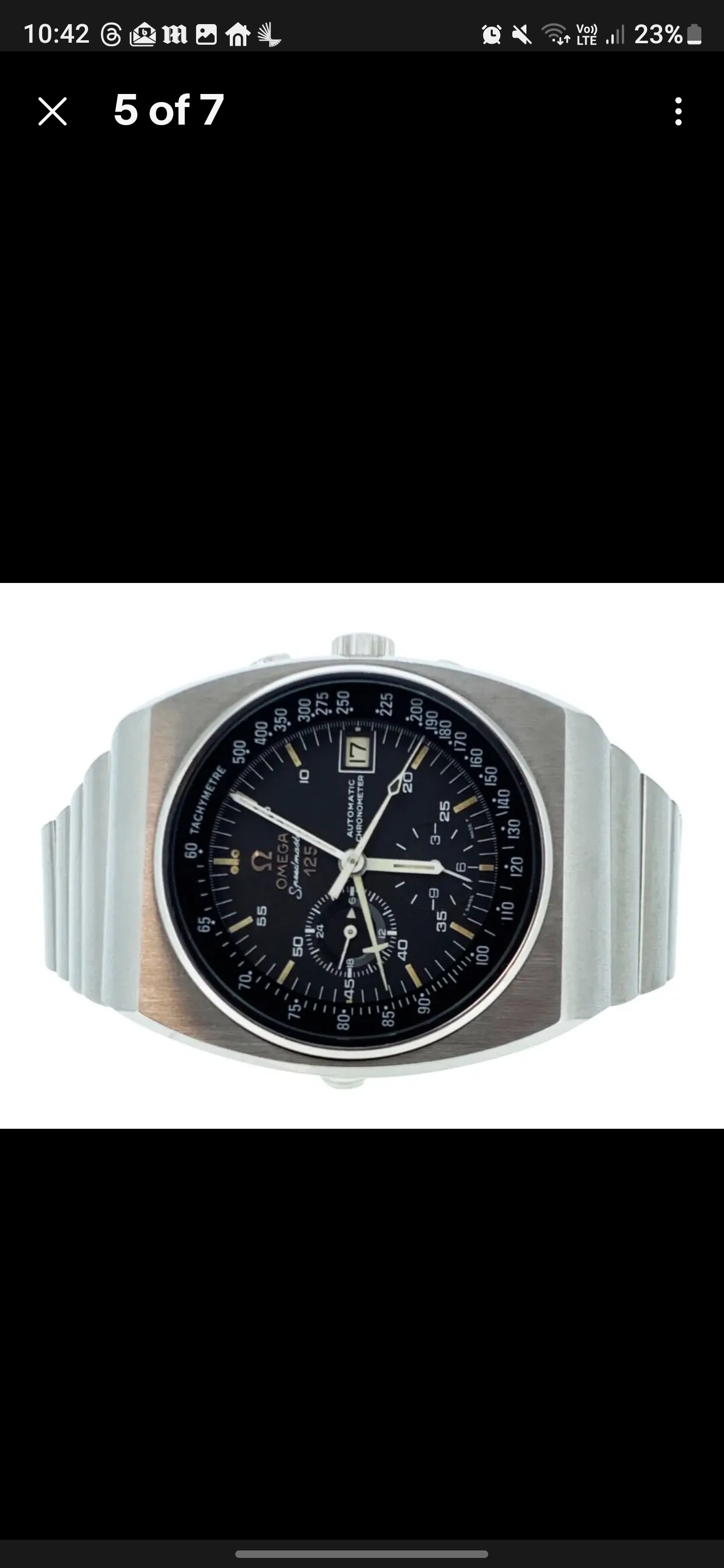

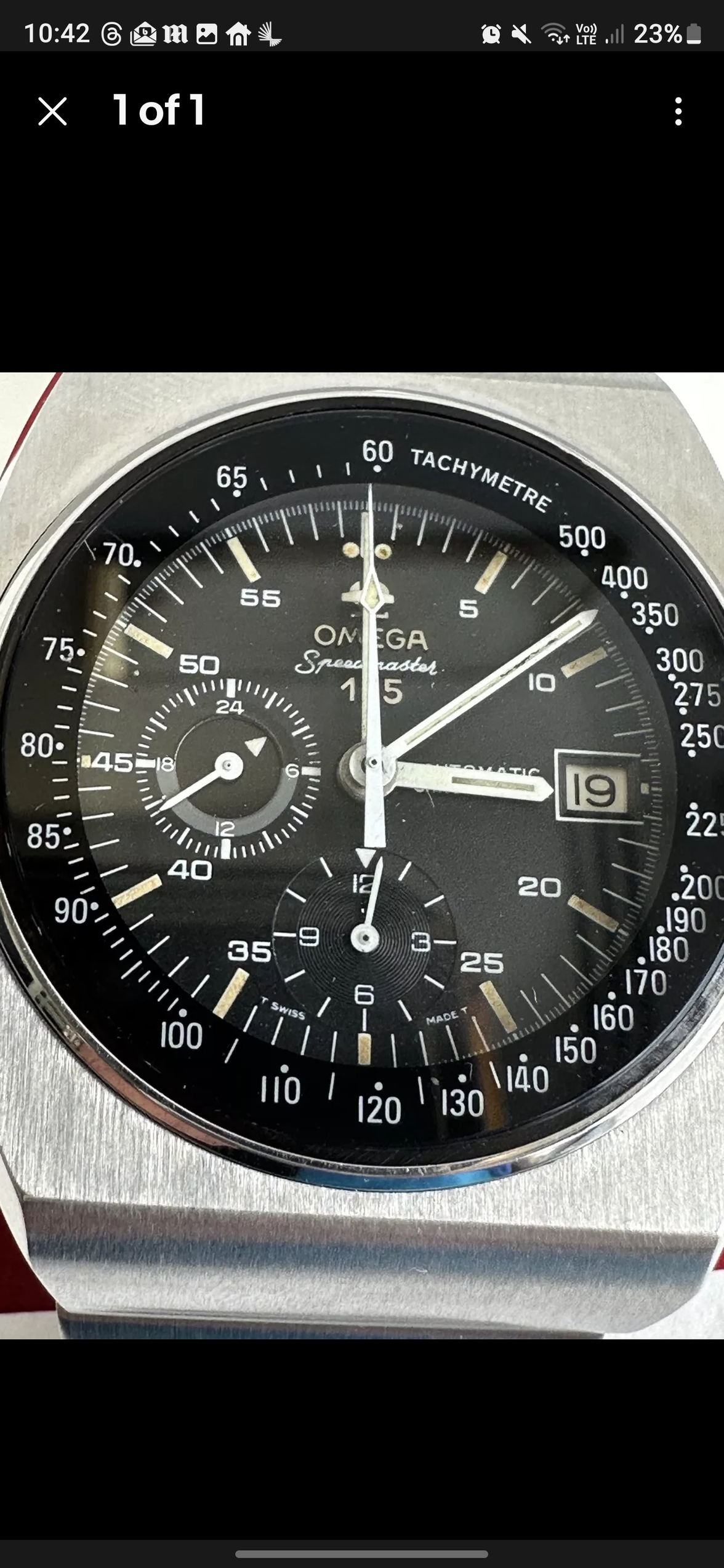

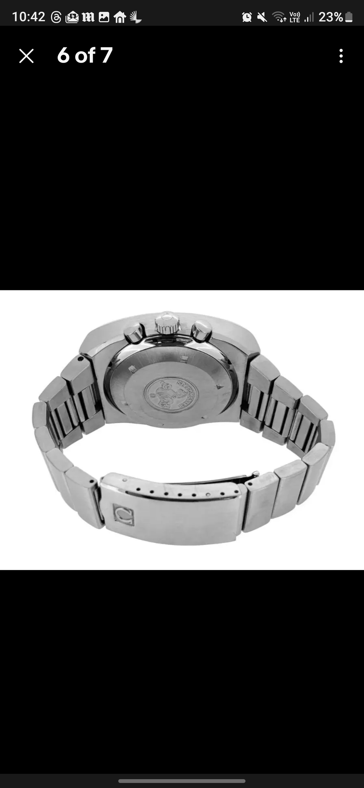

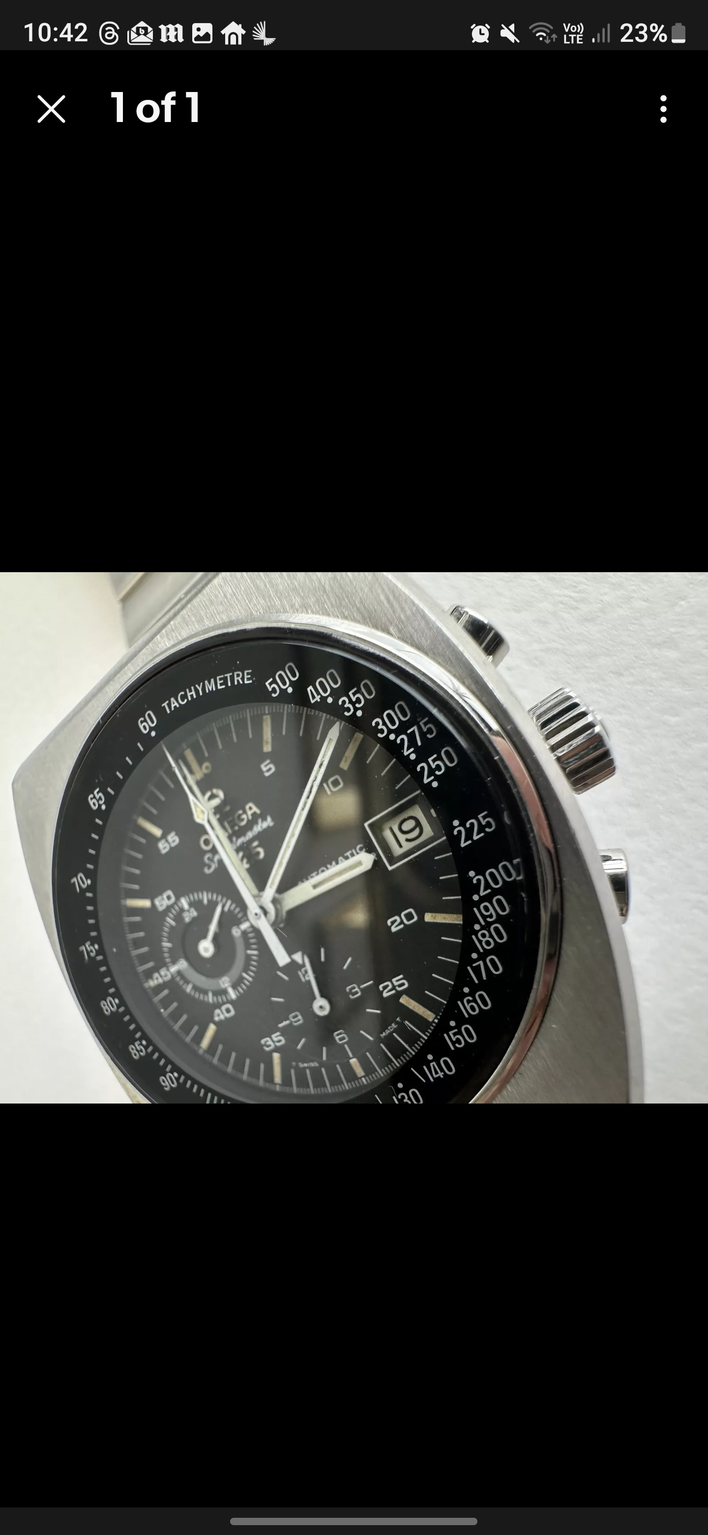

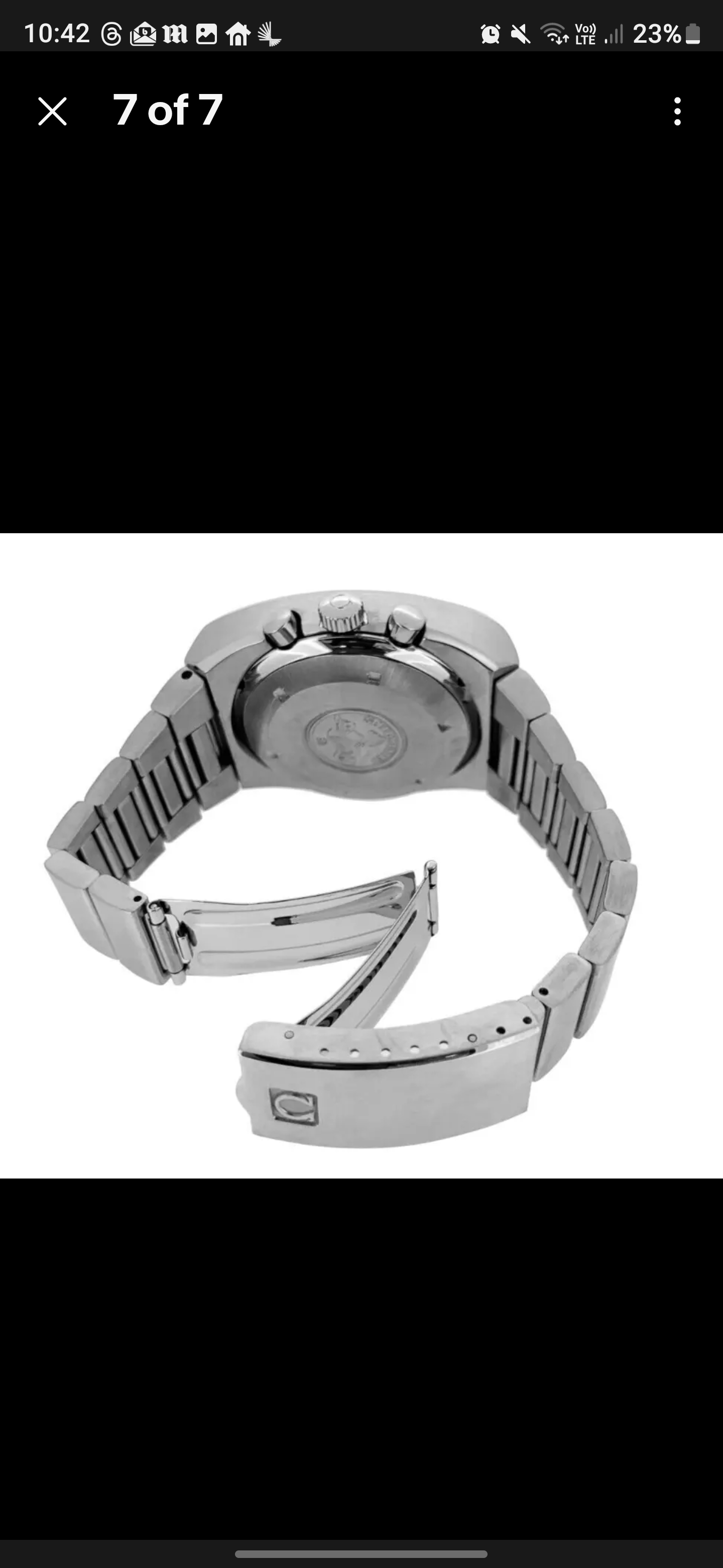

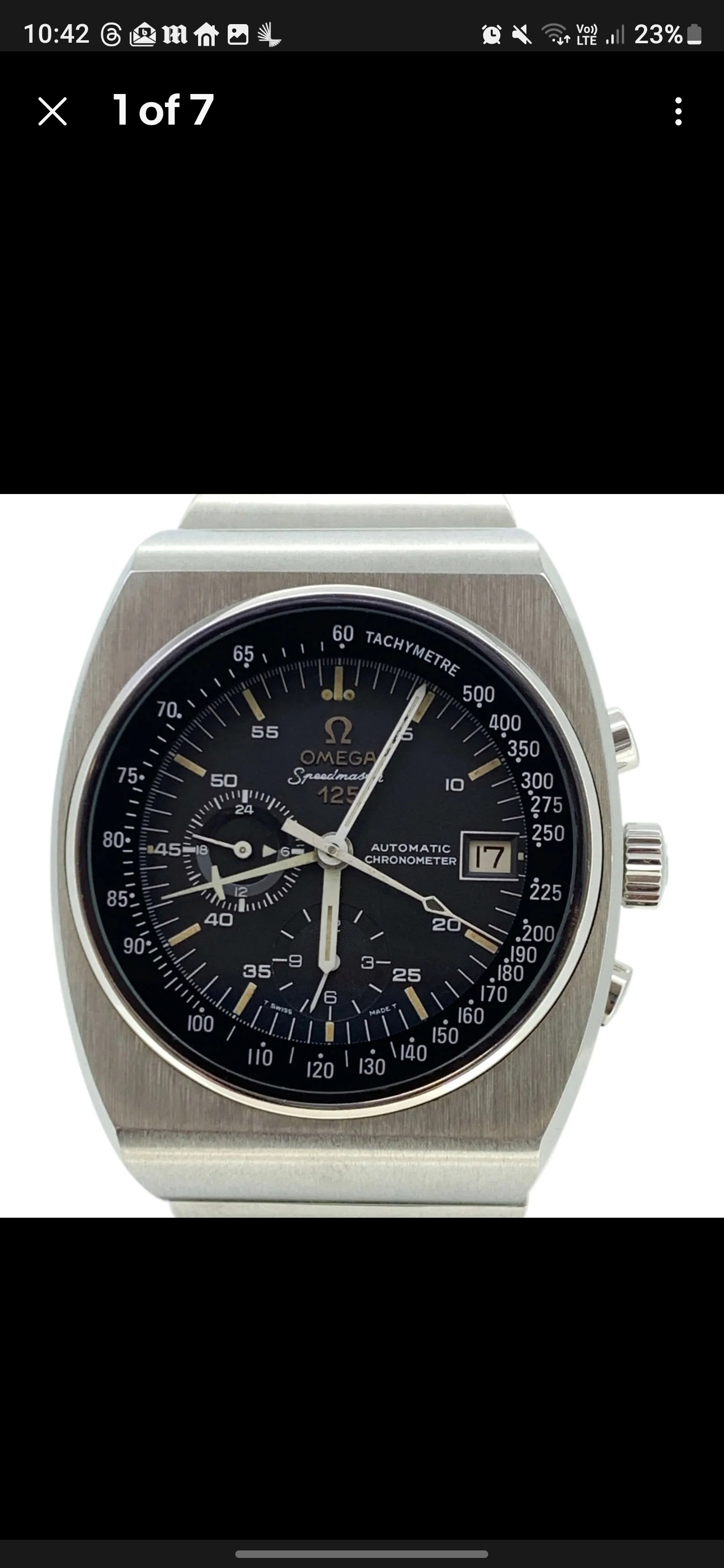

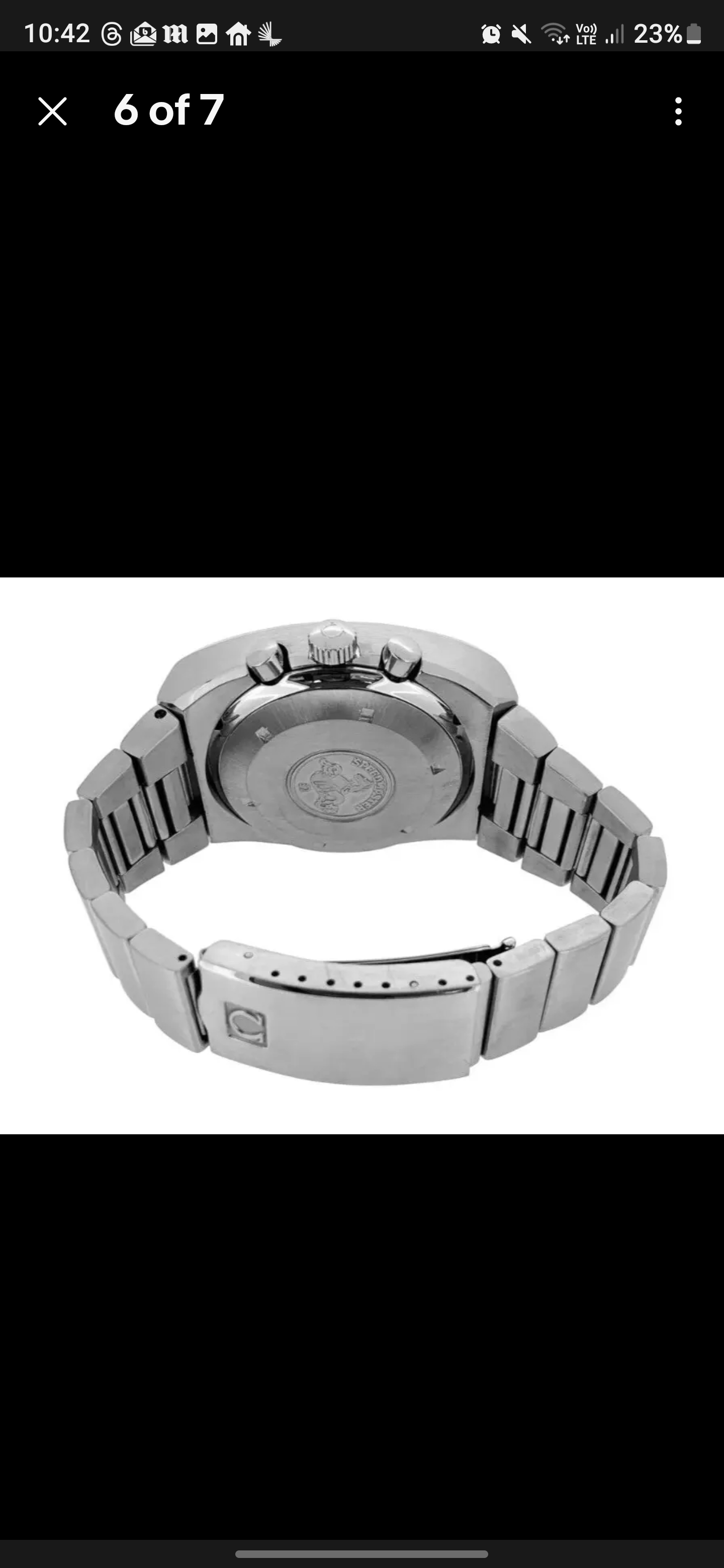

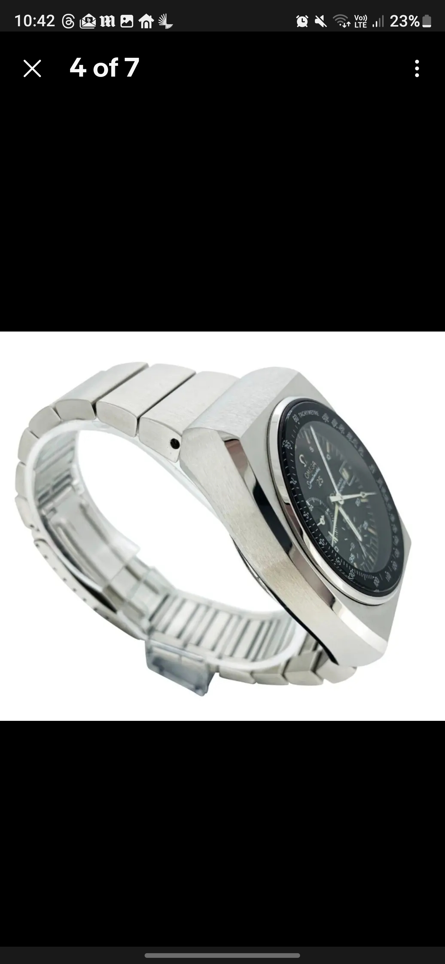

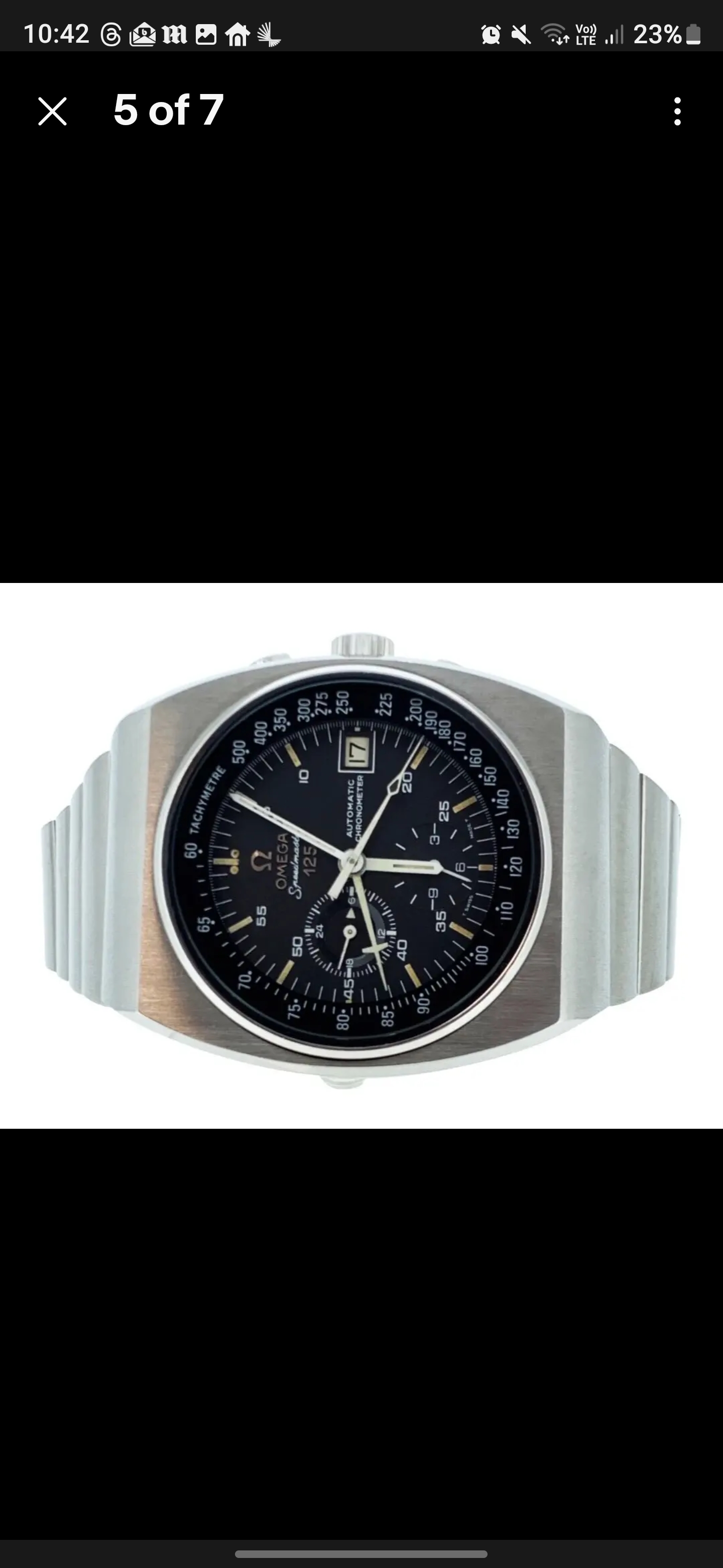

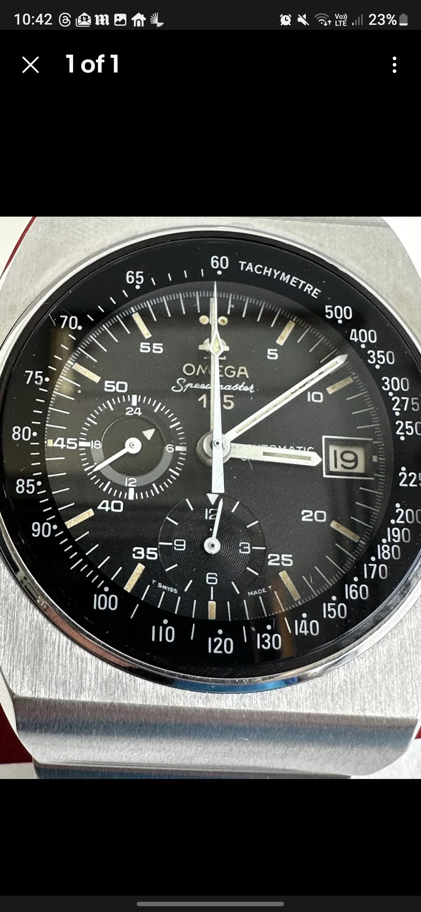

Oh I'm so sorry everyone I didn't realise a our the links. Here are the photos. They're asking about $6000 aud. ut $6000 aud
8

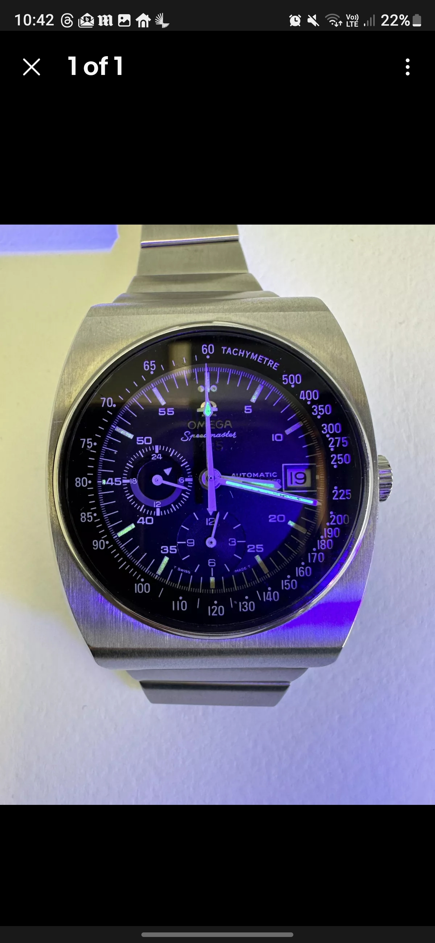

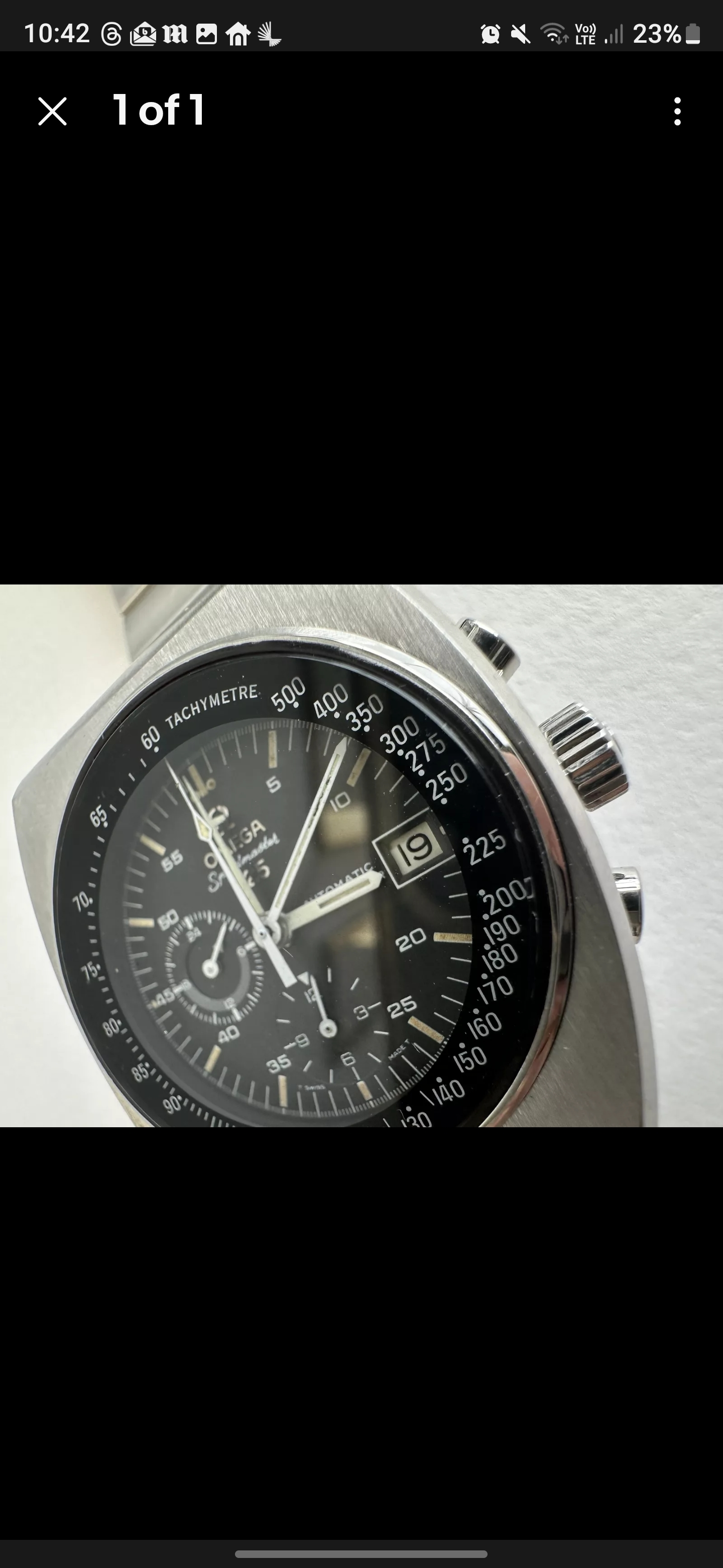

This is going to be my first omega watch and I've always liked this model. I'm always a bit worried about things being over polished but it seems ok. I wondered about the lume too and it looks like the parts the uv is shining on do seem ok.
Was wondering what everyone thought and whether it looked like a reasonable buy. It has no box or papers.
Thanks again.

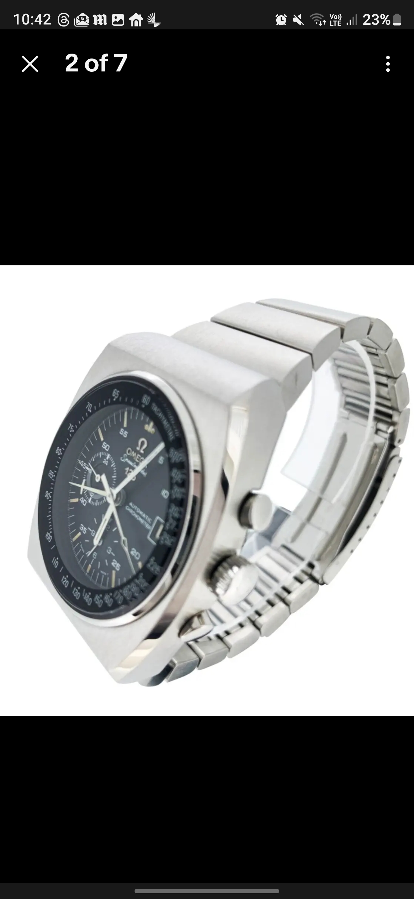

The condition is very good, with the case still looking to have sharp lines and original finish. These tend to get over polished and end up looking like a massive bar of steel soap.
309
231

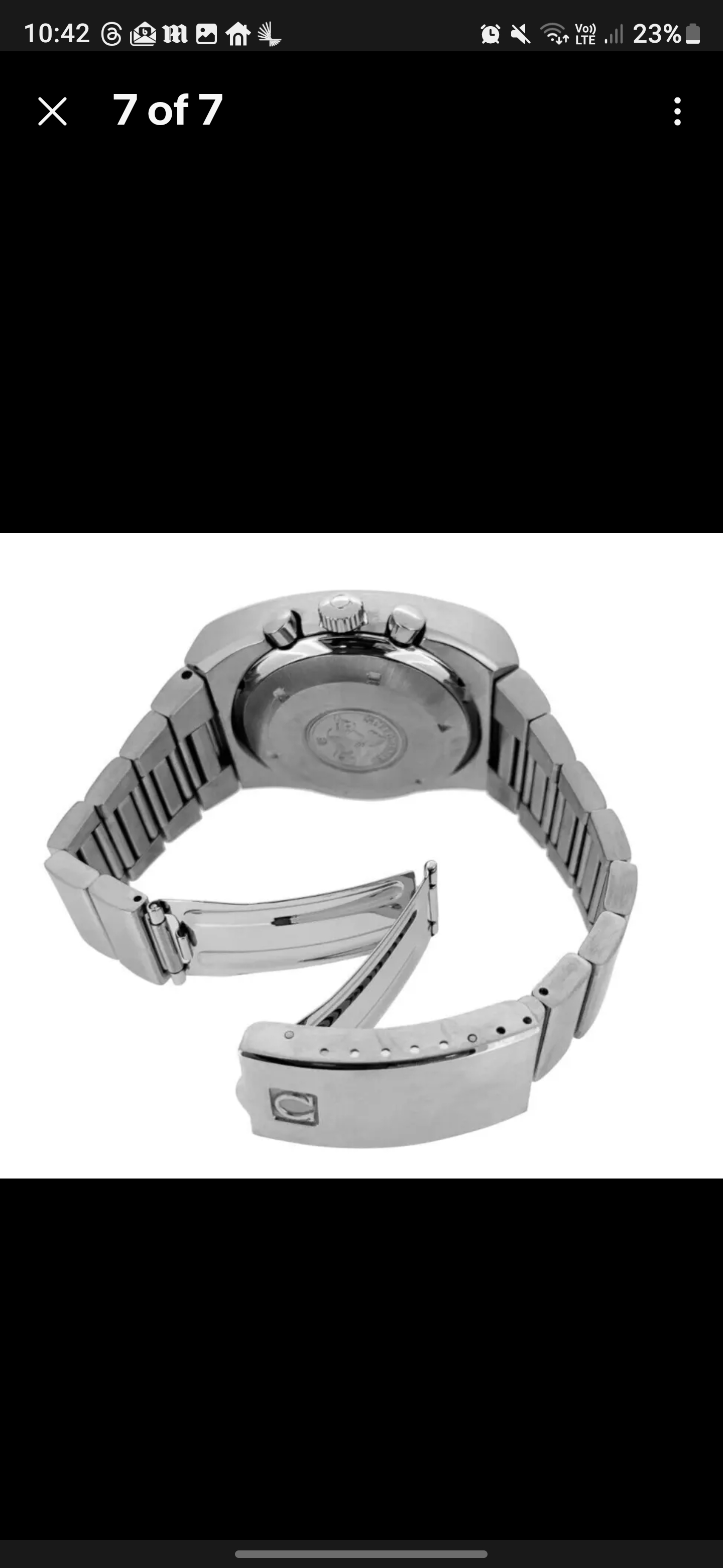

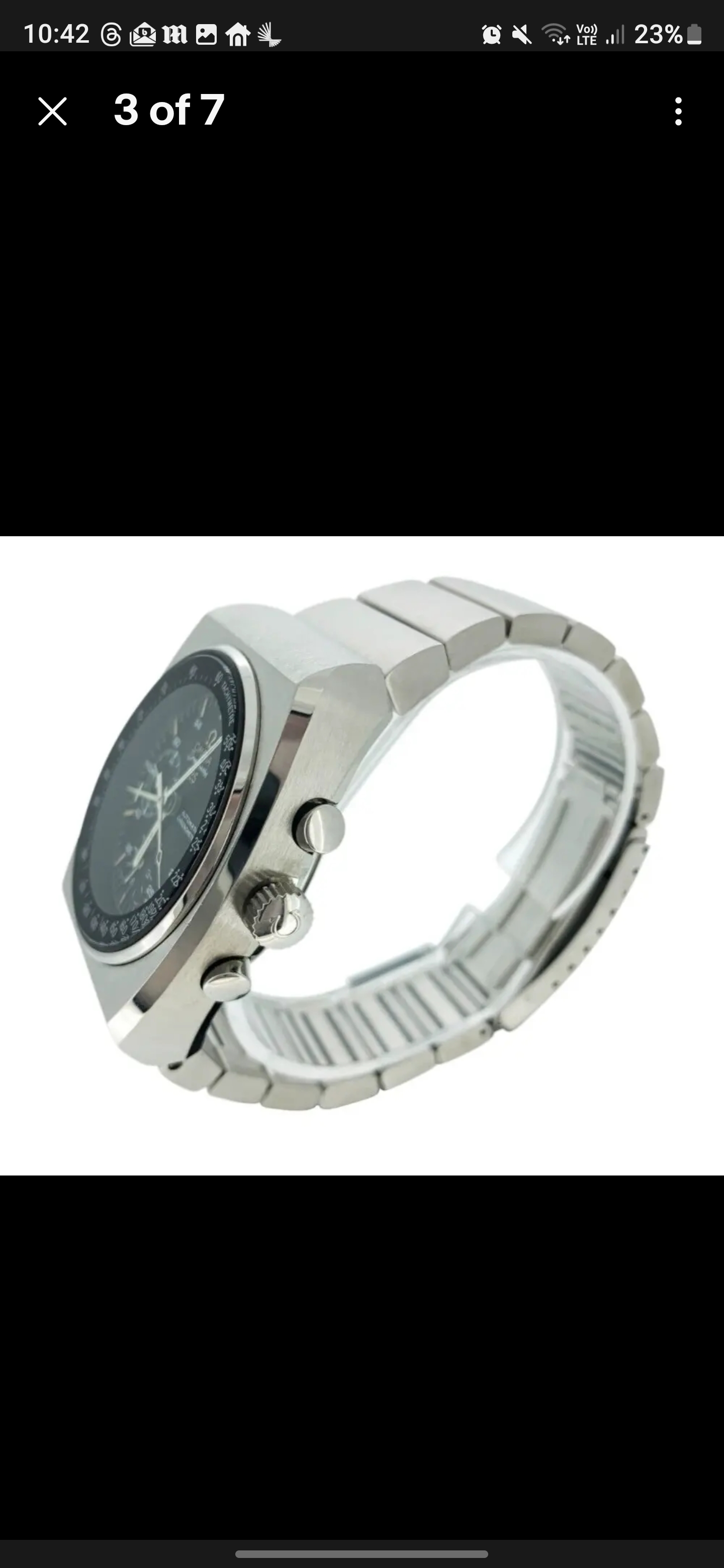

...because this is a new Omega service case+bracelet.... and from what I can see, they used wrong pushers, as for this case you need longer pusher necks to be screwed on the inner case...
