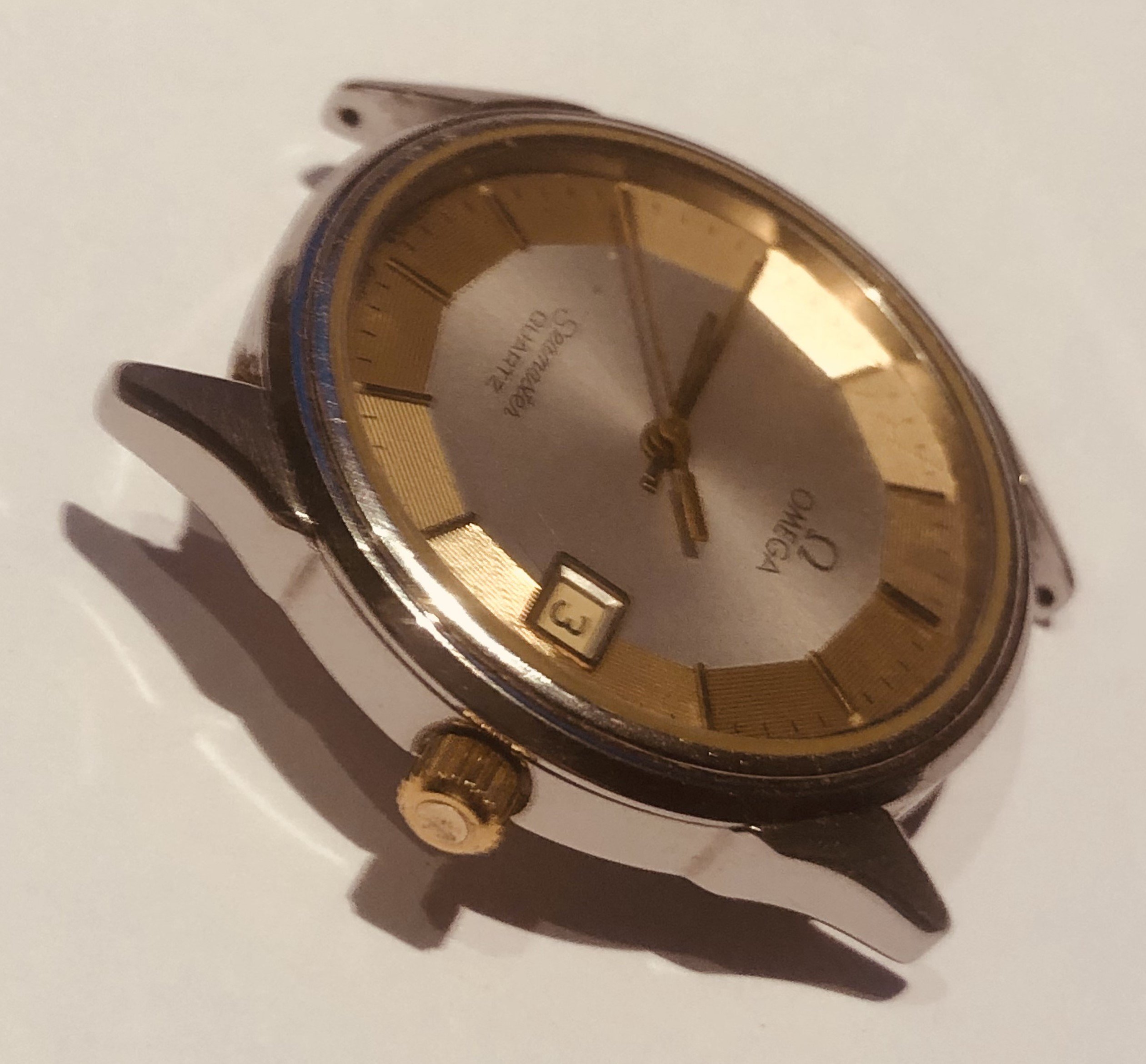

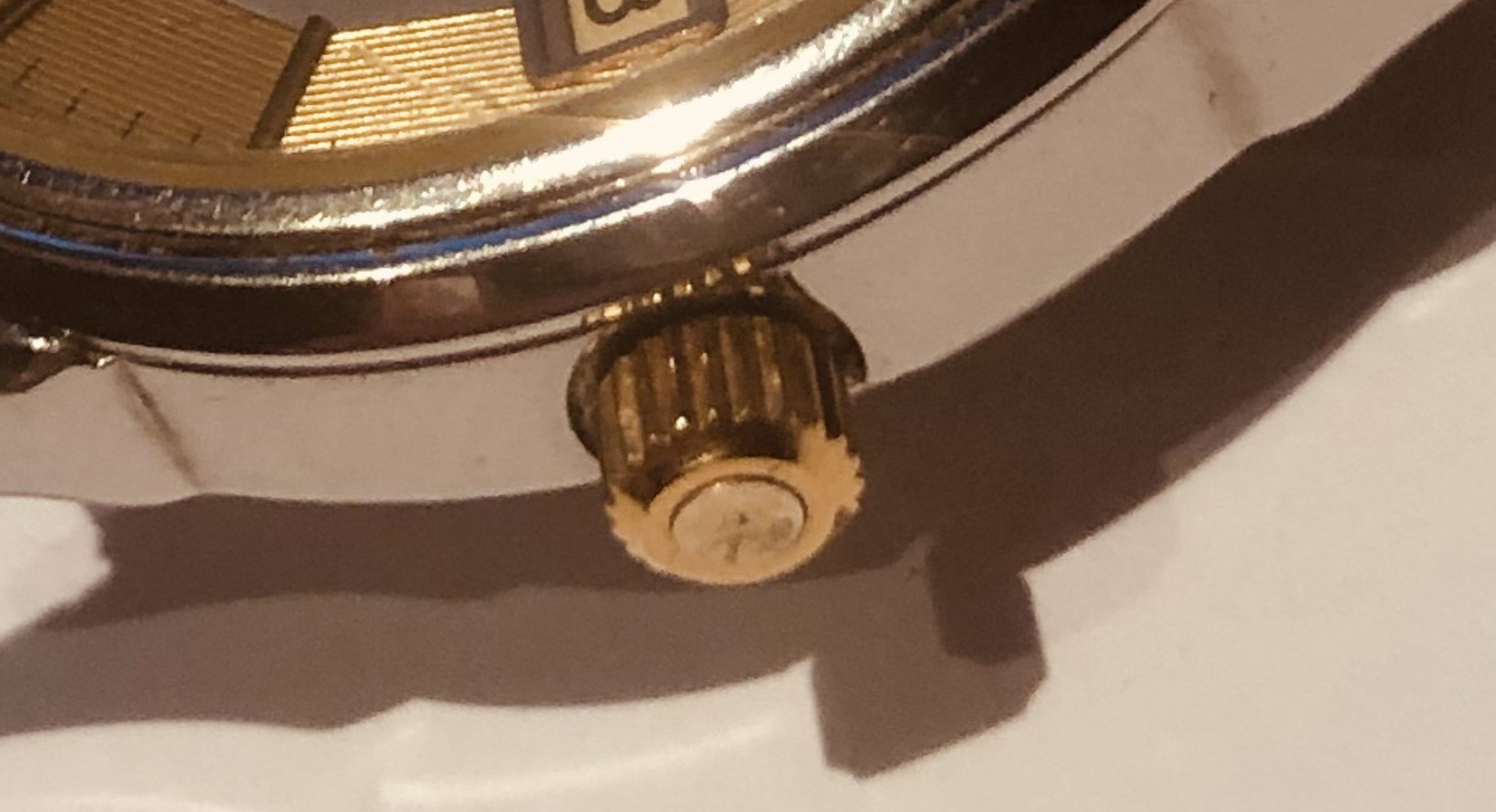

Hi All,
I have a recent addition to my small collection.
It is a Vintage Seamaster Quartz with a Pusher Crown.
I can see the indentation in the crown but have no idea how it works or
what a series of clicks in or released might do. Do they affect the dial display,
the date or the setting of the time?
I have delicately tried to press the crown in but can see no change or
movement on the dial.
Any information will be gratefully received. Thanks, Mart.

The crown actually has a second spring, so it moves separate from the stem. This way the button in the center can press further into the case.
