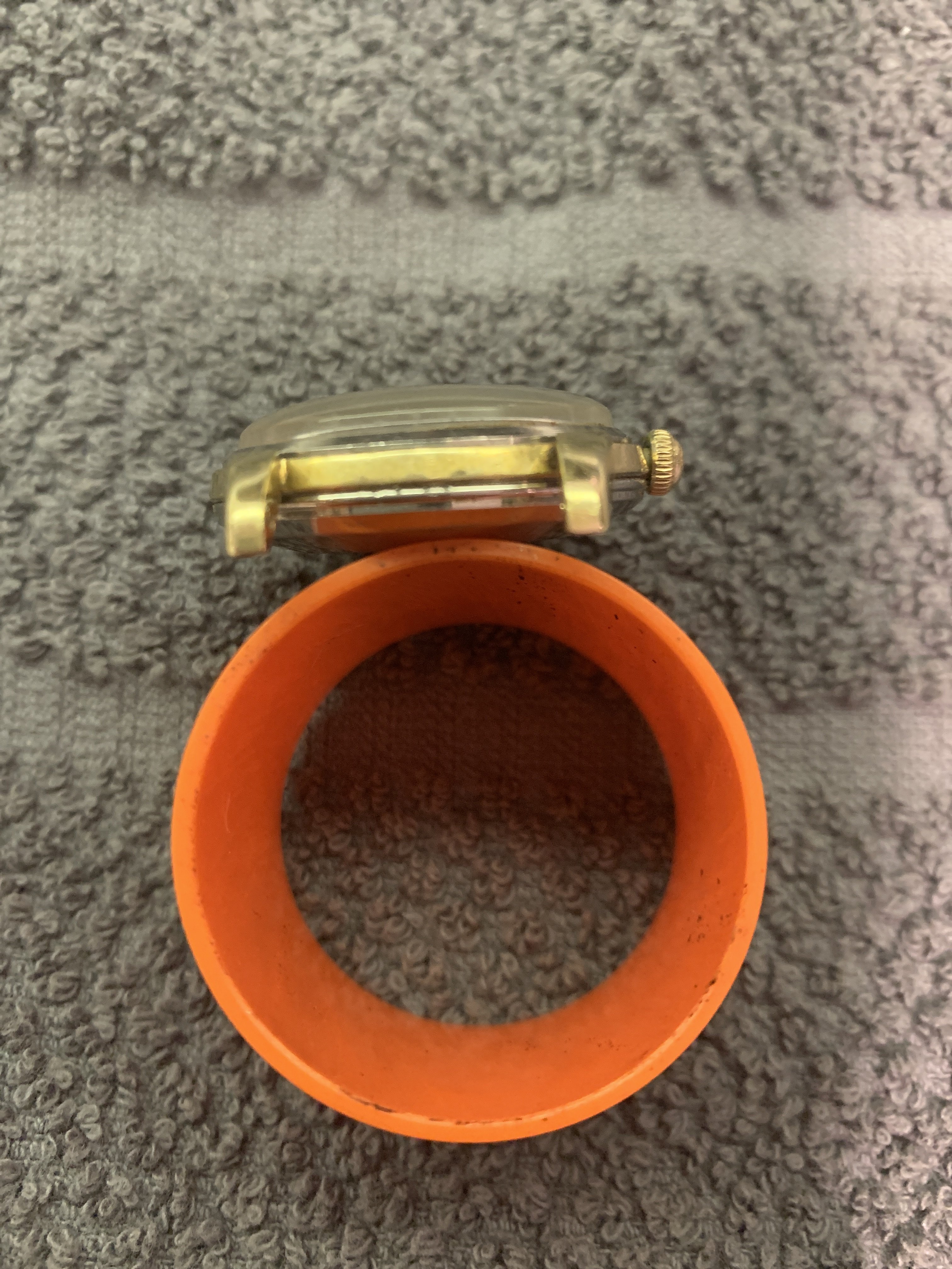

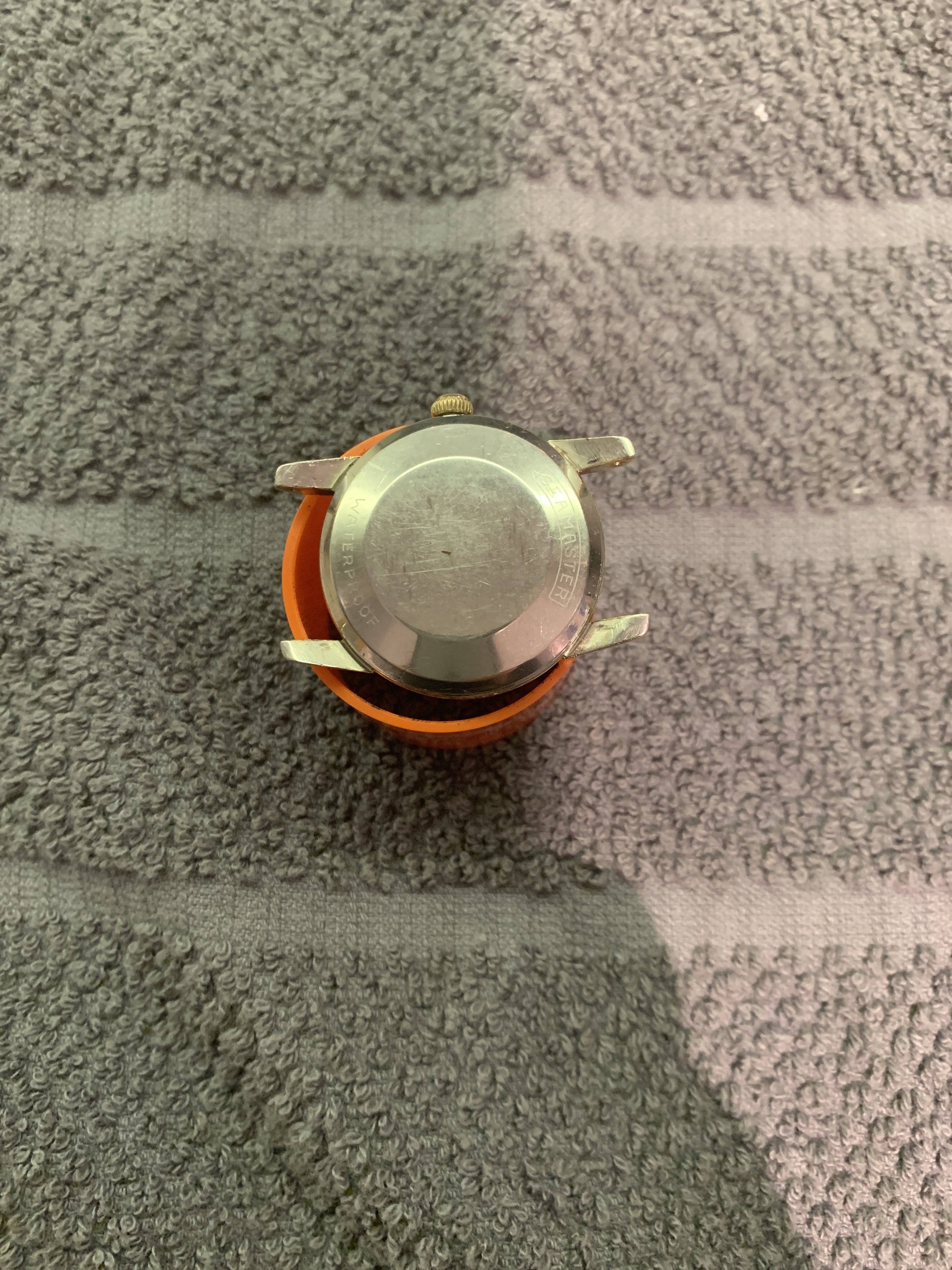

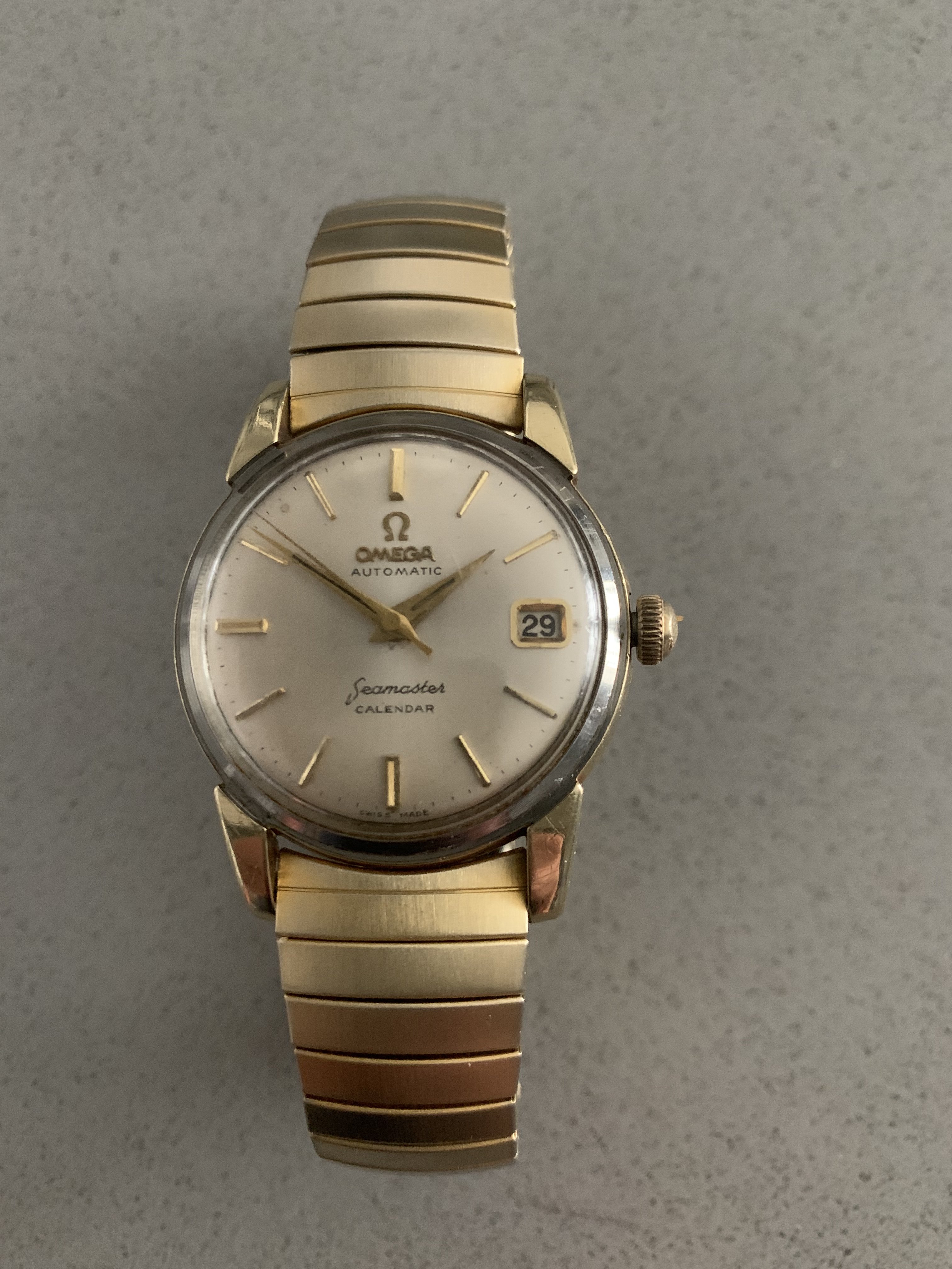

Hello.
I hoping that one of the members can help source a bezel for my Farther’s watch. My Dad recently passed away and when sorting through some of his belongs my son came upon a watch of his, which he has shown great interest in - he was very close with his grandfather and I believe there is a “connection” that my son has as he recalls my Dad wearing the watch.
That said, it’s my son’s birthday coming up in a few weeks and as such I would like to surprise him with gifting him the watch on behalf of my late father. I took the watch to a watchmaker and found out that the bezel is missing. I couldn’t figure out what was catching me out when looking at it but now it’s quite obvious now that I’ve been informed. The watchmaker has no source/line on a replacement.
So after all of my rambling my question - is they anyone in the forum’s community that has a source, lead... as to where I maybe able to locate a replacement bezel? I realize it is a long shot, I believe the watch is a 1956, parts must be scarce... I have tried finding via eBay..., other watchmakers in the Toronto area to jo avail. Any help sourcing and acquiring a replacement would be great appreciated, by both myself and hope soon proud owner my son and I would probably add my father - knowing his watch will be cherished for another 60 plus years, all willing.

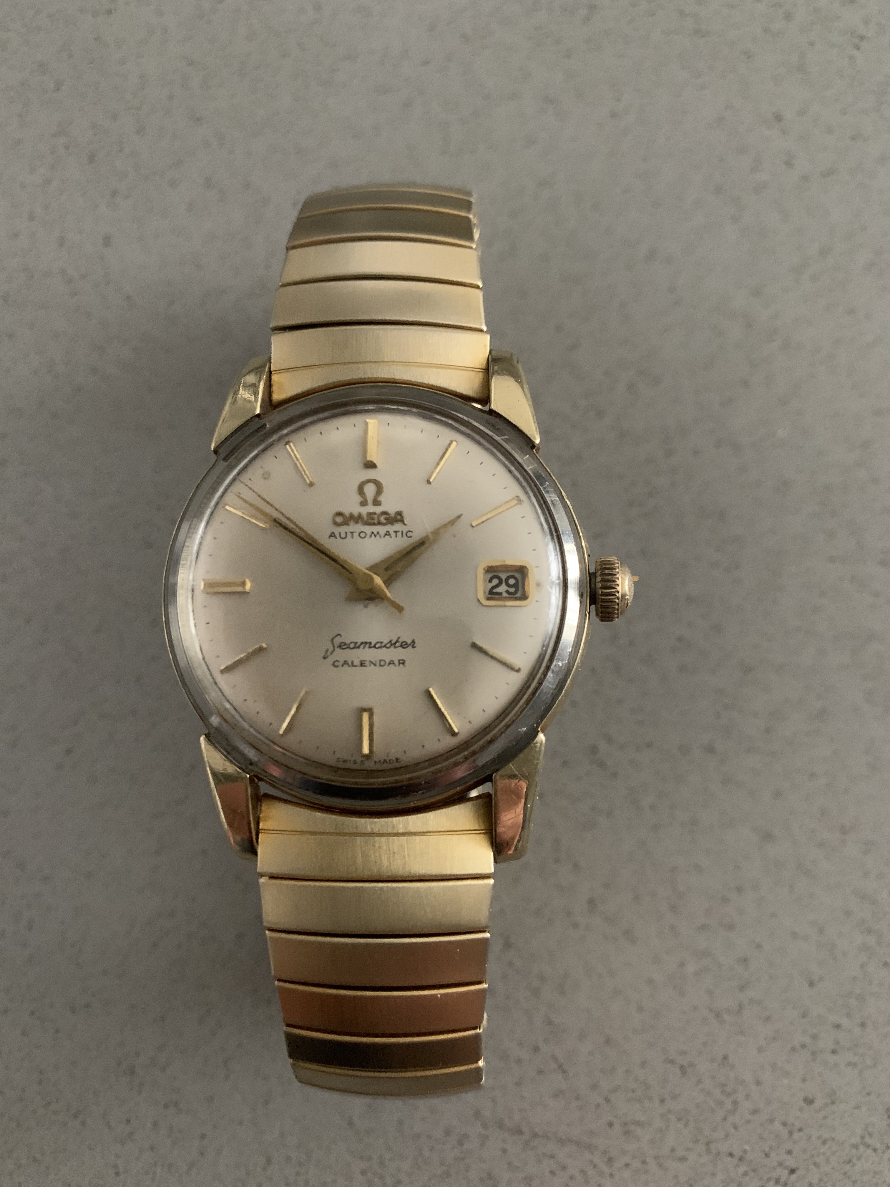

Here are two pics of the watch, if any others required I can take and post accordingly.
Thank you in advance for any help that can be provided.

Do you have a pic of the reverse side? Your watch has some issues for sure. Looks like a redial. This is not uncommon, but affects the value. Crown is wrong. Looks like a gold cap case. The watch bracelet is not good for a watch like this. It could cause bad wear inside the lugs.

You may want to consider sending the watch to Omega. The process takes a while (months) and is rather expensive. The cost to restore this watch will probably exceed the value of the watch. But, if it is to be a cherished heirloom, the restoration will bring you and your son happiness for years to come. If you choose this option, Omega will give you an estimate before work commences.

One question - with respect to replies. What concerns are there about the dial “redial”? I have been looking at a few other examples and to me, it any kind of expert by a long shot, seemed to align with others.

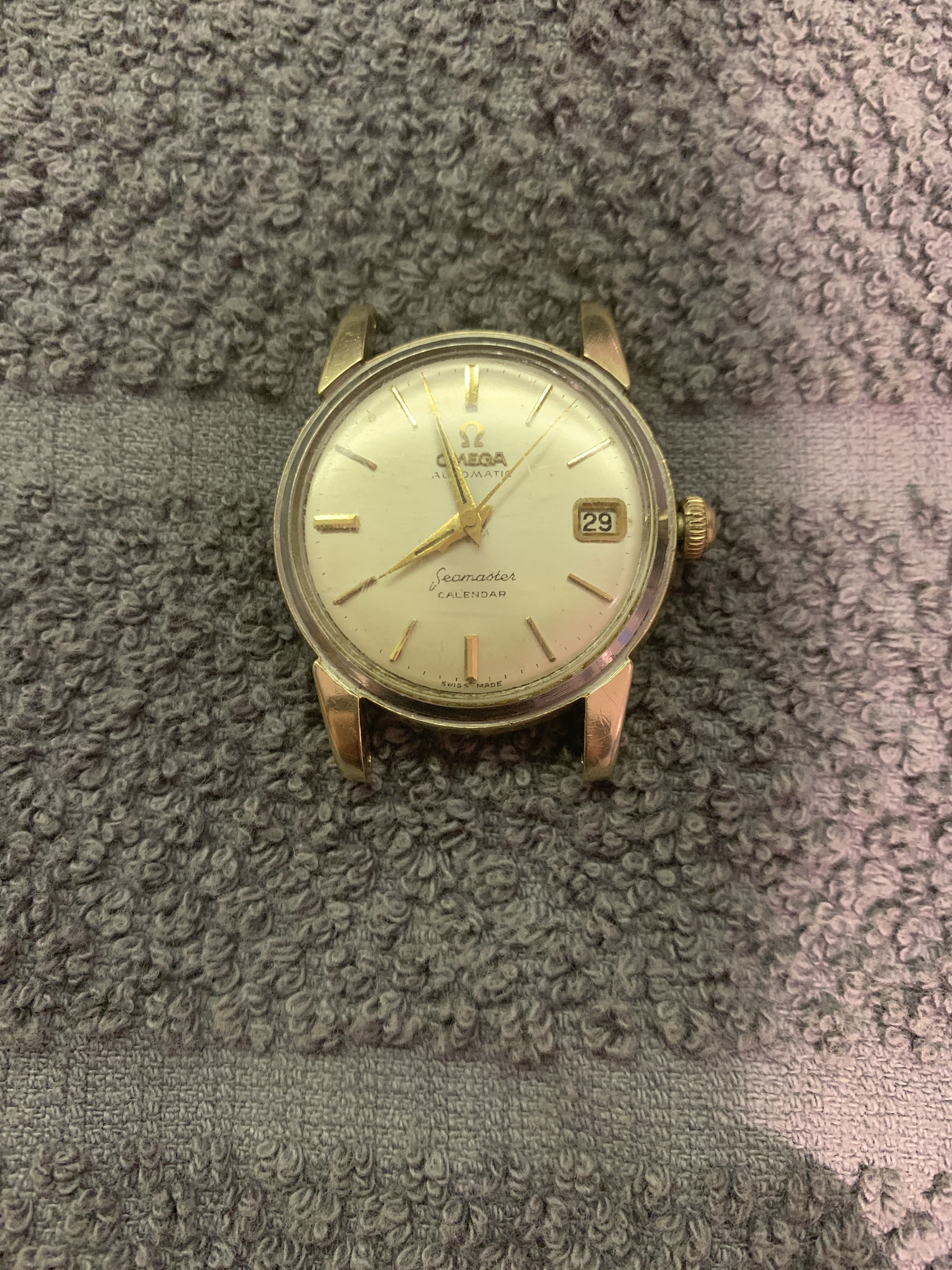

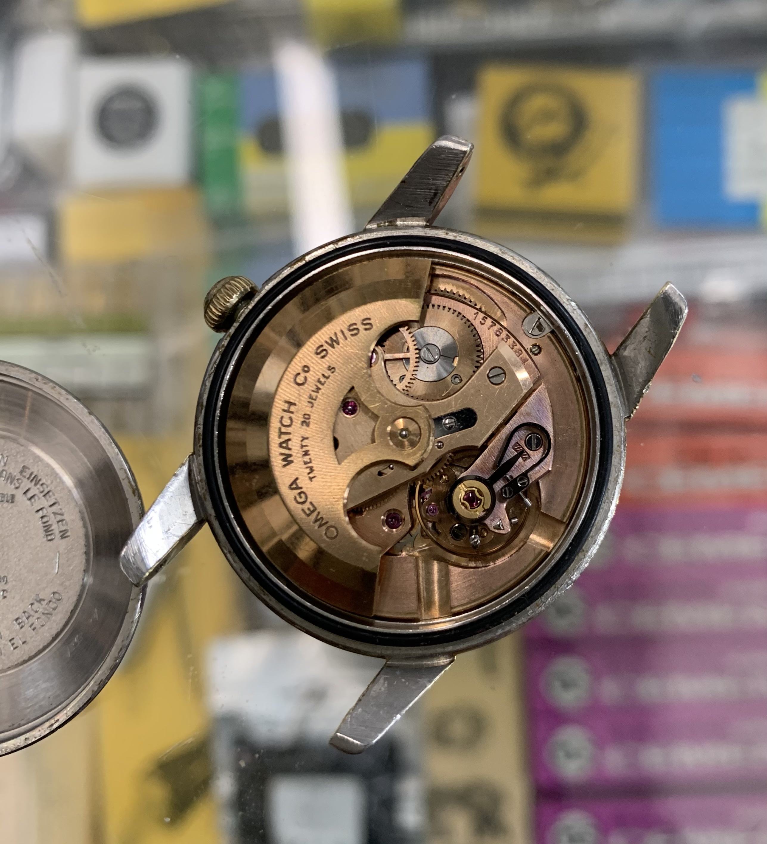

I have worn the watch over a week, set in conjunction with my phone, down to the second and have found that it holds time with a loss of 4 seconds over 10 days. Here are some more pics of it and the speidel strap has been removed.

When I initially looked at this watch, I thought it was a redial. Back in the day, many watchmakers would send watches to be repainted if they noticed blemishes or damage on the dial--sometimes without even telling the owner. In contemporary times, people usually make an active effort to repaint or not because it has an impact on value as the original dial is hard/impossible to properly duplicate. Therefore, "redials" are usually easy to pick out. However, after some closer inspection I don't believe it is a redial. Others with more experience may want to chime in, but this looks like a reference 2849 (or similar variant). If that is the case, the general dial printing looks correct. The photos don't show the font too clearly and I initially thought it had poor printing from a past redial, but that looks like it could be the correct font that may just be clouded by wear on the crystal and your camera's rendering.

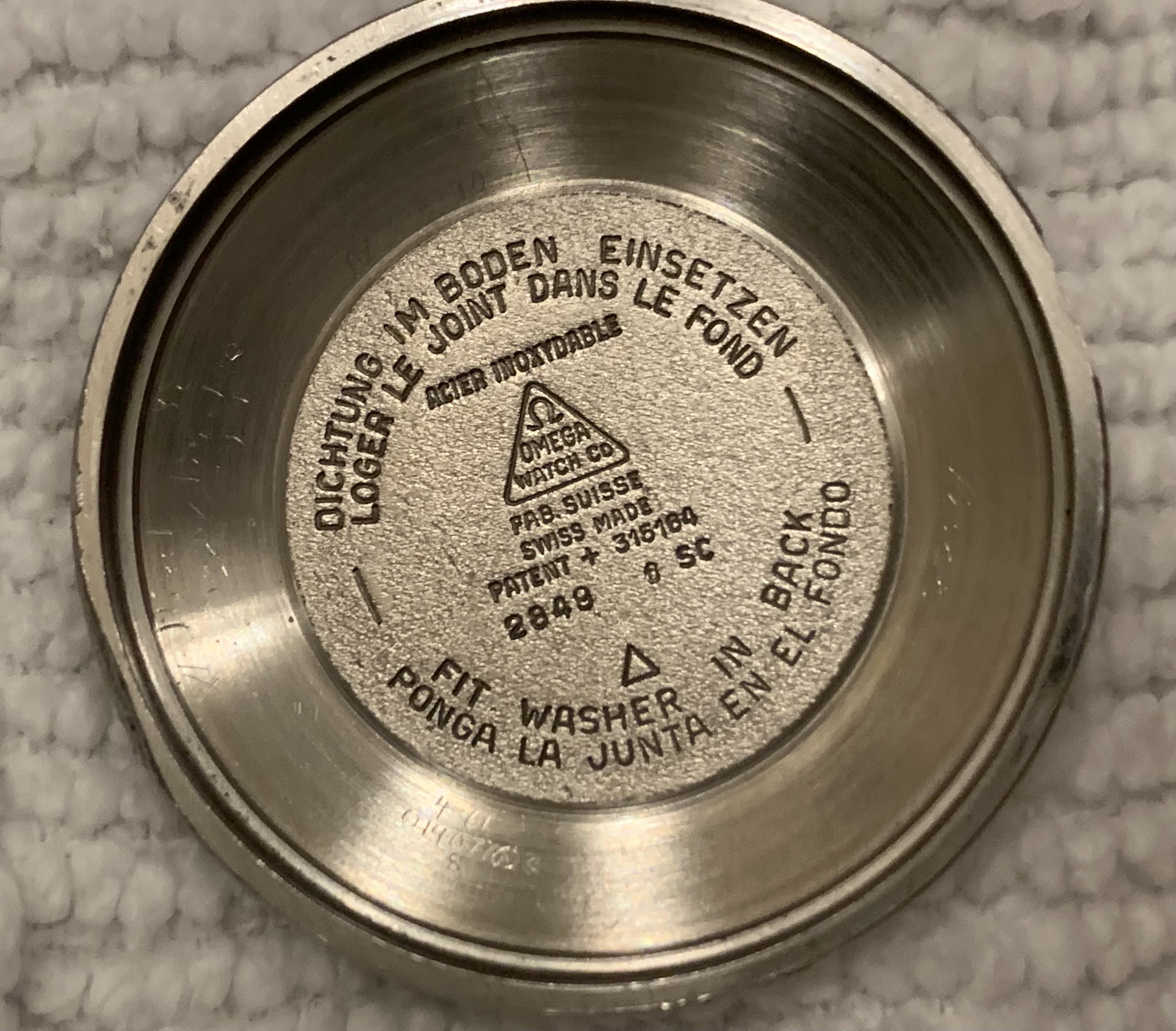

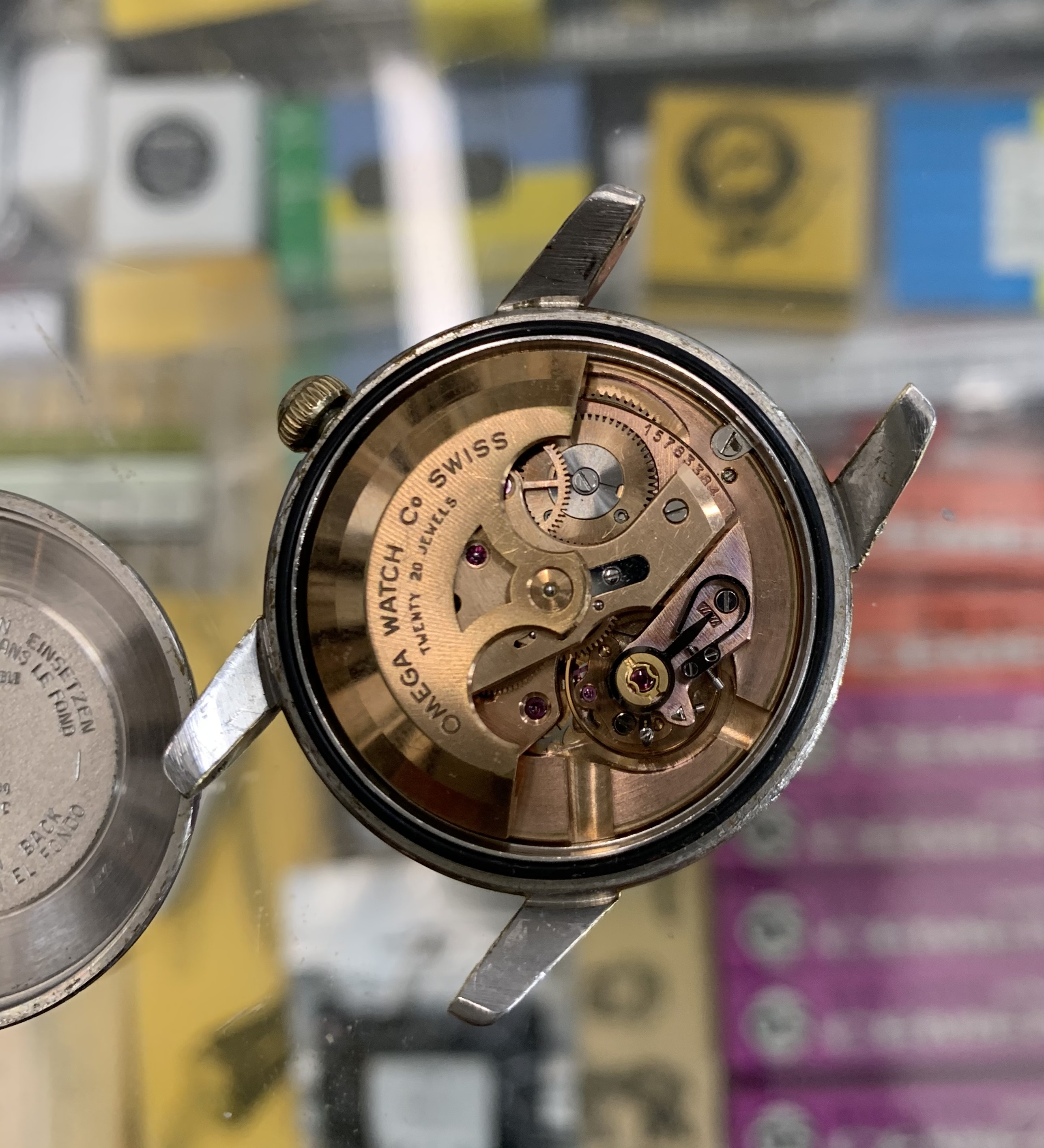

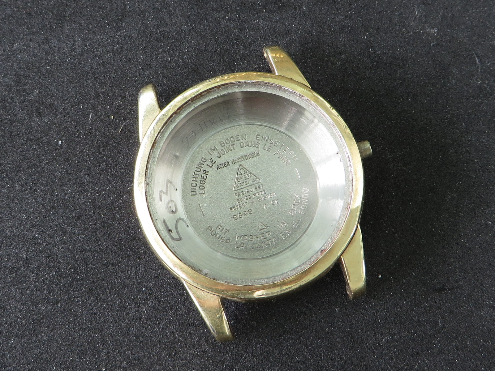

Hello. I was able to get the case back removed and as such I’m posting pics to hopefully assist in tracking down a bezel replacement.
Omega Seamaster Calendar (automatic) circa 1956
serial number is 15783384
Caliber 503
Reference number 2848
Thank in advance for any input, guidance and leads.
Stay safe and healthy. Cheers
Caliber 503
This appears to be a yellow gold capped case - the yellow plated bezel is discontinued, so Omega won't be any help with that. There is a pink gold plated bezel available - 082CE2848. That could be plated yellow.
The other options would be to find a donor, or have a bezel made - I have them made before so this is certainly an option. Having any of that before April 22, not likely unless someone here happens to have one to offer you.
Guessing the watch will require a service as well.
