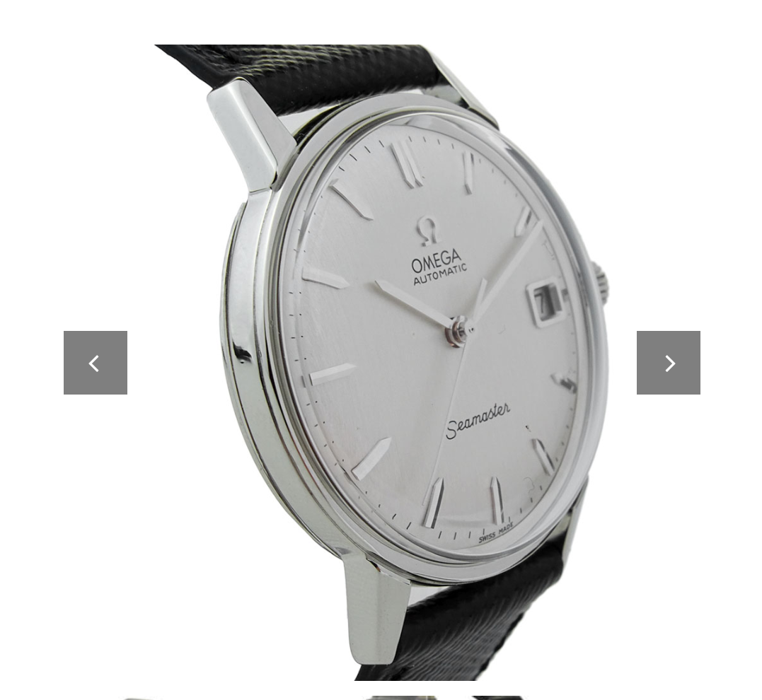

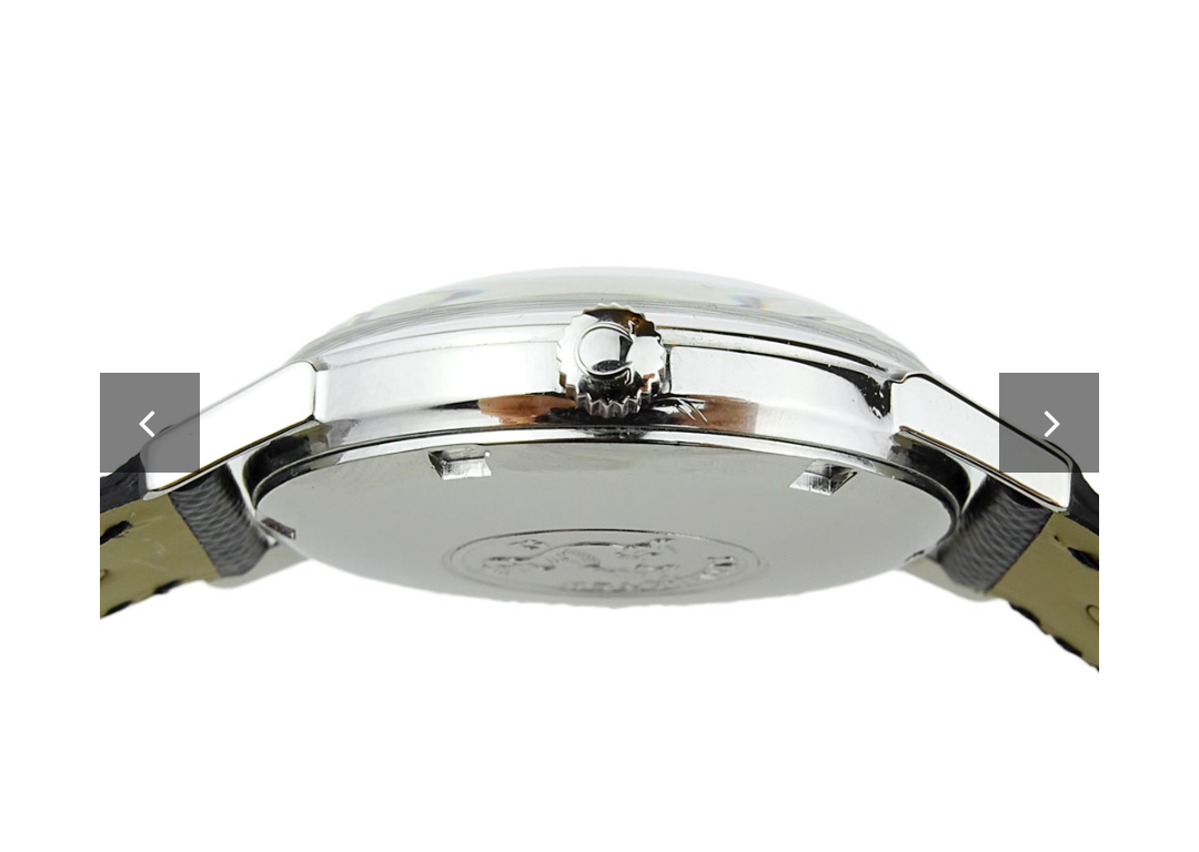

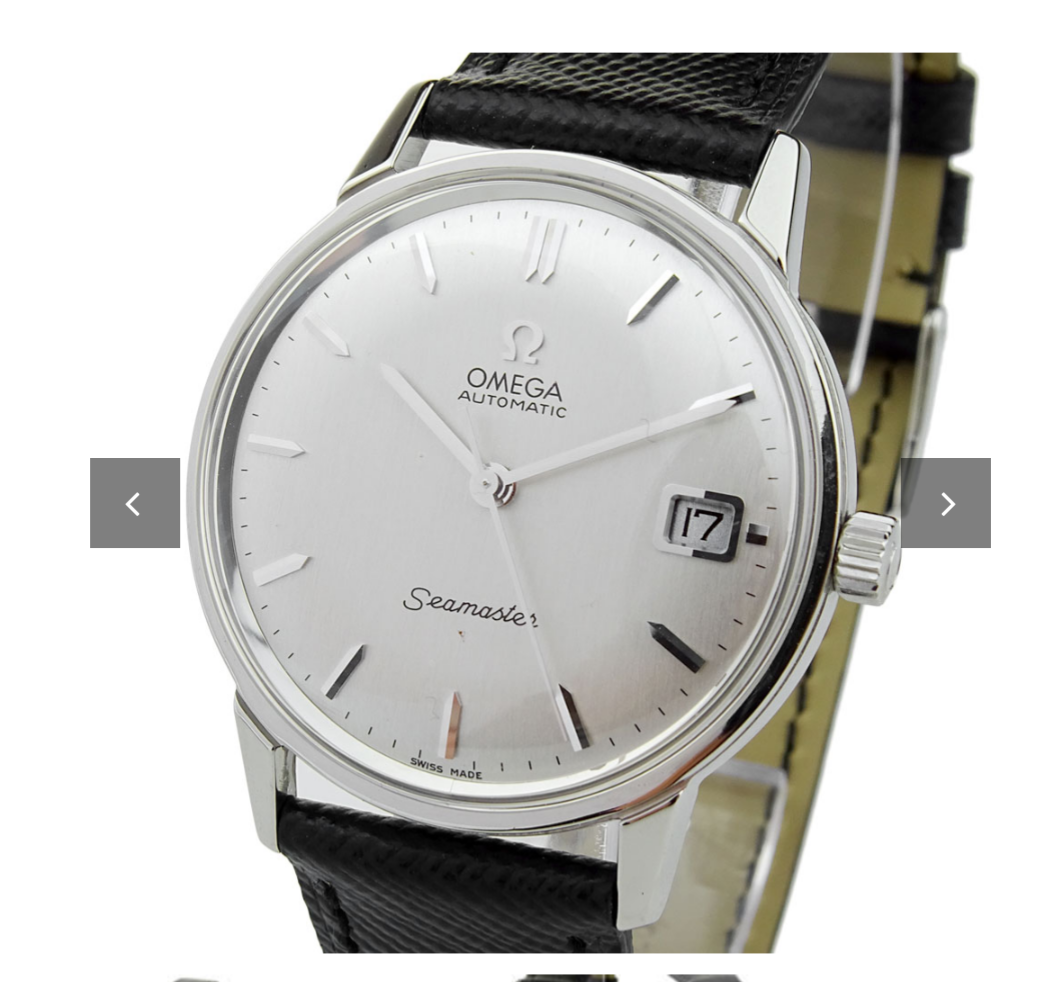

Hi Everyone,
Complete newbie here after a little advice following a quite impulsive purchase of a Vintage Seamaster 166.020 with 565 calibre movement circa 1966.
The watch looks to be in excellent condition, has been serviced by Omega and is provided with their paperwork and remaining 24 month warranty. It also looks like it has been fitted with a new branded strap. In a bid to avoid any fakes, scams or other issues, I bought from a reputable jeweller in my area. However having browsed this forum after buying, I am quite concerned that I may have paid well over the odds as it cost me £1450 and having seen some of the posts on here it seems that a more realistic price may have been around £500 to £600.
Luckily I still have time to return the watch as it has not been delivered yet, so any advice or guidance on whether or not I have made a major mistake would be greatly appreciated.

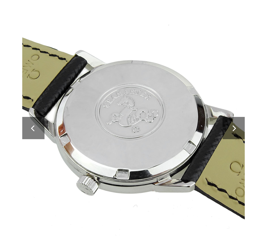

One final thing when putting the 166.020 case number in it often mentions Seamaster Deville. The watch I have bought does not have Deville on the face. I read that it was common for them to have one or the other printed on the face in the early 60's but the article I read hinted that by mid to late 60's both names should have been shown. If anyone could shed light on that minor issue I would also be very grateful.
Pics from the website below. Actual pics can follow once it arrives in a day or so if needed.

You overpaid. Consider it penance for not researching here first.
1,501
5,694
You definitely overpaid, this is not a Ref.166020, could be a Ref.166002. For the price you have the advantage of having two years of Warranty.

Thanks for the reply. Luckily I found the forum in time to rectify the situation and get a refund.
Taking into consideration the service and strap how much do you think I have overpaid by?
The jeweller may be willing to do a partial refund rather than lose the full sale but it would be handy to know roughly what I should be looking to pay in the first place.

It can also been said that you may soon forget overpaying for an authentic and properly serviced watch that should provide enjoyment for many many years. I’m not an authority by any means, but it looks like Omega did as expected and put on new hands etc, possibly diminishing the vintage collector value, but providing you with a reliable timekeeper.
Feel encouraged to post your researched watch prospects here for input prior to a next purchase. Many pay this “noob tax” so don’t feel bad. Read all the sticky threads here, especially learn how to fish https://omegaforums.net/forums/vintage-omega-watches-help-discussion-and-advice.23/

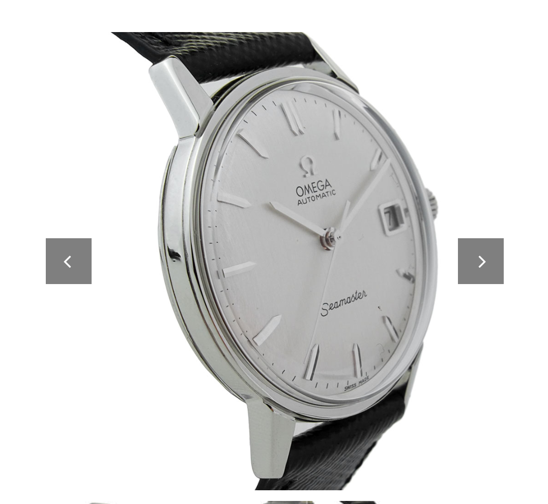

Well, that's debatable. IMO it is a redial, so not much authenticity there, even if it is a quite professional one (The OMEGA font is wrong for the 60s, the Seamaster logo is a modern one with a high crossed t). And the case is quite polished.
Edit: Bottom line from my perspective: Even with 50% off it would be a no go.
Apologies if this sounds stupid but if it has had a redial, new hands as someone else suggested and is coming fitted with a new strap then what if anything is likely to be original to the watch?
The movement and case?
If so I'd be inclined to agree with you that there isn't much "vintage" or authentic about it.

That's how I see it. And another thing: If it really says 166.020 on the case back, then the redial problem gets worse, because then you would expect an applied metal Omega script.
That was from the website description the watch should be delivered today or tomorrow so I can check and confirm. Although taking onboard all the advise that has been given I am thinking I will return it and get the money back. I can then do a lot more reasearch and reading on here before deciding on what I want.

Not quite. That’s not a redial in the normal sense of a repainted original dial. That is the current factory replacement dial for certain 1960s Seamasters, it was likely fitted during an official or authorised service (eg OSC or STS) at extra cost. As noted the font is later so it’s not a like for like swap. It’s still not a good thing but the seller could claim legitimately that it has been serviced with genuine parts, just not on a way a collector would like.
I am seeing some buyers remorse here. By all means return it but dealers have to eat so to expect something like this at a private sale forum price is not sensible. As already noted, the main lesson is to do your research before you purchase. Buy this and you lose 2/3 of your money as soon as it arrives. There are models in the current catalogue where the same applies so it’s not like he is trying to rob you, just exploit the buyers ignorance.

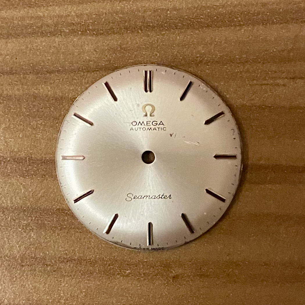

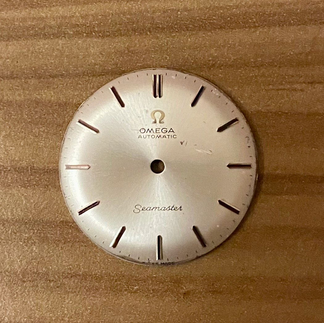

A sensible approach. A watch like that might struggle to make £500 on here due to the replacement dial. It might make more like £750 on ebay due to the shiny shiny factor which appeals to some buyers there and where there would be less awareness of the replacement parts. It is still an attractive piece after all.
Someone, maybe the dealer maybe not, has spent the thick end of £500 servicing that and replacing the dial if it was done the way I suspect. You could argue therefore a fair dealer price would be the £500 true value, plus the £500 service cost plus a notional profit. On that basis your £1K figure looks about right, low even. This is partly why many of is steer clear of dealers and closet dealers.
ps for reference here is what the original dial for that model looked like, this is the non date but is from exactly the same Seamaster model 16X.0002 otherwise. I happen to have a damaged one, note how the fonts are subtly different to yours:
