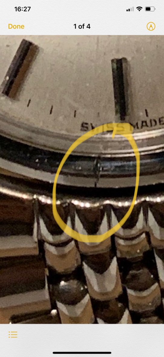

I have a vintage omega seamaster marked as 166.003 on the inside of the case.
unfortunately the bezel is cracked. Does anyone know what material the bezel is made from ?
I would have guessed steel or perhaps stainless steel, but steel shouldn’t really crack ?
Also any ideas on how to get a replacement bezel / repair the current one.

Yes, stainless steel does crack.
You can have it laser welded, finding a replacement will be all but impossible.

Lot of stress on a thin piece of steel. Internal from the crystal which is a pressure fit + the pressure from being pressed onto the case

You might find a manufacturing jeweler, they should be able to make you a new one.

As others have said, the bezel is made out of stainless steel and I'm sure a case restorer could reweld it. I've seen them do wonders repairing deep scratches and dents, so I would assume this is definitely doable and potentially cheaper than re-fabricating it. Unfortunately, I've seen quite a few Omegas from this time period with cracked bezels. Mostly 166.010's on eBay.

Ok thanks guys much appreciated. I now know what material the bezel is made from so hopefully a repair can be considered.

I have had these laser welded in the past and they always crack again at the same spot when being installed. Good luck.

i was considering the laser welding route, so if you’ve tried this already, cheers mate as it saves me a lot of wasted time going down that particular rabbit hole.

Yes, I’ve tried it more than once and when you try to press the bezel into place they split at the same fracture point.

I wonder whether the bezel can be kept open and filled so it will fit better and not crack again?

my understanding is that the bezel cracks because of the pressure from the glass. Whether this is true I don’t know. But a looser fit might stop the glass from being held securely ? Just a thought.

Mmm, no. The crystal has nothing to do with holding the bezel in place on this reference.
