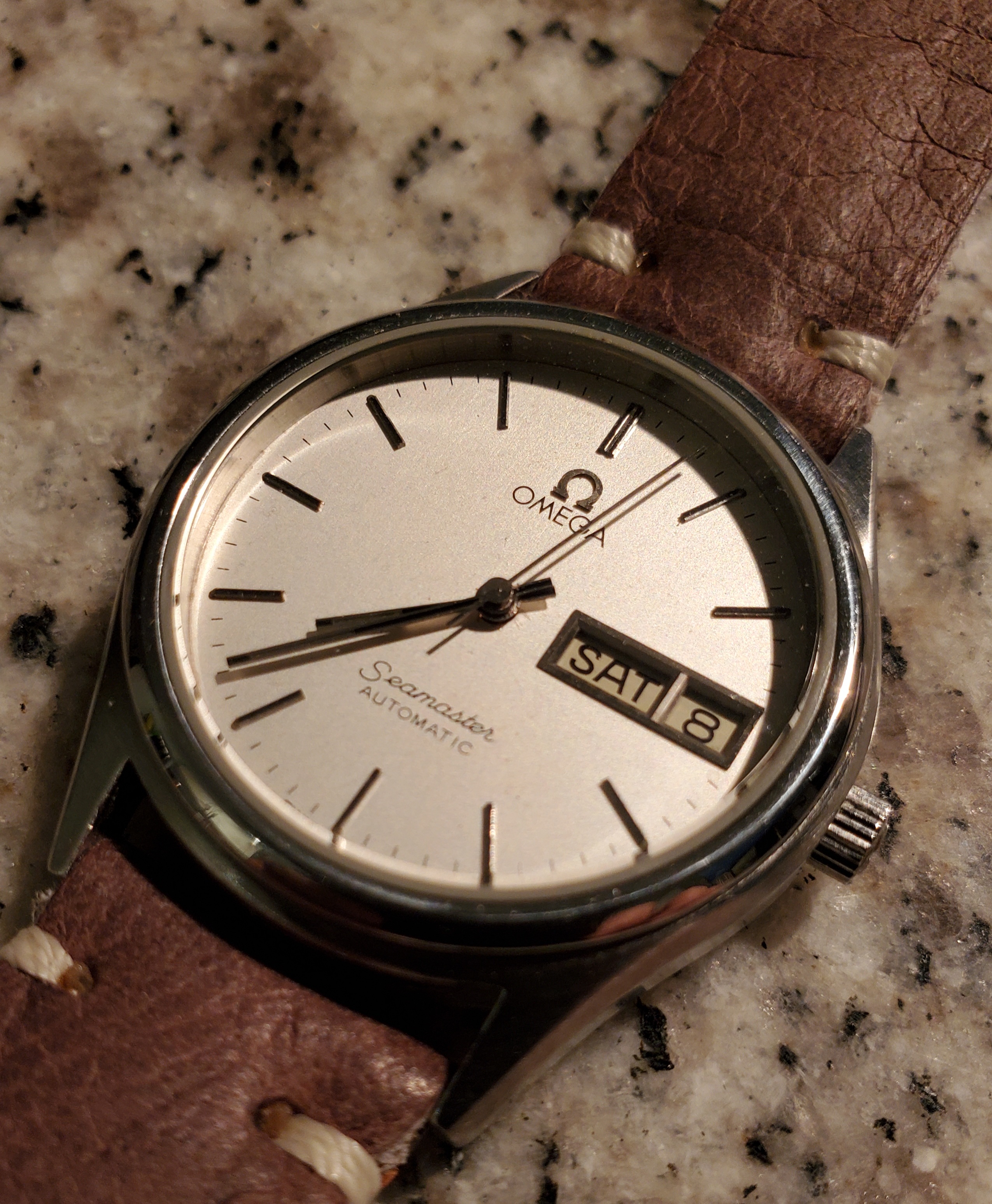

I have a vintage 1020 Seamaster that I inherited from my grandfather.
When I first received it I had it serviced by a local watch maker (June 2018) and it was running well within COSC spec.
Fast forward to today I noticed that it is now running about 1 minute fast per day. Anyhow, what is the typical service interval of this particular vintage? Is 3 years a reasonable time?

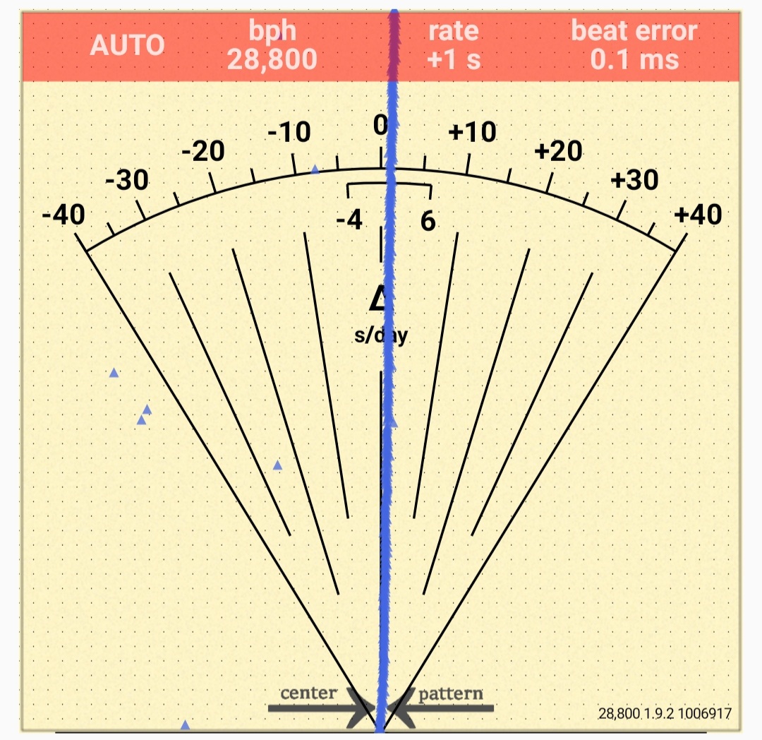

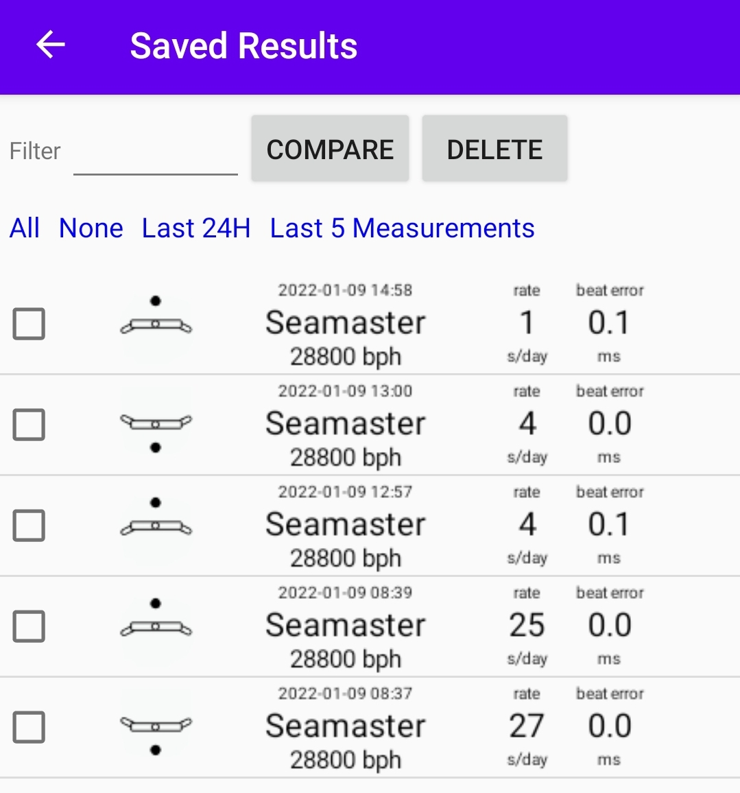

Update: the demagnetizer from Amazon arrived today and I gave the watch a quick "de-zap".
The watch went from nearly 30s to 1s per day based on rough measurement.
