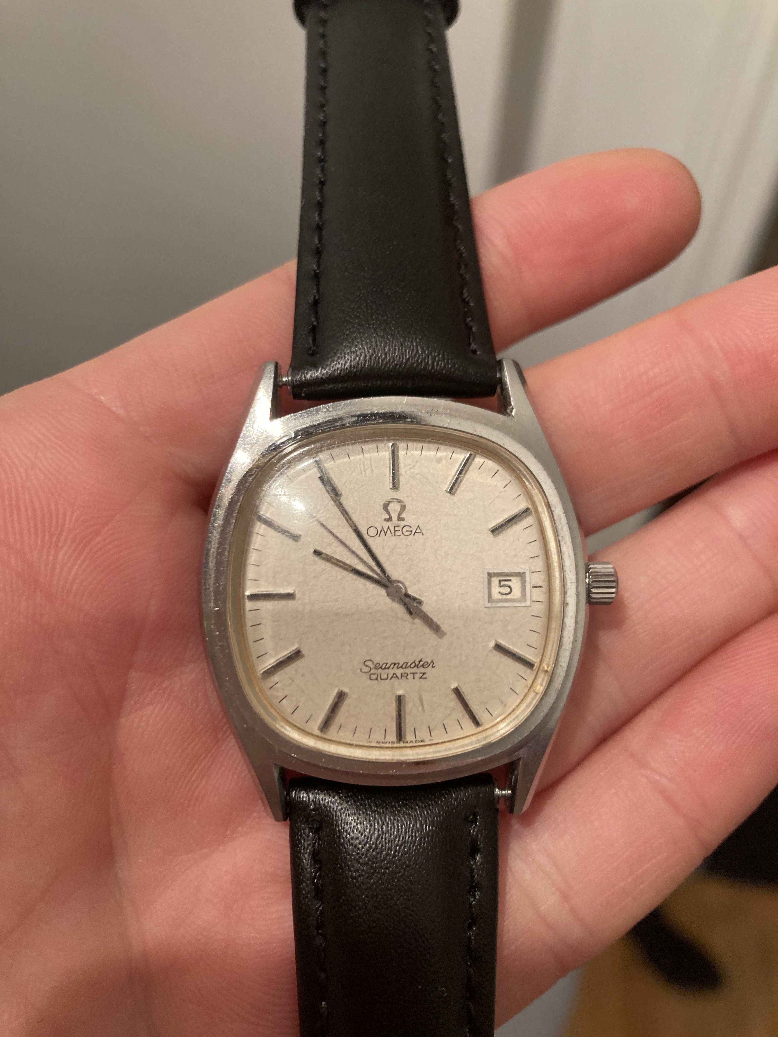

This is the first time I’ve posted on a forum anywhere, so please excuse any gaffs. I couldn’t resist buying this little quartz TV dial Seamaster for about the price of a tank of gas, but it’s woefully in need of an overhaul. No simple battery swap will fix this one. Not only does it not run, the crown moves the hour hand, not the minute hand. (Gah!) Obviously, the repair won’t be cheap. But who (other than Omega itself) actually has the expertise to overhaul a long obsolete quartz movement from the early 1980s? Any recommendations in the NYC Metro area (or by mail) would be most appreciated. Thanks!
