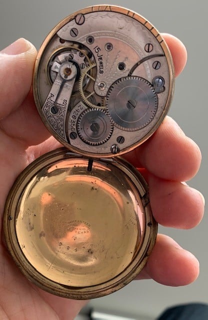

Hey,
So I'm a vintage watch virgin 😀.
I was given this watch that has been in the family for years.
It's a little rough, however it amazingly still works.
Before I look into items like getting a new second hand installed, could someone give me an idea of what I have?
Thanks
18,840
39,183

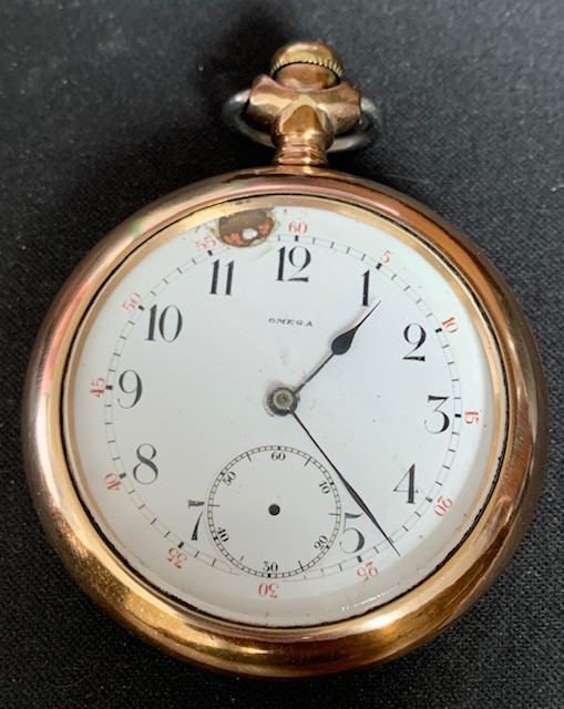

Possibly a caliber 18'''L 15P dating to about 1904.
The dial is vitreous enamel with Omega "Paris" style Arabic numerals and blued steel "Poire" hands.
The movement is decorated which was often done for movements intended for export to North America.
It is housed in an American made case, I can't see the makers mark but it's rolled gold and the "Imperial" is possibly the grade of rolled gold, which is guaranteed for XX years.
The case appears to be for a lever set movement (notch at 2 o'clock?) so it may have been re-cased at some point, or the original buyer just liked that case and chose it when they bought the watch.
If you can provide clearer photos and the diameter of the movement in millimetres it may be possible to add more info.
The diameter is 44.86mm.
The Stamp inside reads WMC CO Imperial, Guaranteed 30 Years. The number stamped below this is 32427.
Thanks for the help.
