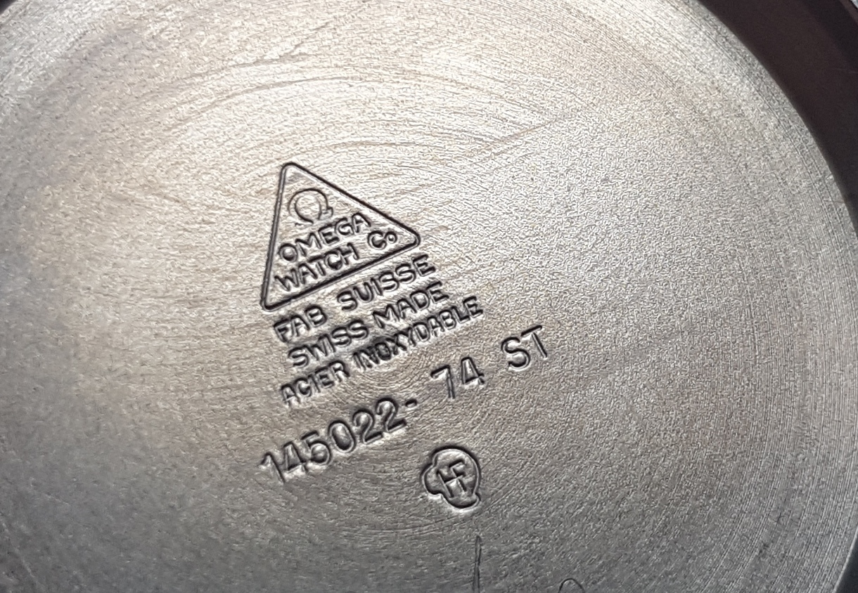

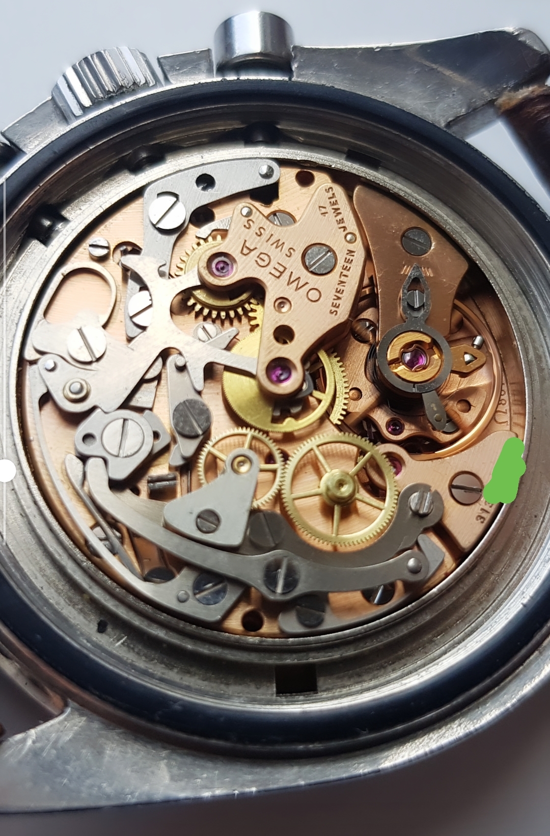

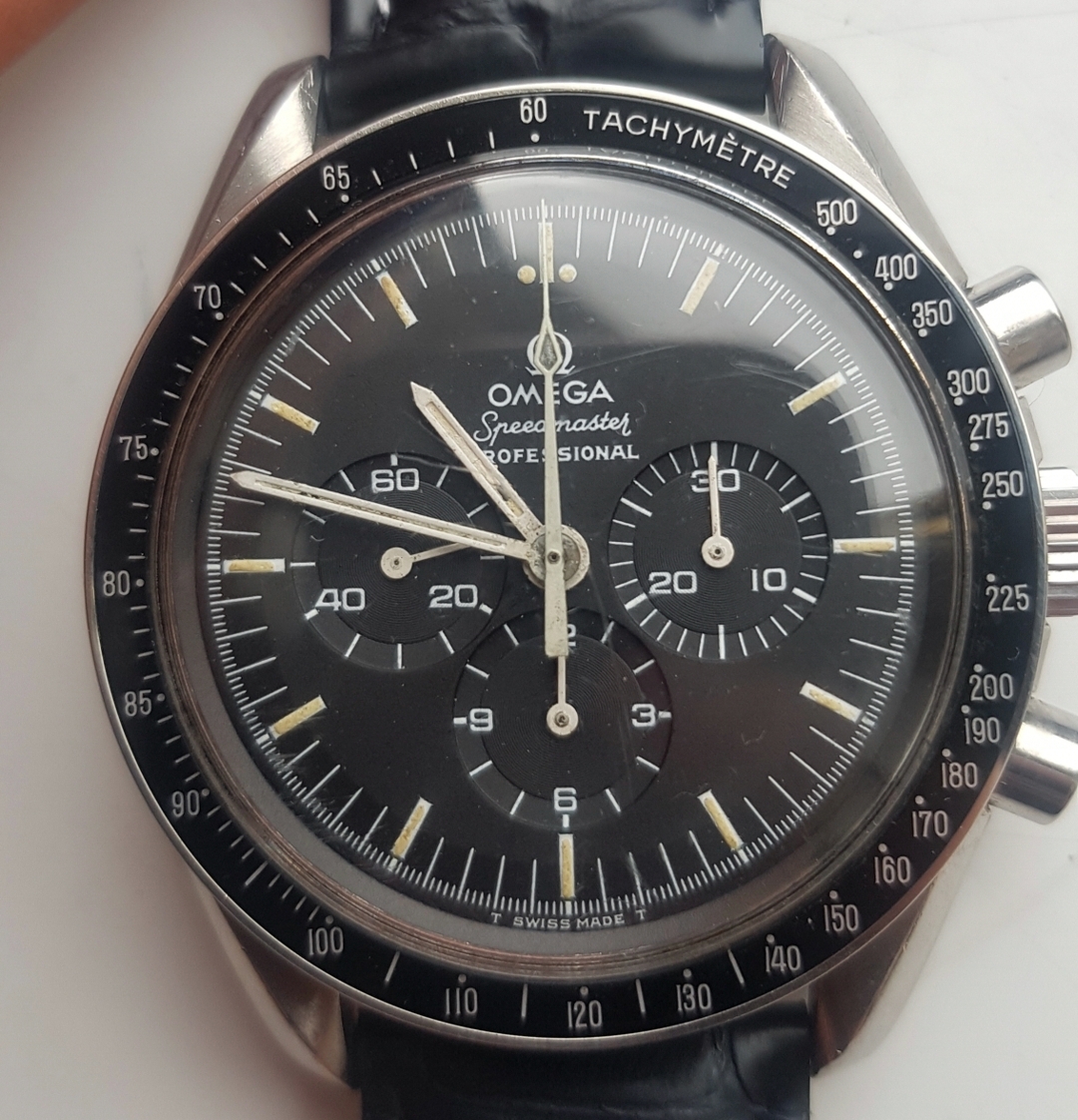

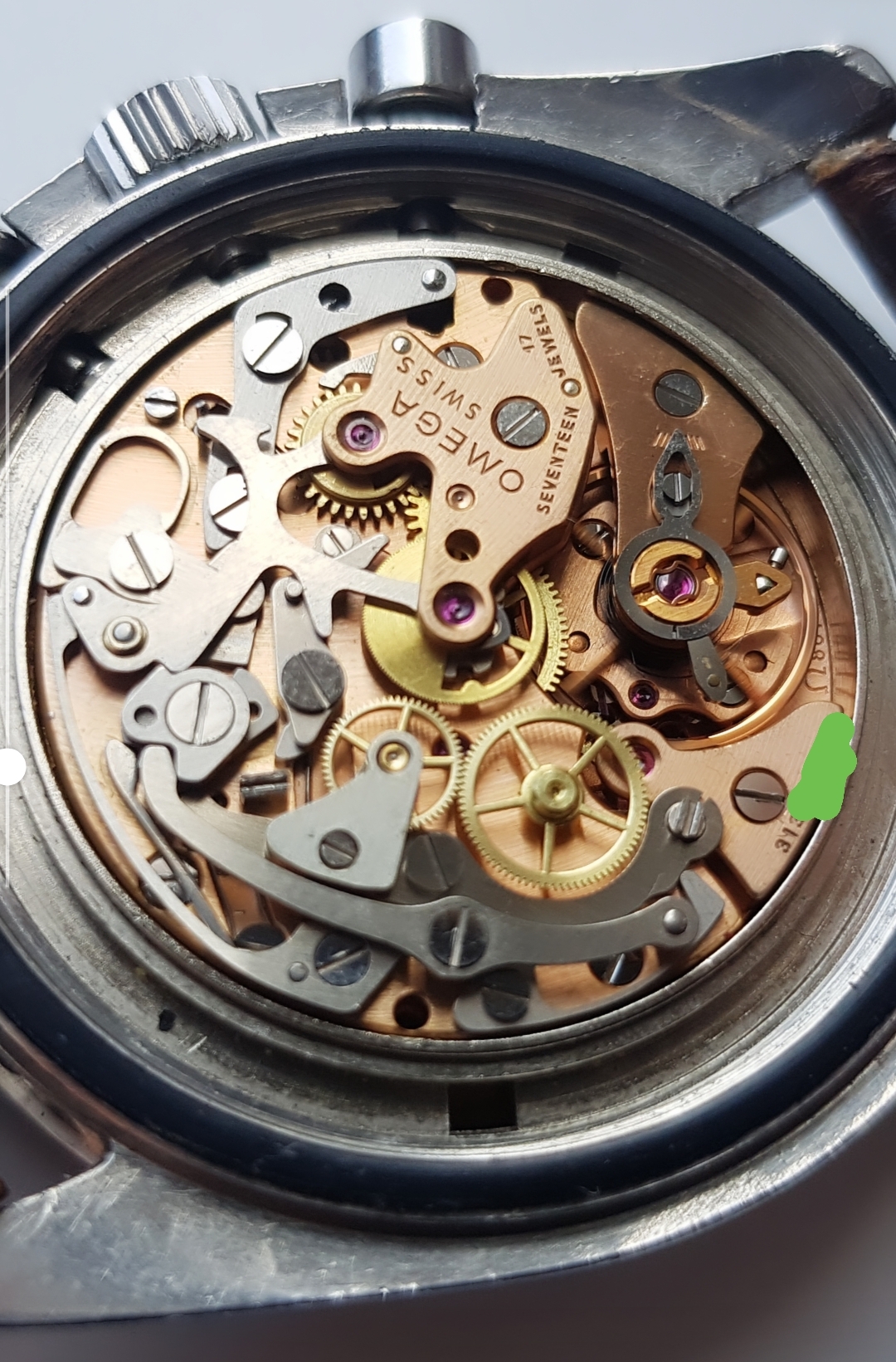

Hi, looking for some advice.
I've got a Speedmaster with movement serial number 31 million odds, depending on what site you visit this gives several possible years of manufacture. I've seen it ranging from1969 to 1973. Movement is calibre 861 as it should be.
The inner caseback is marked 145022 - 74.
I paid for an extract from the archives from Omega and they got back to me stating "The available historical documentation associated to the movement you provided us leads to a watch model that does not match the one in the pictures you submitted."
Would you reckon then the movement at some point has been put in a newer case with the inner caseback being marked 145022 - 74. But surely they could have gave me an extract for the watch even though the movement has maybe been changed at a service?. I mean from what I can tell everything is perfectly genuine and original.
I'm now unsure about the date of the watch and what exactly has happened.
It may be a stretch but any help / advice appreciated. Pictures attached
Thank you, M

Curious to think that the movement has been replaced by a movement in the correct range for that reference… Even if it is known that this reference got the widest range of all pre -78 Speedmasters.

No. That means, that your movement does not belong in a Speedmaster. Could be a Seamaster chrono. That is a polite way, to tell you, your watch is not original.

From what I've seen from research a calibre 861 with such serial number is the right movement for this type of watch. I took it to mean it didn't belong in this 145022 - 74 model and instead another Speedmaster rather than another watch altogether?.

Thanks for the advice. On entering the serial number on the site it gave an production estimate of May 1971. Everything I've read does point to a Speedy movement so I'm quite reluctant to think it doesn't belong in a speedy.

Omega knows what watch that movement was originally installed into. As @watchyouwant mentioned, the message you got from them suggests that it was not a Speedmaster movement, but there's no way to know for sure. Cal 861 movements were used in various models, including Seamaster chronographs, and when repairs are made at a later date, people will often use whatever movement/parts they can find.

Ha, it's just a pain Omega couldn't have given a bit more info. As Jaegodylan stated above he was told a very similar thing relating to his watch when he tried to get an extract of the archives and it turned out to be the wrong caseback causing the issue. They also stated to him the issue was regarding the model, I have hope yet.

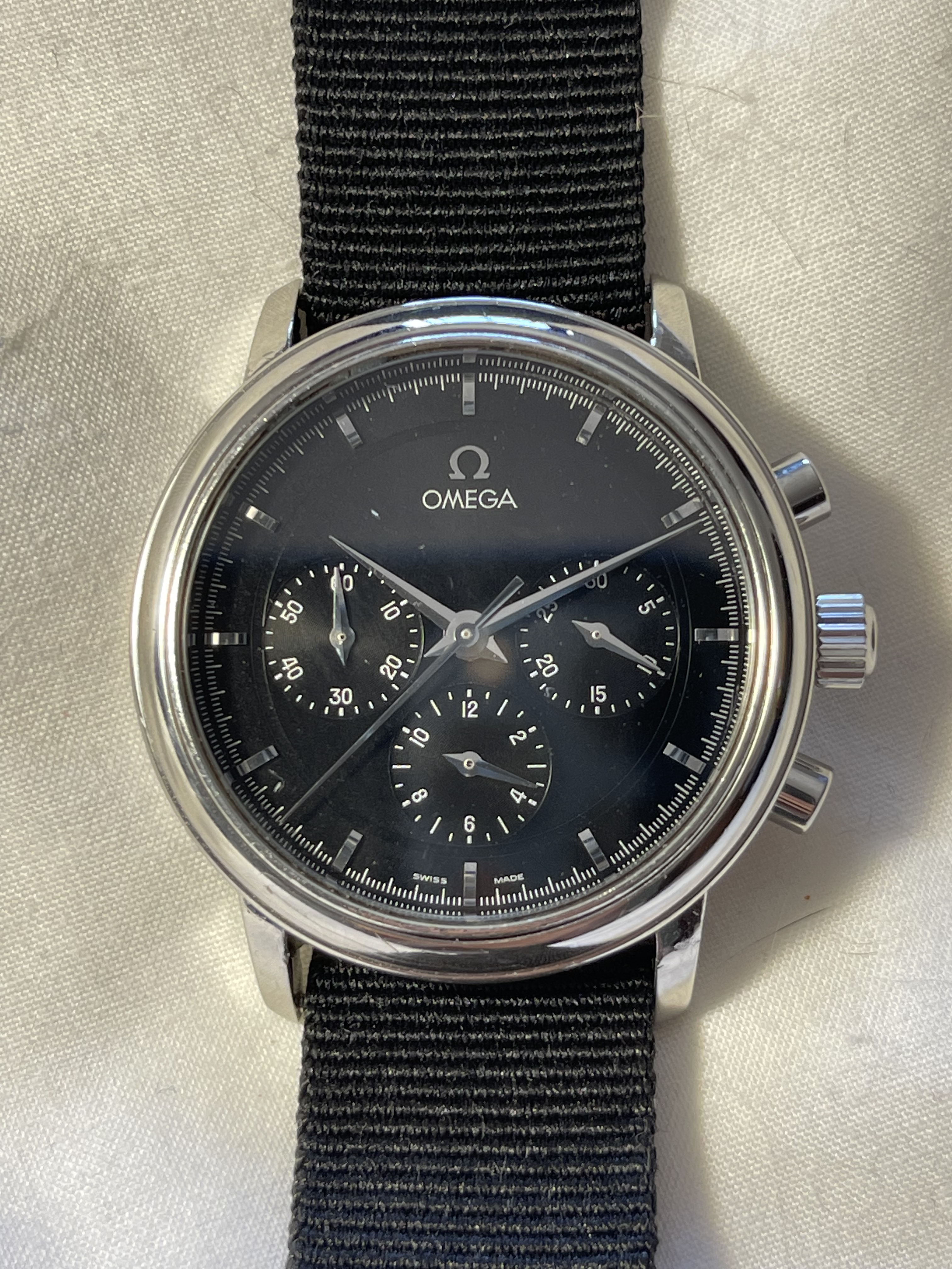

... Cal 861 movements were used in various models ....
i have this one, 861 in it, not a speedmaster

Do you know if the only case reference is the 145022 - 74 one on the inner case back, or would there normally be another elsewhere. It seems weird do only be on the case back when they're often changed over. Other watches I own it's often between the lugs etc
Thats is the only one.. the odd thing here is I don't think they would deny it over the -74 as the extract would typically only ever say 145022.

There are several Speedmasters 145.022-74 (flat dial, middle-size S) in 31.3 millions so please don't consider that it's a replaced movement or something similar. Unfortunately the beginning of the 1970s is a weird period with 145.022-69, -71 and -74 with serial numbers in the same range/batch.
