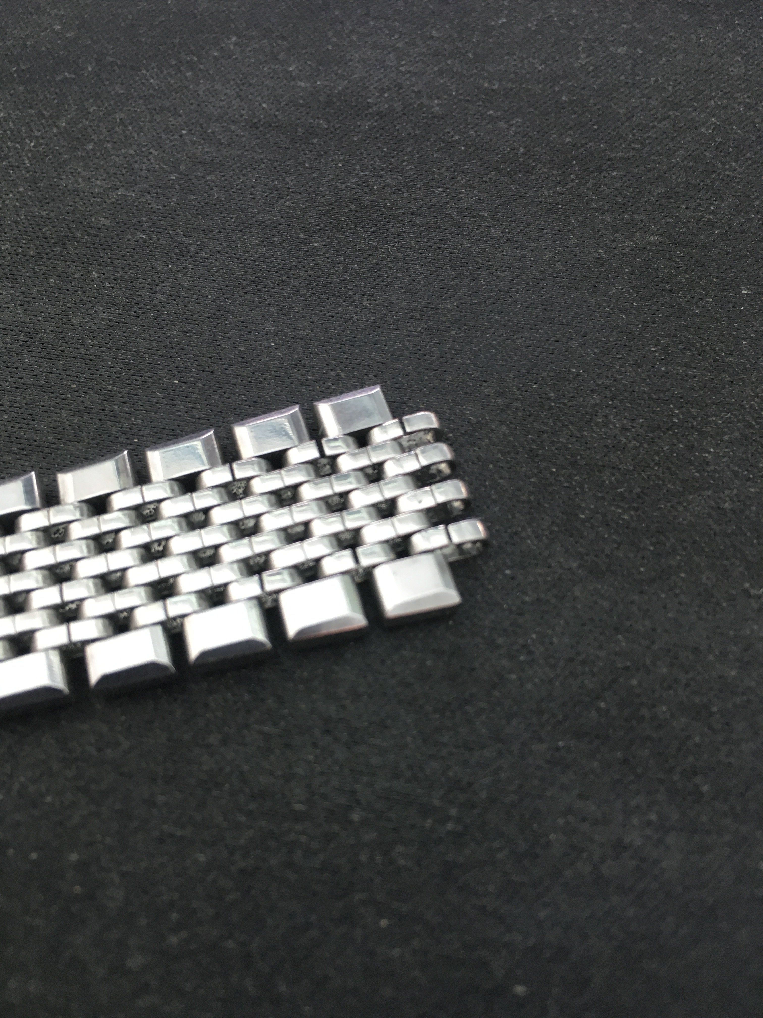

I don't really know if there is already a suitable thread but I need some help in regards to which endlinks and which beads of rice bracelet to purchase for my Omega Seamaster Cosmic (ref. 166.026-tool 107). I already have a very pretty leather strap but I want to switch between sporty and classy. I've found a BOR bracelet on the internet, which fits my lug width (18mm). I wanted to ask the forum if this is the correct bracelet with endlinks to purchse.
Here's the link to the bracelet I found:
https://www.etsy.com/de/listing/758..._query=18mm+omega+bracelet&ref=sr_gallery-1-2
Thanks in advance.
Cheers,
Max Hazelaar

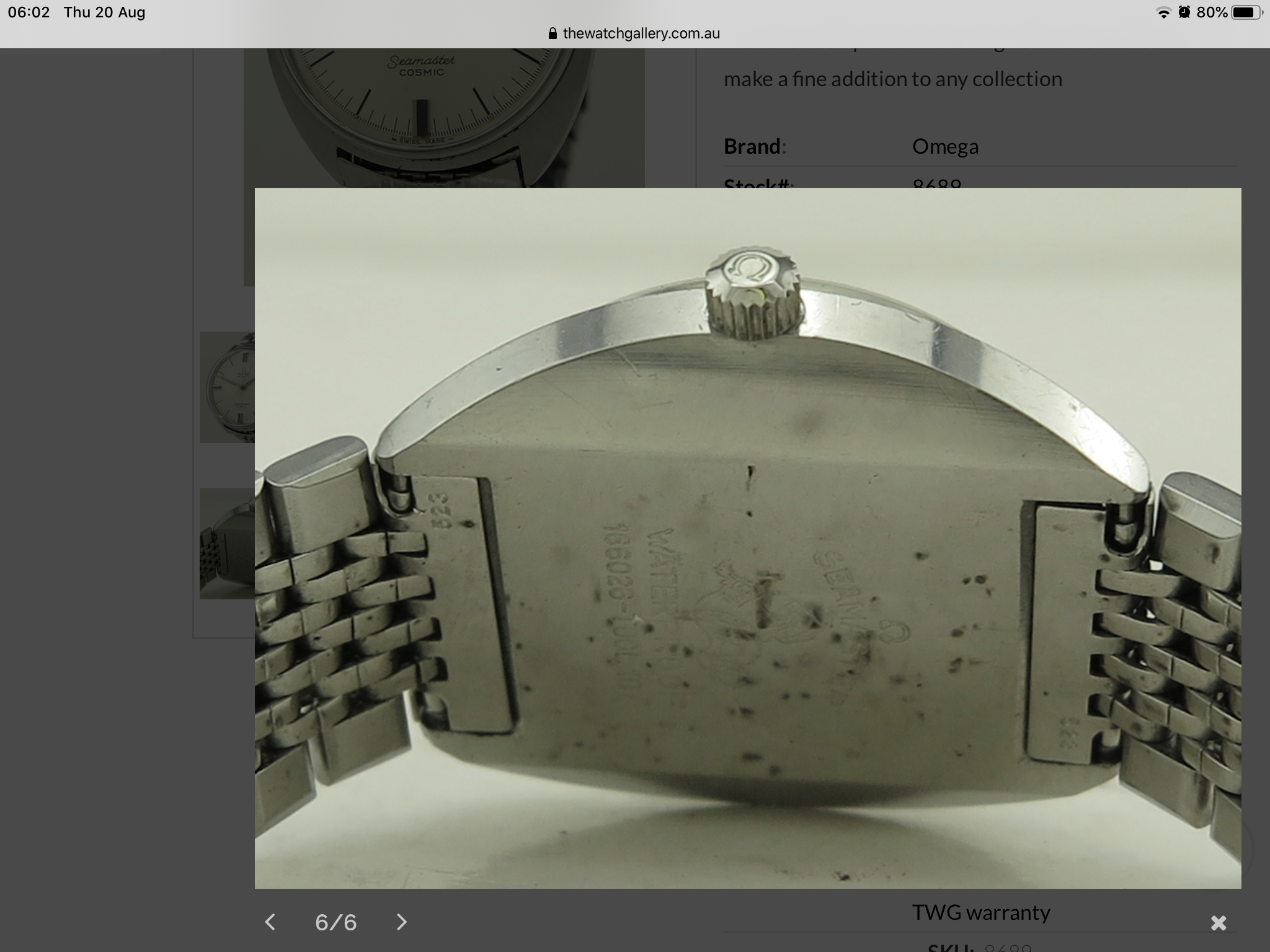

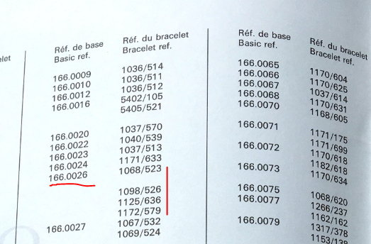

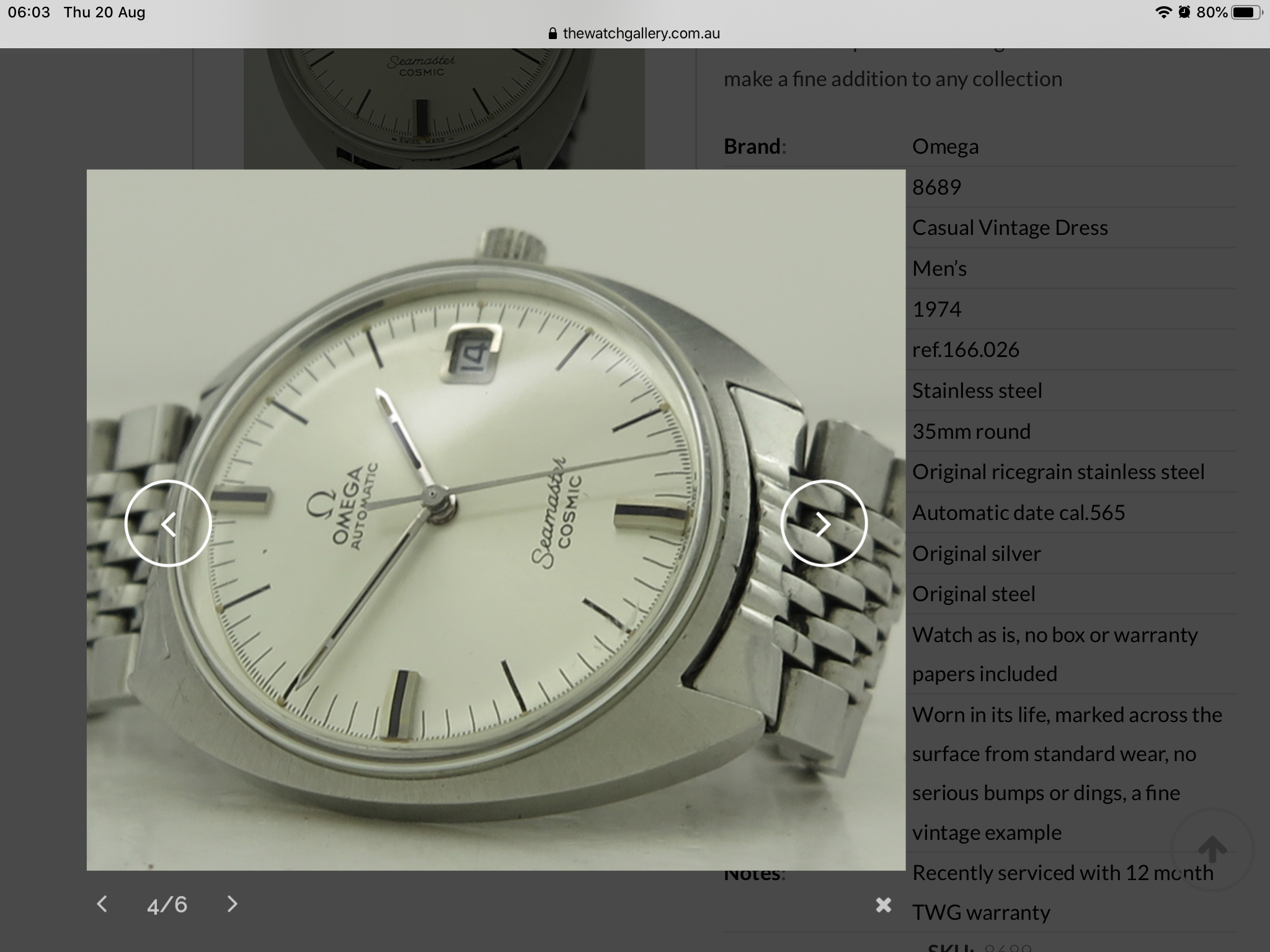

A google search revealed this - looks to be 523 ( or 623)
But other bracelet types also come up

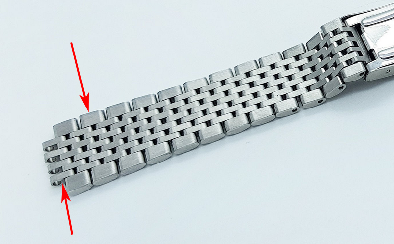

The bracelet in your Etsy link is FAKE, as are probably 95% of Omega products offered there.
The outer links have the wrong shape, the back side should have a beveled edge and the center links should be hollow, not solid.

Thank you for the quick responses! Anyone got an idea where I can buy a 1068 bracelet with 523 endlinks?
cheers,
max
